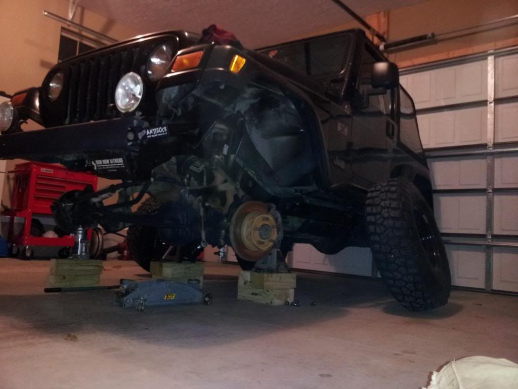

How it sits as of right now. Going to start again tomorrow with some prep and painting of the axle and frame areas that are usually harder to get to.
Going to rent a coil spring compressor tomorrow to help with reinstall.

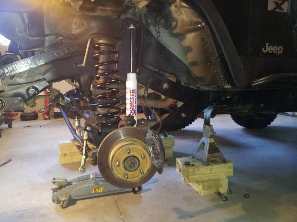

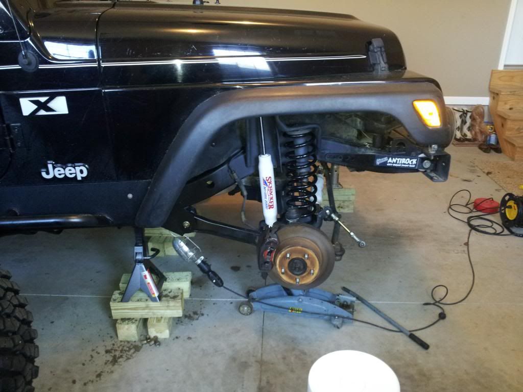

Coil spring compressor made the job much easier.
Driver side finished:
Passenger side finished:

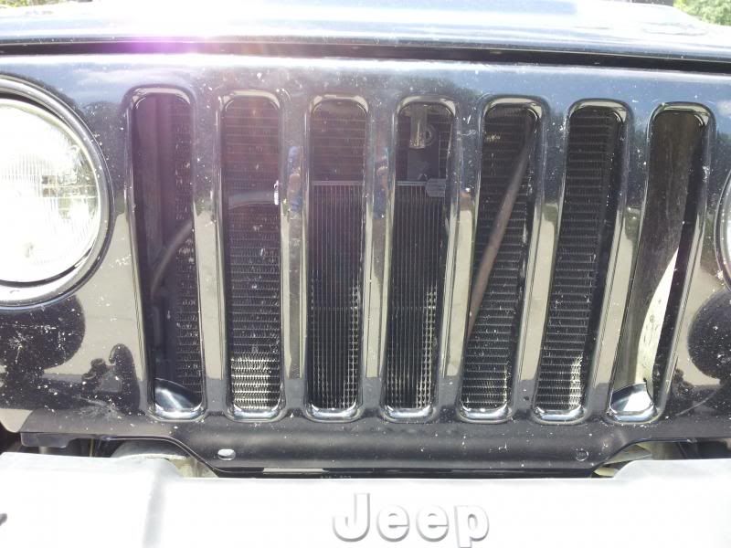

-Picked up an OEM 4.0L transmission cooler off of a 90's Ranger from a friend for free, added this into the return line with some barb fittings
-New front calipers
Only pic worth mentioning is the transmission cooler all finished up (Jeep is dirty):
Overall the transmission cooler addition wasn't too bad, and it's really seemed to help temps while at cruising speed. Overall very happy as the cost for the cooler was only 4ft of hose, clamps, mounting hardware, and a couple barb fittings.

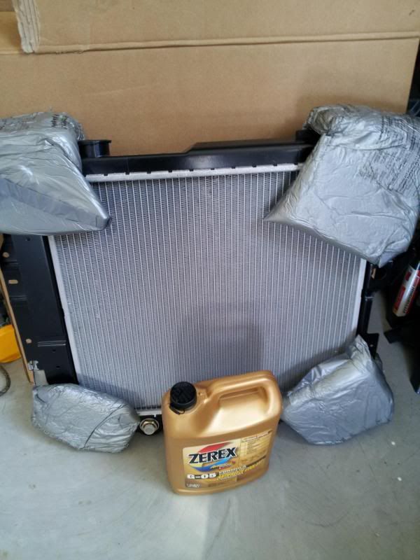

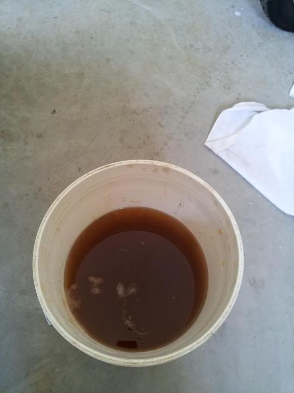

Factory radiator finally seemed to take a crap, think it had too much build up and wasn't flowing as it should. After almost 10 years and 130,000 miles I am not too disappointed. I made the mistake at some point and used Prestone's "mix with any color" coolant at some point, and I think what was flushed out speaks to that:
After this I flushed with Prestone's Super Flush twice, then just water 3 times. After that the water was coming out quite clear, so I called it good after one more draining.
All torn apart:
Hoses checked out good, they aren't that old. Went ahead and threw in a new SuperStand 195 degree thermostat. After this the new radiator (factory replacement sourced from a local radiator shop) was installed with fresh Zerex G-05 HOAT coolant and distilled water.
With this the entire cooling system has been replaced over the past few years, so feel pretty good about that. Should last me quite a long time!
