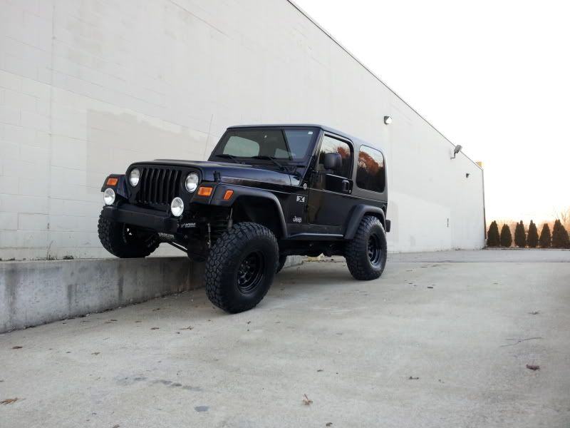

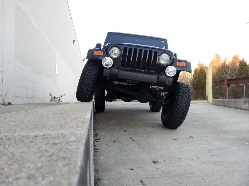

Bit of mall crawlin' flex today. I was able to nearly max out the front and it seems that my bumpstops will not need to be modified. I may consider trimming the fenders a small amount, maybe .25" most. Either way working to get the Jeep ready to wheel here soon. I need to replace the right tie rod, just using another ZJ one.
You will also notice my spare hasn't been replaced. I ordered a matching steel wheel, and took it to the tire shop. But for some reason they only had 4 of the tires I requested delivered. Left the wheel with them, and they are going to have it ready for me this coming week.

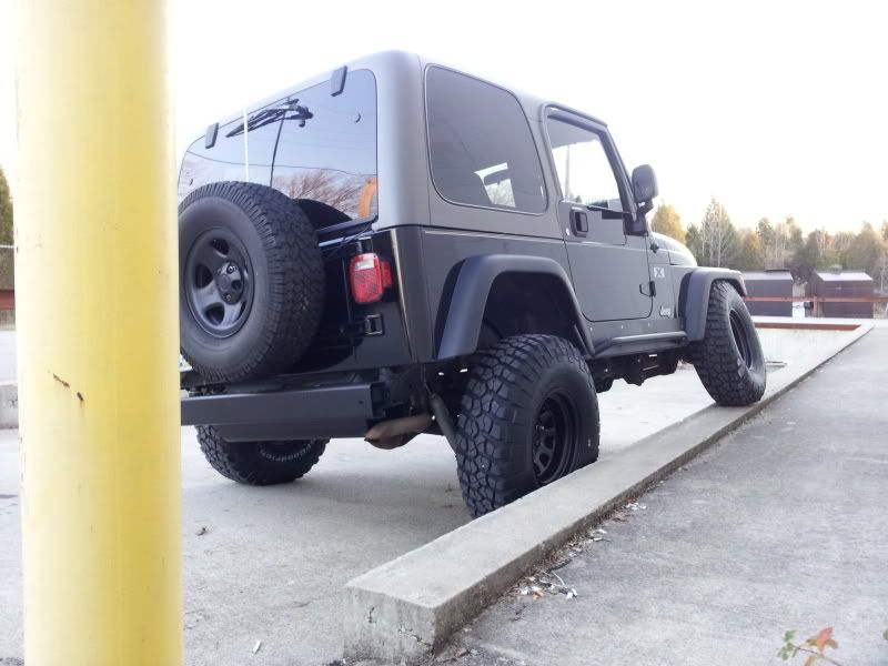

New tie rod was installed then aligned the next day. Full size spare is in also. Waiting on hockey pucks to properly space tire to tailgate.
33s have not been bad at all, can't get an accurate read on fuel usage as it was cold last week so there were many mornings where I let it warm up before heading out. But very pleased with them thus far.

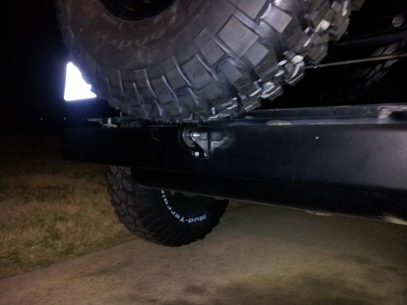

Stole this idea off of another member on this forum, can't recall who it was. Headed to Lowe's, ended up with a heavy duty 110 lb caster. Cut the top part off, drilled a few additional holes, sanded, painted, then drove it home with some self-tapping screws. Result:
Really seems to help support the tire. I do notice the interference when I close the tailgate, which makes me feel good about the additional support. To increase the functionality of the setup I have some hockey pucks and longer bolts. Plan to extend the OEM rubber stoppers later this week so they firmly contact the tire.
