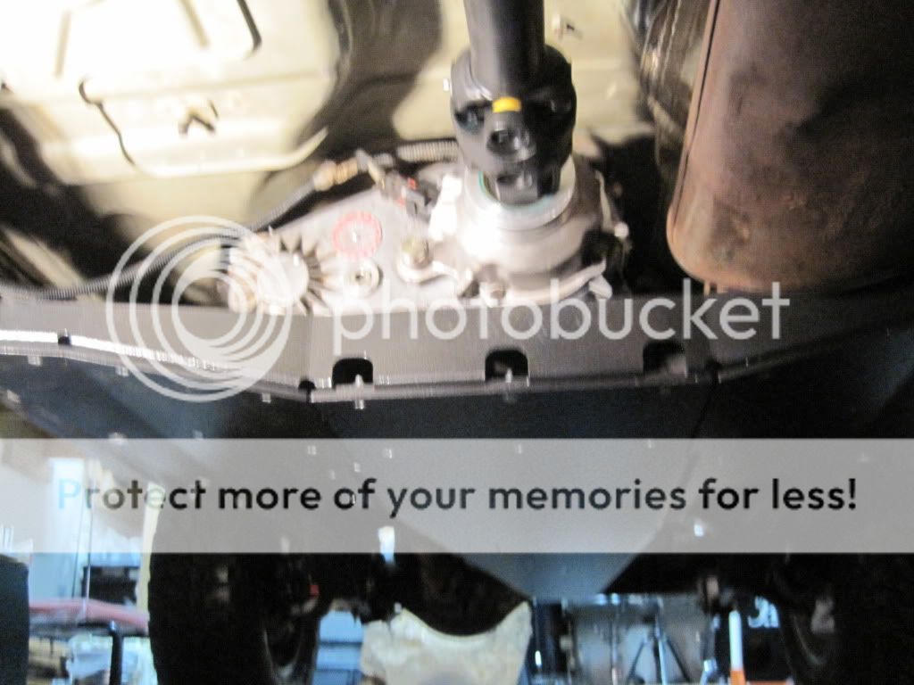

There are numerous benefit to running the Under Armor. Due to the flatness of the design and the overall drivetrain lift my output shaft is at 3.3. That is almost perfectly flat. In all honesty I was hoping to deal with an SYE and Double Cardan shaft later since we are dealing with an LJ but every Jeep is different and a 3" pure drivetrain lift is too much for my LJ. A rubi LJ might be a different story.
An SYE install will happen early next week with lots of pictures so stay tuned for that

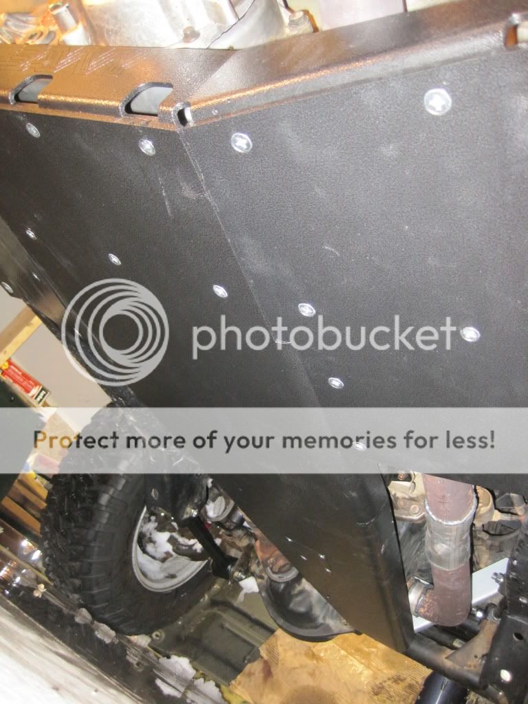

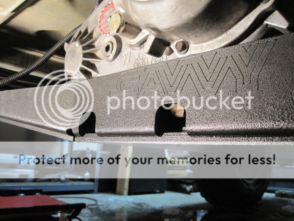

Just thought I would make a quick update to this thread. I have a few issues going on and needed to get them cleared up.
1. After my Under Armor Install I had some vibes so I installed an SYE and we are all good now.
2. Install a full set of Currie Arms and no issues with them. No additional vibes or road noise.
3. After getting the Under Armor Installed I wanted to clean up my multiple oil leaks before getting my skids all messy. So I did the valve cover gasket, oil pan gasket and rear main seal. Lots of work but I have no leaks and very please on how well it turned out. I really hope the rms holds up for a while.
4. I got my skids powder coated and they look great!
Here are some shots of the Currie Arms flexing on stock suspension with sway bars connected. (cell phone pics I apologize)
jermeyg is offline

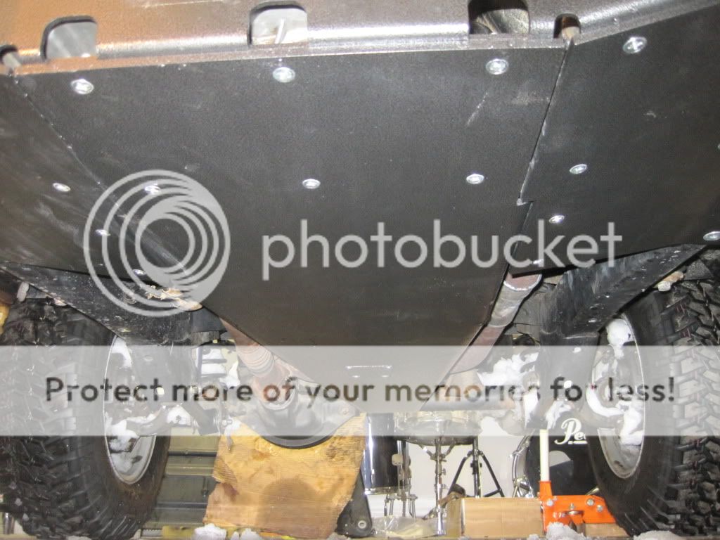

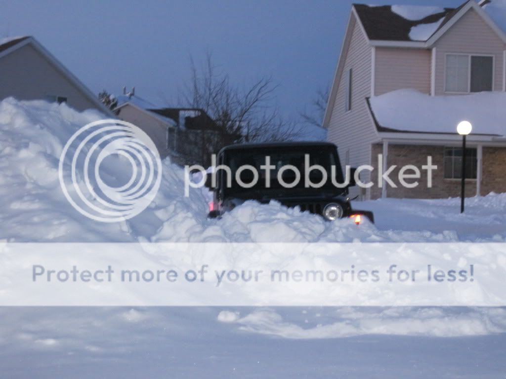

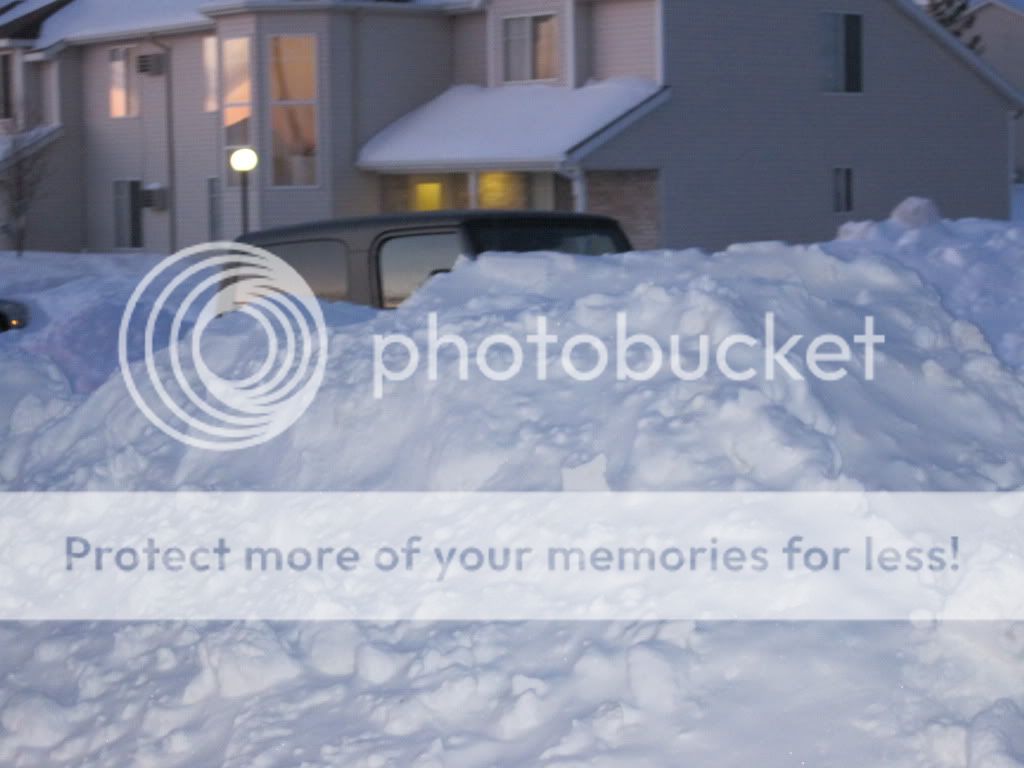

post #95 of 295 Old 02-02-2011, 10:10 PM Thread Starter
jermeyg
Location: Rosamond
Posts: 557
Got my skids on
and a chance to play in the Great Snow Storm

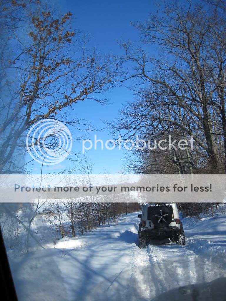

post #96 of 295 Old 02-03-2011, 09:46 PM
Geister
Location: Illinois
Posts: 212
how many inches did you get by you? i got 22"
"If you don't fear death, then death will fear you"--Whitt
Geister is offline
post #97 of 295 Old 02-13-2011, 01:29 PM Thread Starter
jermeyg
Location: Rosamond
Posts: 557
Hey, sorry for the late response. I think I am at 15" with stock tires and no lift.
Went on a snow run this weekend. Had lots of snow and some guys on 39s busting the trails. Really impressed with the Jeep on stock suspension. I got stuck once but really kept up with the group with little issues. The under carriage clearance really helped out!
jermeyg is offline
