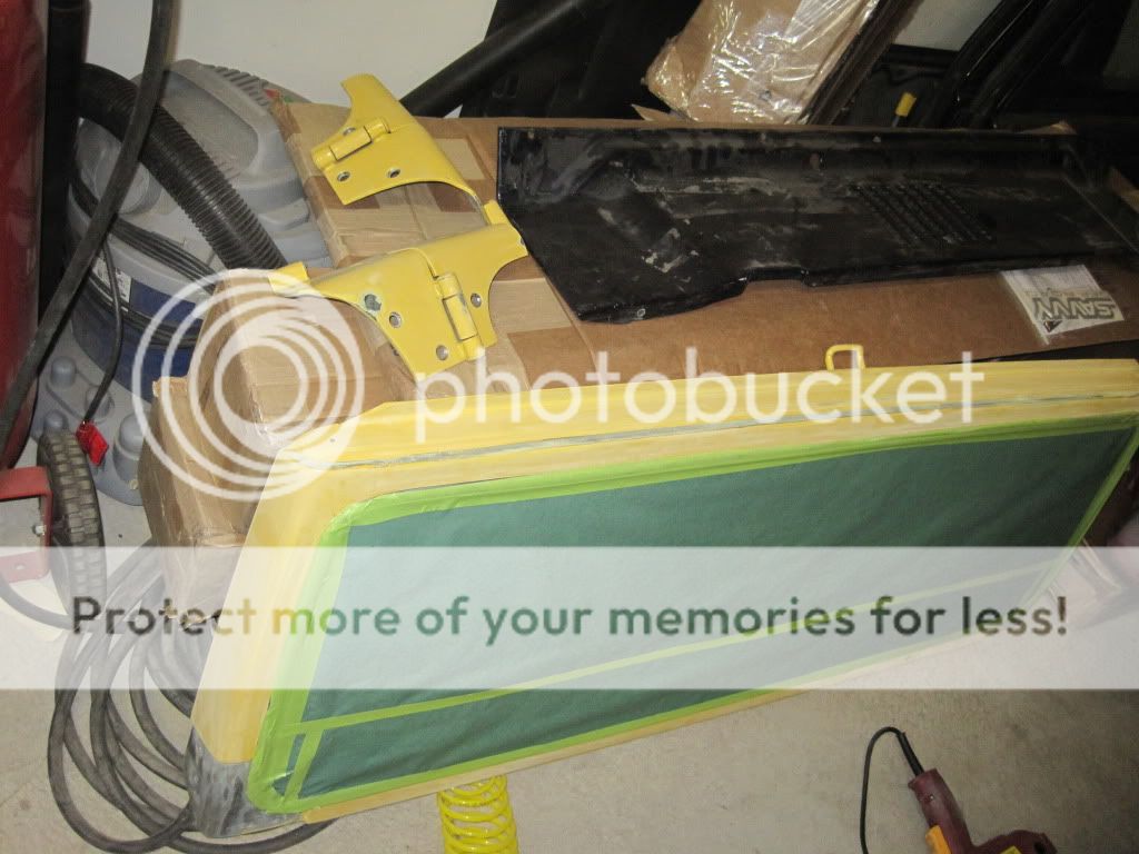

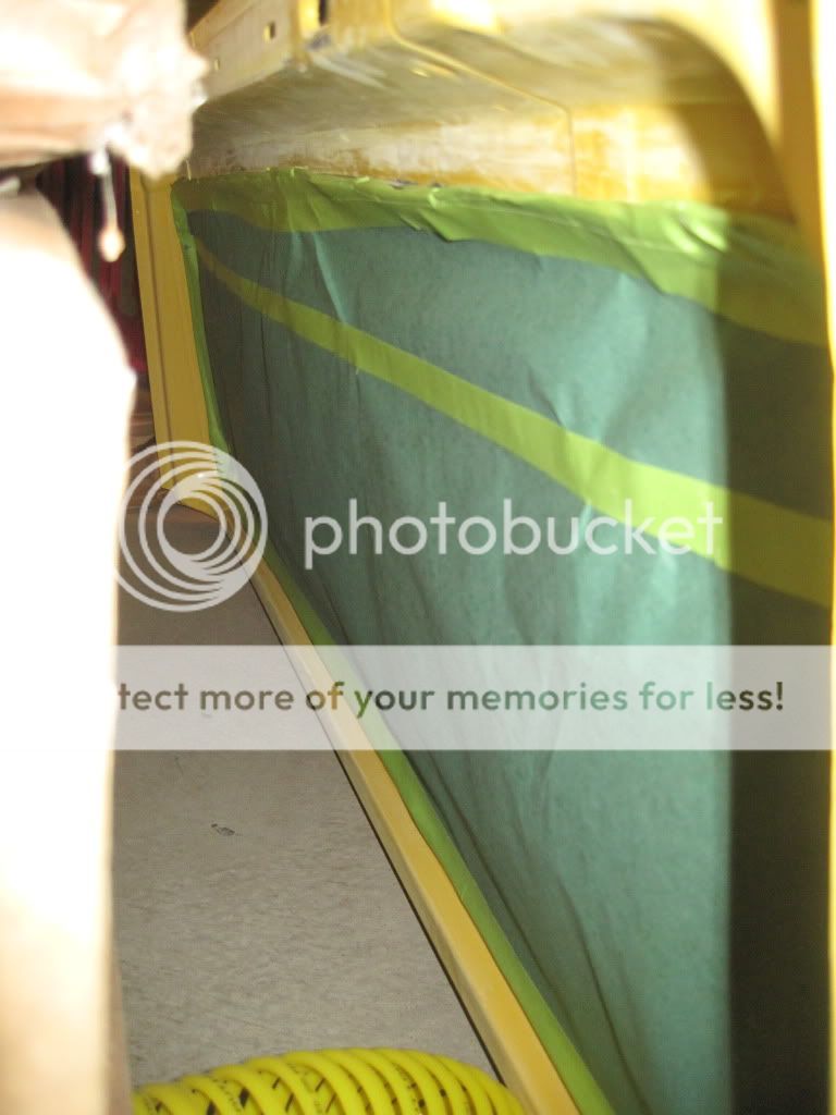

Okay got the doors stripped out today and ready for paint. I also got the fenders and hood prepped for paint. Man, prepping doors are hard work! Had to take the entire door apart latches, door locks, windows, interior etc... Still have the grill to strip, and windshield frame to get ready.

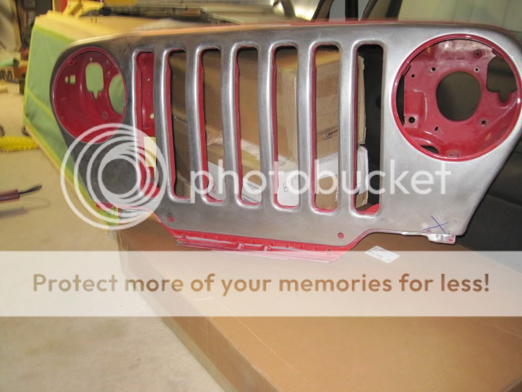

The grill has been stripped and sanded so there are no rust spots and rock chips in the front.

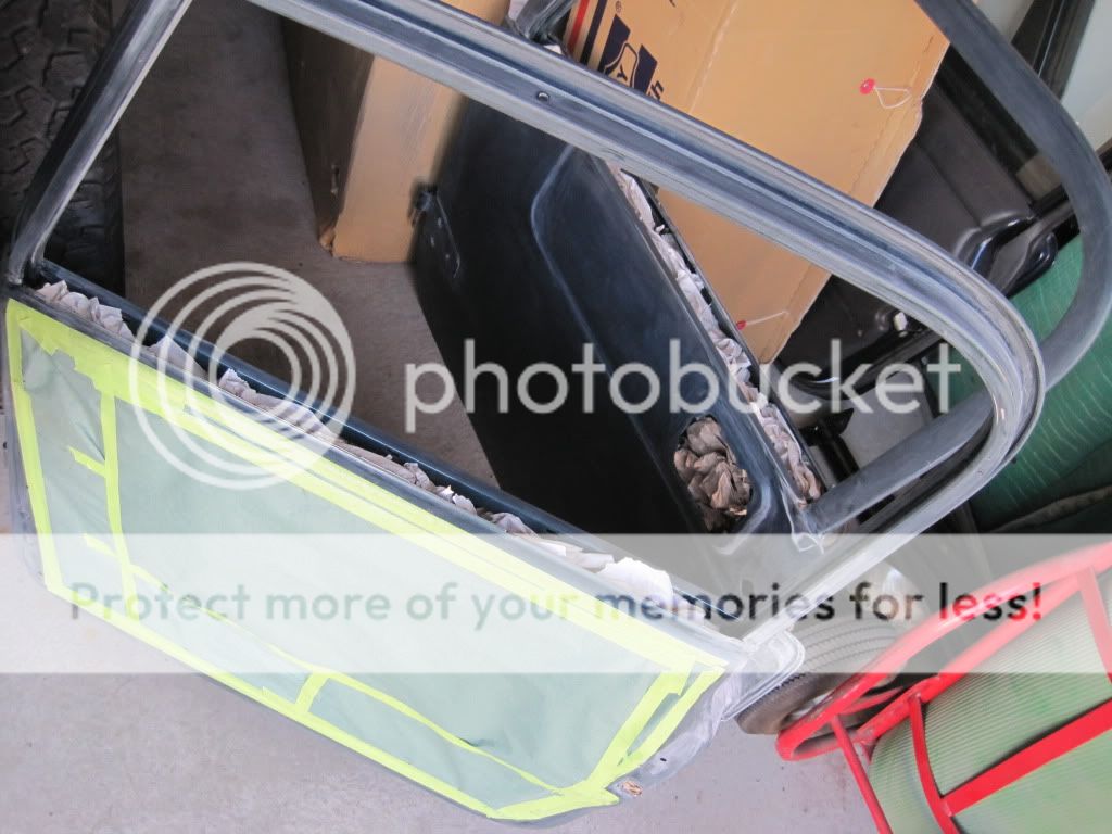

The windshield frame had to be prepped and since there was a glass in it you have to find a way to lift the moulding up so that paint can make it underneath it. What I did was use some wire and fished all the way around so that it lifts the moulding up. Then I sanded around the glass as close to the edge as possible. You can also use a tape that had a plastic edge to lift up the moulding as well. Here is what I ended up with.

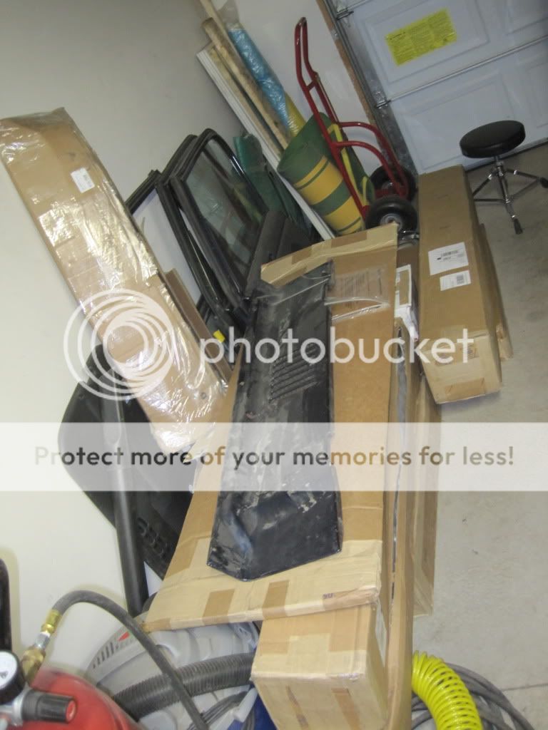

I also have tons of boxes from Gerald for the next part of the build once we get the jeep back together. I will install the BL and MML while the Jeep is mostly apart because its accessible this way.
