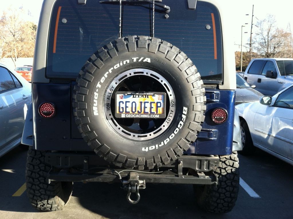

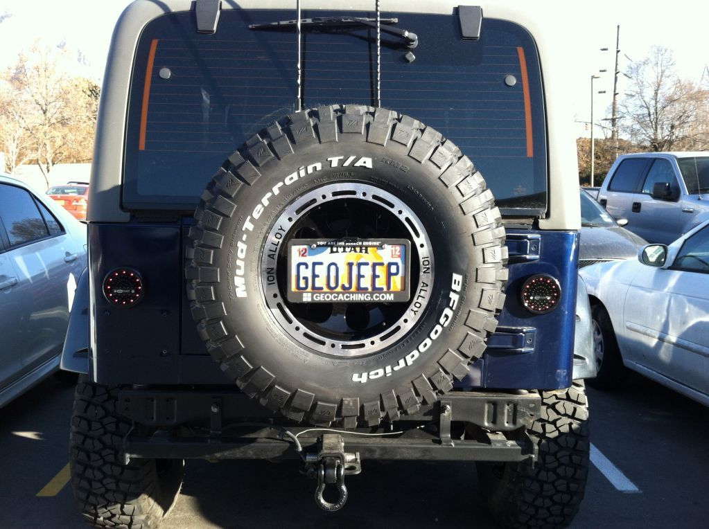

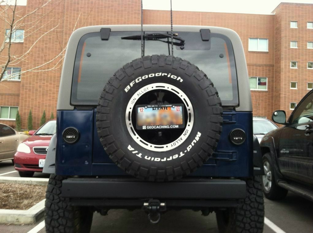

Today I re-painted my stock bumper to hid the rust that was building up on the ends. I'm not sure why but its a pretty common place for TJ's to rust. I used Rush-olem Spray on truck bed coating. I also painted my hidden hitch tow receiver
Before:
I also got a matching rim and 33" spare.
Heres a picture of the of the new matching spare with the bumper painted. Its an ION 174 rim with a 305/70 r16 KM2 Tire. I'M really happy with how the painting turned out I just need to get a tire carrier or a bracket so that the tire is high enough to put the rear bumper top part back on.
That was the good part of the upgrades today and now the not so good part.

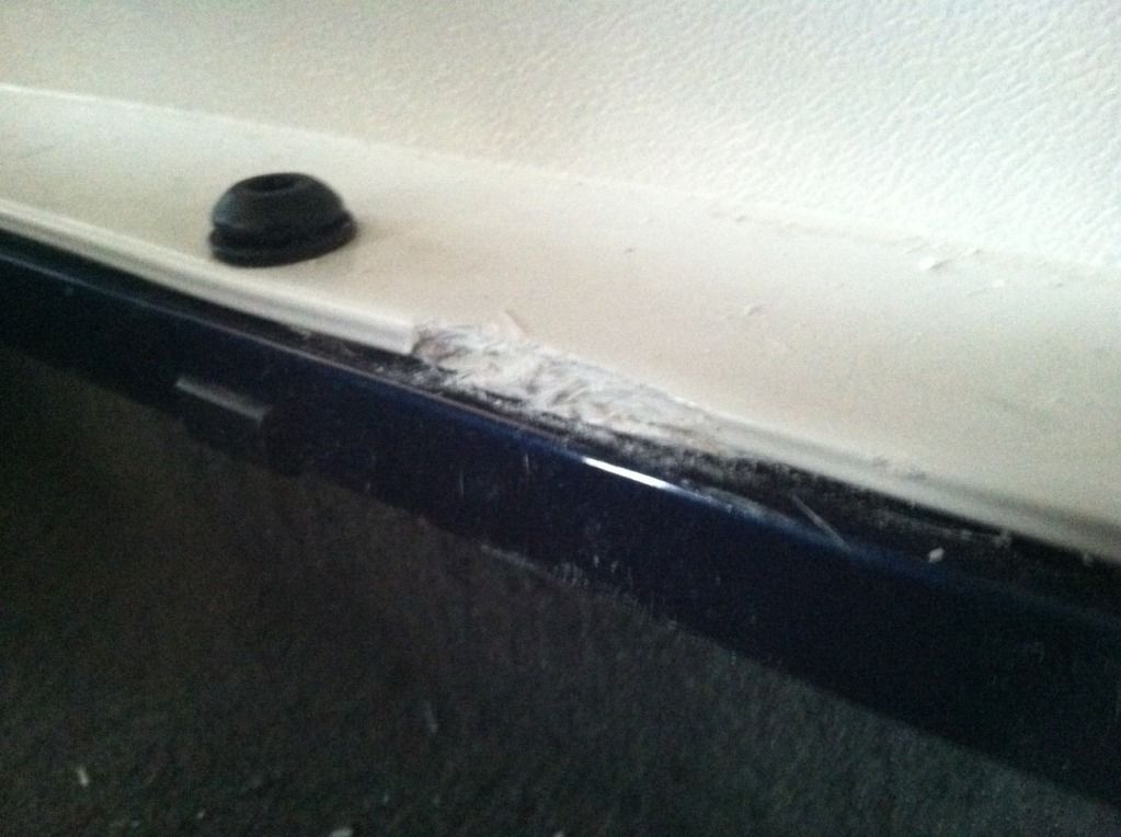

On my way to get my new spare mounted, my rim took a tumble when I turned and took a little chunk out of my hardtop . I'M just luckly that it didnt hit the window!

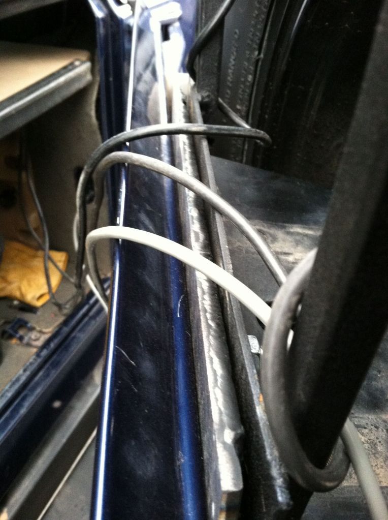

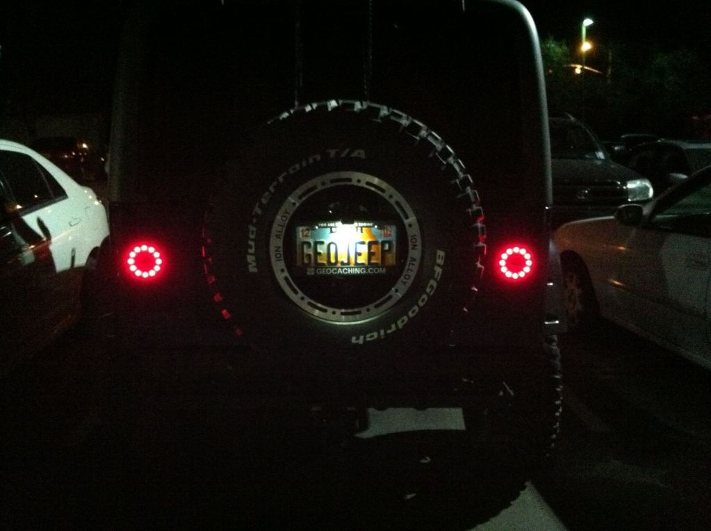

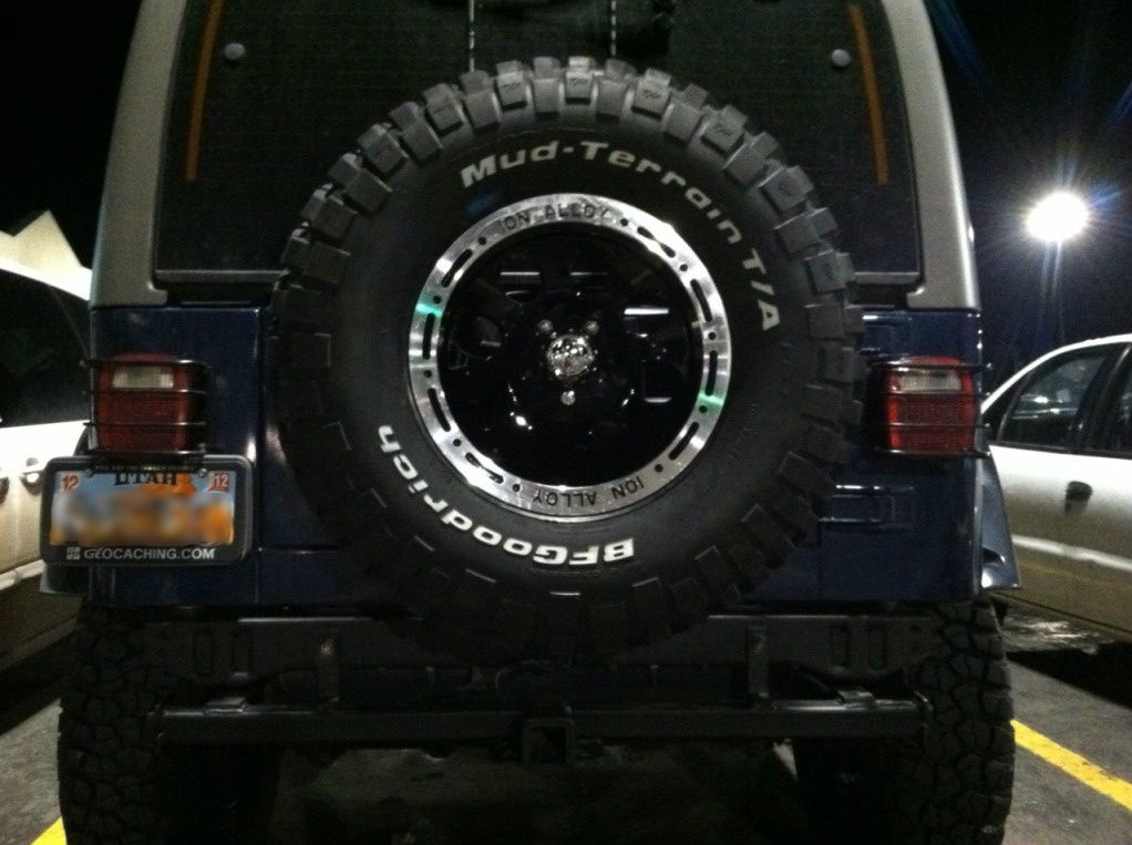

I saw a TJ on here a little while ago with the ORO LED taillights and i was instantly in love with them! the only problem was the price:/ I was looking through the classifieds on here the other weekend and I found a set of the ORO LED tail lights that included the licence plate relocation bracket to the spare tire and the license plate LED third brake light and night plate running light. I sent the guy an email and boom they were sent out to me monday through USPS. I couldnt wait for them to come in and I even had the old lights all the way out wires cut and ready before the LED ones even came in. haha
Well the day finally came and the mail arrived. I opened up the box and what do you know the seller even included the LED Flasher relay for free that is necessary to remove the "fast flash" that occurs because the LED light draw such little power that the Jeep thinks that the original bulbs are burned out.
I started the install and everything went just as planned.
I had to cut the original light wires and then then splice in the new LED wires according to the color chart.
I got the new lights all in and I love the black look they have to them.
The lights have 4 functions night running lights red circle around the out side, brake solid red, turn signal solid red flash, and reverse bottom half white.
Night Running lights.
Day Running lights
Day Brake lights
With them all installed and ready to go the only last thing was replacing the flasher relay. After finally finding it under the top cover of the steering wheel I was good to go! and fast flash was all gone! THe longest part was probably finding this relay haha

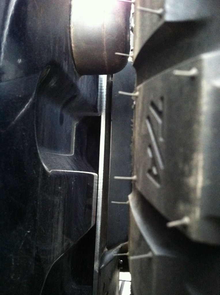

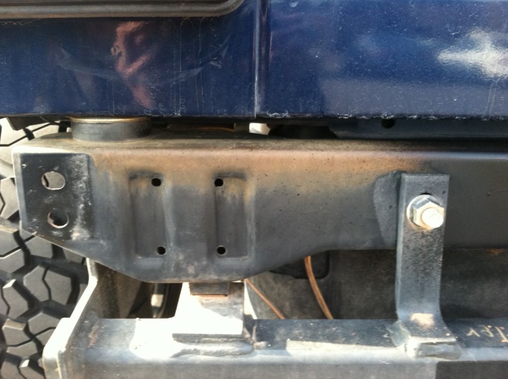

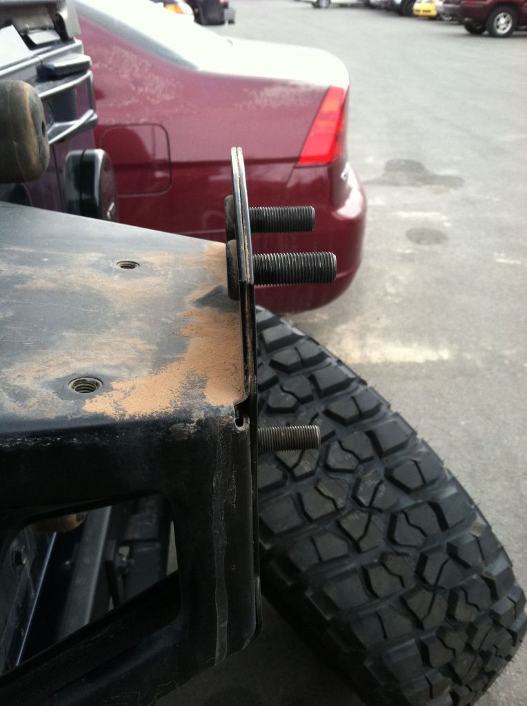

Today I finished fabricating and welding up my new tire carrier idea. With my 33X12/50 matching spare tire on the stock carrier it came down to far to fit the bumper back on as well. I looked online and found lots of different bracket adapters to fit a larger spare but they all brought the tire out as well as up and with my stock hinges I didnt want to put any more pressure on them my moving the tire out, so I wanted to find a way to move it only up and not out at all. (yes I will get a tire carrier in the future but while im in school I dont have enough to afford one yet ) Here is what I came up with. I took a 10.5" X 16" 3/8" sheet of steel and drilled 4 holes for the stock tire carrier bolts to go threw and old it to the tail gate in the stock carrier holes. I mounted the plate flus to the button of the tailgate then took the original tire carrier and raised it to the top of the 16" plate and welded a bead at the top and at the button, all done! It looks great and fit perfectly!
The stock carrier before
Here is the top bead weld with my CB antenna mount that still bolts threw the carrier.
You can see the flat steel sheet with the stock carrier against it.
Here is the about 1/4"-1/2" space between the bottom of the tire and the bumper.
And now here it is all said and done! It looks great and I would highly recommend it to any one who needs to mount a larger spare with out putting any more pressure on the stock tailgate hinges.

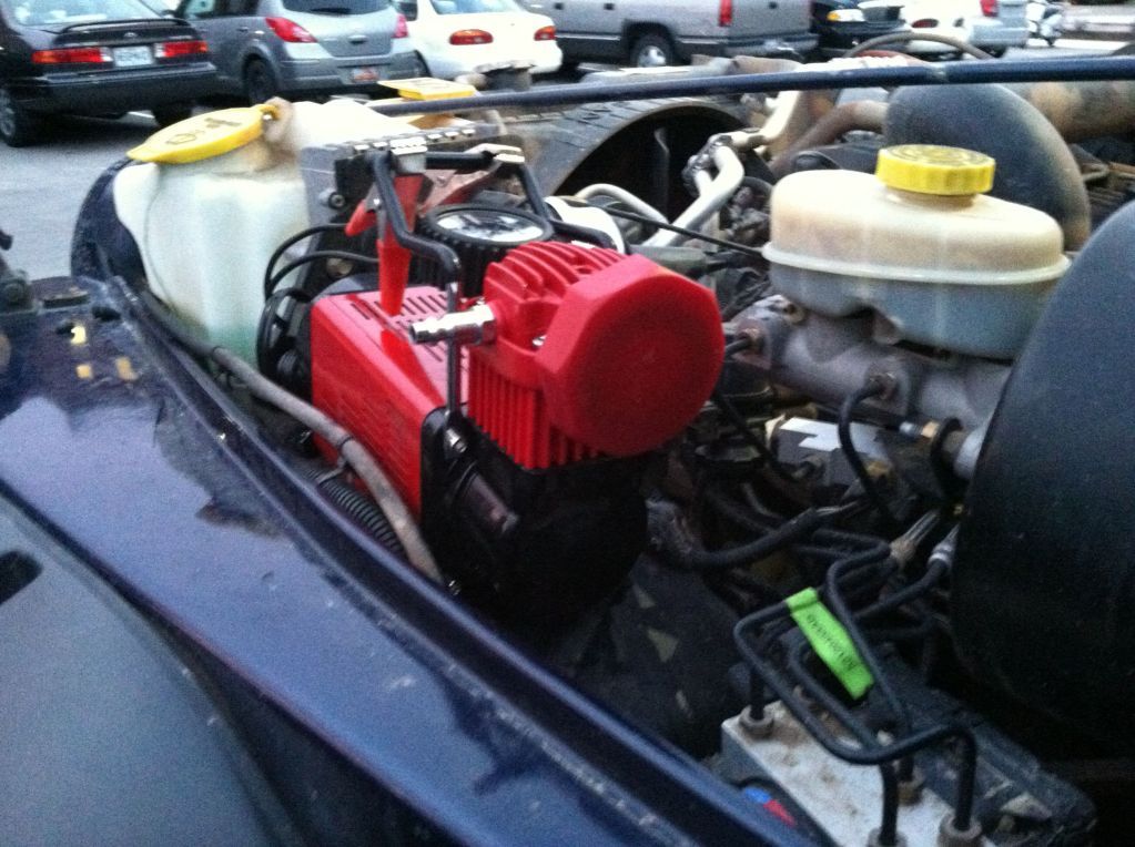

Operation Air compressor!
After having to wait forever to fill one tire after running a trail and then having to nag air off of everyone else I decided it was finally time to upgrade my own compressor.
After hours and hours of research I concluded that the best compressor for the money was the Superflow MV50 by Q industries. I was able to find it instock at o-riley's and went and picked it up.
Because I have ABS I was unable to mount the compressor in the ABS tray but I was able to get it to fit by moving it up towards the grille a bit.
I mounted the compressor with one of the bolts form the windshield washer fluid bracket and then drilled some more screws threw the other feet holes.
I will hardwire the power cord tomorrow to the battery but for now I have the alligator clips held onto the compressor handel to keep then in place.
I also upgrade the tire stem connector from the twist-on to an air chuck to help make it faster and easier.
Over all I am very impressed with the compressor and the installation so far and I will find out tomorrow how well it really works on the trail
