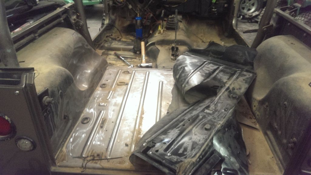

The PO left this crap in my TJ for me to deal with:
What is that exactly? It's spray-in bedliner. Why is it on the floor? Because the 'tarded PO didn't know how to properly prep a surface for paint. It was also WAY too thick, and when it failed to adhere to the floor board of the jeep, it became a rubber mat. I never noticed it because it was all one solid peice and was held to the floor by everything that was bolted to it. Well, this past week I went to install an aftermarket cage, new seats, and new center console, so out came the stock stuff. Unfortunately for me, so did the bedliner...
The liner on the tailgate came off in a single sheet:
Apparently some people think a grinder works the same as a sander. Those people are morons.
It's a good thing I know how to do a QUALITY bedliner job. Sanded it down with 180 grit paper, scotch brighted the areas I couldn't hit with the sander, and then washed it with pre-cleaner several times.

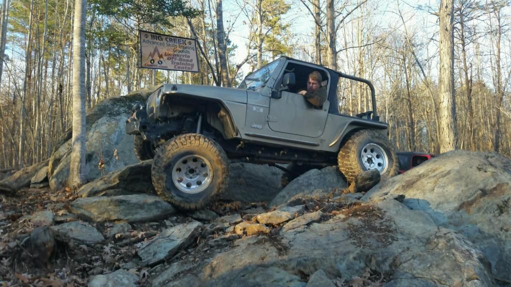

kyle_craig
Posts: 2,748
So do you recall the specs on those wheels (width/backspacing)? And what size wheel spacers were you running? That stance looked sweet!!
kyle_craig is offline
post #747 of 748 Old 02-14-2015, 03:50 PM Thread Starter
Jankoid
Location: Albemarle
Posts: 4,897
17x9, 4.5" backspacing, and 1.5" spacers. Those were 37x13.50 Pitbulls, though they were more like a 35x13.50.
Jankoid is offline
post #748 of 748 Old 02-14-2015, 04:06 PM
kyle_craig
Posts: 2,748
Good to know. I just scooped up some Classic IIs with the same dimensions. I think 1.5" wheel spacers will be the ticket. Thank you for the quick response!!
