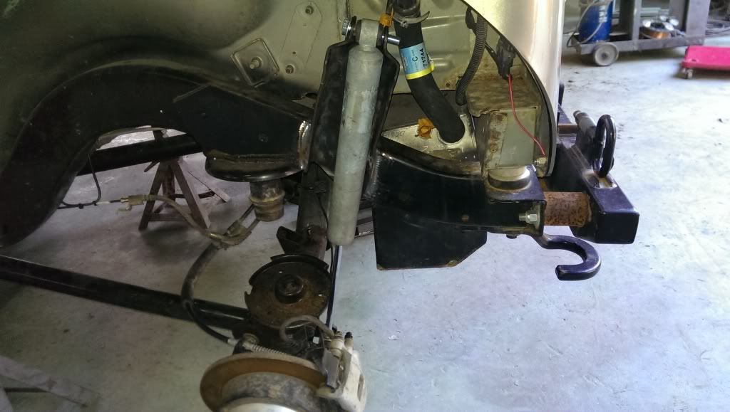

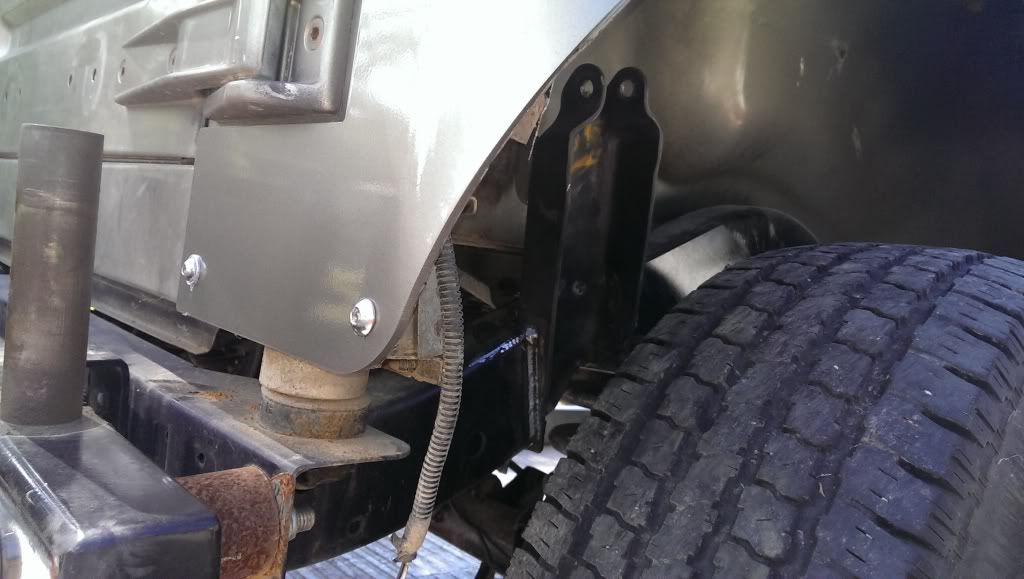

What's different?
Jankoid is offline
post #576 of 748 Old 09-05-2013, 02:02 PM
tyvanwie
Location: Boone
Posts: 9,872
Shock mount..?
tyvanwie is offline
post #577 of 748 Old 09-05-2013, 02:30 PM Thread Starter
Jankoid
Location: Albemarle
Posts: 4,897
Yep, finally got around to outboarding the shocks. Want very hard, just time consuming. Was pretty much the same process as the stretch coil buckets.

post #579 of 748 Old 09-05-2013, 03:20 PM Thread Starter
Jankoid
Location: Albemarle
Posts: 4,897
Originally Posted by Dash View Post
Nice welds.
Thanks, I can't take credit for them though. My dad has a good friend who is a professional welder, so I've been having him do most of the welding on this jeep. They are beautiful welds, and there is no chance in hell they will fail.

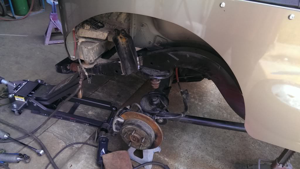

Reinstalled gas tank today (removed it for safety when cutting out the shock towers). Extended the hard brake line so I could hook up the brakes to the rear axle, then bleed the brakes.
To do list:
Cycle rear suspension again (tomorrow)
Finish shocks
Set rear ride height
Gear oil in diffs
Rear driveshaft
Torque all bolts
Sway bars font and rear
Paint and install sliders
Tie down battery
Switch MTZs over from LJ
Etc?
Really not much left, outboarding the shocks was the last big project. I'm probably going to gulches next weekend, so if I get everything finished I might take this instead of the LJ. We'll see.

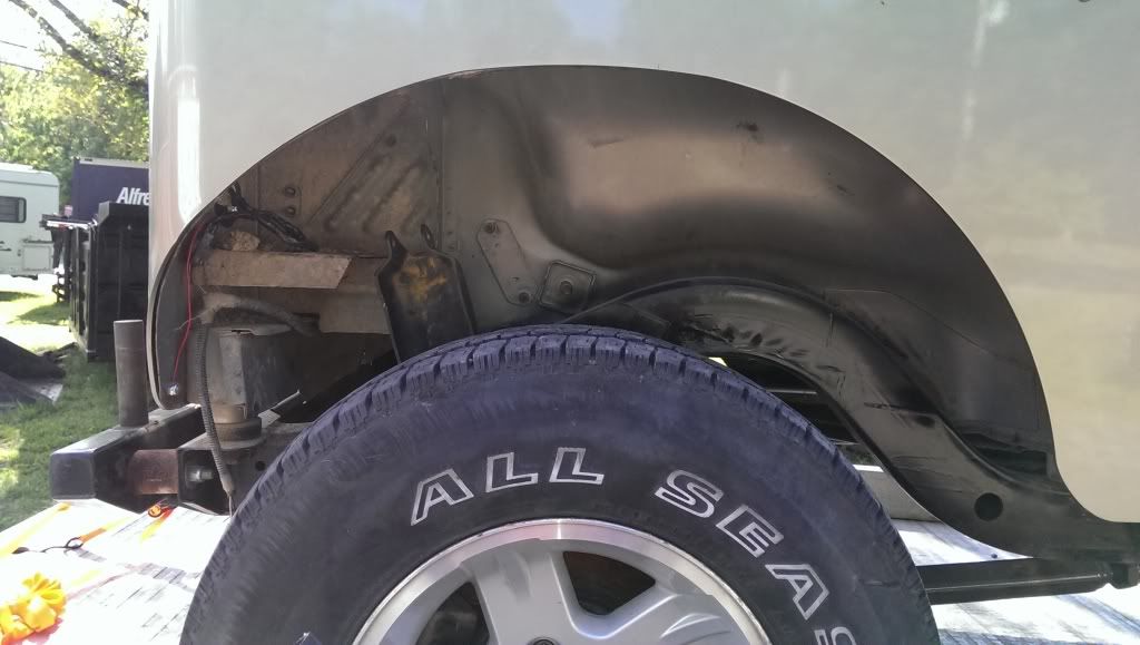

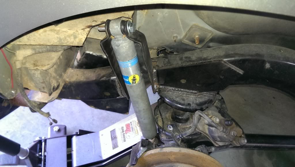

Cycled the suspension today for what should be the last time to check shock clearances. The passenger side is perfect, no contact at any point through the full cycle.
The driver side contacts the back of the shock tower at full droop, but only when the passenger side is at full stuff. It just barely kisses it, so I think I can grind a little material away and it will be fine. I don't think it will ever hit hard enough to matter. An extra half inch of bumpstop on the passenger side will fix it if it does become a problem.
