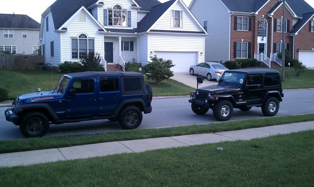

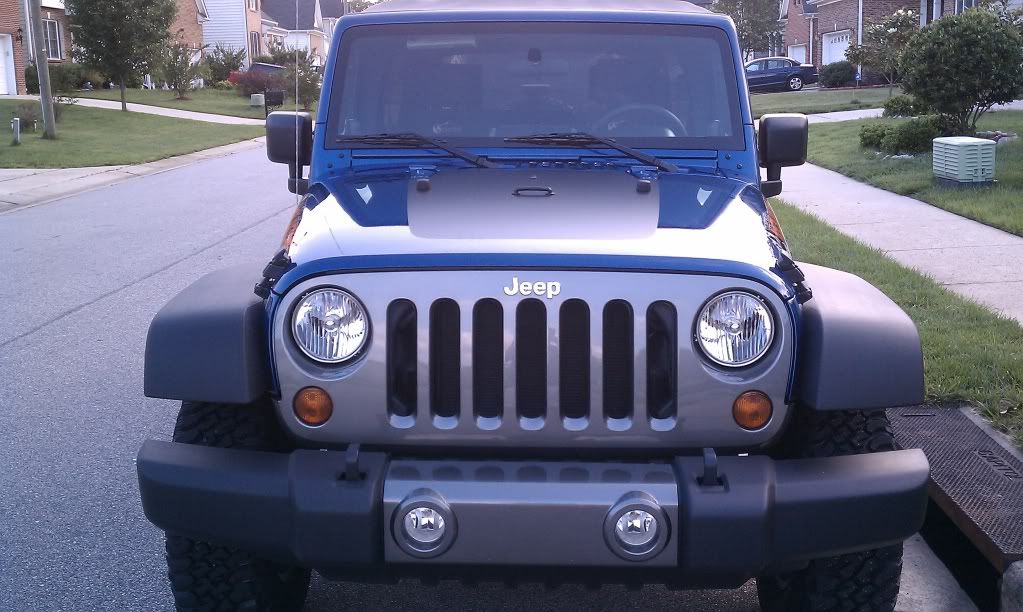

But that's not all.... The biggest news is that, well, my wife decided she wanted a jeep, so we added this to family!
I don't think we are going to do too much to the JK for the time being. We have our hands full between the TJ and the Bronco.

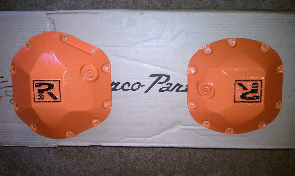

Well I didn't get as much done yesterday as I wanted to. The in-laws came down to spend Memorial Day with the wife and I so I was on grill duty. Anyways, I did get the differential guards painted, yesterday, and then hand painted the Riddler Logo with some black touch up paint. I decided to go with an orange colored Rustoleum gloss enamel. It is pretty close to impact orange (my favorite cooler!). I prepped with Acetone and then self etching primer.
The results! Painted Riddler D44 and D30 differential covers:

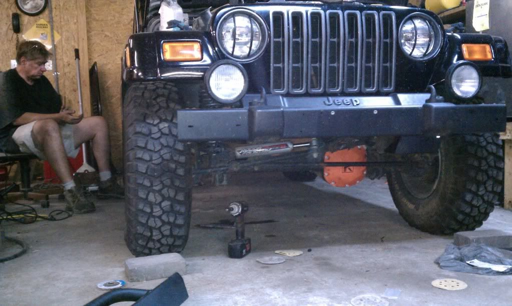

Well it's been a long day, and I still haven't finished getting everything on... While my buddy and I were getting ready to put on the differential guards my buddy noticed that theere was some fluid leaking out of my passenger side rear drum break. So I took it appart and noticed it was leaking break fluid out of the cylinder. Fixed that, then went on my way installing the dif covers. Installation went pretty fast, and over all I'd say it was a fairly easy and a painless installation.
So while I was waiting for the RTV to dry I went ahead and started preping for the rocker guard installation. First I removed the little factory side steps, and then started to remove the Sahara plastic cladding crap.....That's when I started running into problems. First the screws just kept spinning, so they had to be removed with a cut off wheel. The I came to the sad realization that the stupid things are held on by this stupid rail that is riveted to the dang jeep. What makes it even MORE fun to remove is the fact that the rivets are facing the wrong way which makes drilling them out even more of a PITA. After the first 3 (out of 7 total per side) we got a system worked out and instead of spening 15 minutes per rivert we got it down to aobut 5. Anyways, after we got all the rivets out on the passenger side mounting the actual rocker guard was easy. It was getting late so we didn't start on the driver side tonight. So all in all......I hate the Sahara cladding. If anyone wants to buy it (or my stock side steps) let me know....
