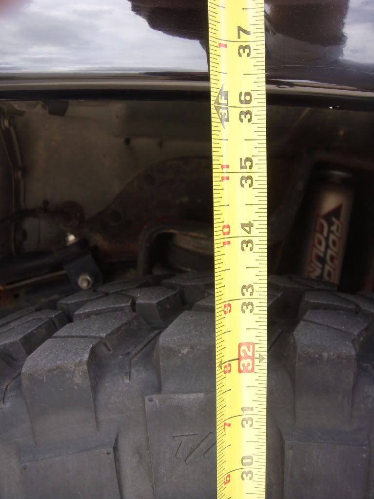

I've been very pleased with it, and for the price you can't beat it. I went out and measured, and have had almost no settling of the springs. It was may 1/4" off of where it was the day I put it on. I added a pic you can compare to my original measurements (front).

Jeep looks good, how tall your tires actually measure?
They are a little over 32" but not quite 32.5" would be my guess.

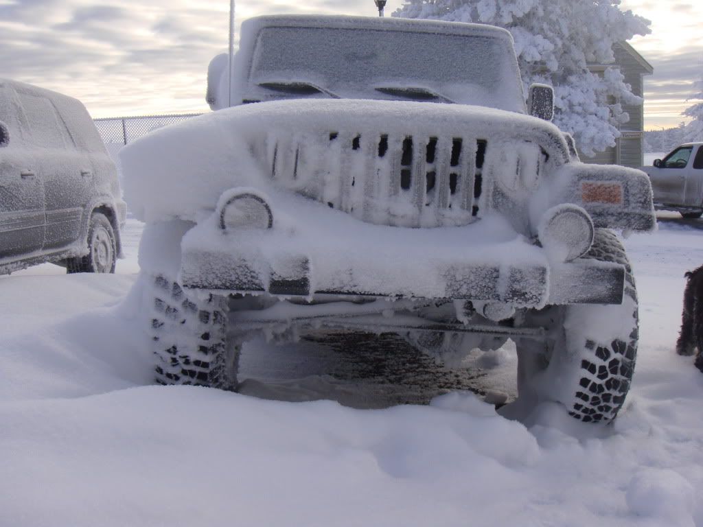

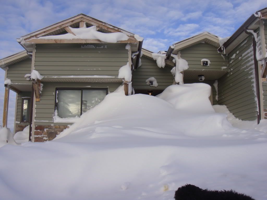

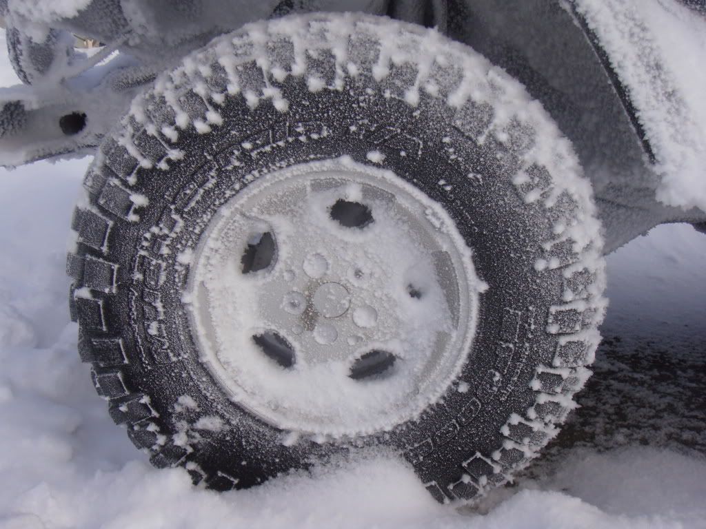

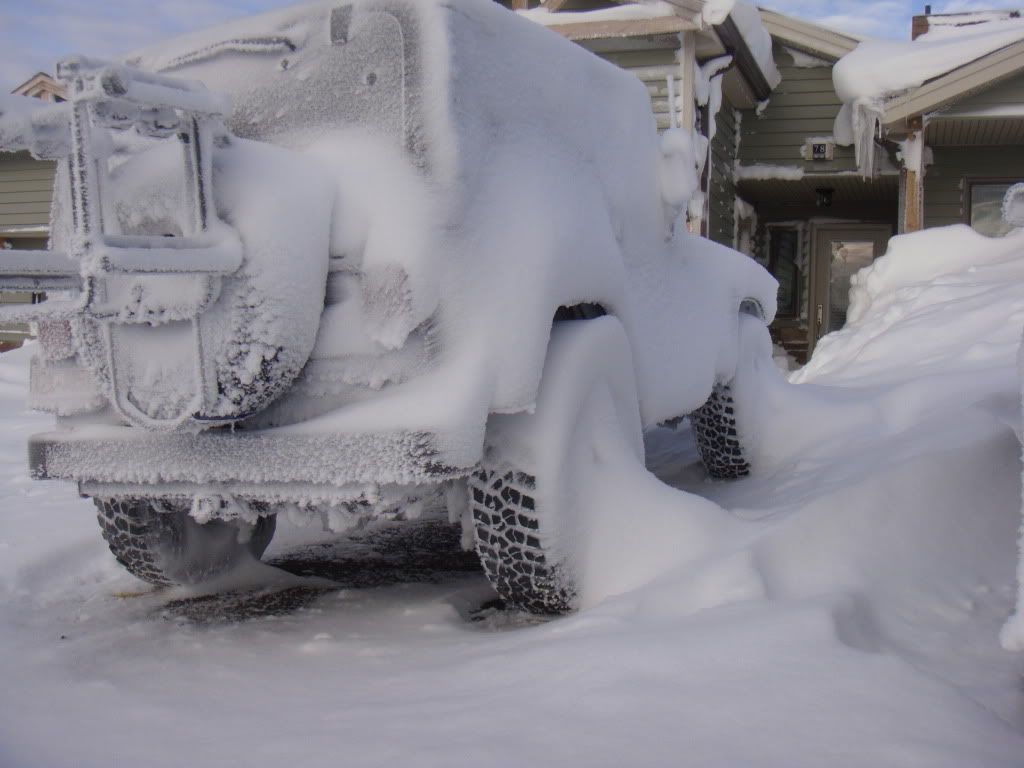

I also figured since I haven't posted them here I'd show off some of my pictures from when I took the jeep to Snowshoe, WV the first week of January for some snowboarding. We got close to 2' of snow while there, and the jeep ate it up!!!
HUGE snow drift
Out driving!

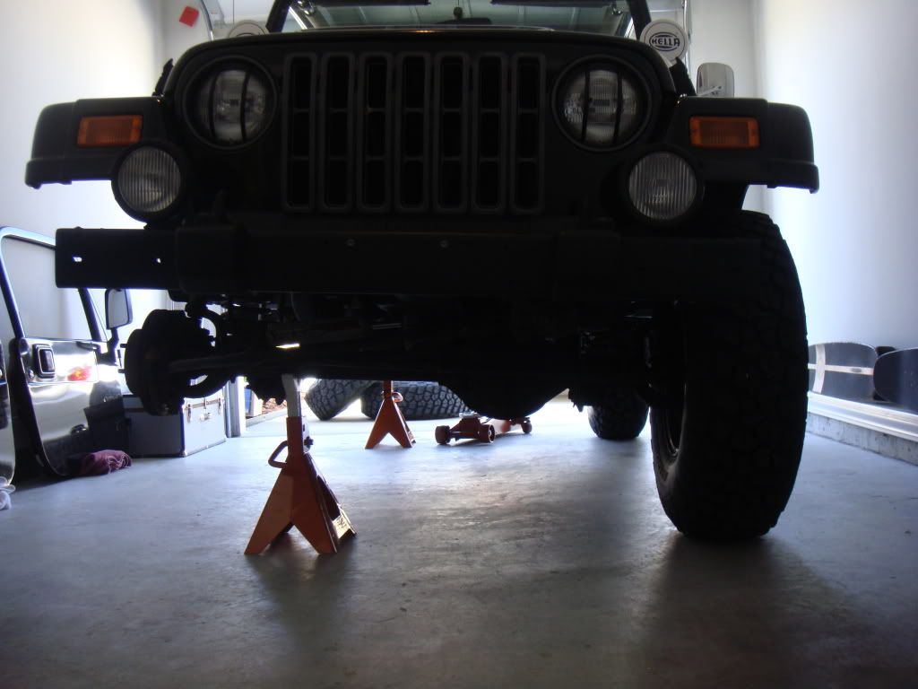

Well since the last update I've removed the rear milk jugs, rotated my tires with my new 3 ton floor jack and 6 ton jack stands, and removed my transfer case drop kit.
The new toys in action!
When I installed my lift last year I knew I wouldn't have access to the tools I needed to install the t-case drop kit back at my apartment, so I went ahead and installed it prior to testing it for death wobble. So this whole time I've had and not really know if I needed it. I decided since I now have a floor jack to make things easier I'd go ahead and remove the drop kit and see what happens! The only problem was when I installed the drop kit I left the bolts with my buddy (who lives on the other side of the state), and that was close to a year ago, so finding the bolts would be challenging to say the least.
Since the bolts with the drop kit won't work, I went out to Home Depot and bought six grade 8 1/2" (with 13 threads per inch) bolts and six grade 8 1/2" washers. The removal of the drop kit went fine and you can see the new hardware below:
The only problem was once I took the jeep out for a spin I started to notice some vibrations So its back to Home Depot tomorrow to buy some more washers in the hopes that I can stack a few and eliminate the vibrations without sacrificing as much ground clearance.

Well I got the washers and installed them. Unfortunately I still had vibes after using 4 washers per t-case bolt. This was roughly half the height of the t-case drop kit. So I went ahead and just put the drop kit back in.
