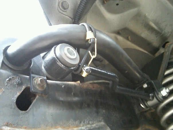

So we spent another 2hrs on the rear and unfortunately realized that the torx bit set my buddy had didn't go all the way to t55, so we had to stop the installation. We have everything else removed and ready to go so we should be able to get everything finished in another 1.5hrs to 2hrs MAX im hoping. Once I get some free time I throw up those pictures of the front install as promised, but right now I gotta go get my tires mounted and balanced!!!

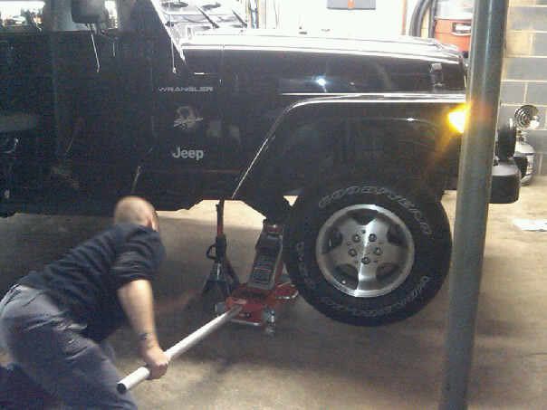

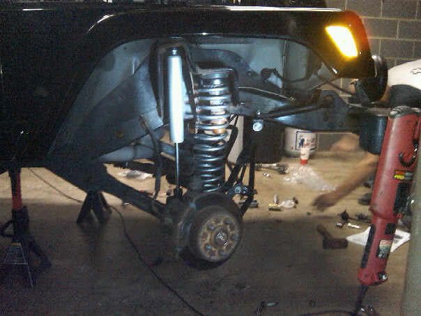

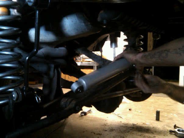

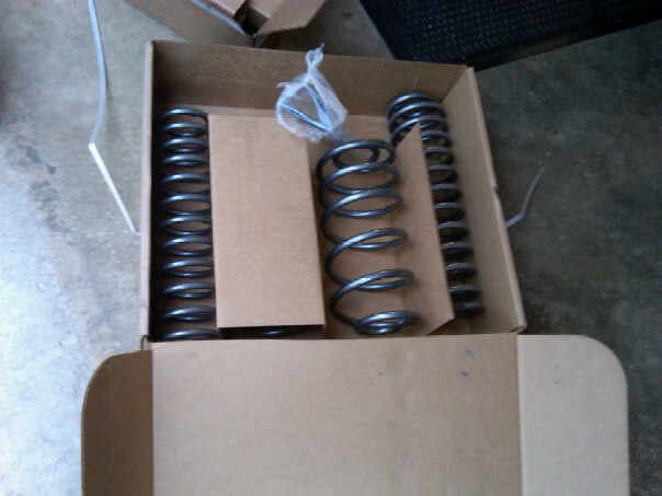

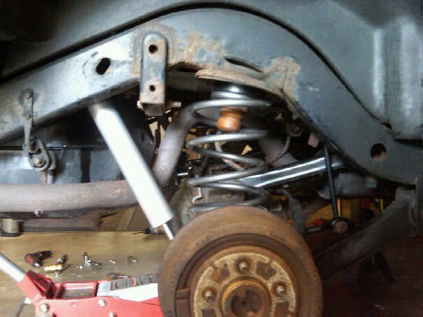

So here are some photos from last night taken by Muddy99JP. Thanks buddy!
The new springs, fresh out of the box!
Old rear springs with new rear springs
Here we go!
One side finished!

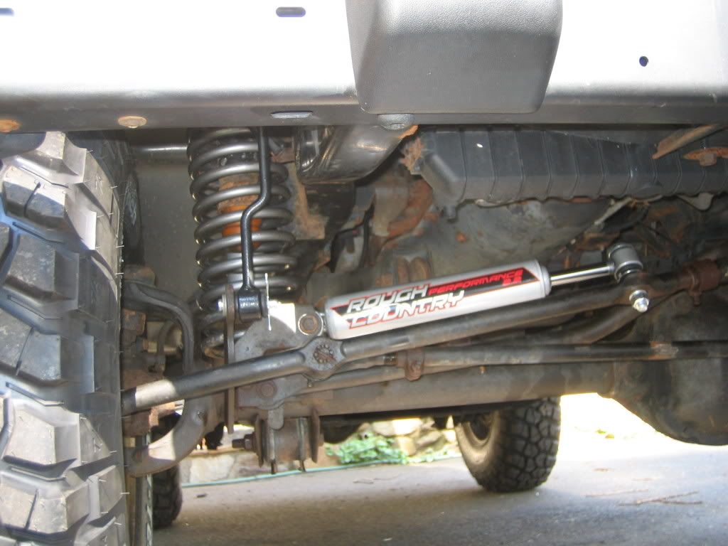

Putting in the steering stabilizer...

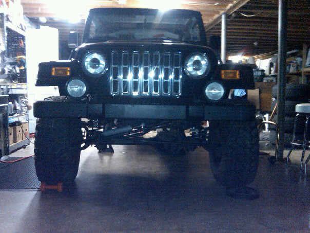

Front end DONE.
The rear is still on jack stands, so the front end is a little higher than it will be. These are my buddies 33x12.50, he is letting me borrow until I get my tires mounted.
We should be starting to work on finishing up the rear in the next 30mins! I'll post more photos once we are finished, as well as the ending measurements....

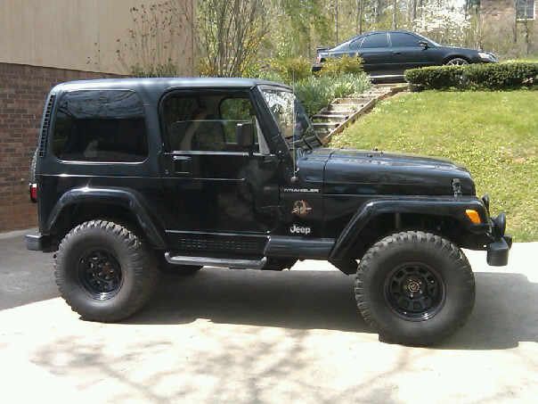

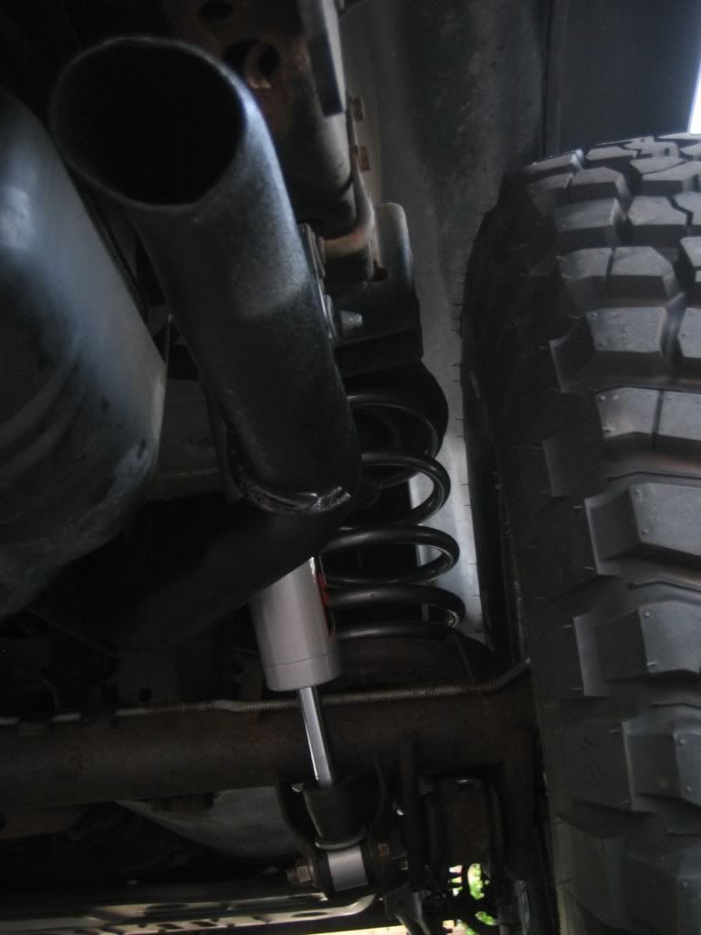

DONE! With this project, but by no means customizing my TJ. I'm going to need to stop all the major upgrades until after I get married (Aug. 8th), but I still plan on working on some more of the rust, and maybe smaller things like roll bar grab handles, etc.... Anyways, now the new pics!
One side done on the rear....

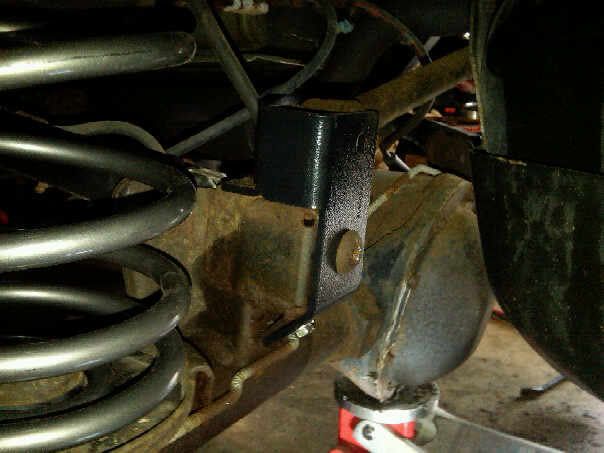

new rear track bar relocator(and the dumb t55 torx bit bolt that kept us from finishing in one night!)
New height in front and rear = 4"

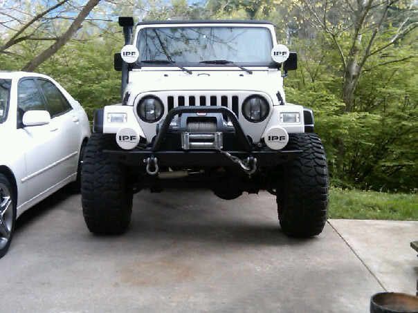

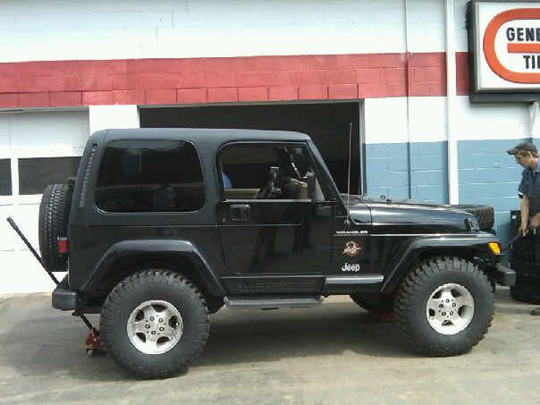

Here it is with my buddies wheels/tires while mine were getting mounted: pro comp MT 33"x12.50. Now that I've seen my jeep with 12.50's I want a set of those too!
At the tire shop getting my BFG MT Km2 33x10.50's on. Too bad I didn't have enough money to get some new wheels too. They rub just a bit when in full turn. Darn 5.5 backspacing

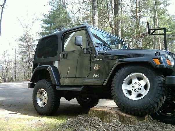

RC 3.25" Test Flex
So I had to try out my new sway bar quick discos(which are awesome and work great by the way), and of course I figured I share some pictures!
Due to being pressed for time I didn't hit any trails, just a stump outside my garage! Hopefully soon I can put it to the real test!
Sway bar on
sway bar off...
On the stump
another angle
and one more, the tire is all nice and tucked up in the fender with no rubbing

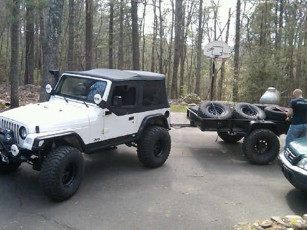

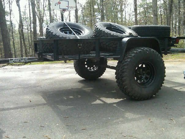

And finally, I couldn't help but love my buddies jeep and lifted trailer with 33x12.50 Pr Comp MT's on it. He has a 4.5" BDS SL with 35x12.50 Mickey Thompson Baja Claws, front and rear ARB air lockers, new front and rear warn bumpers and warn rocker guards, safari snorkel, round LED tail lights, and the list goes on. Something to strive for. I couldn't have done it without him and his awesome collection of tools!

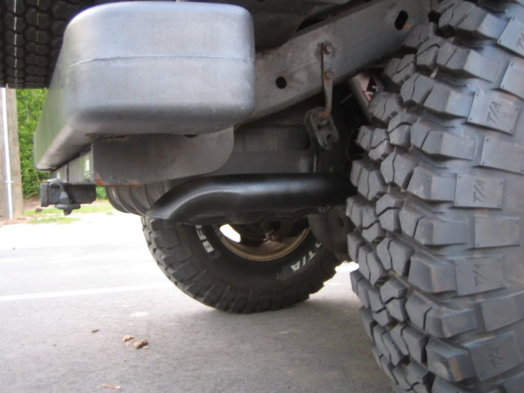

Painted Tailpipe
Now I know this is by no means a performance mod, but since I've spent a good bit of money on new parts for my jeep recently and I HATE the look of rust i decided to paint my tailpipe black.
Total cost of mod: $4 and some change......
Total time: 45mins
First I took some 150grit sandpaper and spent a good bit of time removing all the lose rust and carbon from the tailpip. I then wiped it down to remove all the rust dust. I taped everything off with newspaper, and covered the shocks and springs with tin foil(saw it in another thread and worked great).
Then I used Krylon high heat black paint (for temps up to 1200F) and sprayed a nice coat.
