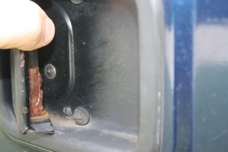

-Outside latch on driver's door is showing some of the worst rust on the vehicle. Works fine, but probably a future maintenance task.

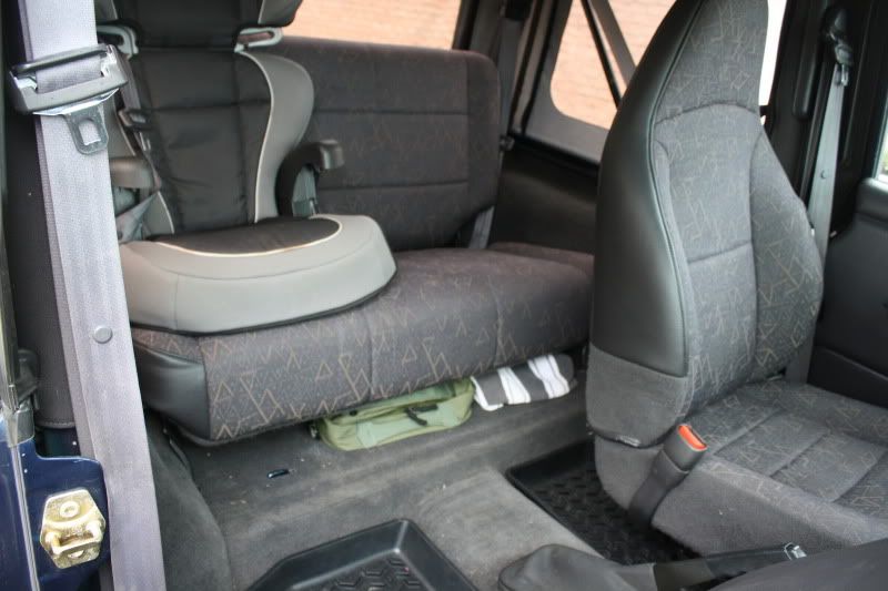

I threw a booster seat in the back for my man cub.

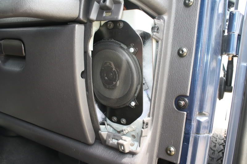

Next I ordered a Kenwood HU and 5.25 speakers to replace the front pair. I picked up a pair of adapters off ebay for the speakers. Crutchfield was my source for the stereo parts and with the assistance of their guides and install kits, it went in without a hitch. I’ll be replacing the sound bar speakers as well. I am undecided on what size at this point. A few weeks after I installed the front speakers, I opened up the dash again to stuff in some polyfill in hopes of improving the sound quality. At that time, I noticed some surface rust already on the speaker adapters. I pulled them out and gave a quick sanding, then a couple coats of Krylon. Hopefully that will keep the rust at bay on the metal adapters. I sold the stock stereo and speakers on Craigslist. I also found the stock antenna to have a small bend in it. It was an eye sore for me, so I bought a cheap replacement antenna. It is the stubby flexible variety. It works just fine, but I’m not sure I like the looks of it. I may go back to a stiff, metal antenna in the future.

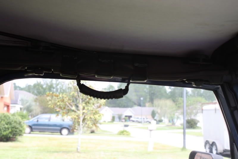

I bought a pair of Smittybuilt grab handles. I don’t remember the model, but it is the three strap variety. They work fine so far.

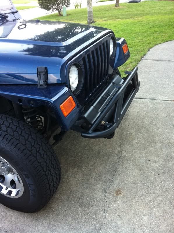

Bought and installed a Daystar 1” body lift. This was interesting. It was definitely my first big automotive project. The instructions and my research said it would be a 2-3 hour install. It took me about three days total. Bare in mind, I was tinkering with a few things and doing it piece meal, but it still took a lot longer than 2-3 hours. Adjusting the radiator fan shroud was the hardest part. I’ll probably add a motor mount lift at a later date. I wish I had picked one up and did it all at once. I used PB Blaster on the bolts and all were removed without any fuss. I used the included hardware (Grade 5), but I plan to order Grade 8 bolts and replace them.
Radiator fan shroud holes:
I removed the sun visors and flipped the rearview mirror.

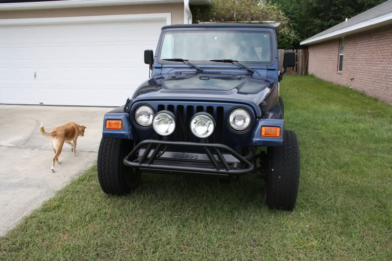

A friend gave me a pair of lights. I assume they are driving or long range lights. They were not marked, chrome, and needed rewiring. The plan was to rewire, spray paint them black and slap ‘em on the bumper. My first mistake was finding the prewired foglight connections, and then cutting off the connectors. My thoughts were since I didn’t have the connectors on the lights, I would just rewire and use some generic connectors. My other mistake was not checking the wattage on the lights. They worked, but were over powered. Something told me to check them, so I pulled them apart and found they had 100w bulbs. I picked up some 55w bulbs and put it all back together. Oh, one more thing. These are huge. Like 7 or 8”. Not sure I like the way they look that big. In retrospect, it would have been much easier to just get some 5” KC foglight replacements and call it good, but these were free and I just had to make ‘em work!
I bought a Trail Gear front bumper for the $80 clearance price. I like the bumper. I had to dremel one of the lower mounting brackets a fraction of an inch as it didn’t quite fit. I tried to sell the old bumper on CL, but no bites. Everyone else must have thought it was a piece of crap also. It was thrown out on the curb… Again, PB blaster on existing bumper bolts and they came out without issue. I installed the new bumper using new grade 8 bolts. Aftermarket tow hooks fit, but the openings of the hooks are blocked due to the vertical bars on the bumper. I’ll be getting D rings for the bumper in the future. A week after install, I found the factory included skid plate bolts are beginning to rust. Looks like I'll need to address that soon.
I mounted my handmedown aux lights to the new bumper.

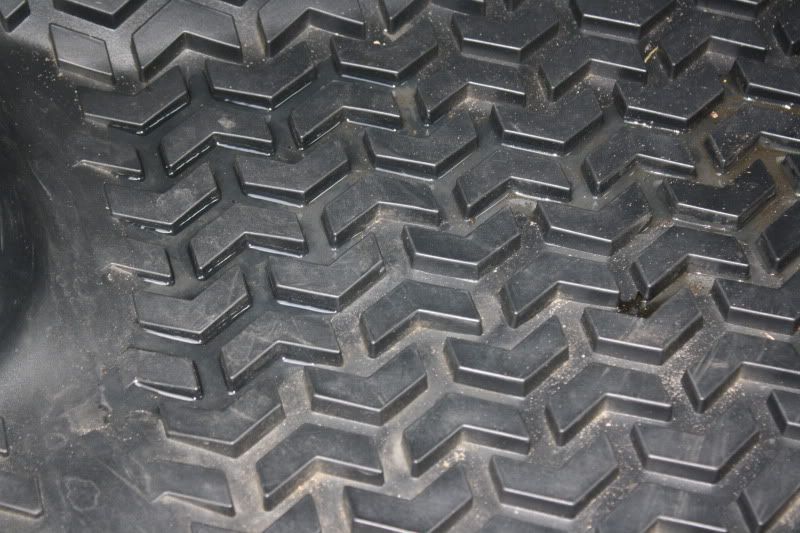

While getting some of the pictures, I noticed water in the new driver's side floor mat. We had heavy rains the other night, so it appears that the leak from the windshield is definitely working its way over to the driver's side and ultimately, the floor board.
Here's the dried drip line on the inside of the windshield:
Here's the water in the floor mat (kinda hard to see):
It's not much water, but I still want to get that issue fixed.

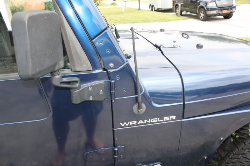

Ordered CB gear for the Cobra III that I have. Firestick FS3, coax, Teraflex tail light mount and SWR meter.

All cb parts have arrived. Antenna is mounted. I had to remove the tail light guards to get a good mating with the Teraflex antenna mount. No big loss. I think I like it better without the guards.
Coax is stretched and zip tied out of sight. I just need to get some wire so I can stretch my power line through the firewall and to the battery. Then I can get her tuned.
