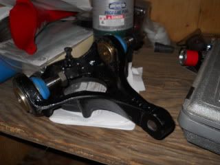

Just wanted to let everyone know a 20 ton shop press (even one from harbor freight) makes life 10x easier. Pressed the ball joints into the second knuckle in under 5 minutes, the first knuckle took me 45 at least trying to find the best method with one of those ball joint press kits.

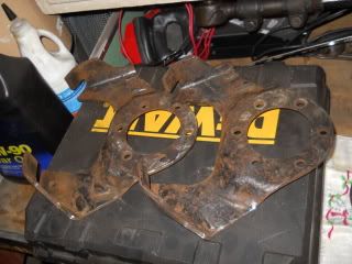

So the other day I cleaned off the caliper brackets. I'm going to run them without the dust shield and hope that everything holds up. I don't see how they can be that beneficial anyway. I will however still look around for new ones with the dust shield still usable.

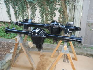

Today I painted the axles and just milled around not really wanting to do anything. They look good, however I didn't get to serious about removing all the weld spatter, just too much work.
Here is a pic of my brothers d60 in rust converter, its getting brush on black rustoluem tomorrow. I'm going to be including some of his stuff into this thread. It will be the tow rig this summer to Rausch Creek so I can go nuts and break something. Last summer I left early because I didn't want to loose the fuel pump again.
Dude, this thing better be done for late june/ early july. Thats usually when NAXJA hols their NAC fest at rausch creek, its gonna be sick.
Axles are looking good as well

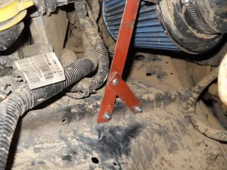

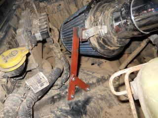

Also made this bracket for my air intake. The old one I had on there was a joke, i don't even know what kind of metal it was made of. found it in the garage and bent it my hand, the filter and tube would literally fall off. not good. So I finally decided to make something and actually fix the problem. Took about 30 minutes and its solid as a rock now, doesn't move in any direction in the least bit.

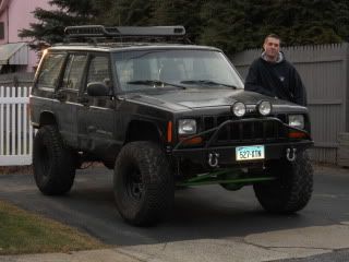

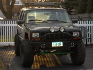

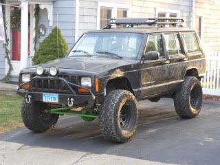

Some current pics of the heep.
and after owning my jeep for about 3 years, here is the first time someone took a picture of me with it, lol

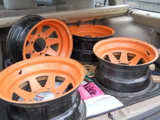

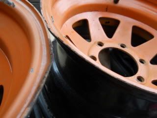

Picked up some new wheels. Cragar 15x8, 6x5.5 lug pattern, 4" bs, painted orange. $75 for all 4.
None are in any worse condition then the wheels I have now.
I don't know if they are cragar or something else, but the guy had the same axle as I'm putting in so I know it will work
