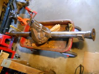

Today's progress.

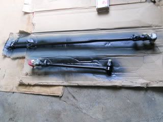

Cleaned off, sanded, and painted the steering with some self etching primer and gloss black rustoleum.

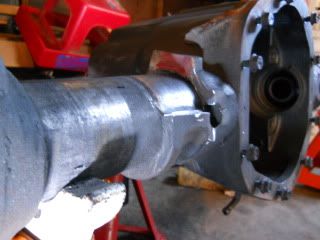

Placed truss on axle to look cool. Tomorrow I will clearance the casting so it sits flat.

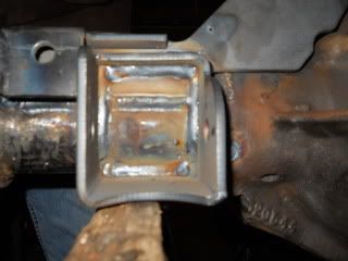

Removed shock mounts and track bar mount from the rear axle and then cleaned it off. I left the spring perches for now but will most likely need to remove them anyway.
I think this axle was set up for an SOA in a yj. I measured from perch to perch on the d44 and it measured 41.5 inches. Then I measured the distance on my Xj and it was 41 inches, For this I measured between the leaf springs because I couldn't measure from perch to perch cleanly, So there could be some error. It could be closer to 41.5in. Maybe I don't need to get new perches after all The only concern would then be pinion angle, but being out of another jeep it might be close to the right angle anyway.

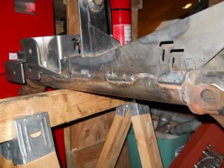

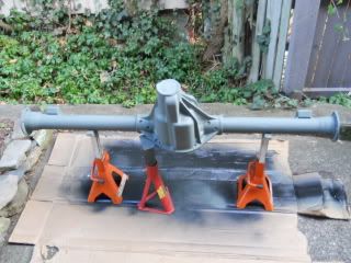

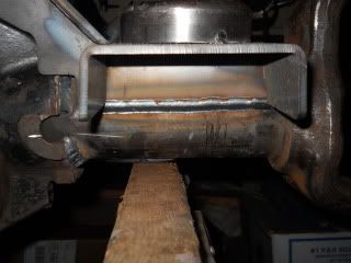

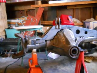

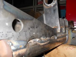

Removed driver side spring perch. Don't have a picture with the bottom cut off too, you can kinda see it in the forth pic.
Now the truss sits mostly flat. The directions say that the truss will warp a little do to heat even though its made in a jig, so the drivers side is still raised off the tube just a little bit. Its supposed to be clamped down starting at the drivers side and moving to the passengers before welding to have it sit right.

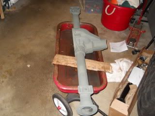

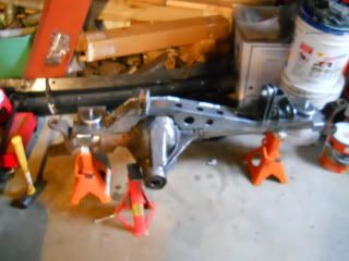

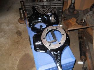

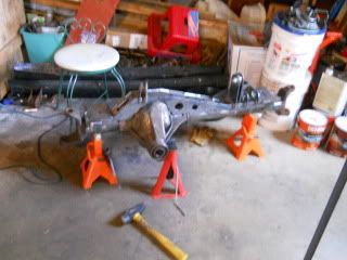

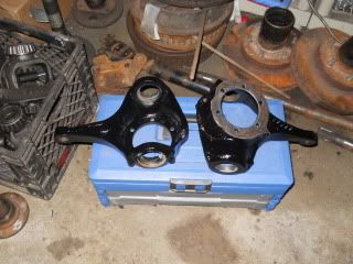

Some progress made over the past couple days. Primed the rear axle, painted the knuckles, and ordered superior 4.88 gears and install kits.
Axle
knuckles
Hopefully the gears will show up before summits estimated arrival time which is january 3-4th. Then they will be off to get geared. A guy in my club will be doing the install for $300 total and welding on the truss for a little more.

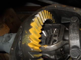

Got the axles back and they look sweet. The welds on the truss looks awesome.
Gears

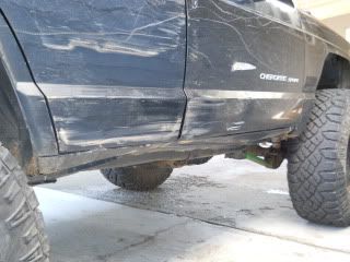

Here are some trail damage pics. There was a lot of brush on the sides of the trail and a tree at one point. Its not all from today but most of the scratches are.

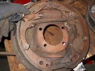

Here are the rear drum brake assembles, I'm going to be getting new everything hopefully this week.

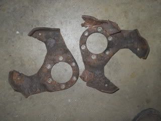

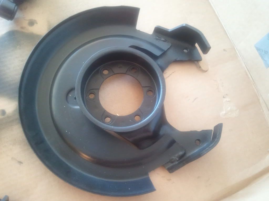

These are the caliper brackets. They should look like the image below.
I'm debating whether to just cut off the remaining rusted dust shield and run just the caliper bracket (like they do in disc conversions) or to try and find a new one somewhere. I have been searching but can't find it anywhere.

So the other day I cleaned off the caliper brackets. I'm going to run them without the dust shield and hope that everything holds up. I don't see how they can be that beneficial anyway. I will however still look around for new ones with the dust shield still usable.
Last night I started to press the new ball joints into the knuckles. Its not easy with just the little ball joint tool thing from harbor freight, especially without a vise or anything to hold it still. But, I got one side done.
Today I painted the axles and just milled around not really wanting to do anything. They look good, however I didn't get to serious about removing all the weld spatter, just too much work.
