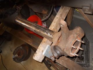

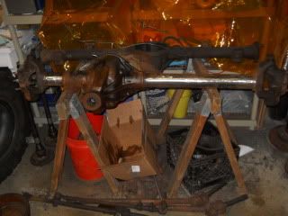

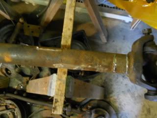

Started working on the axle yesterday, its slow going with a broken wrist.
Brackets off
Cleaned up a bit.
How do people normally clean of the center section? I used a flap disc on the tubes, but there are tight spaces on the casting.
I plan on pulling and painting the outer knuckles, but don't have a wrench or socket big enough. Haha
Brackets off
Cleaned up a bit.
looks great, i just started work on my HP 44 and 9'' swap from a 77 f-150.
it gets expensive fast haha
i love the look of waggy 44s under an XJ.

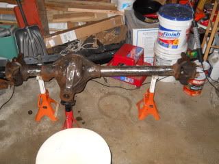

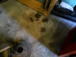

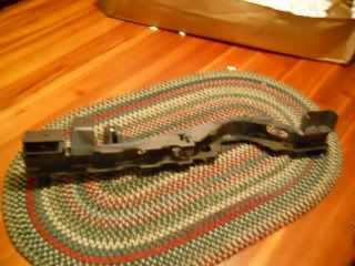

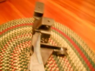

So I have reached some problems. It seems that the rear axle might actually be out of a 77 instead of an 87-88 like I was told. I found this out when looking and cleaning off the diff covers. I could clearly read 3-30-77 and then just the 87 on the other cover. This means that the rear housing is offset about and inch towards the passengers side. The shafts are also different lengths confirming this, unless They are supposed to be like that. Does anyone know if this will work or do I need a new d44 that has a centered housing.
Now what I am also worried about is putting the axles back together. I bought them totally disassembled from a guy who I believe knew what he was doing as the bearing caps are marked. So I think I will be able to figure it out based on the markings and sending an email to the seller as he probably knows. But, can anyone explain to me what the different stampings mean on the bearing caps? Two of them say 147 and two say 057. and they all have an 88 stamped on them, which at first got me thinking that maybe just the cover was from the 77 and they both were from 1988. Here are some pictures.
On the left there is a D stamped near the 18, meaning driver maybe? then nothing stamped on the right one.
Om these two there is what looks like a v or check next to the 21 and 20.
Below: The caps with 147 are on the left and 057 on the right. The grooves line up with those in the diffs, seen in pic below.
This is just a pic of the inside of the front diff(88)
So there is were I stand right now. I don't really know were I'm heading just buying and doing the stuff I know needs to be done. If anyone has any answers, links or opinions please share.

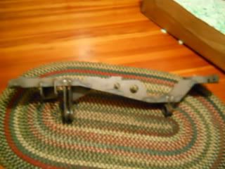

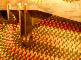

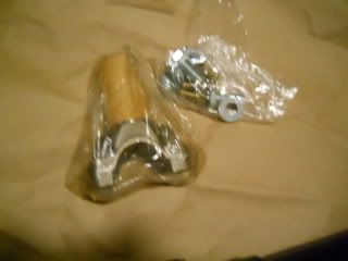

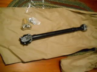

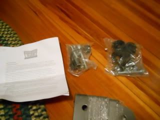

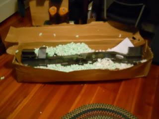

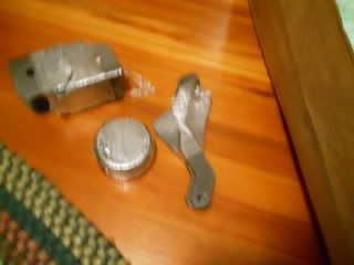

Ordered tnt truss with all necessary brackets and IRO's Hack and tap SYE kit with a rebuild front shaft.

Parts are finally in and work will begin during my winter break which starts in 9 days. The SYE will hopefully be put on quickly but I don't want to buy shims when I am buying perches for the new axle anyway. So I might just wait until I swap the rear axle in. It will be much easier to think once I am out of school and have the parts in front of me because right now I have so many questions that I just don't have time to research.
Here are some things that have been on my mind:
1. Will my rear axle work? As stated earlier the cover says 77 and the shafts are different lengths so I'm worried its offset to the passenger side. However the reason I didn't realize and am still skeptical is that the pinion looks centered to the eye. But, I will be able to measure in 9 days.
2. Should I get new carriers or just stick with the old ones and get thick cut gears. This way I would save like 120 bucks. I figure if wanted to get a full case locker it would just be the one for the lower numerical break and wouldn't matter. Opinions?
3. I have read of people turning the knuckles on the tubes. Is this something I should be looking into doing or is it not worth it for 4.5-5 inches of lift?
some pics
2000 Cherokee Sport Build: http://www.jeepforum.com/forum/f22/2000-xj-build-slow-uneventful-1162913/
Cherokee-at-16 is offline
