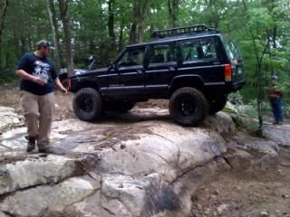

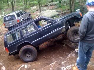

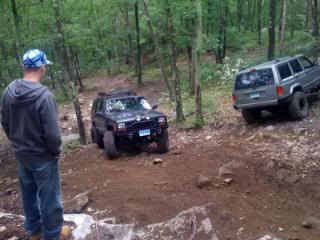

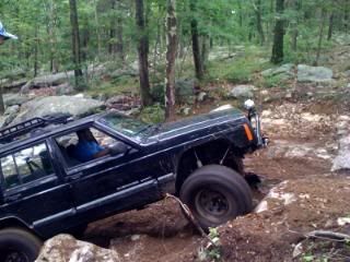

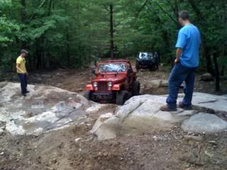

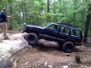

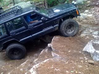

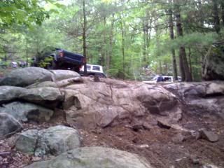

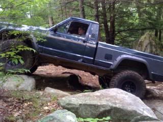

So I finally got out wheelin' today. We had a good time, didn't push it too hard. I want and SYE, Some boxed rockers or sliders, and one ton steering before I really open it up. Aussie did great and only crushed one rocker.
Pics- All taken with my dads iphone and its an older one that couldn't take video

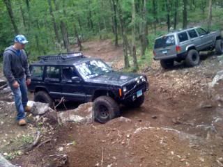

Here are some pics from a real camera.

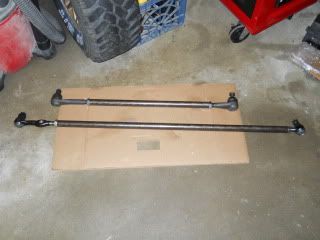

So, my JCR steering should be here tomorrow, tonight I'm going to order a reamer, $40 shipped form some tool supplier based in long island, Its a Ace brand reamer. Painting it lime green to match the diff cover.

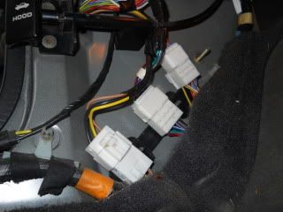

And here is the picture never taken, of the wires you must unplug when going doorless on you 97+. This picture is in none of the write-ups.

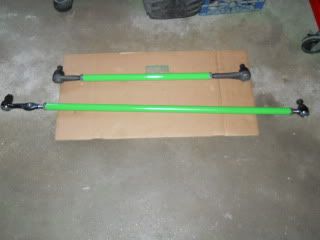

And less then 24 hours later the steering is already painted. 3 coats primer, 2 green engine enamel, 1 clear coat just for fun.

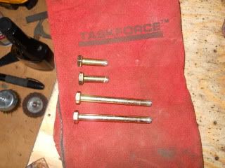

And here are my new door pins for taking the doors off. 5/16 bolts cut down and the ends grinded to help them slid in. I think I will be taking them off tomorrow. I have the day off and its not support to rain.

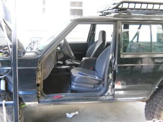

So today I removed the drivers side door. I did a little adjusting but haven't put it back on to see if it still sags, I think it really needs bushings. its pretty simple really but It will suck if I have to lift to close every time. I'm going to hold off on the passenger side until The drivers side is set.

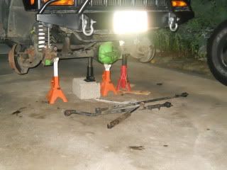

Steering install has began...I got home from work at 8pm. First things first, drink water and bowel movement. Then food and update my Facebook status, check to make sure there are no partys goin on, nowhati'msayin. So 9pm decide to start. 30 minutes later the stock steering in laying on the ground and theres grease on my moms driveway, again....
The steering stabilizer was retarded. For one its dented and stuff, leaked all its oil or something out a while ago, and all its 2 bolts were frozen and took a way more effort then I wanted to put out to get it off finally at the axle side. It will not be missed. Stabilizer= 15 minutes everything else=15 minutes

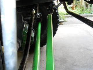

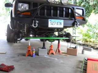

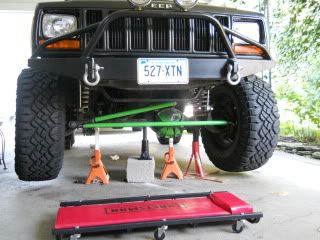

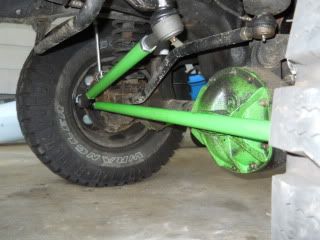

So my reamer wiggled when in the 1/2" drill chuck so I rigged it up with a socket and air ratchet. Worked good but took a while waiting for my little compressor all the time. Anyway here it is.
Tie rod in place.
Drag link in.
All said and done.
Heres a picture of my clearances. it hits at full lock but I never turn that much anyway. I went down a tight street and did a u turn and it I didn't hear any noises. I'm gonna adjust the steering stops anyway.

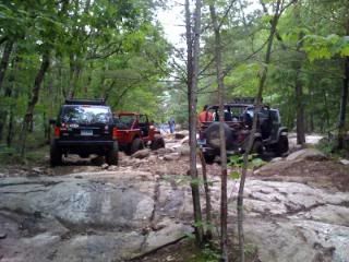

I spent this past weekend up at Rausch creek. It was a good time, I'll post some video and pics later. Ran blues and blacks and also into some problems. For those of you who know the place I drove down to lake Christy, down the hill to the lake, through the edge, and then up the other side. We hung out there a while watching some nut who after going around the edge of lake Christy thought the middle wouldn't be much deeper. Anyway then we went down to tomb stone and while doing the easier line out (still a black) my jeep just died. We winched out and towed me back.

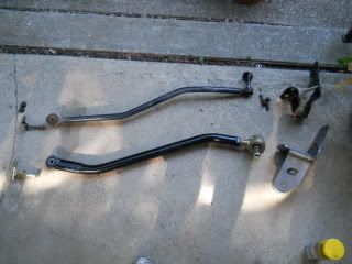

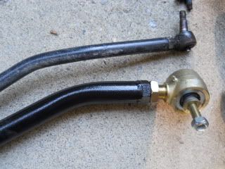

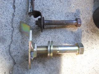

Ok just a little update. On the way home from wheeling in the beginning of august I got death wobble. I welded a washer to the axle mount in case that was the problem, tighten everything up real good, and rotated the tires. There was also this clunk in the middle of the steering curve.That all made it a little less prominent, but was still there. And I basically didn't drive for the next month, i had no were i needed to go, lol.
So, I ordered a Clayton track bar with the bracket and hd bolt for the axle side. Let me say that I am never ordering from another company again. Its just not worth the trouble it might cause. The clunk is gone when turning too. I am very happy. now my only problem is a bent rim.
Here are some pics, I used to have a rough country track bar. And I think I bent it, i think i mentioned that before.
