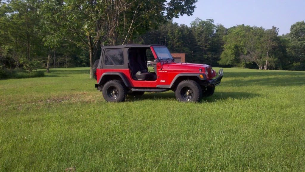

We've had this jeep now for sometime, it served us well for a toy and a back up vehicle.
[in these pics the jeep is 31x1050 with 2" BB lift]
This past spring the jeep was involved in an accident that almost deemed it totalled. Fender,axle and suspension damage plus the mileage of it so they wanted to total it but wait, whats a Jeep persons favorite things to do? Lift and off road parts, so we talked to insurance company and we kept it. We went ahead and contacted Rusty's offroad for one of their lifts. We were looking for a kit that had bascially everything that needed to be replaced. We decided on a 5.5" suspension lift.
