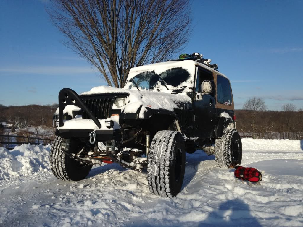

Ok updates.... LOTS. So i got a RE 4.5 XD lift and installed it by myself, it took about 2 days to get it driving again. Pulled out and test drove it anddddd it had TERRIBLE driveshaft vibes so i parked it and ordered a Tom Woods CV shaft and a SYE kit for advanced adapter and did a Tcase swap with a rebuilt one that i already had. Put that in with a buddy and was good to go!
How she sits now, doors off in december! lol

Posts: 361
After the snow, I put on a cherokee roof rack, drilled it into my hard top and used rubber washers on both sides and big washers on the inside with silicone to seal everything up and it works great, no leaks or wind noise at all! So then I bought a Thule Snowboard/ski rack from where I work(Wicks Ski Shop) to transport my stuff up to the mountain and save valuable space inside!
I think it looks pretty good!

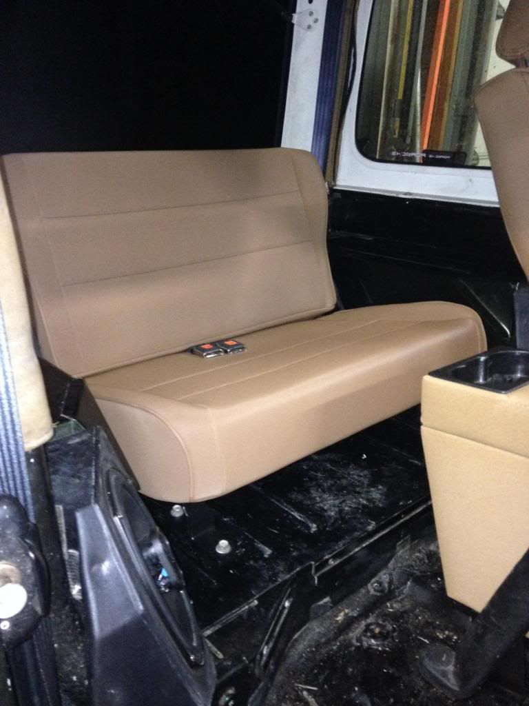

For christmas i asked my parents to split seats for the inside to get out those ****ty mismatch cavalier seats, I must say they were a comfy seat and bolted right up. I got Rugged Ridge Spice Sport Seat, it has a vinyl covering that is water proof and is super easy to clean. I really like them and now have a back seat! and better yet they all match perfectly! The whole thing looks so complete!
Only picture i have right now but I really like them and how they fit, they fit my really well because they are a skinny seat and im a skinny highschooler lol.
