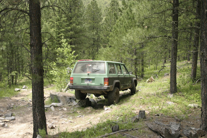

went wheeling 4+ trail didn't make it to the end...
popped the inside bead :/ caught it on a rock
rock ate me
it actually tore this flare off
