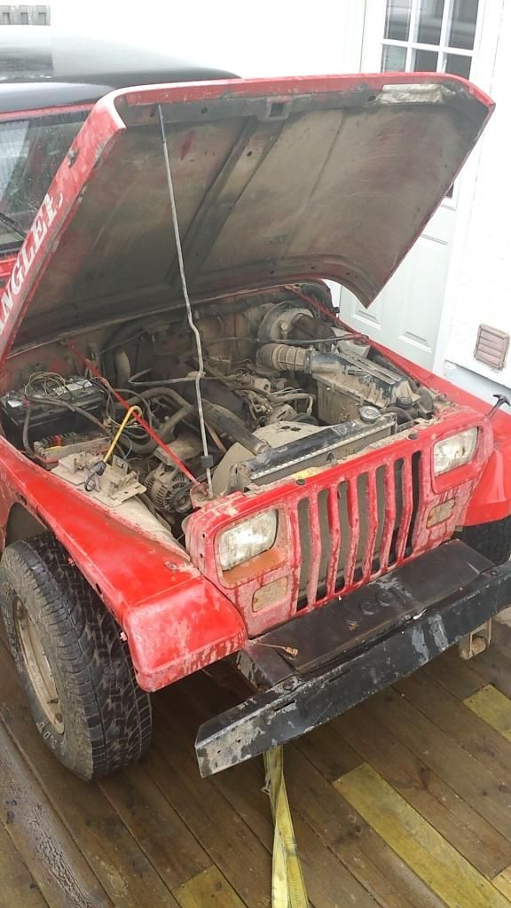

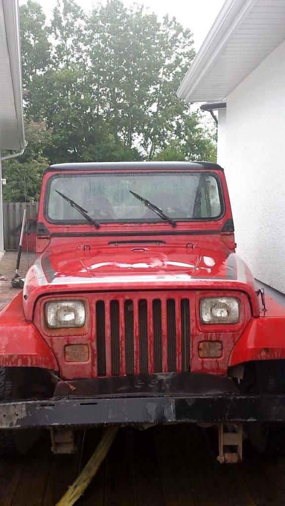

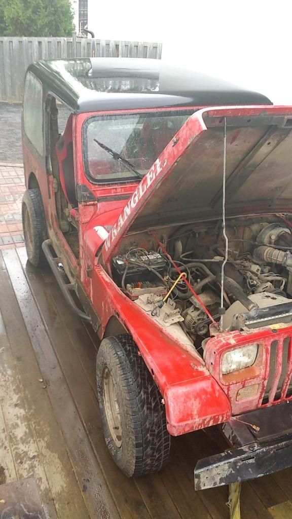

Heres some photos of the jeep I bought after towing it home by a strap.

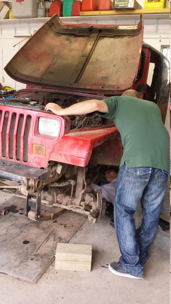

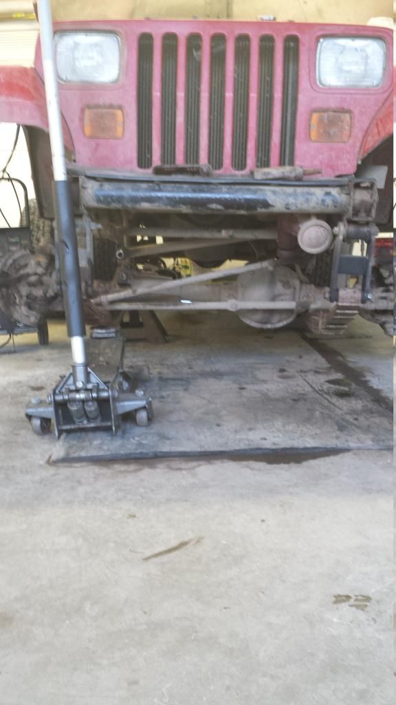

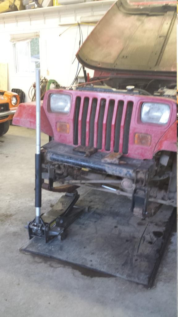

changing the leafs after noticing they were snapped
When I bought this jeep the guy told me nothing was wrong with it. I tow it into my garage and notice that the passengers front leaf was snapped. When I bought it the jeep came with 3 sets of leafs so that saved me a couple of coins. Me changing the leafs.
Changed the leafs just need to find some ubolts to hold the plate from the leafs to the axle together

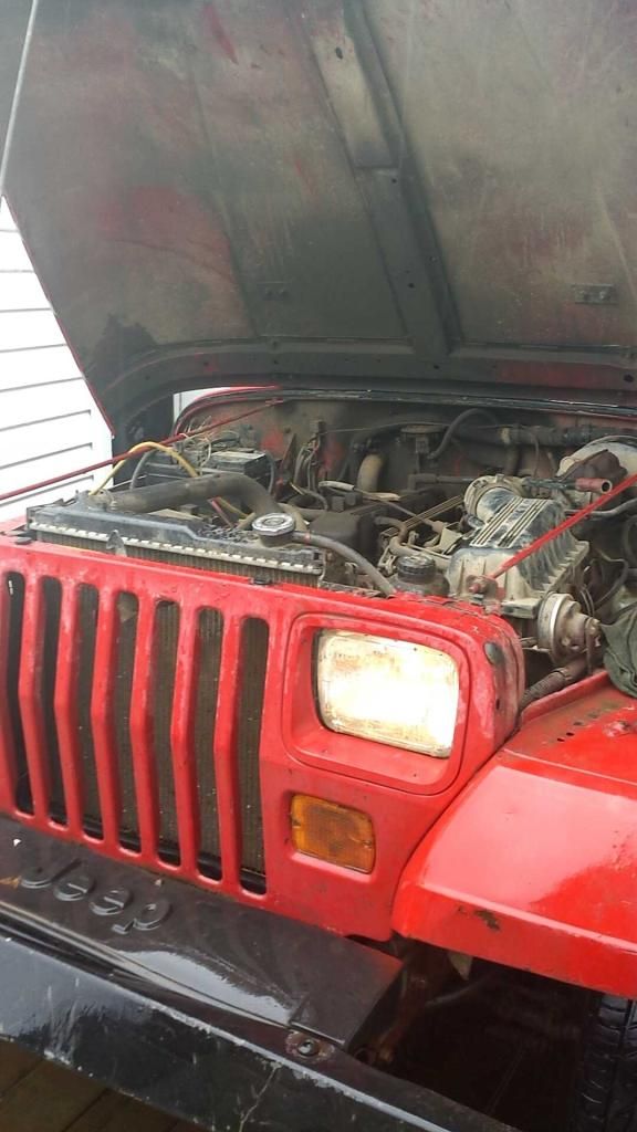

Got my headlights working
Couldnt figure out why my headlights wernt working then noticed the plug wasnt in the headlight. Looks even better

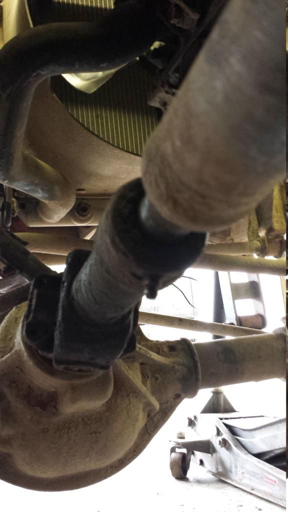

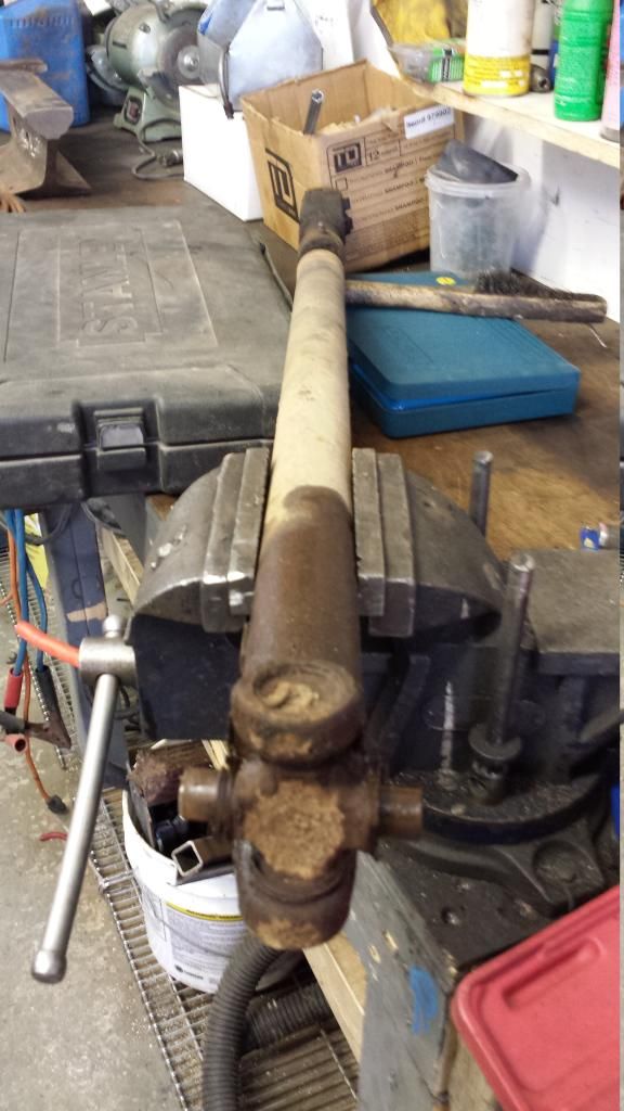

U-Joints Broken
Inspecting this jeep I just bought and wiggled the U-Joints on both ends of the driveshaft and they were really loose (broken). So had no choice but to rip out the driveshaft. Ive had this jeep since July 12, 2014 and did this much to it.
Driveshaft is out like nothing

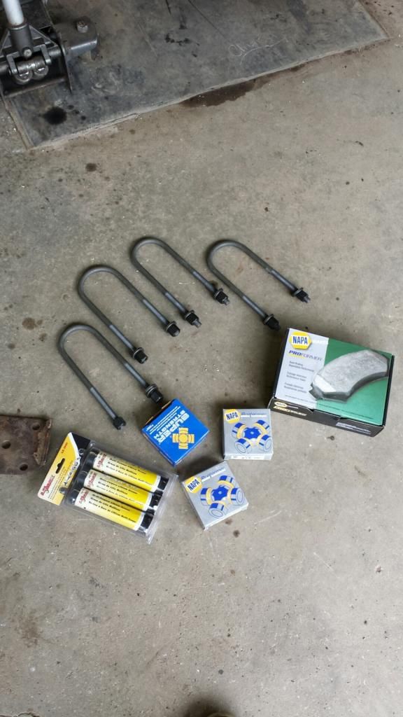

New Parts!!!!
Brother comes back with new 4 U-Bolts, New brake pads, All purpose grease, 3 U-Joints. Can't wait to install them!

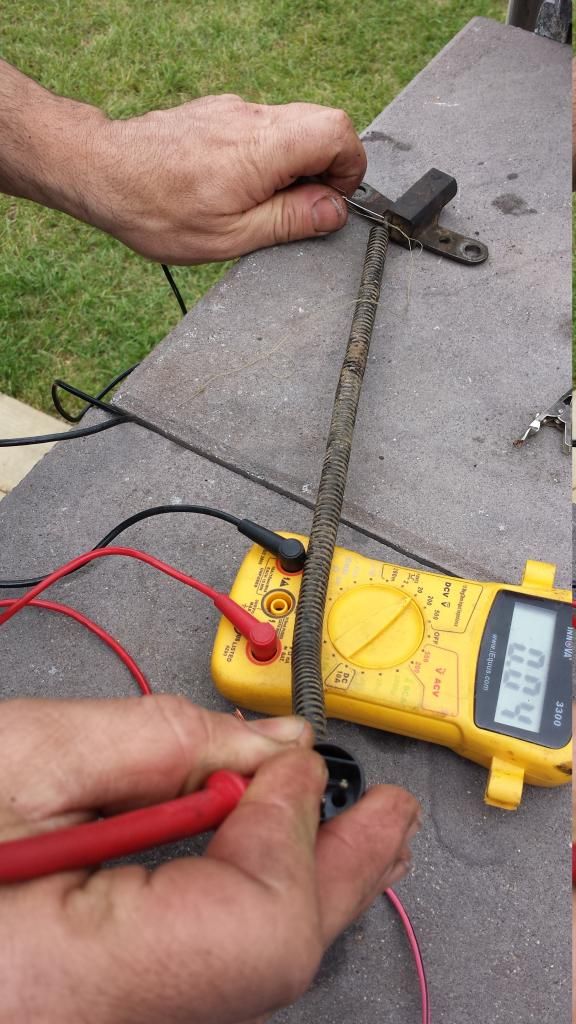

Testing if the crank sensor is good
I had an idea if the crank sensor was the sign of no spark. So I asked my dad if he can help me test it out of the jeep.

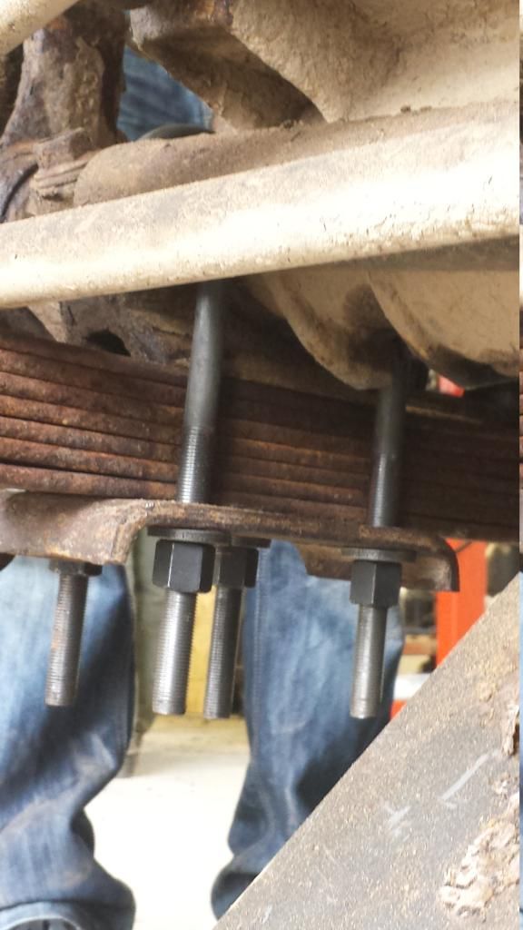

New U-Bolts
I put on the new U-Bolts and they held those leafs good.

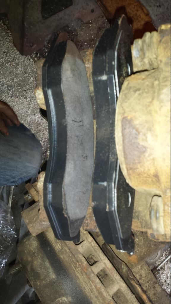

New Brakes are on and look nice
Put on the new brakes I got today almost got the jeep partially done

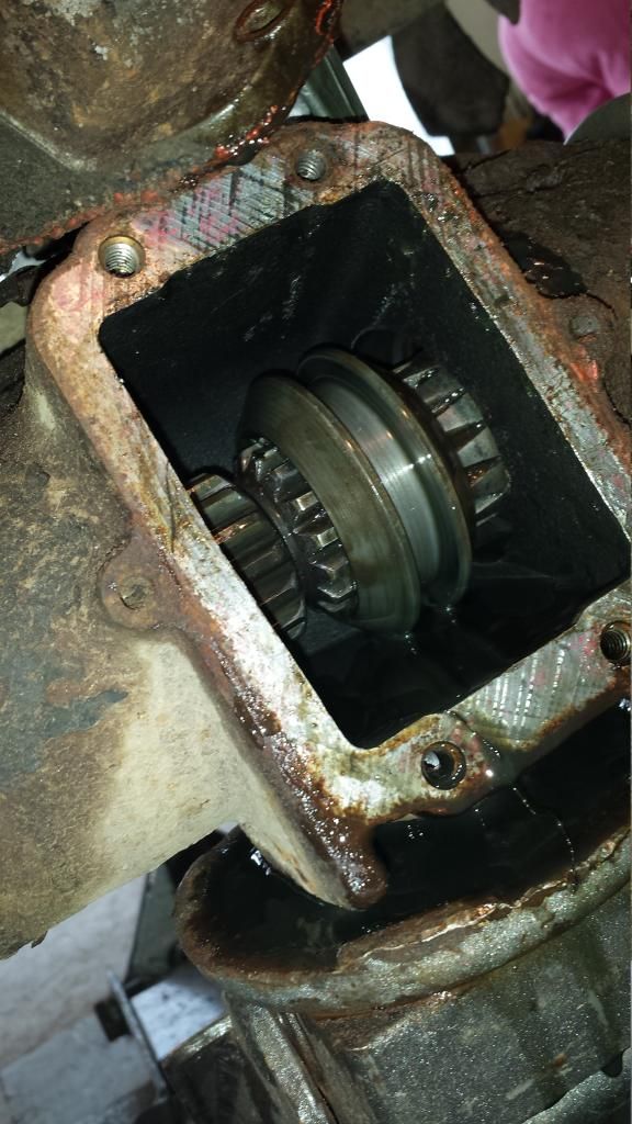

Another Problem!!
Putting the 4 wheel drive axle on after changing U-Joint
After noticing that axle not going in we looked with a light through the axle and a sleeve(gear) slipped out for the actuator.
Opened up the actuator case and popped that sleeve into place.
Solved that problem!!

I put the new U-Joints on the driveshaft ends and it is put back on the jeep and bolted up.
