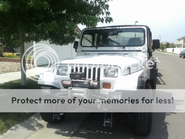

Beautiful Jeep man. No offense intended, but it drove well? Looking at those front shackles makes me think it would wander all over the place.
Randonexplosion is offline
post #5 of 75 Old 01-21-2014, 08:28 AM Thread Starter
Killswitch505
Join Date: Jan 2014
Location: Hobbs
Posts: 105
None taken yeah I thought the same thing when I seen the front end but yes it ran straight as an arrow. It was a rough ride as far as bumps and stuff but at 70mph I could take my hand off the wheel with almost no wonder

Those shackles need to go. They are dangerous to say the least. Way too tall. If you say under 3" on the suspension you will avoid the death wobble. 1" shackle, 1" body and under 3" on the suspension. You can run 31s on stock suspension. 31s would look silly with a total of 5" lift IMO.
