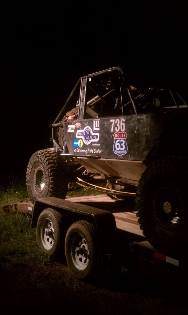

Game on. A day away from race day.
All loaded up and ready for the drive up state.

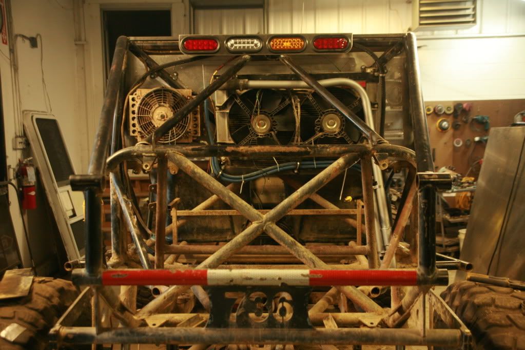

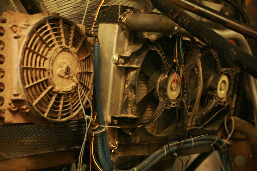

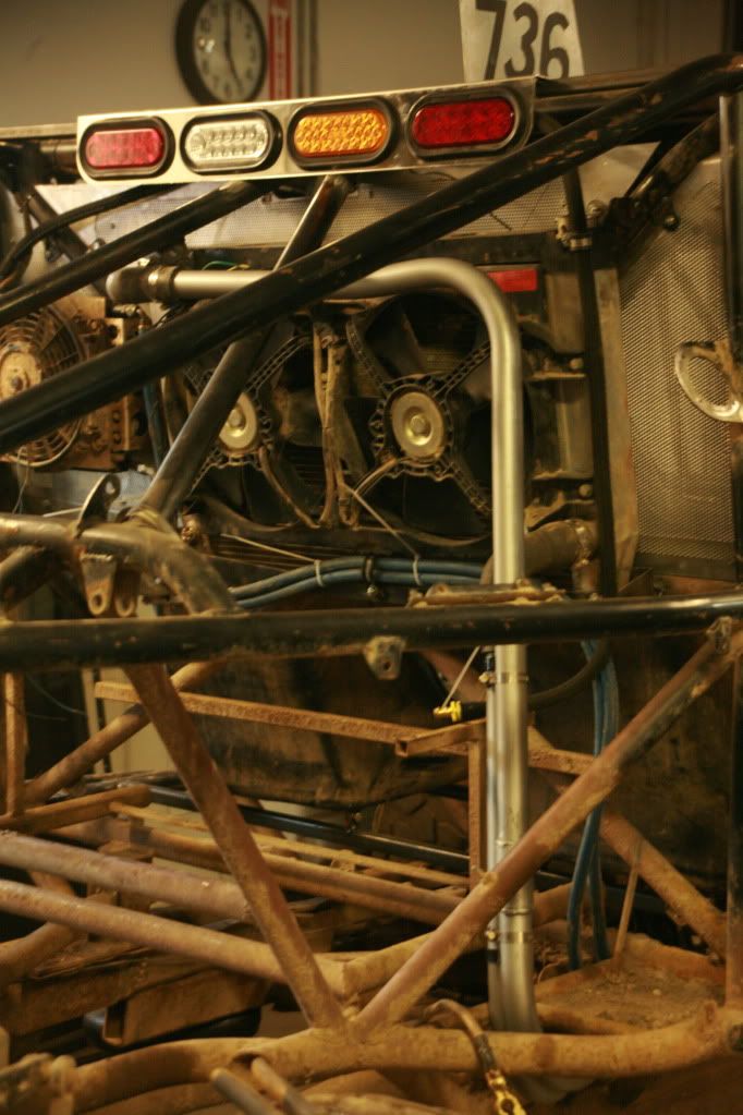

It has been a while since I updated this. I had some issues with the stroker in its first race. Pulled it and put a spare 4.0 in it. In the off season this winter it will go back in and I will start working on the supercharger again. With that I needed more cooling, so I covered that first.
XJ buggy on tons...

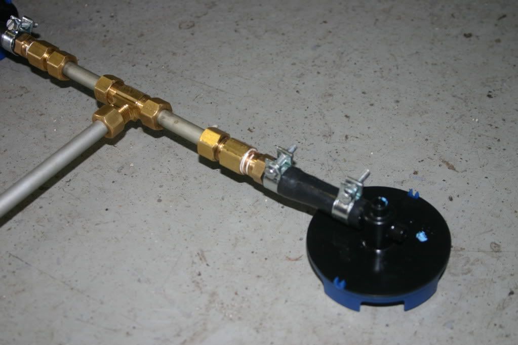

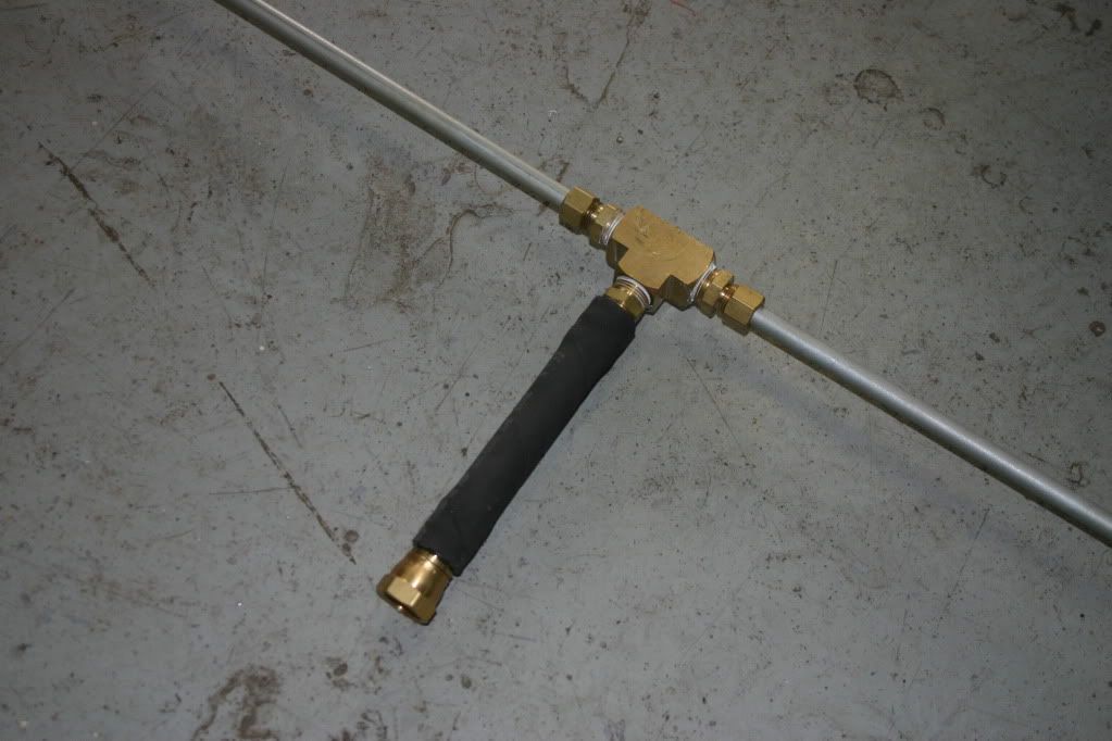

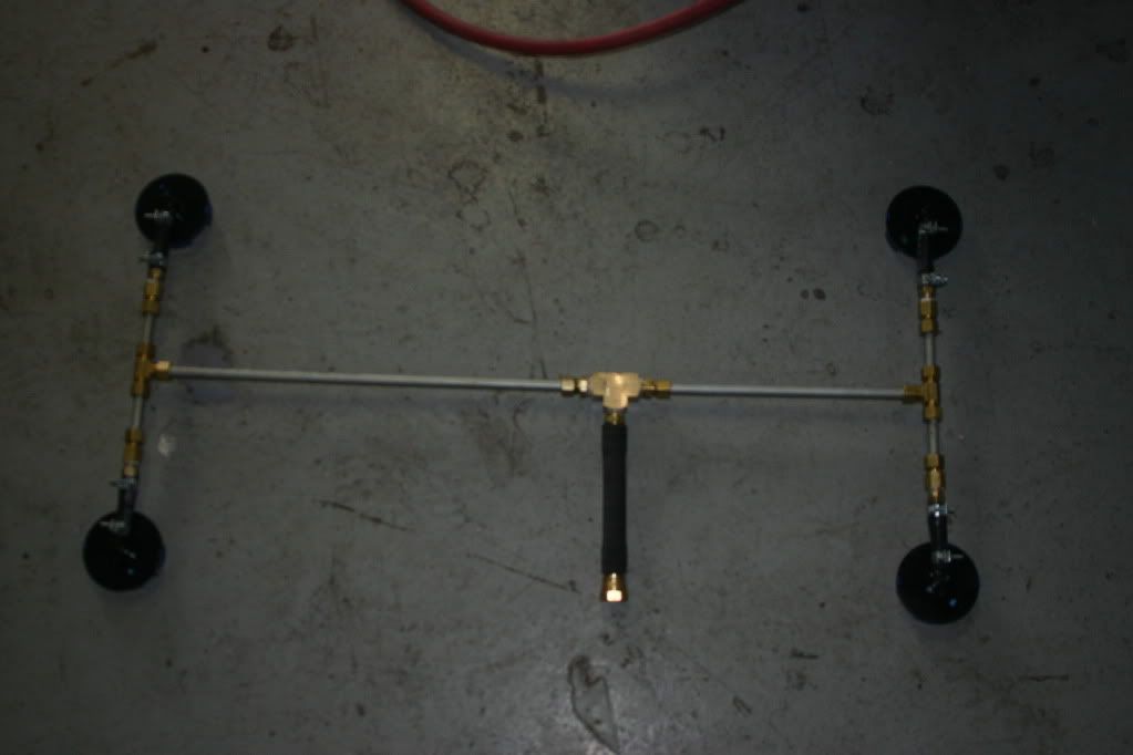

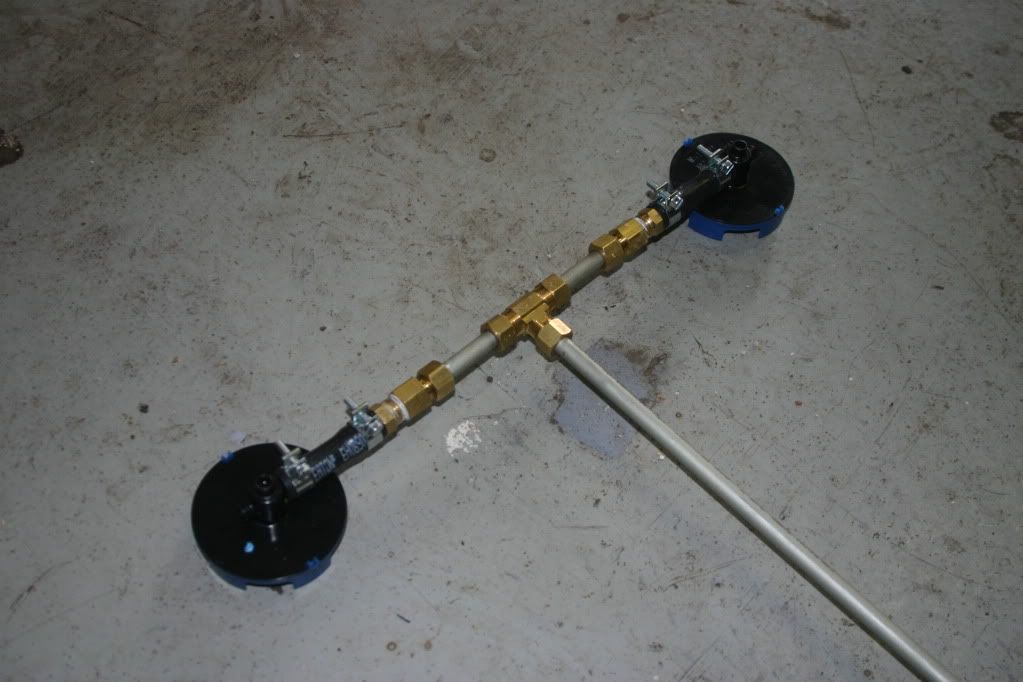

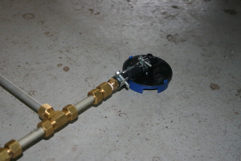

Rebuilt the fuel system
Tee coming off the main -8 fitting
3/8 compressions
3/8 down to 5/16 barb to the Walbro
XJ buggy on tons...

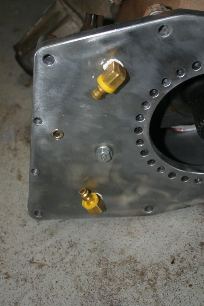

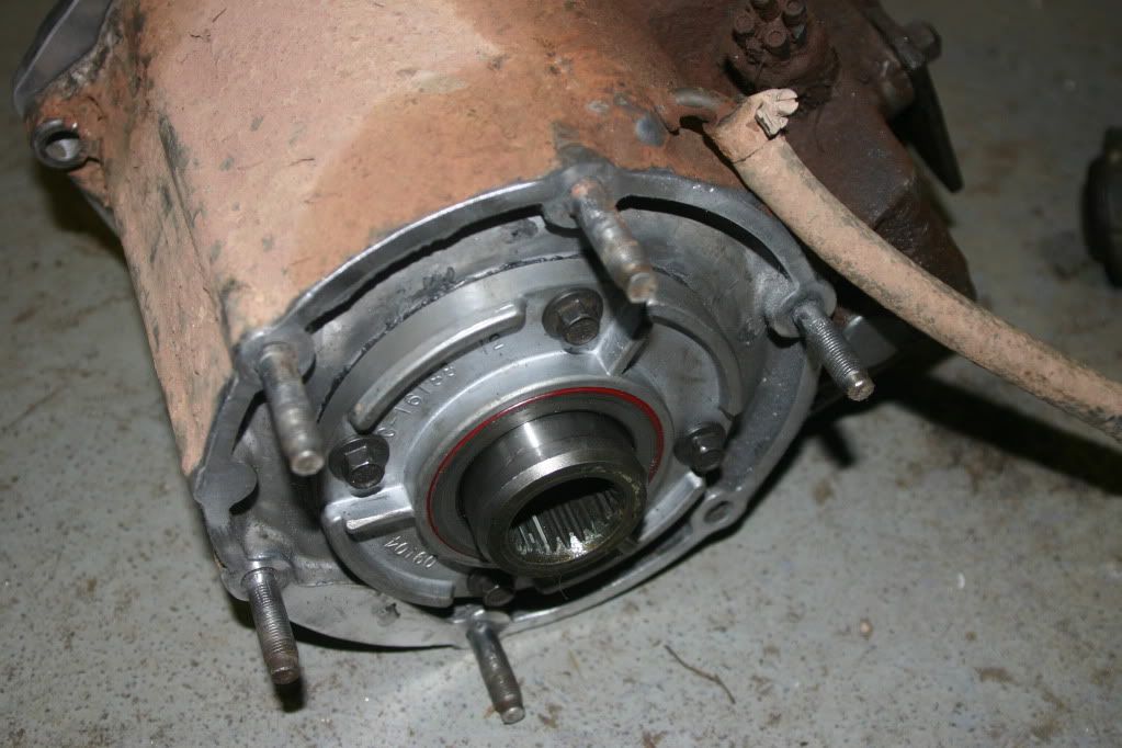

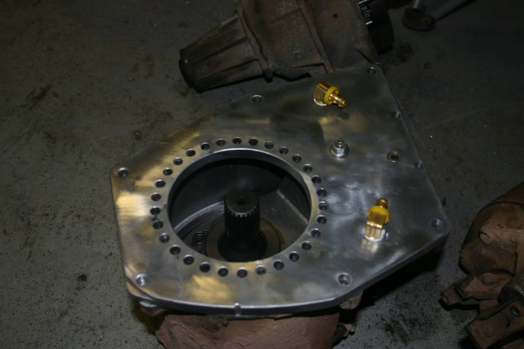

Since I had an extra Tcase laying around with the HD gears in it, I did the switch as I was rebuilding some stuff.
Doubler back together with the new 6 planet planetary and 23 spline input. Also, I put in two barbed fittings so I will be able to have a fluid level gauge.

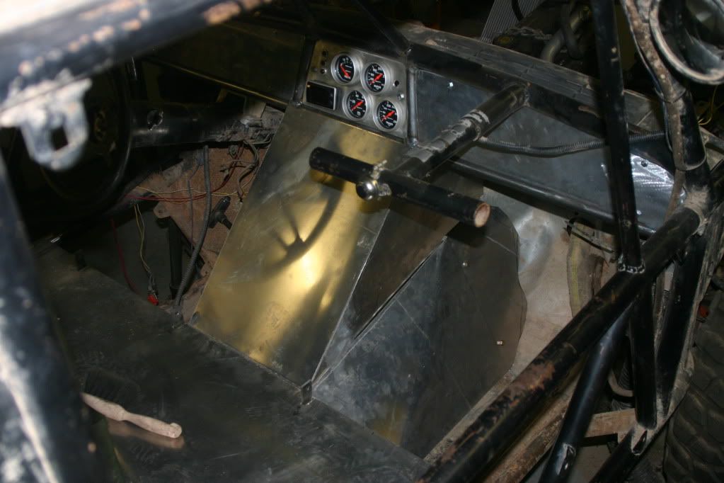

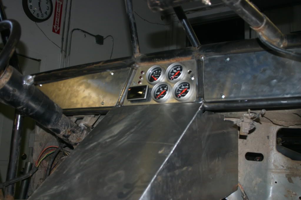

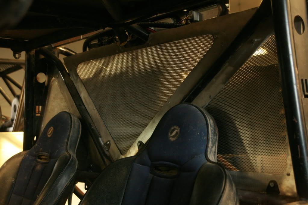

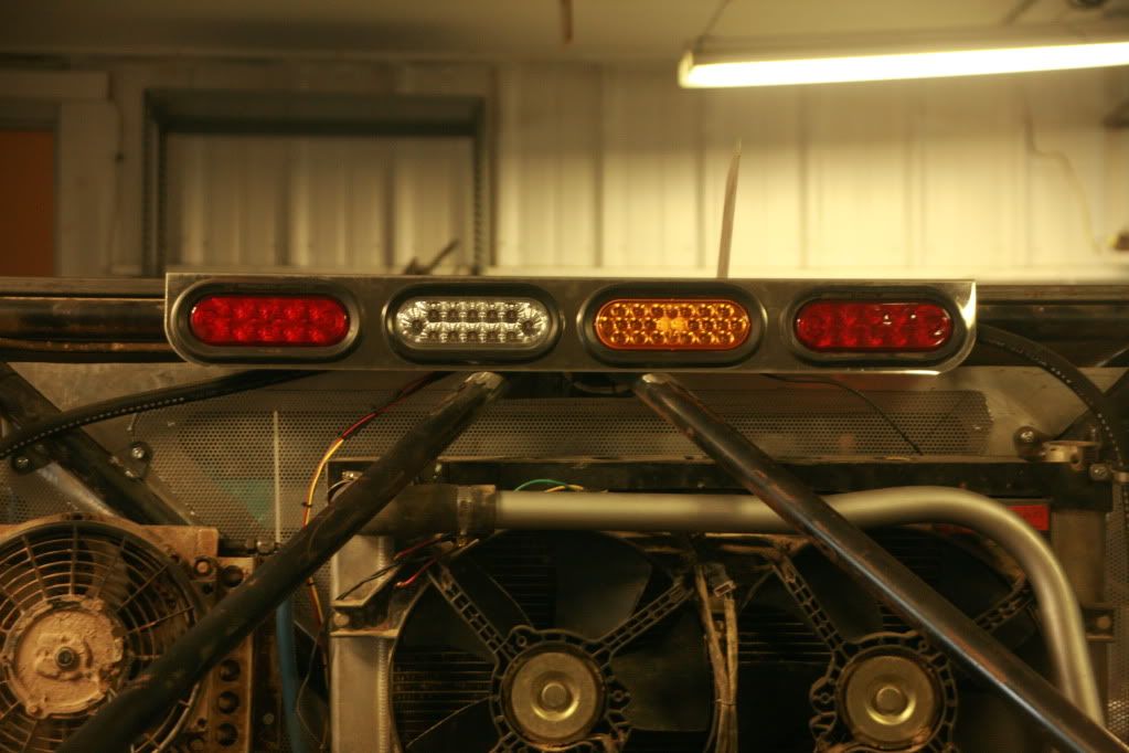

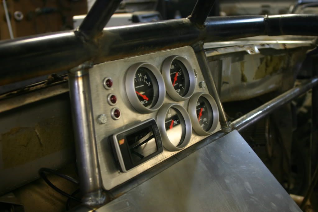

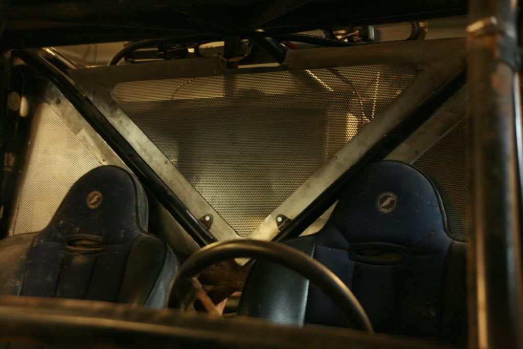

Interior changes....
From our first race of the year.
XJ buggy on tons...
