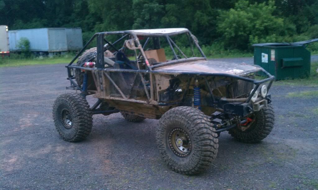

Alright so its time to get ready for the Line Mt. Coal Bucket. The XJ buggy is still sitting on the trailer broken and covered in mud. So I am using the open space in the shop to start ripping into my 4.0 and 258 and bring them together for a stroker.

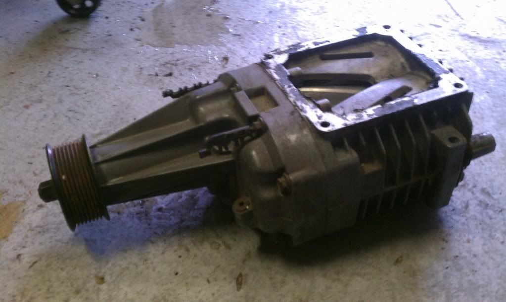

Also, I have been going back the forth with my buddy Corey that builds turbo 4.0's and it looks like we are going to go after the Supercharger option. With some more fuel, the right cam, programmable MAP sensor, intercooler and a tune from Corey. We are going to go after about 300-350HP and 400lb-ft of torque at 6-7PSI. Should be a nice combo for east coast coast racing. The LQ motor will be put in a new chassis. We are going to try to get the SC in, in August when we have a 4 week break between races.

NICE! What is the SC from?
01LimitedXJ is offline
post #96 of 114 Old 06-21-2011, 09:29 AM Thread Starter
xjcrawler736
1990 XJ Cherokee
Location: Harleysville, Pa
Posts: 176
Ford Thunderbird. An Ebay special

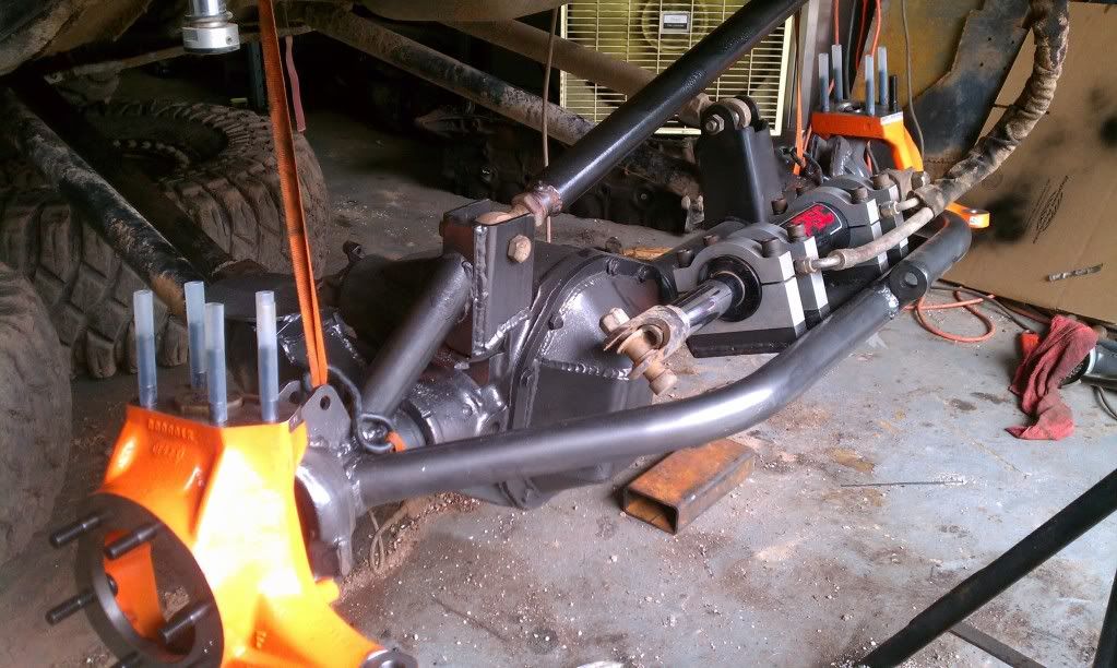

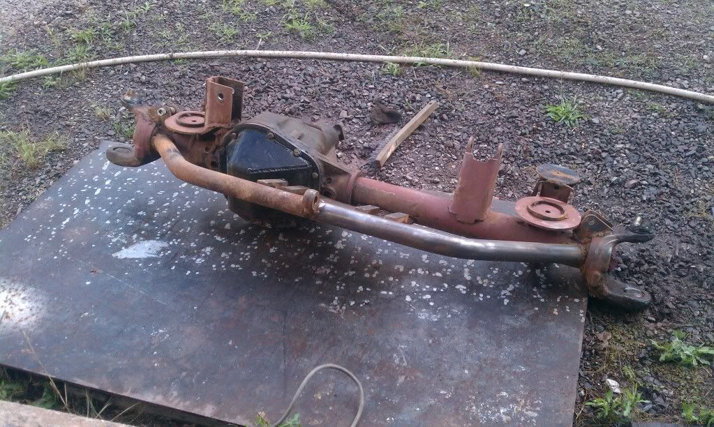

Rebuilt the front end so we don't have to worry about breaking knuckles in the future.
Before:
After:

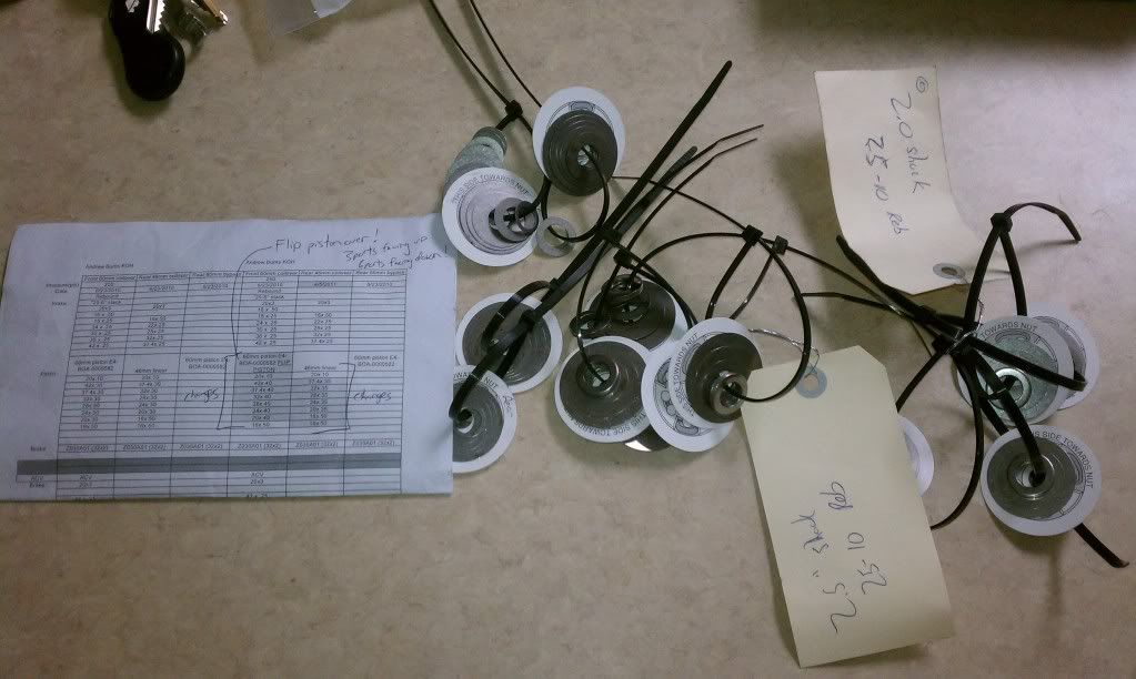

After some great communication with Joel from Bilstein, all the shocks are re-valved and charged with 250psi of nitrogen. We bumped the compression valving all the way around. Up front we stepped up one step because we were only bottoming on big hits. So I thought one step up would work well for our east coast racing. In the rear Joel had us step up one step also but I thought it wasn't going to be enough based on how the suspension was acting.
We were bottoming hard in the rear often, not just big hits either. I thought of that and that we were doubling HP in the near future and are upping compression in the front. For those of you that don't know, when you up compression valving in the front it makes the rear feel softer because of more weight transfer.
So I called Joel back and he suggested a double stack on the high speed shims. Double stacking gives the shock more control then just thicker shims. I was told it is a much smoother feel. So we raised the slow speed valving up one step and the high speed valving up two steps.
After charging the shocks I just jumped on both ends a couple times and it felt much stiffer. Hopefully this puts us were we need to be with our compression valving. I have a feeling we might need to lower the rebound valving but we will not know until we get some video from outside the vehicle in some big chop.
Tonight I will be putting the brakes back on and filling up some fluids and we will be ready to race. When that is all said and done it will be back to power washing for another couple hours.

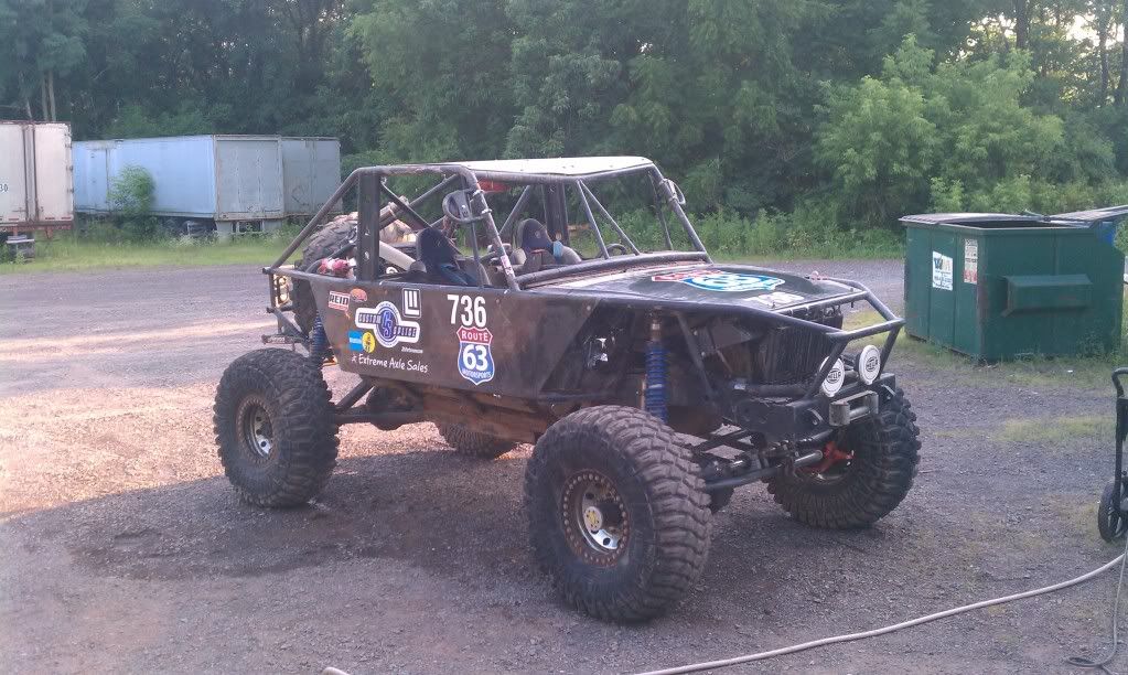

Another hour of power washing and it is kinda clean.

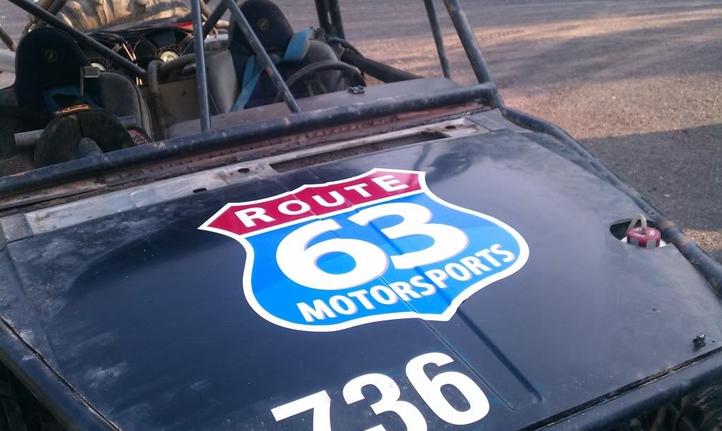

New logo on the hood
Skins back on
I fabbed up some tree sliders last night just to help with the tight woods racing. I would rather not rip the rear axle out when tagging a tree.
