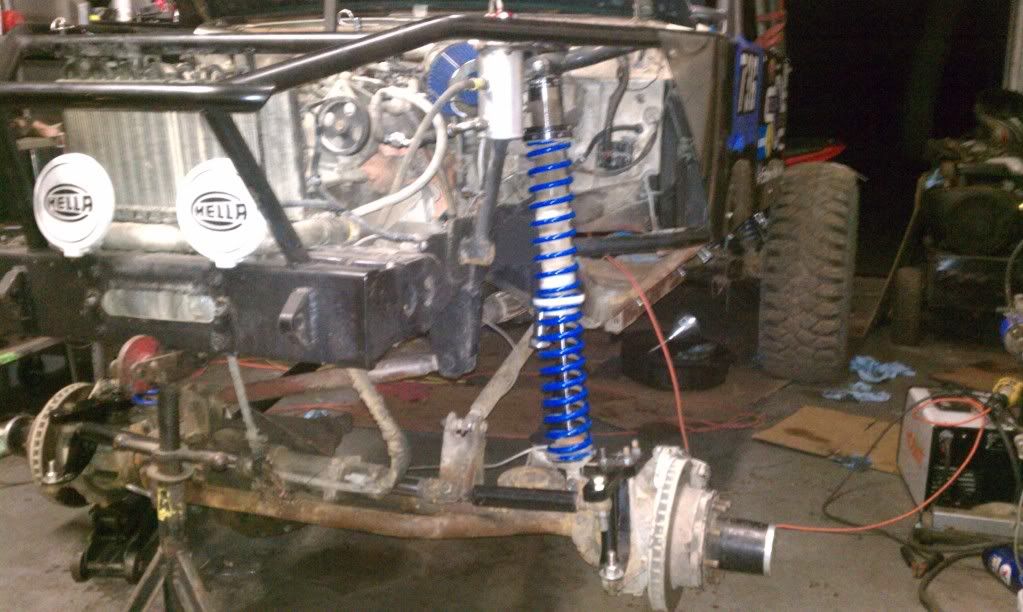

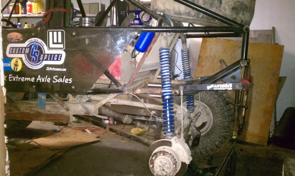

Front end is back together and now I am working on the rear. One of my dual rate sliders decided it wanted to destroy itself.

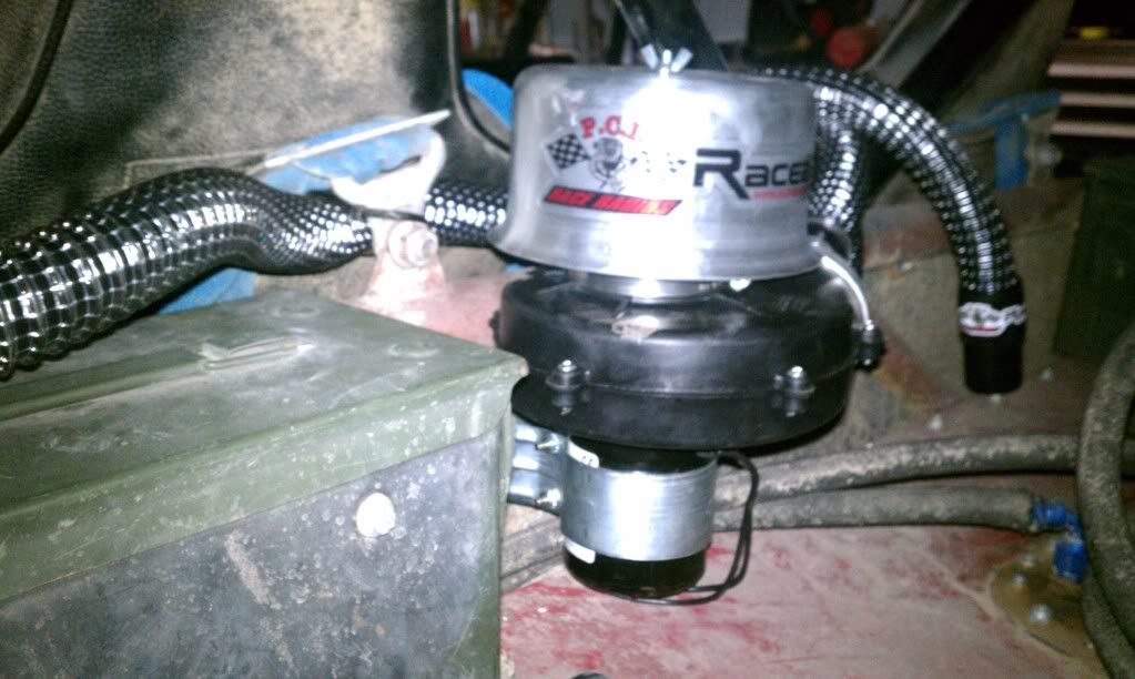

Pumper all mounted up
Front end done.
Front bumps welded, painted and installed.
Starting to rip into the read.

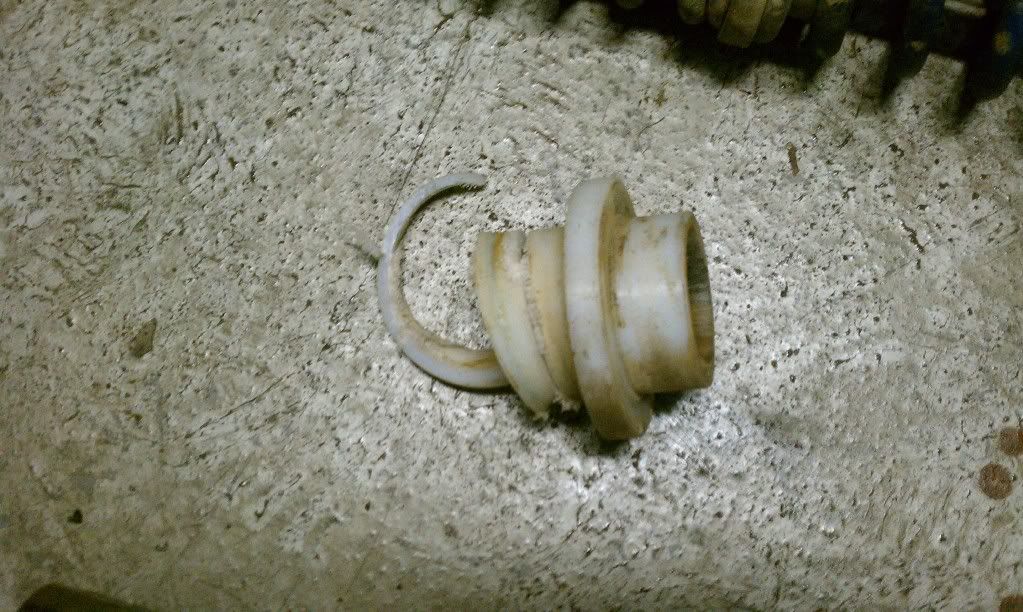

Destroyed dual rate slider.
Sponsors represent
Numbers are done from the vinyl place
Lots of wiring tonight and hopefully finishing up a lot of other little projects.
More pictures to come.

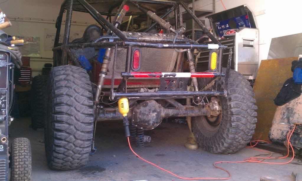

Jeep at full bump to setup the air bumps. Belly height is just about at 12"
Timmay came over to help fab up the rear bumper

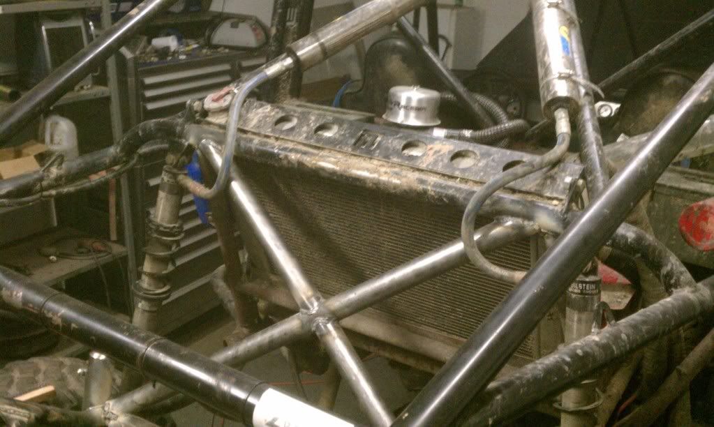

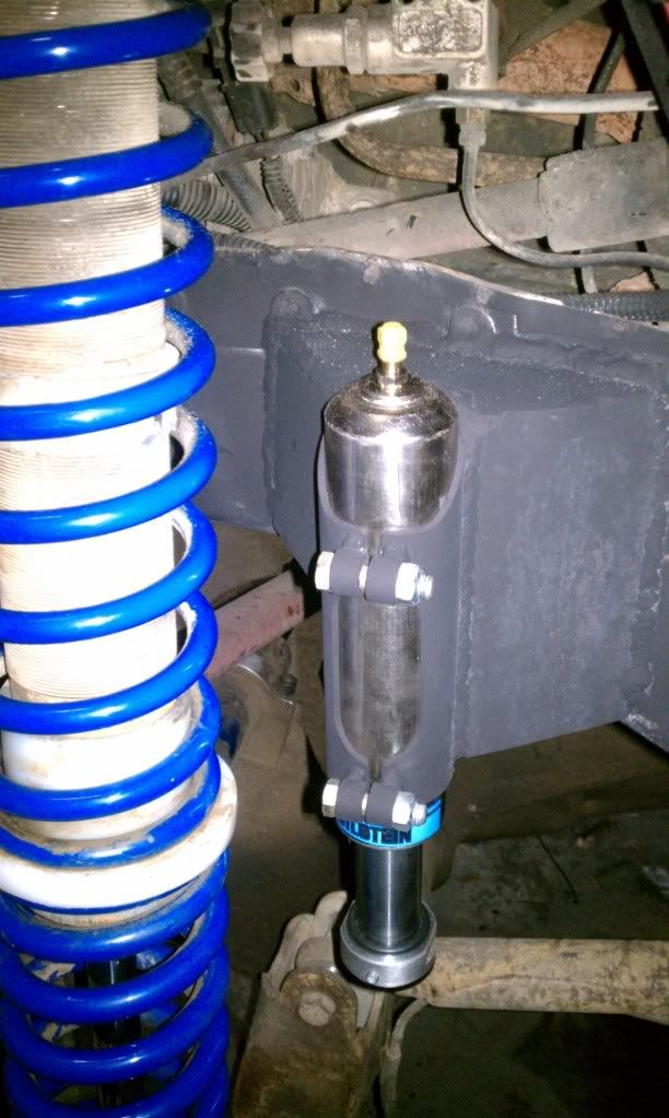

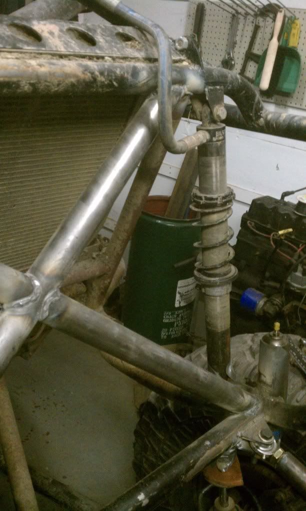

Progress from last night.
Bump pads and bump cans are mounted and welded. At ride height I will have 7" of up until I hit the 3" air bumps in the rear. In the front I have 4" of up then 3" of bump.
I have also had my sway-bar set for crawling thus far. It flexes perfectly even front to back on the farthest hole. Since our next race is a tight woods course I moved the bar all the way back to the most resistant hole.
Do to so many racers having problems with their hydro rams moving, I thought it was a good idea to add another set of clamps to the ram. I have not had problems yet but it can't hurt to put on twice the clamping power on the ram.
Finishing welds on the bumper and new front drive-shaft will be taken care of tonight. Then the buggy will be back on its feet and out to do some testing.

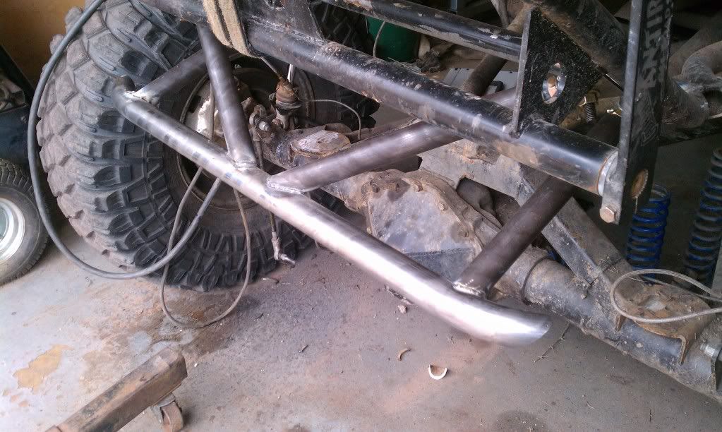

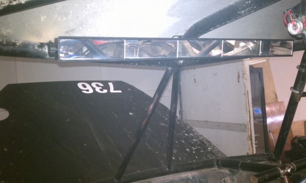

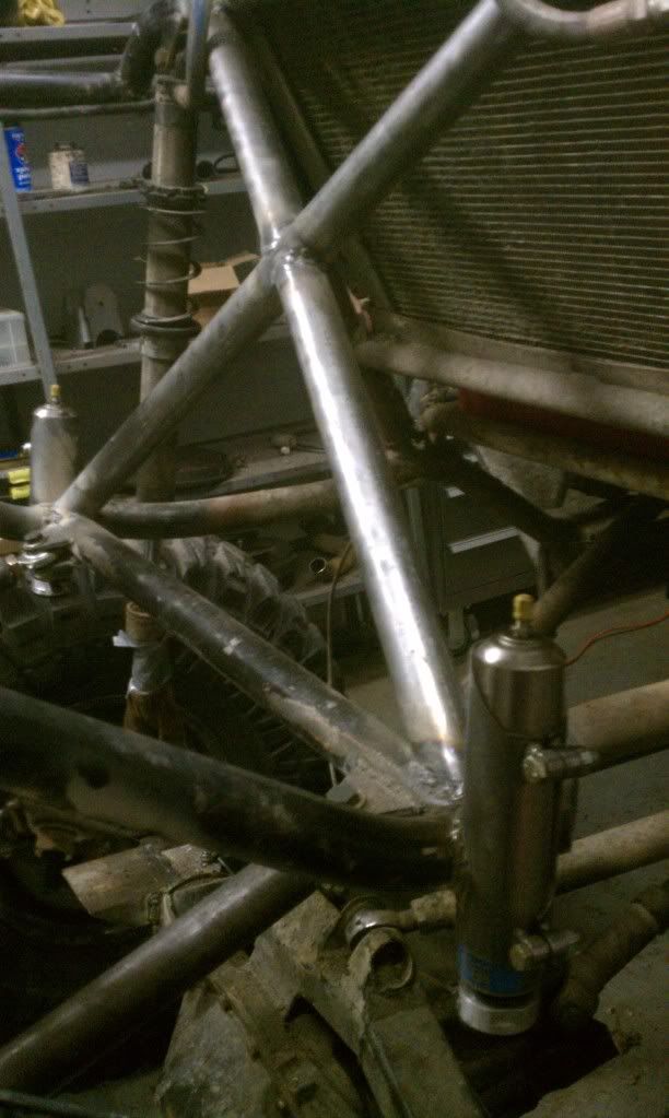

New rear view.

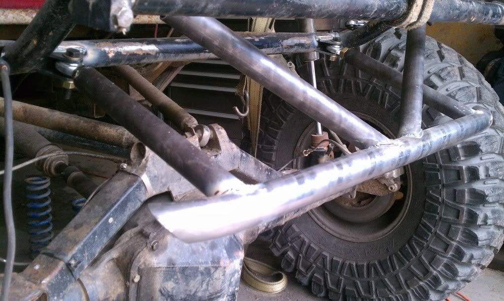

Built an X over the Air Bumps for some extra strength.
Just have to add a plate gusset so the bump can doesn't bend up.

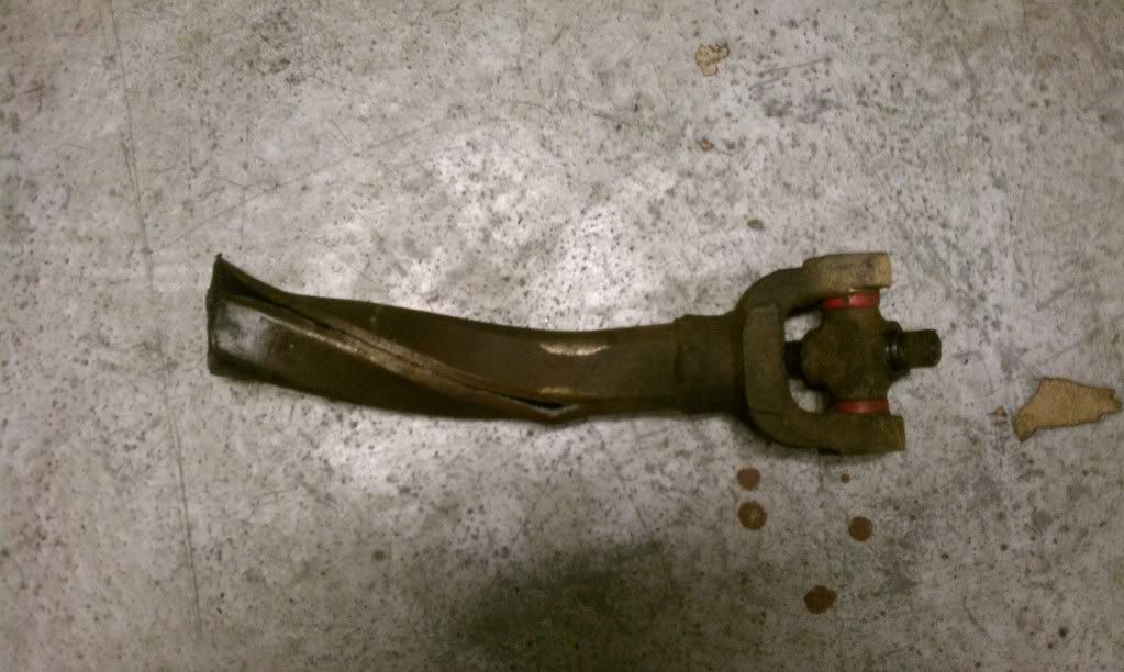

And the reason I built a new driveshaft. Good old 4 spline failure. :laughing:
Driveshaft, mirrors, and bumps are done. Just a couple more things and we are ready to race.

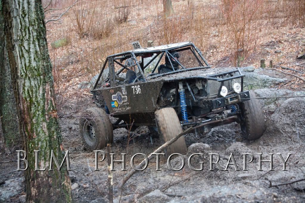

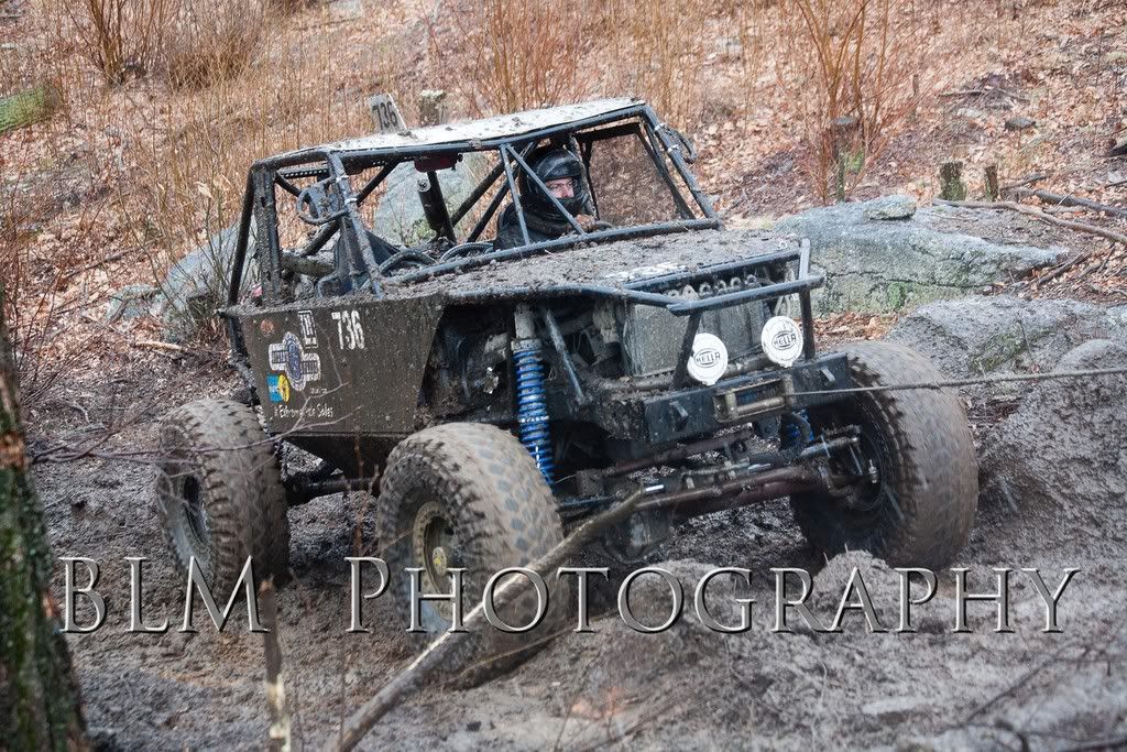

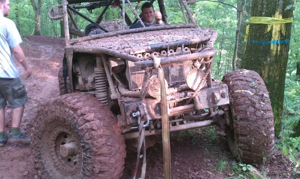

So we got back from the Line Mt. 3.5 Miler Sunday afternoon. Talk about a fun race.
We had a really late starting position 123 of 136. So I knew we were going to have to work through a lot of traffic. By the time we were on the line we had people already coming in and finishing their last lap. Two hours after the first person started we were off. Right away we blended into the traffic. Right behind a Line Mt. racer and Alan Woodson and in front of another local racer. We kept on Alan's bumper until we came to a big traffic on the high climb. We were directed to the bypass and slid in the mud against a tree. Woodson pulled away and the local racer plowed into us. We backed up and got back on track. A minute later we caught up and passed the guy that hit us. One down... I started to get comfortable with the tight corners and trees and started to push harder. A minute later another traffic jam. Mike guides me through the trees and we claim another 2 victims. Through the next 15 minutes we picked off another 13 cars. We were really on the move. I hear Mike come over the radio and say, "Do you think we can hold this pace for the rest of the race." I think we can so we push on. No more then a minute later we come around a corner and the dirt berm pushed us to the other side of the track. BOOM we hit a tree at about 20mph and keep going. The next corner I went straight off the track. We had no steering. All the high steer arm studs and a 3/4" chromo hiem had let go. Our race was over.
To hit that tree when we were doing so well gave me a sinking feeling. But with the bad came the good. Our team is now sponsored by Reid Racing. They will be supplying us with their bullet proof D60 knuckles and ARP studs. Thanks for helping us out Geoff. Having Reids under our buggy will be one less thing to worry about.
I only have a few pictures from the race. So here goes.
Following Woodson down the muddy climb
Getting hit by the local racer.
The aftermath and my Co-driver Mike throwing up some gang signs. :laughing:
