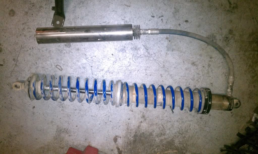

Got my shipment of Bilstien air bumps this weekend and started to really dig into the jeep to get ready for my April 16th race.

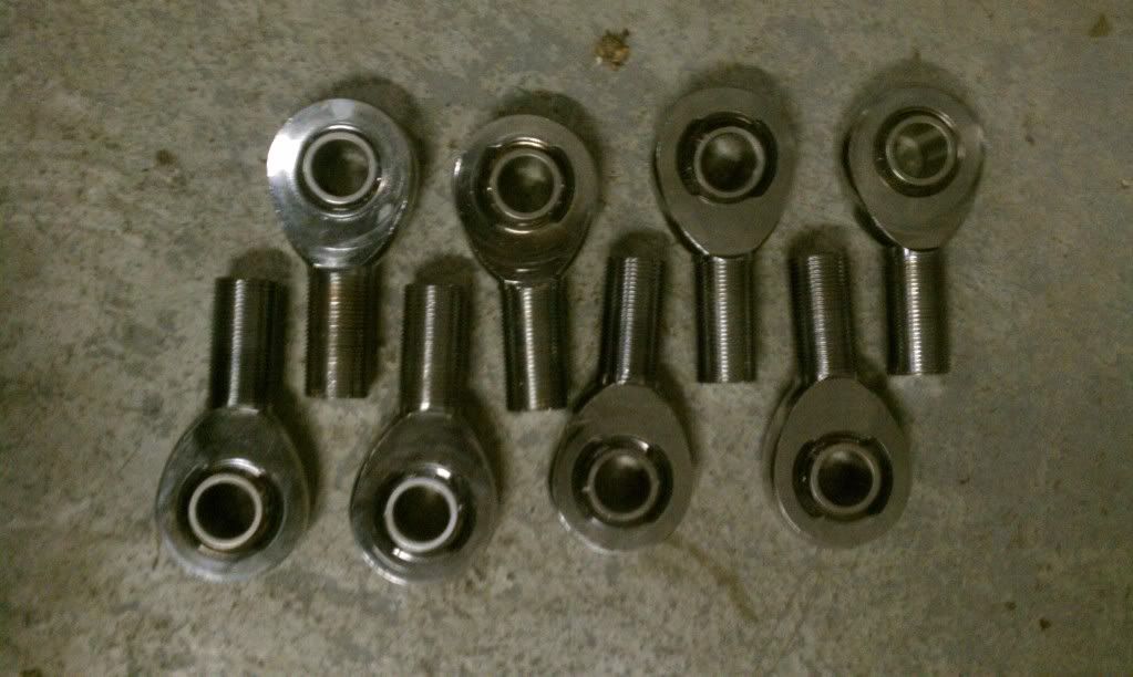

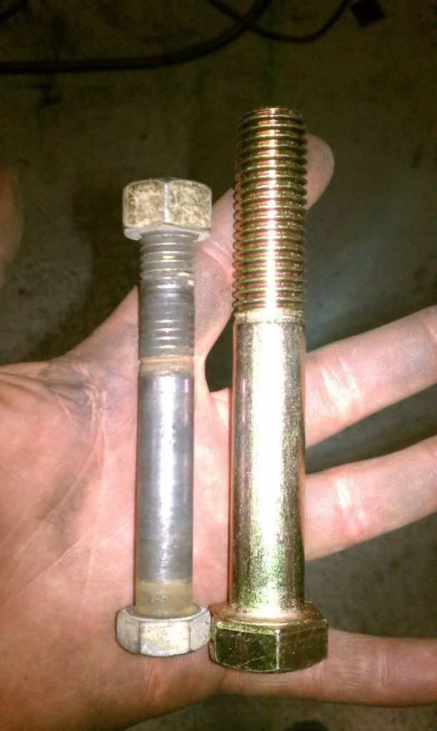

All my Ballistic joints were destroyed so I switched over to 1.25" hiems. And had to make new links.
Also I have been having trouble with breaking studs on my high steer arms and having them loosen up. So I modified the arms to tie into the factory TRE location with a 3/4" grade 8.
Also with the upgrade to the hiems, I go from 9/16" bolts to 3/4". When you hold them, you can see how big of a difference the size is.

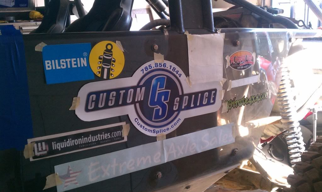

And started mocking up my sponsors.

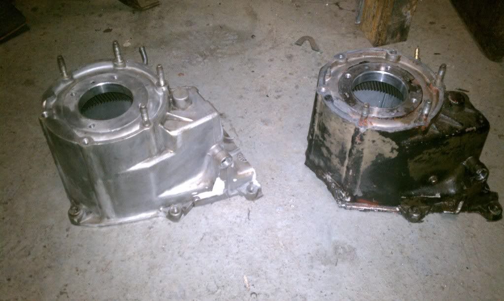

Oh and this happened again to my doubler case. (I have another case that will be going in this weekend)
Much more updates to come in the next days/weeks.

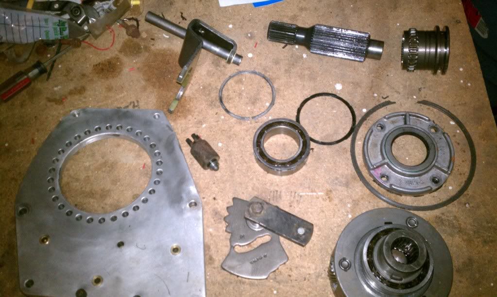

Got the old doubler a part last night and started working on the new case.
New vs. Old

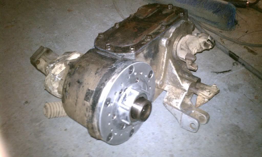

And did a quick inspection of the Dana 300 to make sure everything is ok since I rebuilt it a while back. Also had to take care of some seals since it was leaking.

Also tonight I mounted the front Bilstein air bumps. They will be all finished and welded up tomorrow. I wanted to have the doubler and Tcase in tonight but it has been fighting me all night.

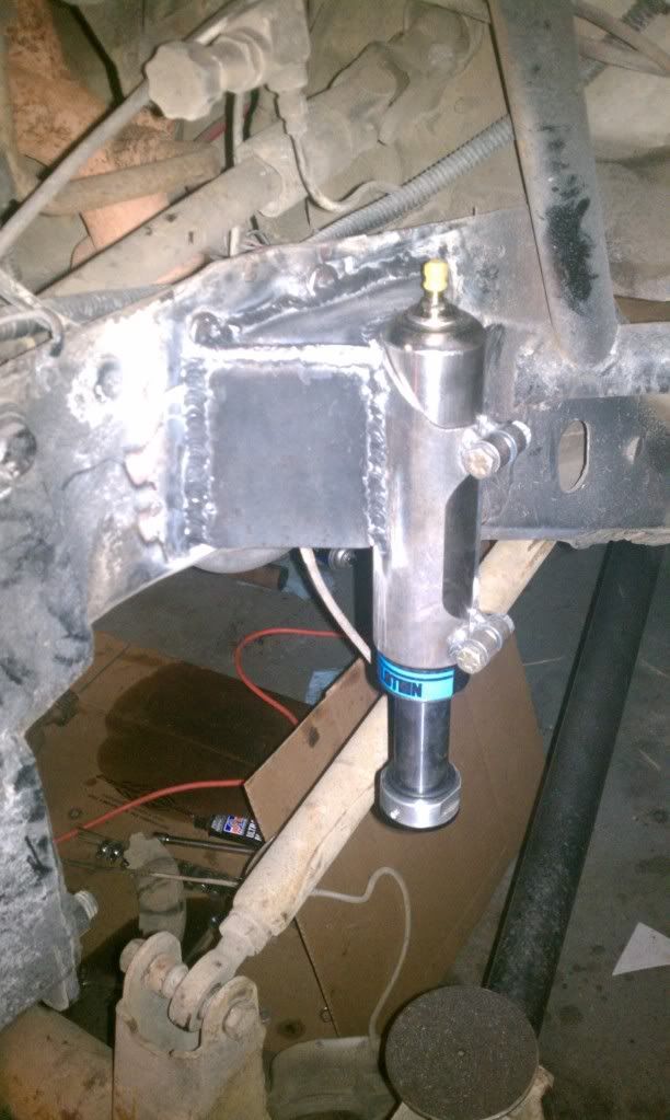

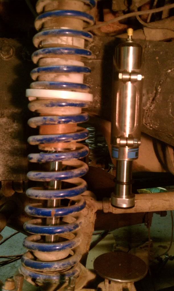

Started placing the air bumps
Then pulled the coilovers and started welding
Welding just about complete.
