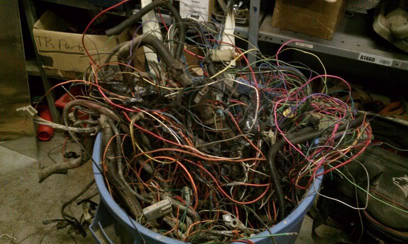

So with KOH coming fast and the Jeep still not running. I rewired the entire vehicle. I am talking everything. All harnesses we cut down and every wire not needed was cut out. I lost many pounds of wire. It was unreal how much crap is backed into these things.
Then I moved onto building a relay and fuse box for my fans, lights, and horn. Came out like this.

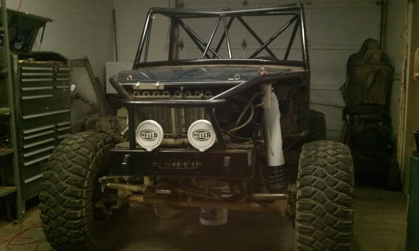

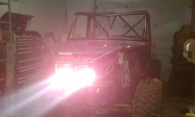

Got the new Hella lights mounted and wired last night. And the new hood on.
Working on a sponsorship with Hella so I can get rock lights and a full light bar up top. Hopefully everything works out. They are very helpful and there products are top notch. Last year we got stuck on Sun Bonnet and found out that the lights were not working. So I wanted to make sure that wasn't going to happen again.
