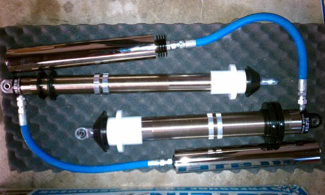

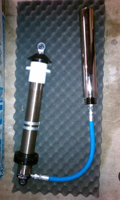

And the shocks that will be on this bad boy
Front
ACV res with heat sink
Front vs Rear
XJ buggy on tons...

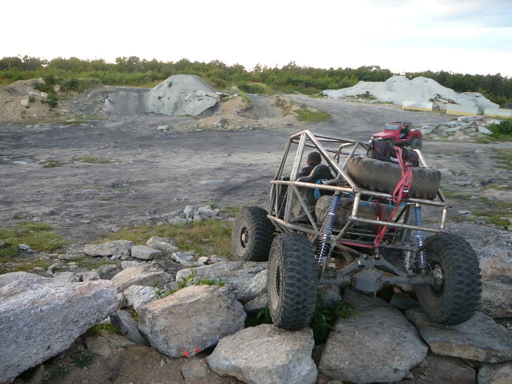

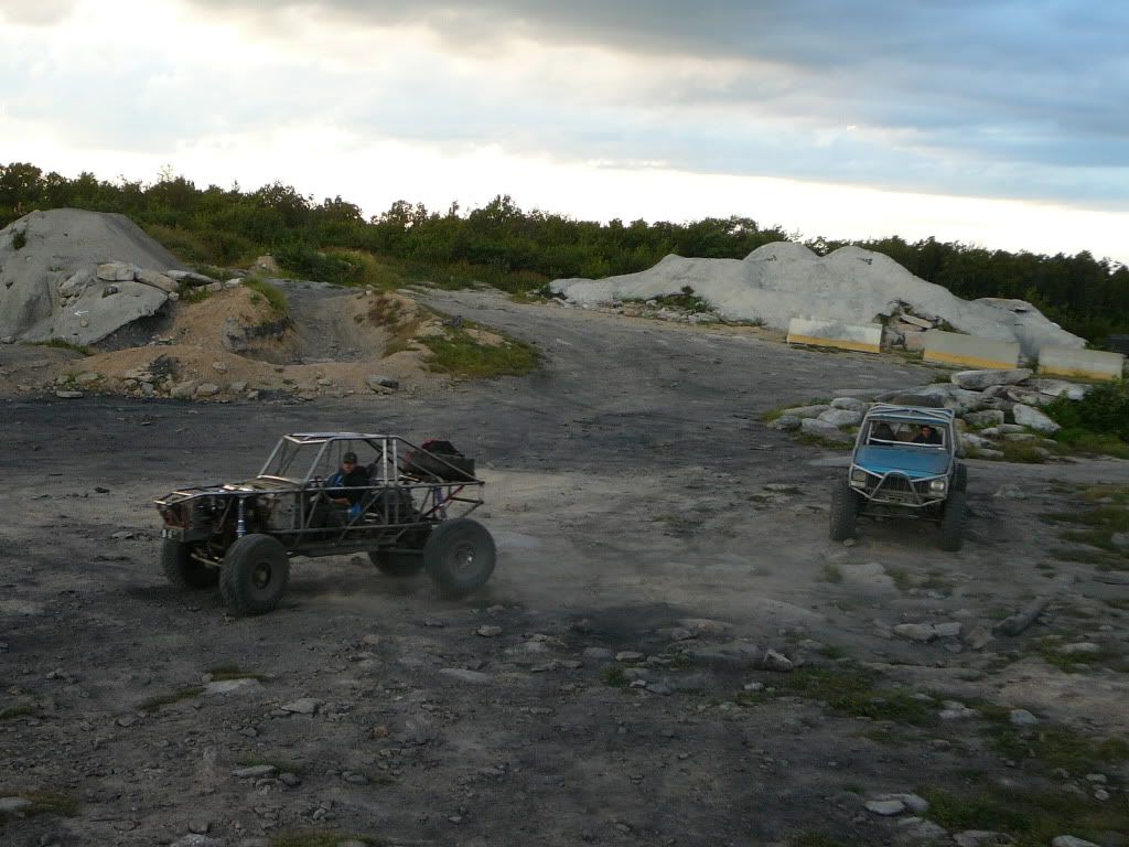

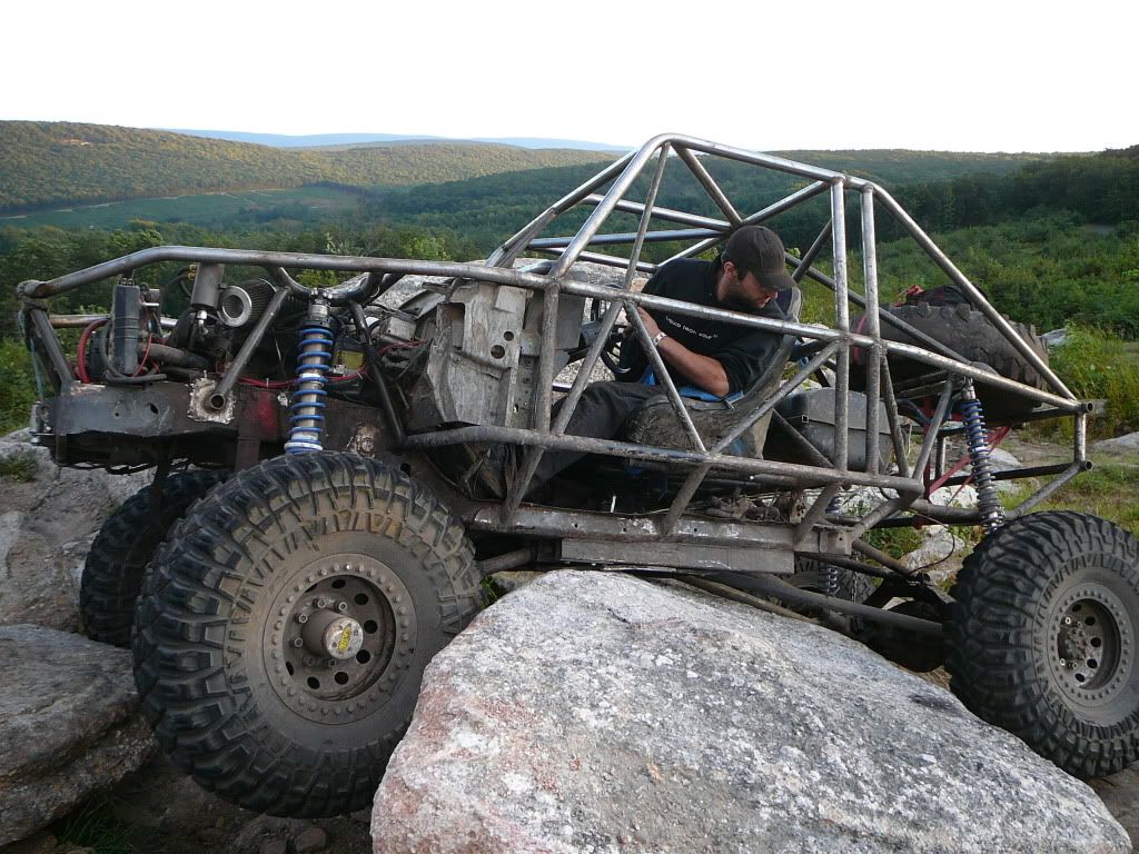

Got it all together and ran it at Rausch Creek this past weekend.
Everything worked really well. Steering is still sucking air but other then that, it was great.
