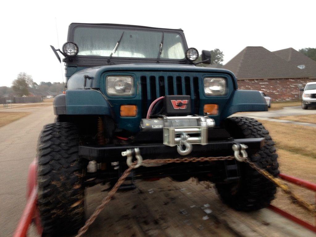

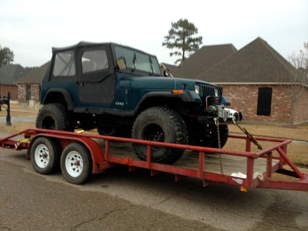

Been wanting to start a build thread on my Project. Plans are to build a good stout driver with decent power cheap as possible. lol as if thats possible!! Here is how my father in law bought the jeep. He made me a deal I couldn't pass up. He bought the the jeep really cheap to rob the motor, trans, lift, tires, wheels, and winch for his jeep. He offered to do all the body work, paint, and bed liner on this jeep (he's a body man) then sell me the rolling chassis for $1500 so the project started for me.

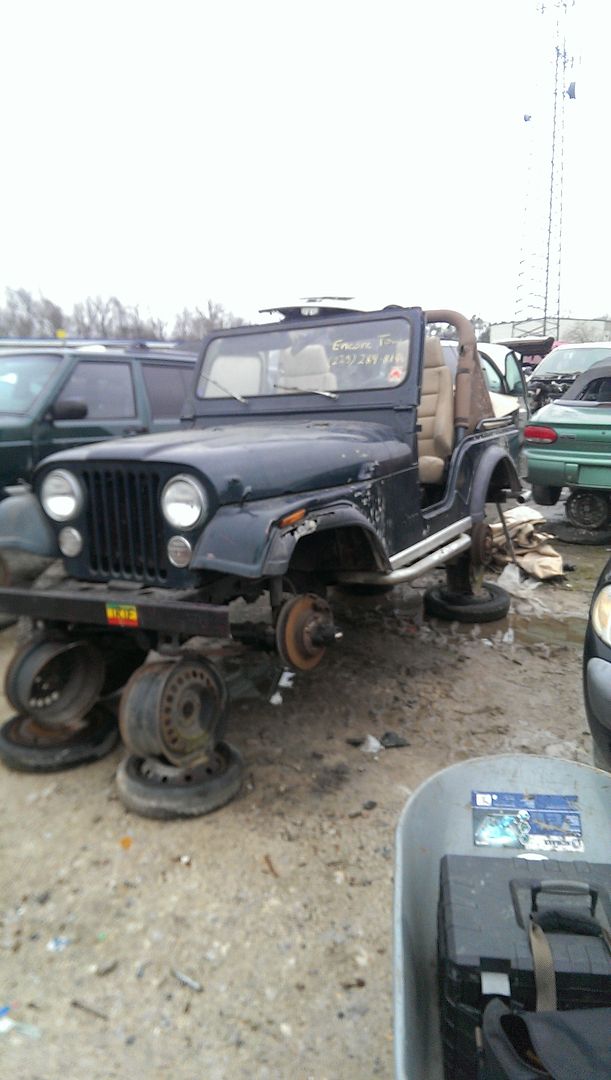

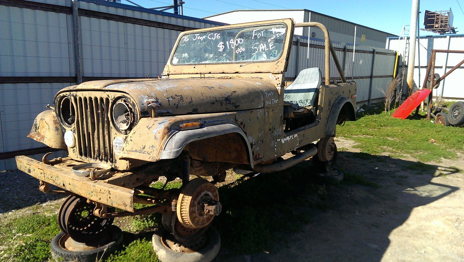

So I'm a junkyard rat and started searching for parts and some ideas. Here are some of my finds.

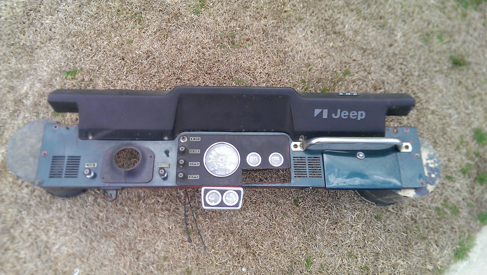

CJ dash to swap in because I hate the YJ dash I also got all the Heater ducks, blower box, windshield, and cut the top off the cowl to graft onto the YJ tub so the defrost vents would line up.

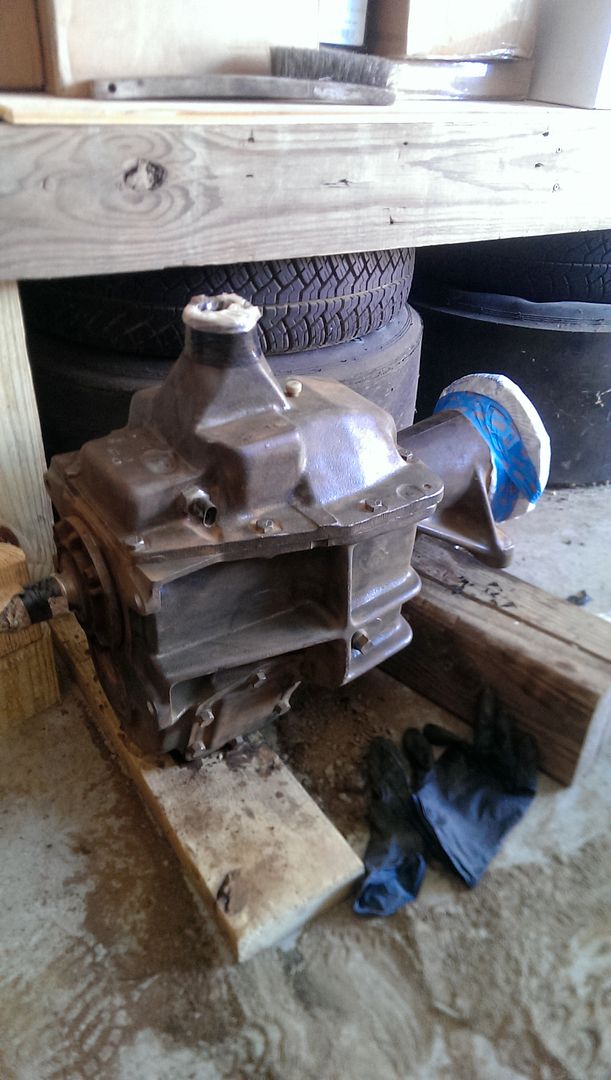

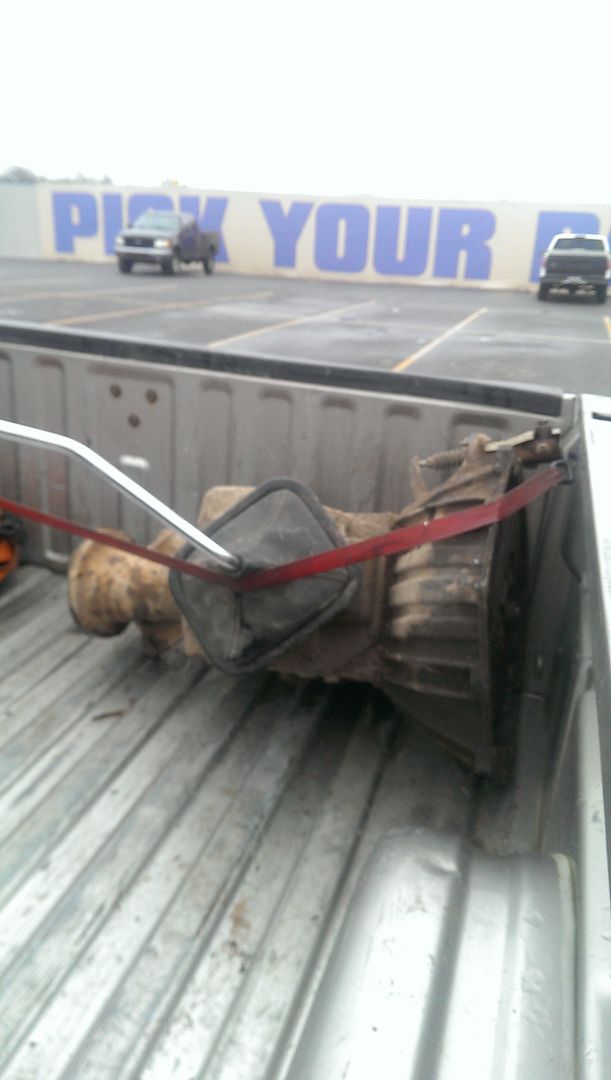

Got a SM465 out of a 1986 C10 with the hydraulic clutch.

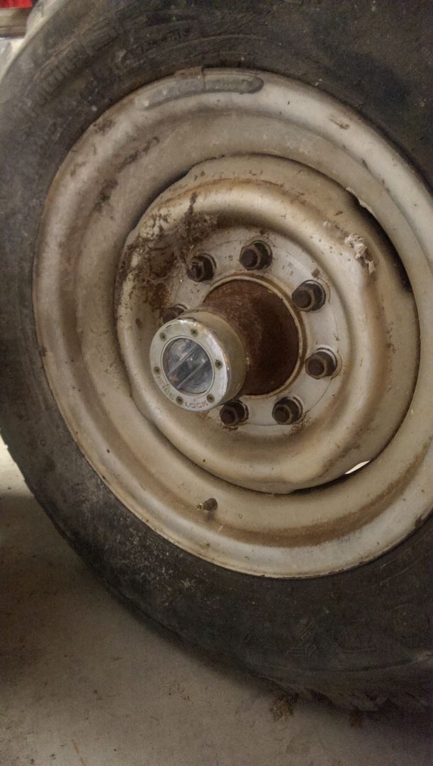

I know its just a 10 bolt but will work for now until I can afford a Dana 60 Down the road, don't think I'll find one of those in a Junkyard ever. It's a 30 spline 8-lug 10 bolt out of a 1991 3/4 Suburban so should hold up ok under the jeep. Only has 3.73 gears so those will have to get changed to match the rear.

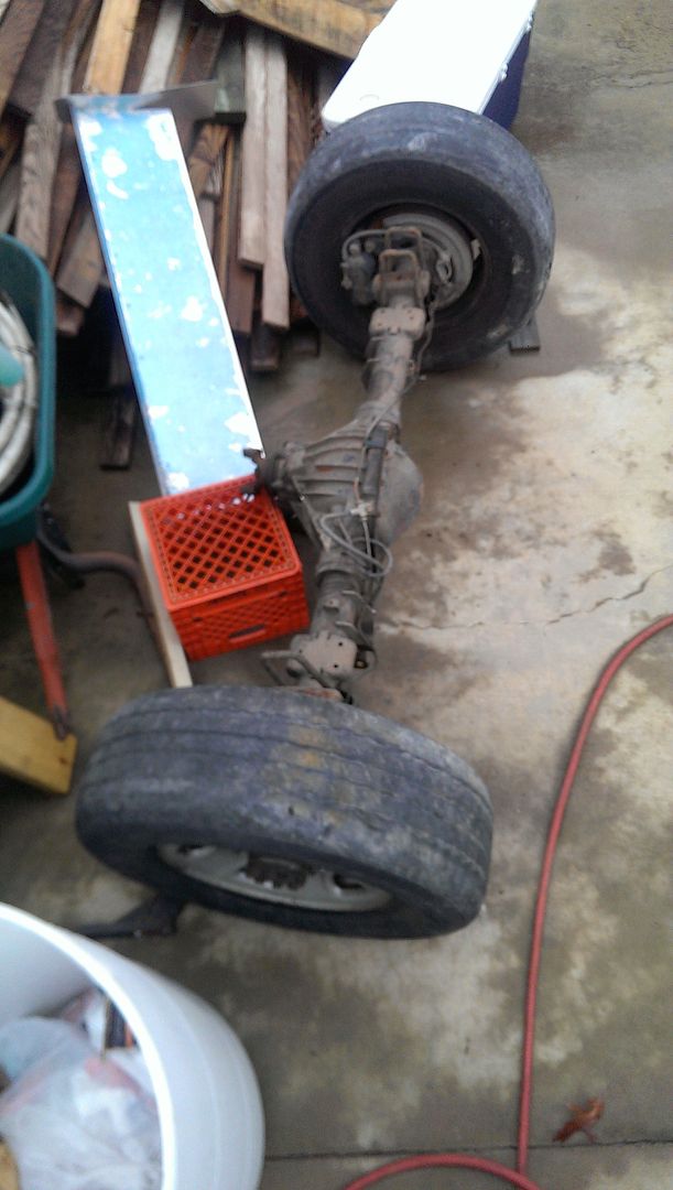

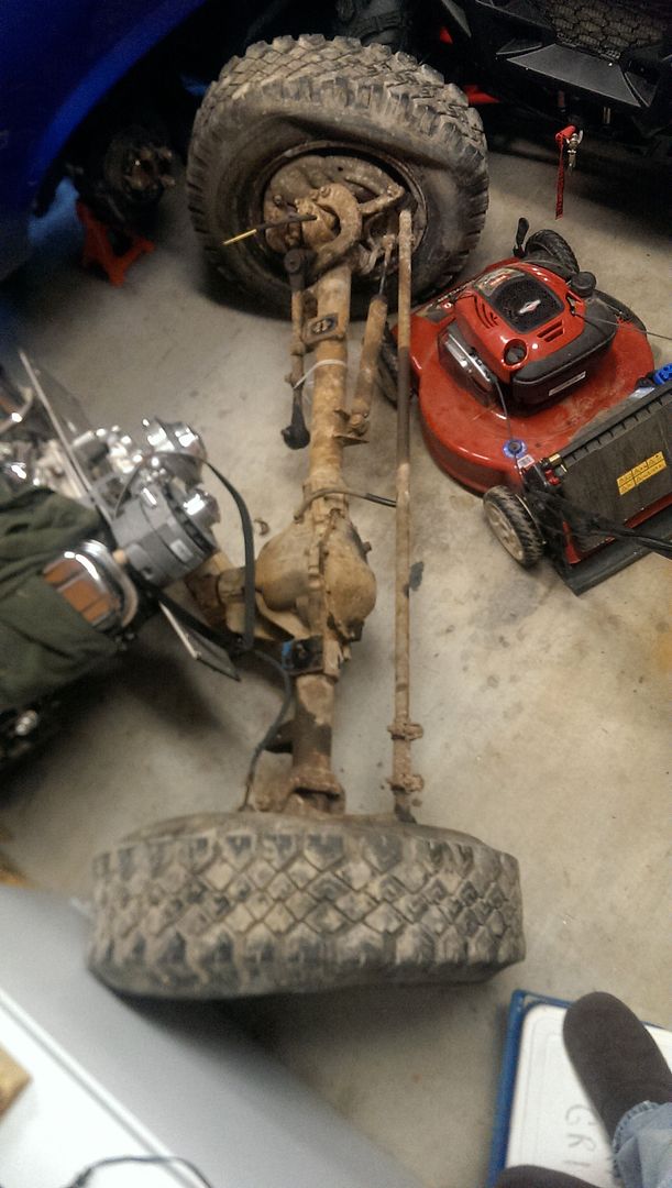

AAM 14 bolt Full Floater from a 2001 Silverado 3500 with 4.10 gears and open carrier. Gonna stick with these gears and ad a Detroit Locker. Went with this one instead of the earlier 14 bolt for the factory rear disk brakes and E-brake.

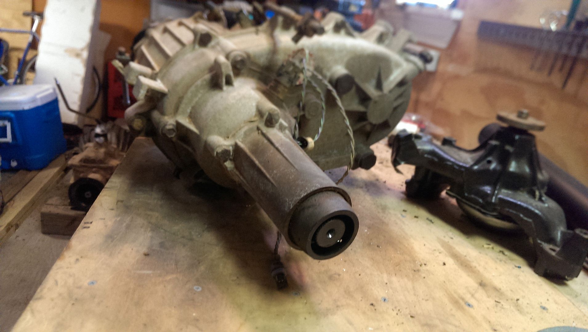

I also got the NP241C from the 1991 Suburban and a NP241D from a 1993 Dodge RamCharger. The idea is to some how utilize the Dodge one so I don't have to buy a SYE.

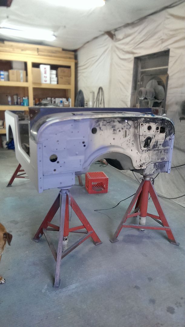

On to the body work. Don't have to many Pics of the beginning stages of work, didn't think about taking any but heres what I have.

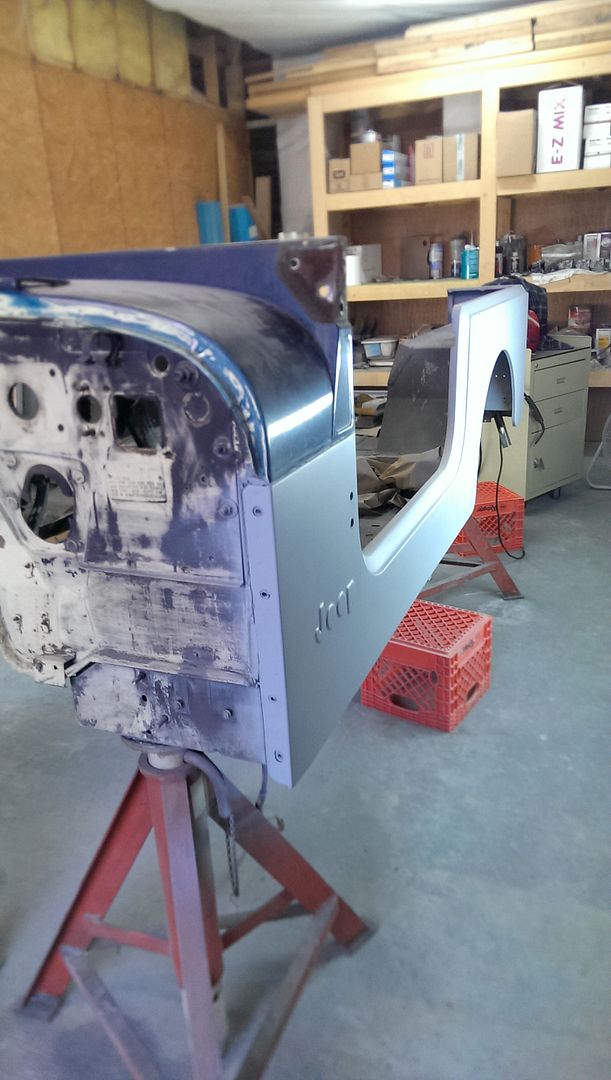

Here's where I grafted in the part of the Cowl from the CJ thats different then the YJ where the defrost goes into the windshield frame.

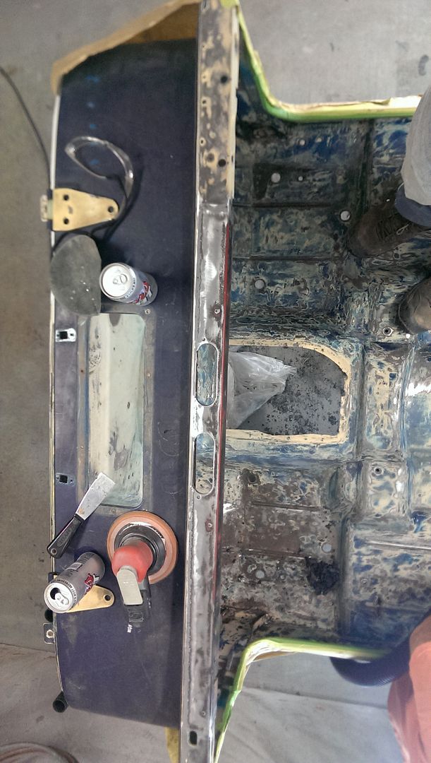

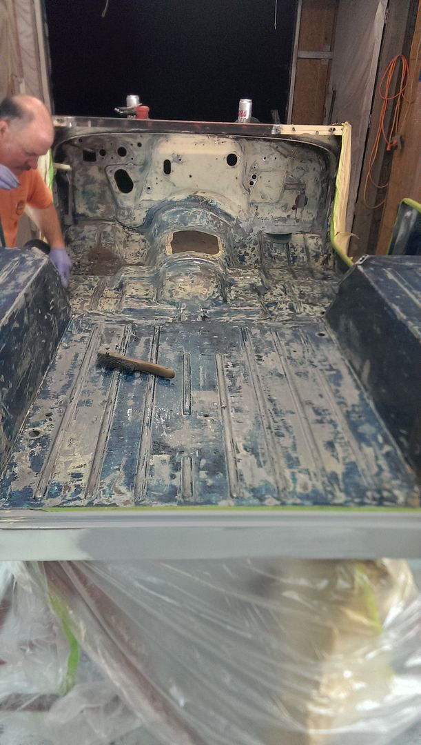

Stripping old bed liner from the tub was the hardest part of prep!!!

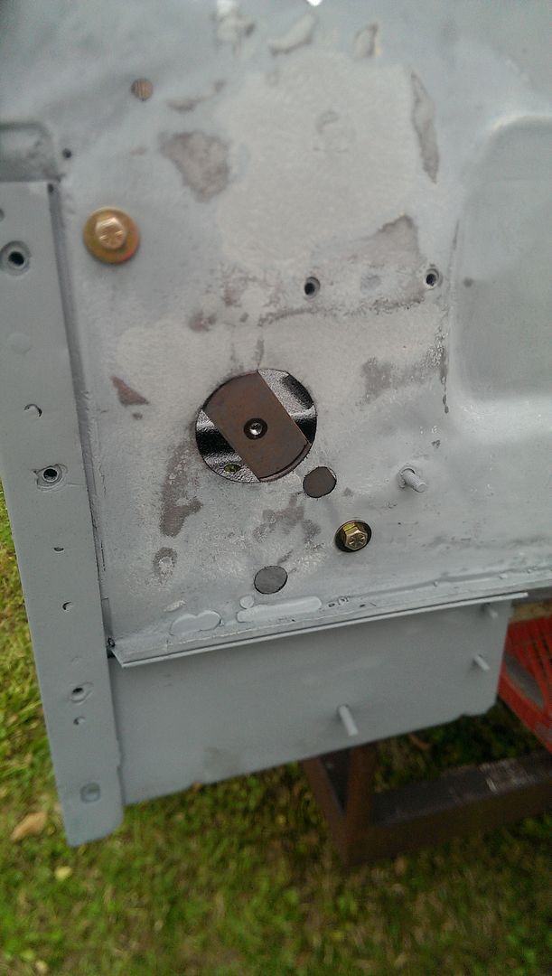

Wish I took more pics on how to do this but hopefully you can get the idea. Cutting the new hole for the Larger heater blower motor. Used that piece of flat bar for a center so the pilot bit on the hole saw could stay centered.

Body is primed and bed liner done!!
Under Coating next, sorry don't have finished pics of this
Got the holes cut for flush mount brake and reverse lights.

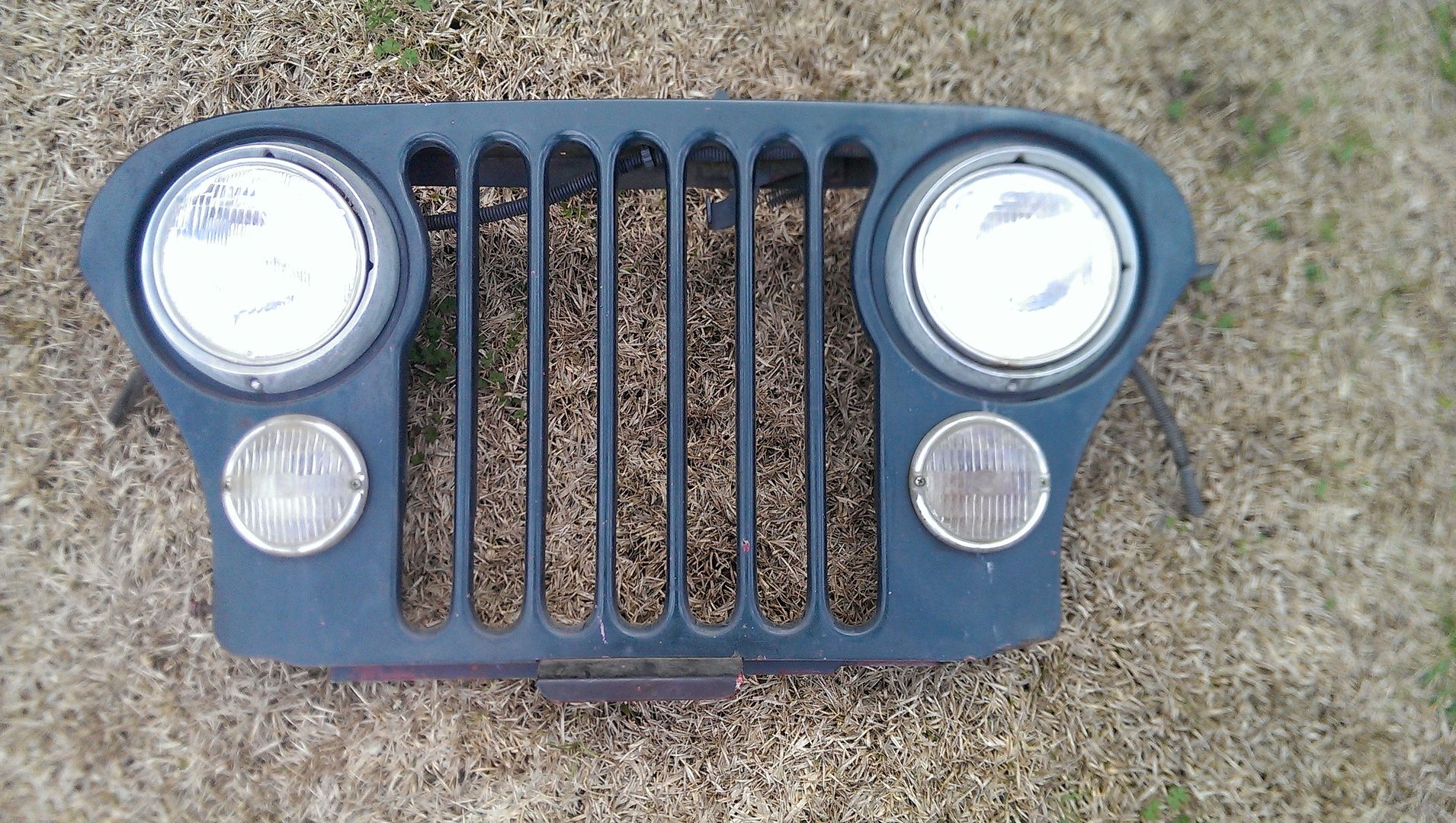

OH, decide to stick with the YJ grill. The square buckets have grown on me.

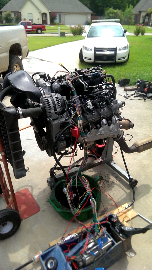

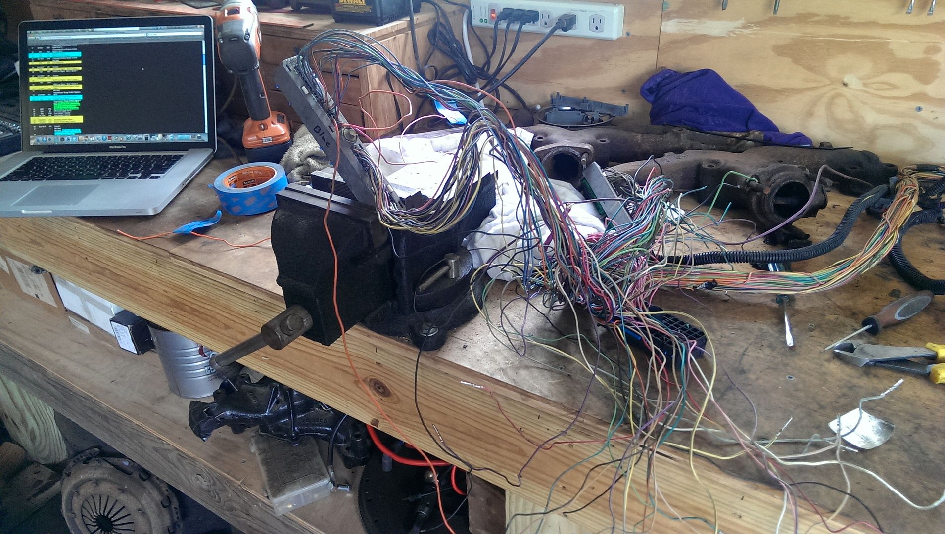

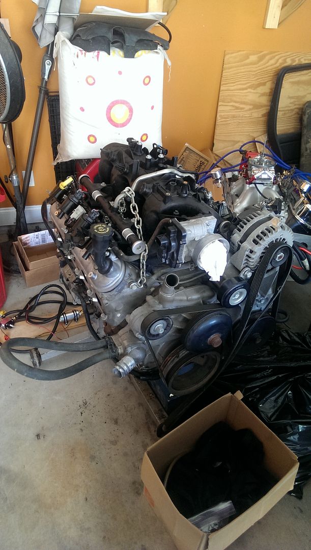

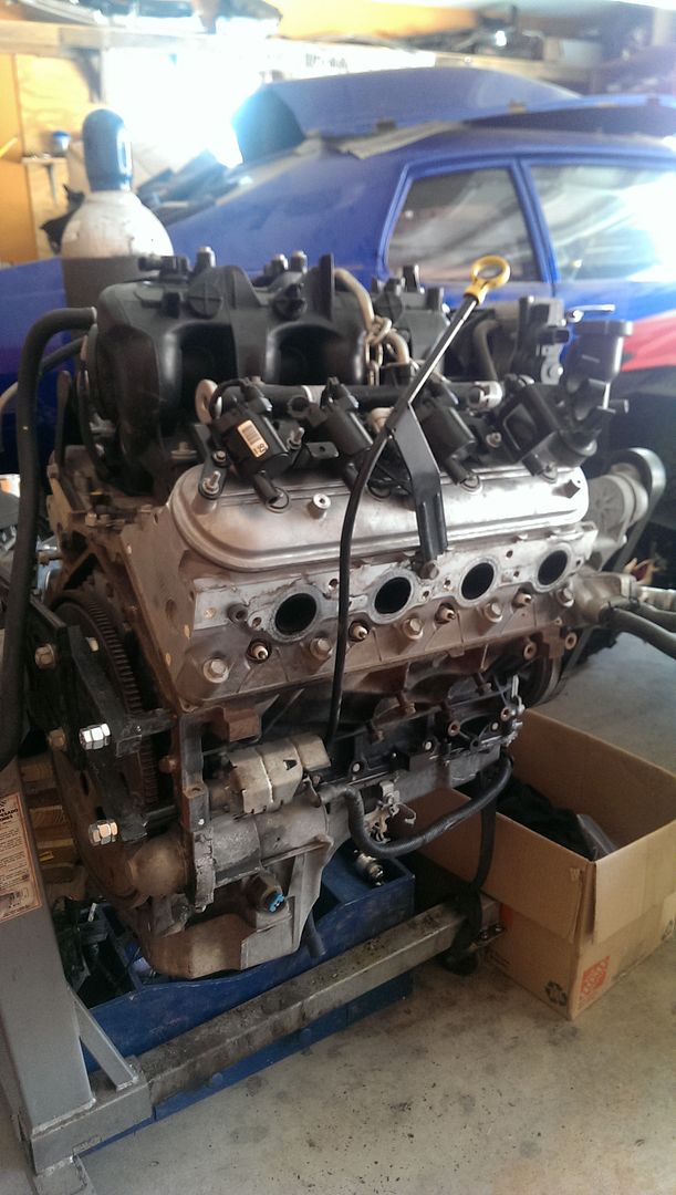

So was gonna go with a LM7 5.3 from a Junkyard because it would have only cost me $250, and found a couple but not that just right one yet. Was on CL and came across this Gem. Its a 2006 LM7 5.3 Complete PCM and harness for $600. The guy said 78,000 miles and that maybe but I pulled the valve covers and oil pan and it looked brand new, still shinny metal.
Here's the bird nest of wires I ended up in making the standalone harness lol. Big thanks to Brendan Patten at LT1swap.com for the "how to" on his website and reprograming of my PCM. Here's it is running on the stand testing the harness before I buttoned everything up.

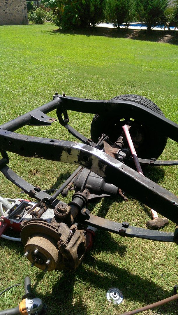

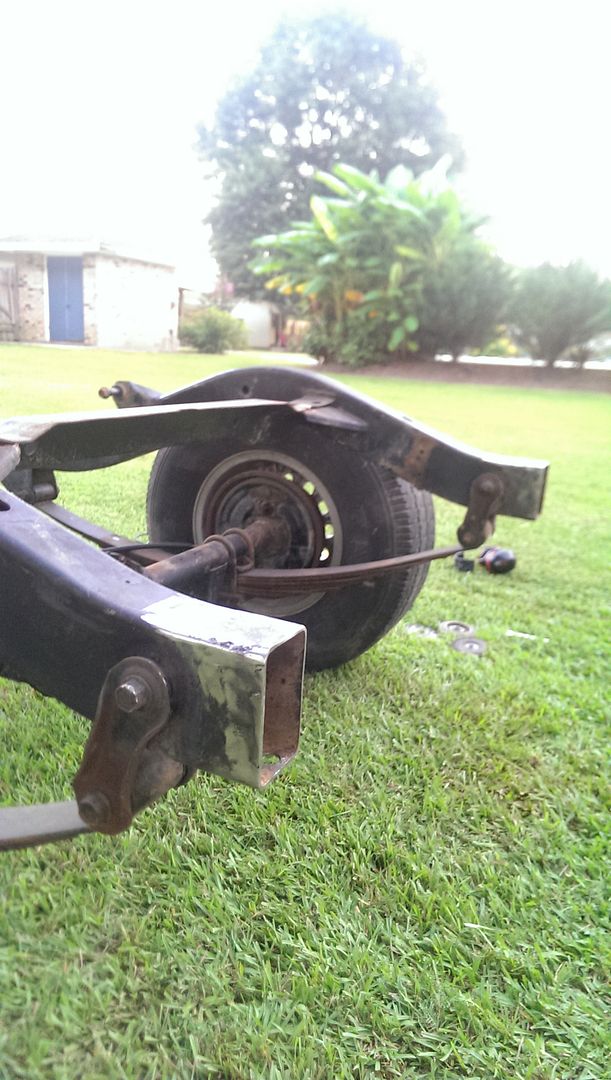

This is the product of two very very long hot days of grinding and swinging a BFH. Got all brackets removed that I could, so when the new stuff gets here all I gotta do is remove some paint and weld em on. No more sway bar or track bar crap. Incase your wondering I took the shock mounts off because I'm going with the F-250 mounts.
While I was at it removed the old bumper that the previous owner hacked up.
