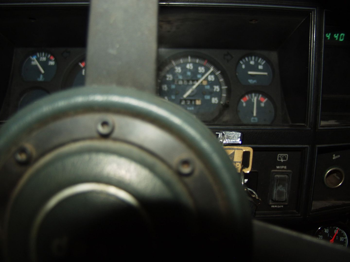

I mean, its stable enough to go 65mph down the highway. (I was at 65 but was slowing down due to my turn coming up, lol) Dashboard oil pres gauge is busted btw.. (see the mechanical gauage located in the bottom right hand side)

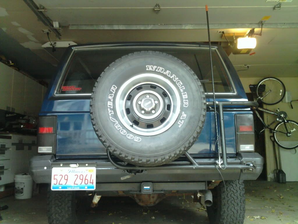

So quick update, finally relocated my license plate since it was blocking my tail light before. Also mounted my CB antennae, but remains unconnected until I install the actual radio unit.

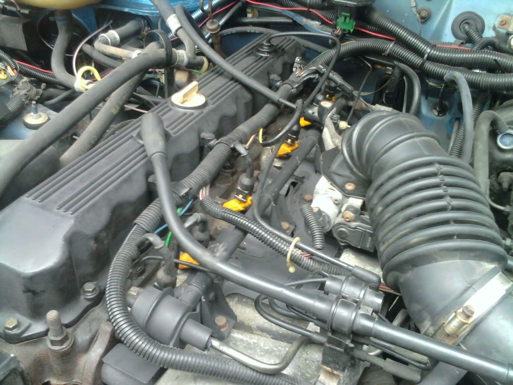

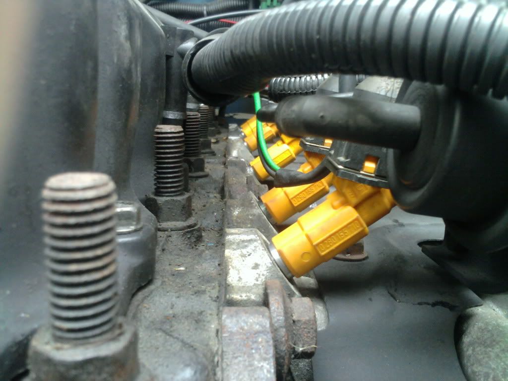

So the first "real" performance mod I did was the 5.0L 19lb mustang fuel injectors. They supposedly create a better fuel mist by using 4 holes instead of the stock 1.
Mustang Injector (:
Stock Injector (-)
Since I had to take out a bunch of stuff to install the injectors, I decided to repaint the metal to make it look nicer
Here are the Mustang injectors after being installed
Another fun fact about my jeep is the alarm system. I never knew what this little black box did until I "armed" it... Apparently once it is armed and the doors are closed, the alarm will sound about a minute after any door is opened. When it is armed, the hood locks shut so no one can pop it until the system is deactivated. Pretty sweet tech for 1988

I know its 6 pages and 3 years later but does OP or anyone else know what year to get those 5.0 injectors? Its driving me up a wall cause I keep finding part numbers and the boobs at Advanced Auto dont know what to do with it. I want to be able to say 19xx fuel injectors and just walk away happy.
Wow I cant believe its already been three years.. as it turns out your in luck. The injectors I used were from a (1990-94 model) 5.0 mustang. They have the 19lbs pressure rate. I would suggest finding someone on ebay who refurbishes sets; IMO its better than buying used ones and then buying all new seals for them.
If all else fails, you could look into the dodge neon 19lbs fuel injectors, i think they have 4 holes as well.
Hope this helps
Hope this helps
Thanks bud! I heard about the Neon ones too. A friend of mine got 3... only 3 of them for an 87 xj he had and then ****ing sold it. Id rather go with the 5.0 injectors because its sounds meaner than Dodge Neon... anyway thanks again, you save me from a massive head ache.
