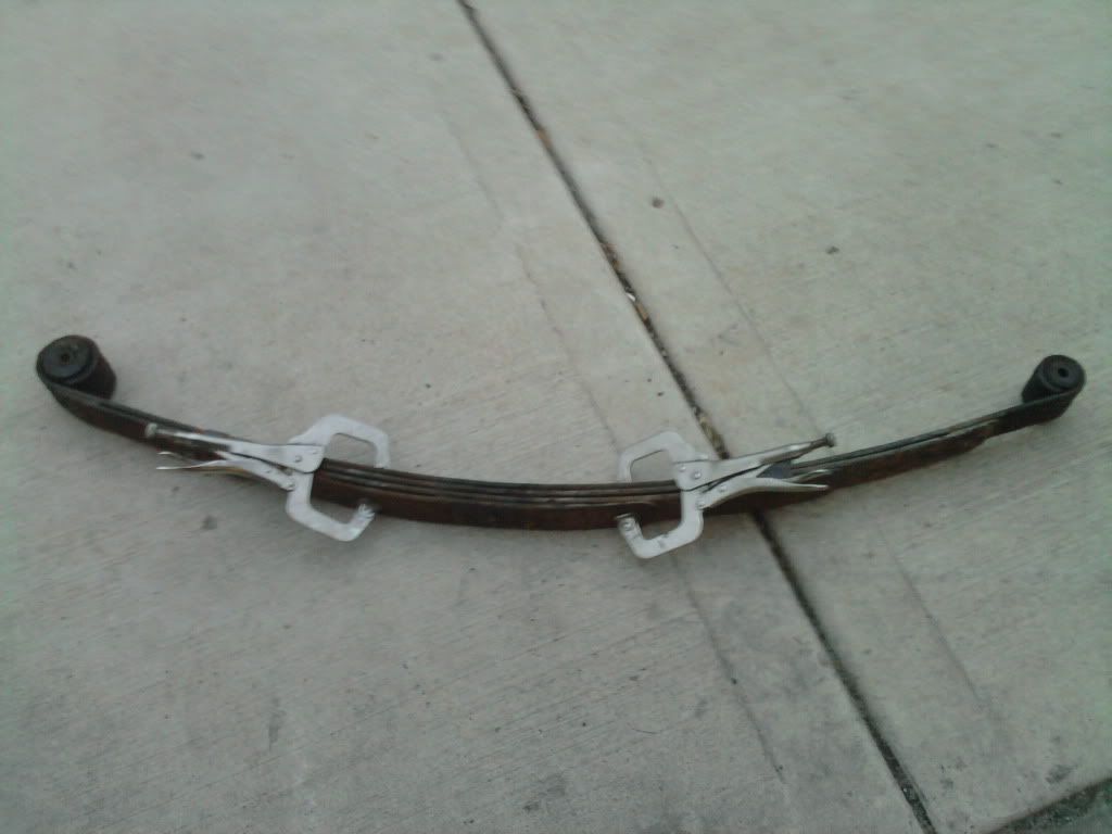

So i originally thought that the rear leaf springs would be easier to do than the front coil springs.. i was wrong. took me 2 days to do the first leaf spring, but once i figured out what i was doing, it only took me 1 long day for the second.
What i was lookin at before anything was done
Original leaf spring before the AAL
After the AAL was installed and new centerbolt tightened

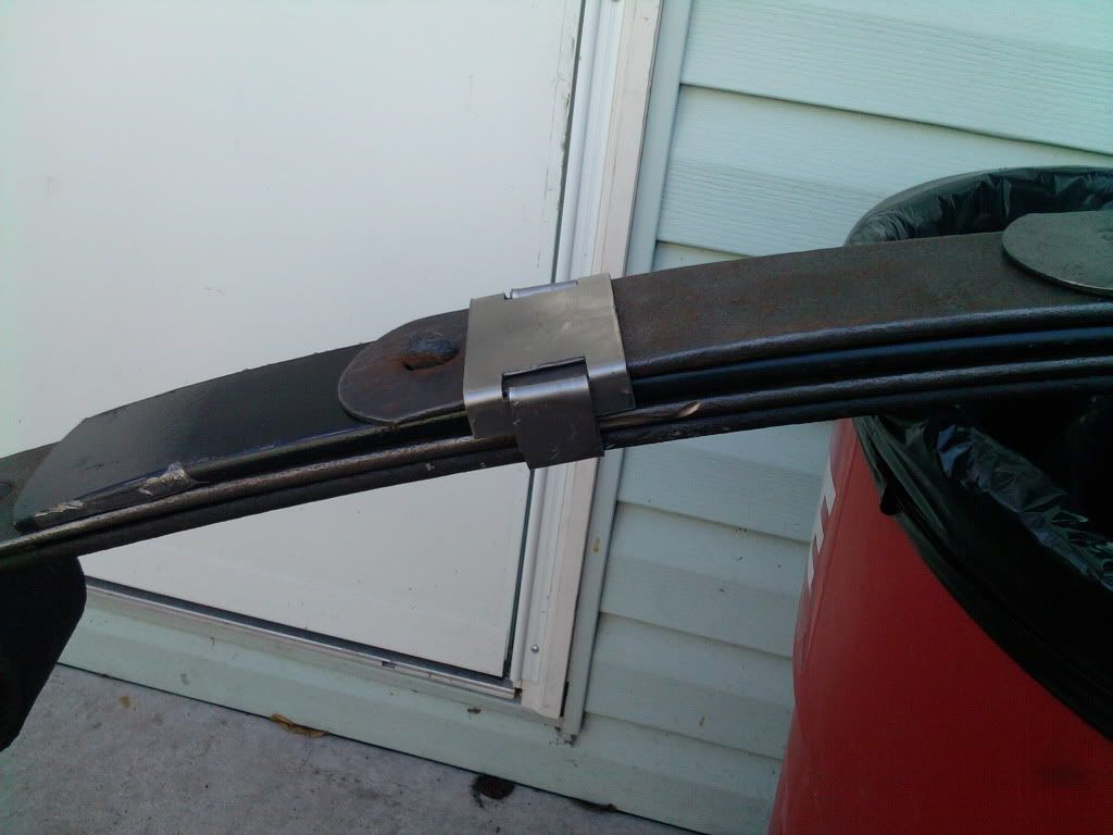

The kit included new clamps for the leaf springs.. i dunno if i used them right, but they work, and are pretty damn snug.. so lets hope they hold. [The eclipse is my other *headache* project]

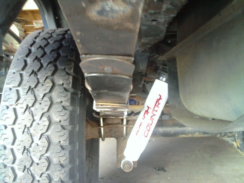

After rear shock and "new" leaf spring was installed. [And before you give me crap about how i bolted the leaf spring plate on wrong, i realized it after i did it, so i had to go back and fix it]
Getting the original steering stabilizer out was probably the most pain in the *** part of the whole project because of the friggin tapered bolt-hole. i ended up getting lucky beating it with a bfh and it finally came loose. Soo new steering stabilizer installed

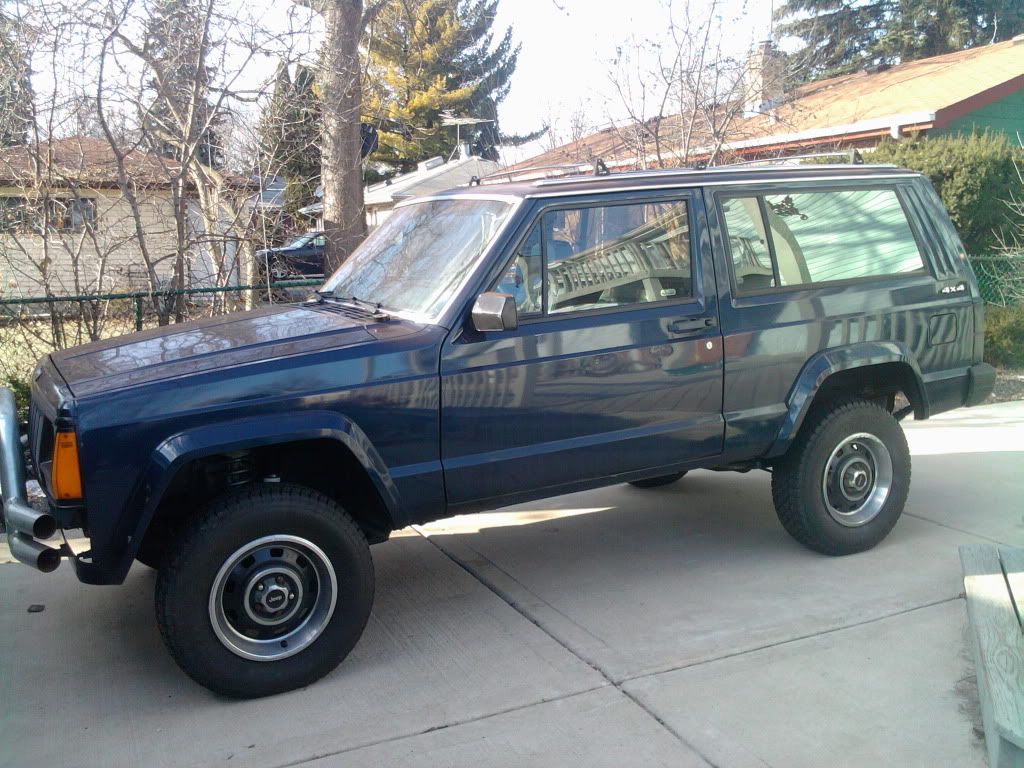

PART III -=Final Result=-
So now my baby is an extra 3" higher so i actually have to 'step up' to get in her. ....i will smack whoever turns that into a "thats what she said" joke..
Closer Up
Overall it took me 5 days, and my hands look like i put them through a shredder. But it was worth it =]

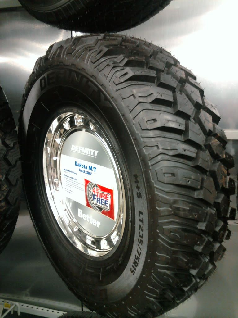

in order to run 31x10.5 means i would have to get rims that are 10.5 wide right? or am i having a total brain fart with the tire ratio.. but if i am right, the rims i have now are only 8 wide and i dont see getting new rims anytime soon.. I did see these at Pepboys last time i was there and they caught my attention.. no idea how much they cost tho

1990JEEPXJ
1990JEEPXJ's Avatar
1990 XJ Cherokee
Location: San Diego, CA
Posts: 7,157
you can use your stock rims with 10.5" wide tires.

No you don't need 10.5" wide rims, lol. Many people run 12.5" wide tires on 8" wide rims.

Your stock wheels are 15x7 and yes they are fine with a 31x10.5 but the back spacing is wrong. Tires will most likely rub when turning sharp.
