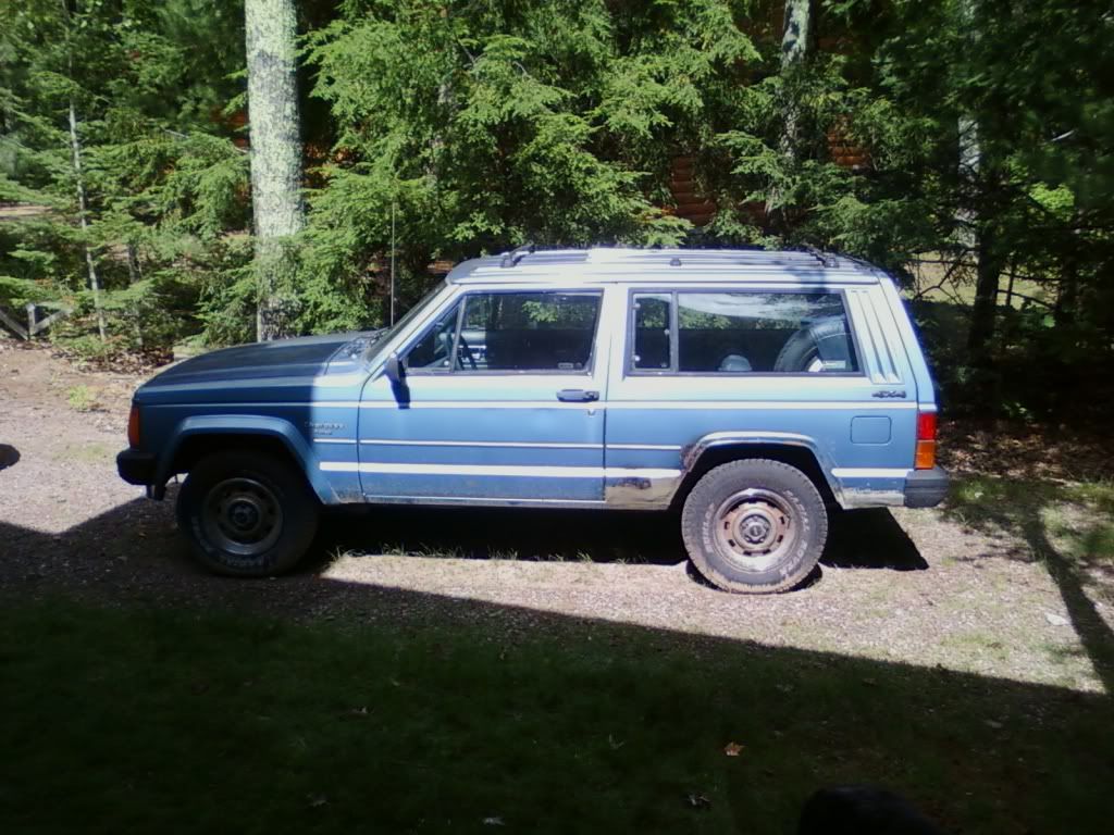

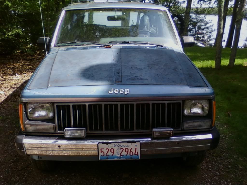

So for as long as I can remember, my family had this old jeep rotting away at our lakehouse. We basically used it to get the boat in and out of the lake, and for the quick trips to town. Anyways, years of abuse and neglect left their mark. This is what I started with:
Whats left of my very first attempt at fiberglass/bodyfiller
Notice the damage from the fallen tree on the roof rack
Busted fog lights and sun-damaged babyblue paint
Cracked Passenger Fender Flare, Roof is dented from a tree falling on it (miracle the windshield did not break)

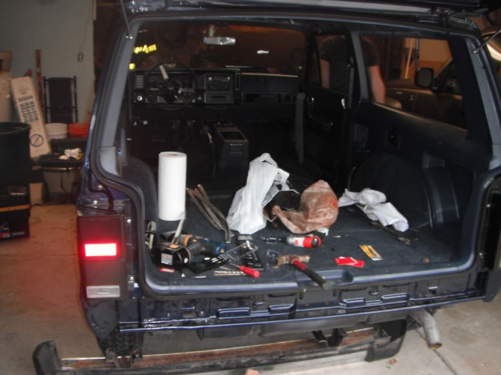

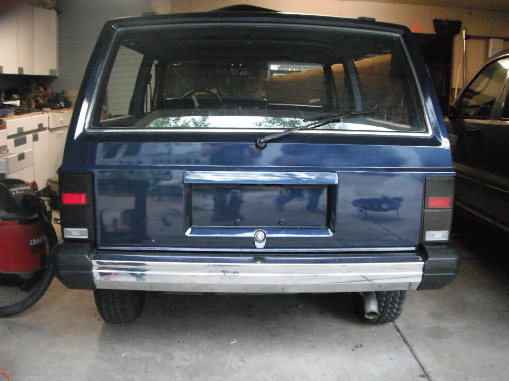

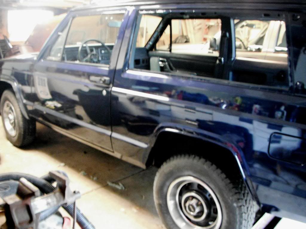

So after driving my jeep roughly 6 hours home (typical trip time from lakehouse to actual home), I realized that there was literally just carpet separating my feet from the road. Once I got the jeep home and stripped the carpet out, I found that the floor had seen much better days. Sadly I do not have any photos but there was no floor left on the drivers side by the pedals. I ordered a replacement floorpan and put it in. At that time I did not have a welder so I ended up bolting the pan to the frame, caulking the seam, then fiberglassing over the seam. Worked good enough for me. I then used rubberized undercoating spray to cover the entire floor. Once I had the entire jeep down to the frame, I took it to Maaco to get it repainted. Ended up getting a darker blue to keep it matching with the blue interior. After painting:
I called in a favor from my highschool autos teacher to use his blastchamber to clean up the original rims, then bought some enamel paint and sprayed them black. I saved the original chrome trim pieces and reused them as well
I didnt like how the tailights "stood out" by being so brightly colored, so I got some tinting spray and tried it out. For a first attempt, Im quite happy with the results

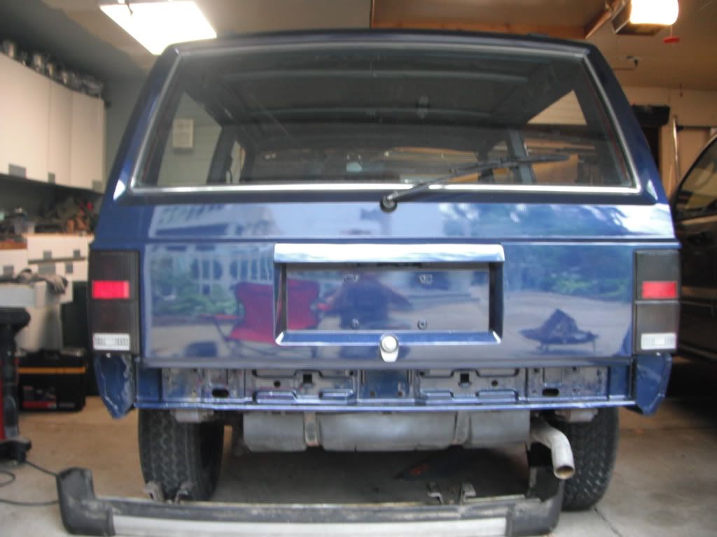

Finished rear with bumper installed

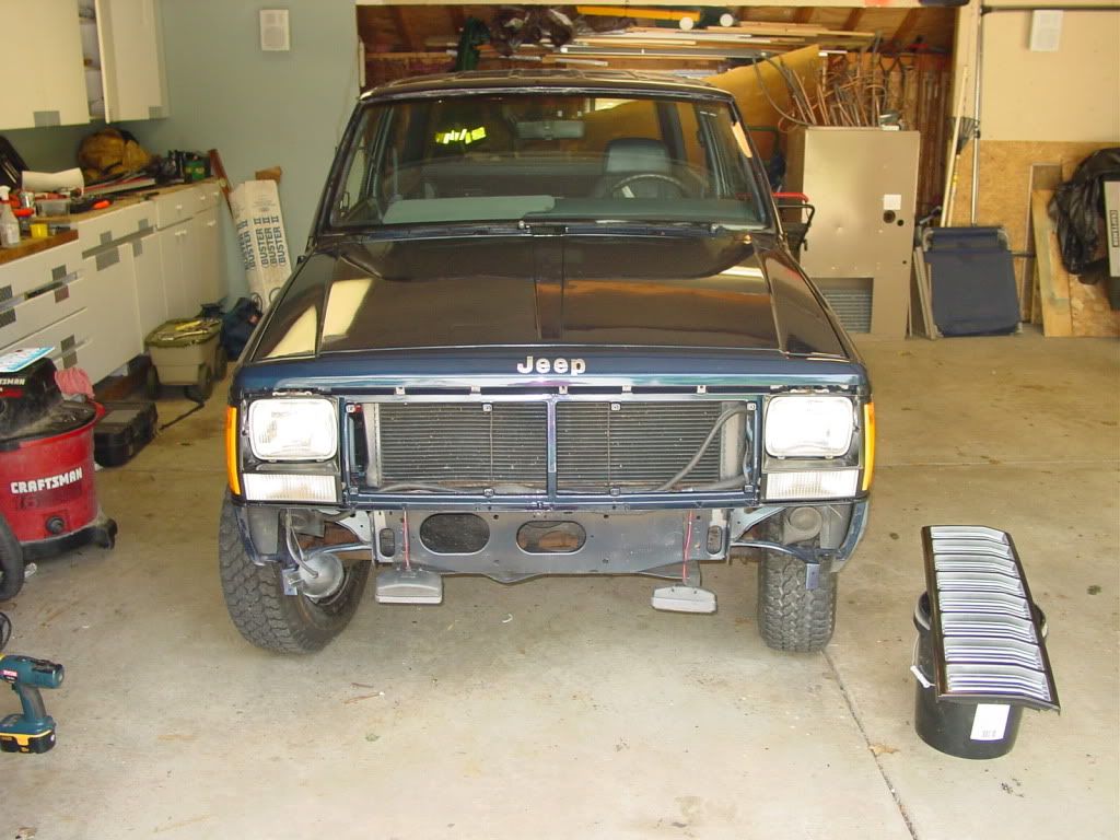

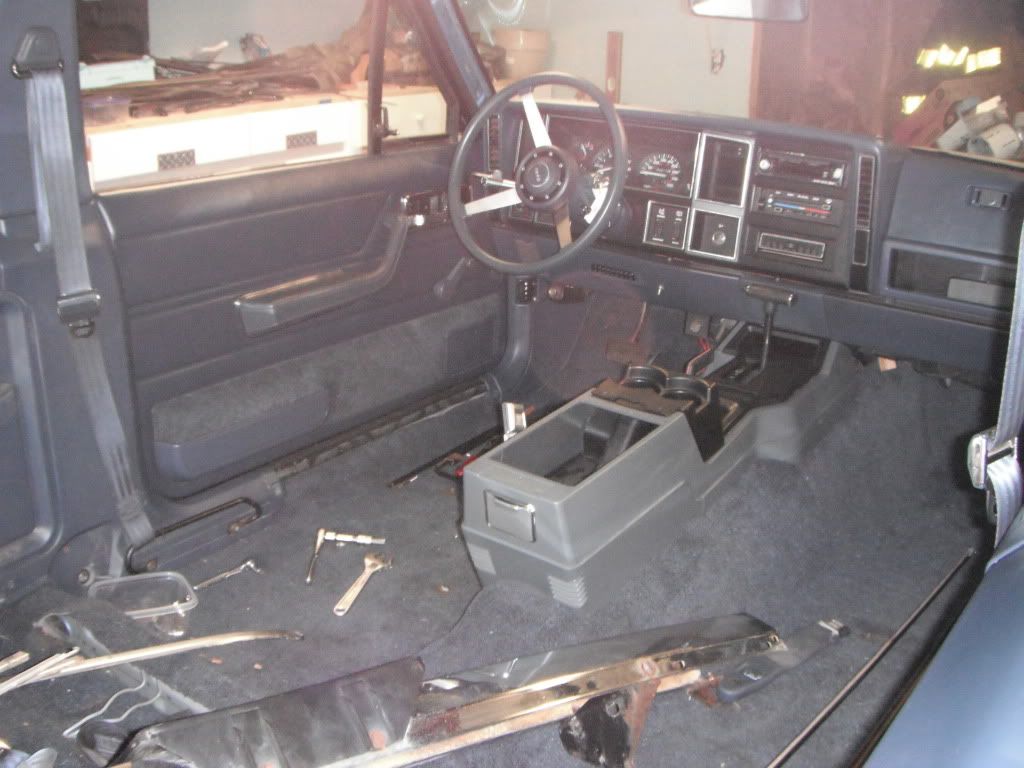

I became a fan of my "local" (45min away) junkyard because I found a lot of goodies for the jeep; including a replacement passenger fender, whole center console, updated instrument cluster (replaced original '88 one with a full '9x cluster), cupholders, headliner base, headliner speakerbar, and others I cant think of at the moment.
After the "new" centerconsole was installed; the jeep originally did not have a center console, instead it had little trim pieces around the Ebrake and Shifter
Had to take some steps backward to finish a few things I forgot, like taking the rear bumper off again to put the hatch gasket on

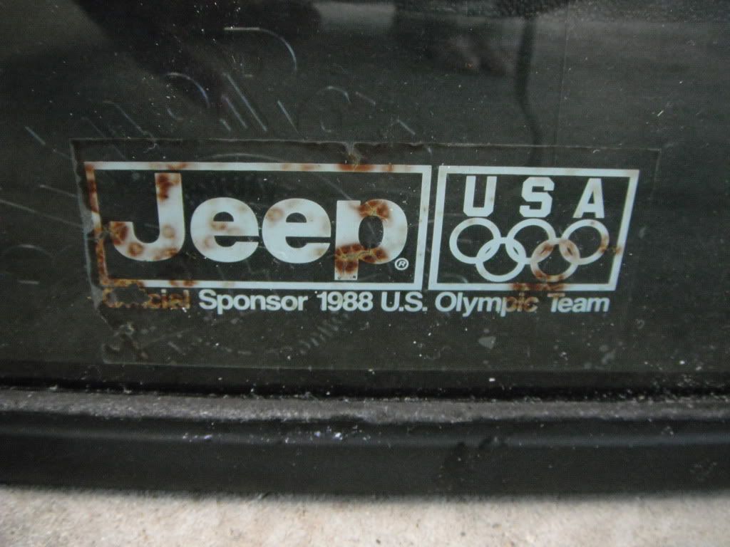

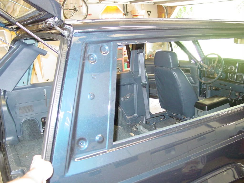

Since I like doing everything myself, I attempted on putting the cargo windows back in... which was a mistake. I ended up shattering one of them. I got a replacement pair but they are tinted so I wont be able to reuse the awesome decal which came with the jeep
Before cargo louver
After cargo louver

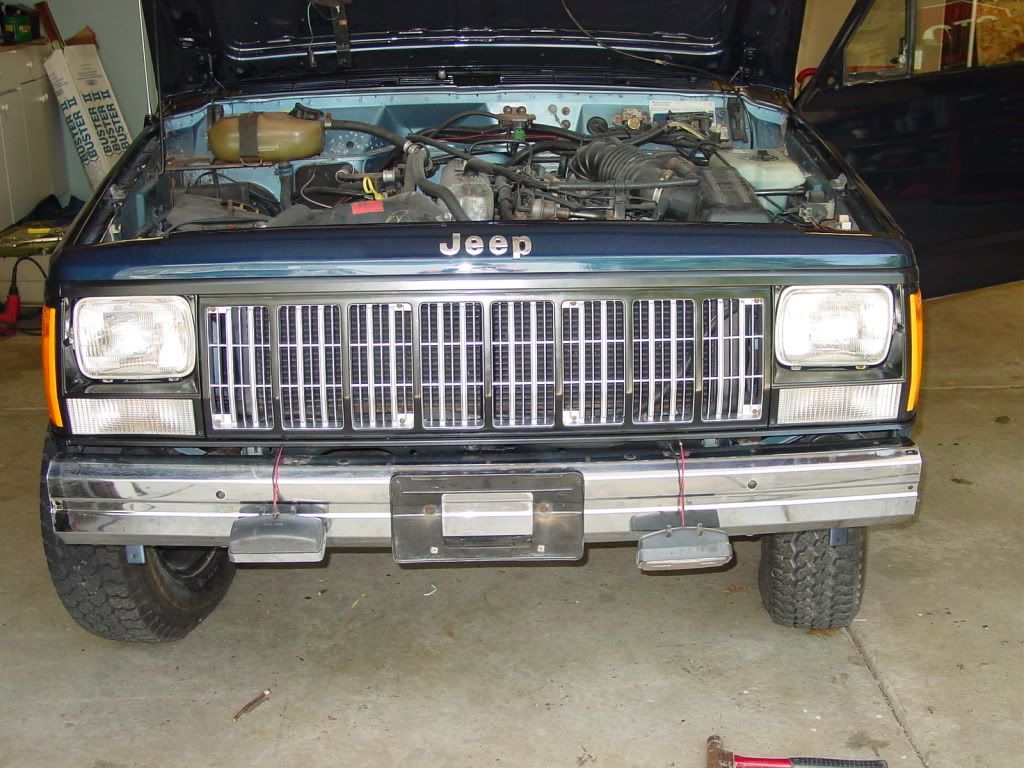

While I had the plastic trim off from the lights, I decided to give it a fresh coat of black paint, then reassembled them and put the lights back in. I also repainted the grille
After the grille was installed. I did a base black, then taped off the majority (took for friggin ever) and painted the inner portions silver.

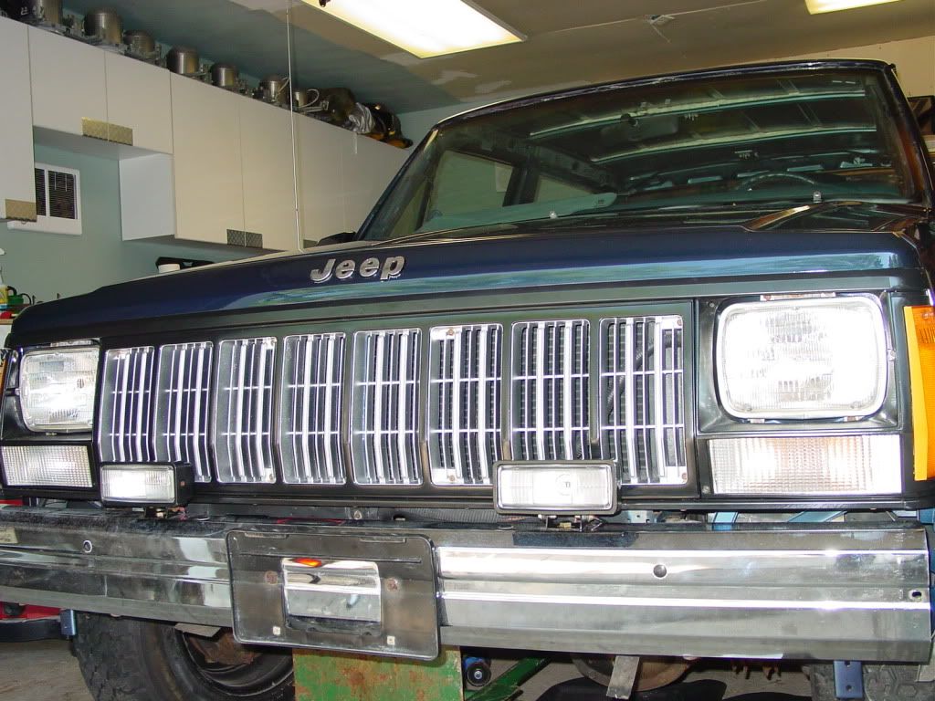

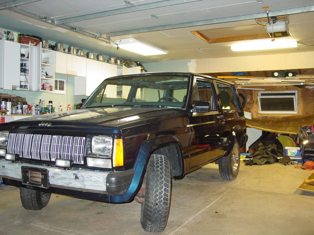

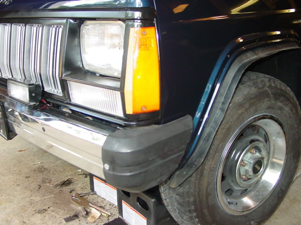

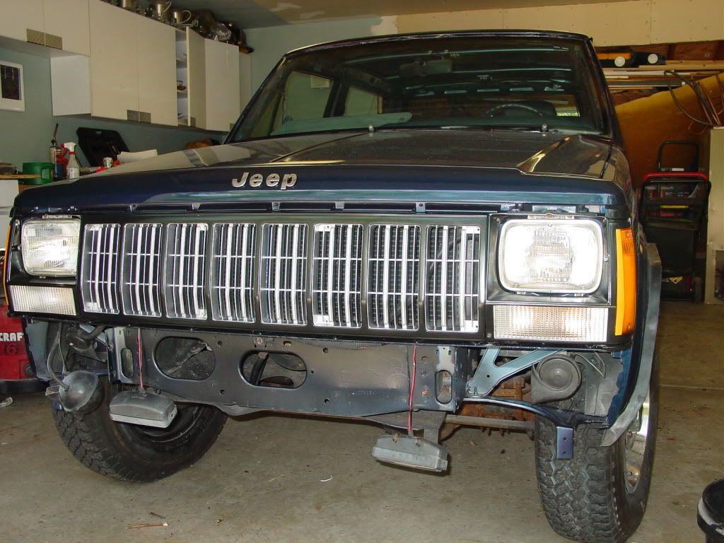

After I was happy with how the grille turned out, I cleaned up the front bumper and put it back on.. then had to take it off after realizing I bolted it on without pulling the fog lights to the front
As I was tinkering with the fog lights, I noticed how they were faded, and even rusting on the interior. Sooo I gave them a quick paint job, and used the leftover silver paint from the grille on the inside of the lights
Once I was happy with the fog lights, I put the bumper caps back on

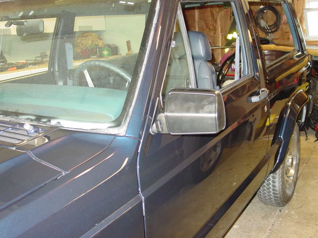

I gave the mirrors a quick paint job also, just to make them look ..not so old..

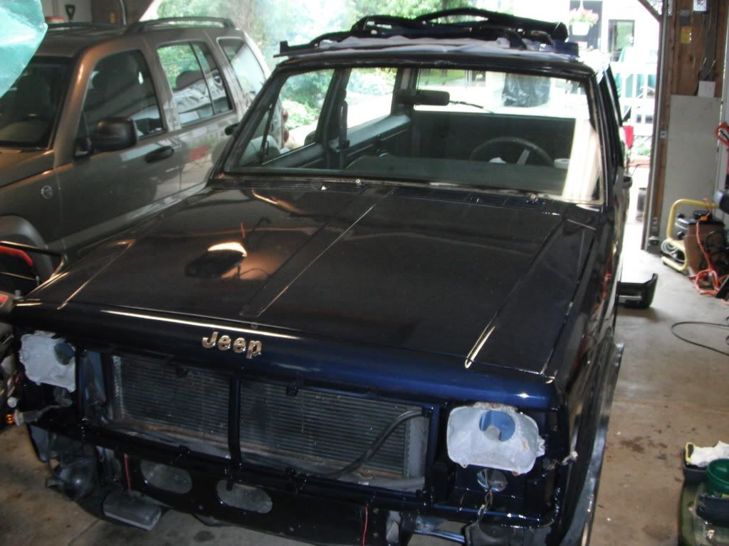

So after some blood sweat and tears (literally; but tears of joy) this is what I had to show for my hard work

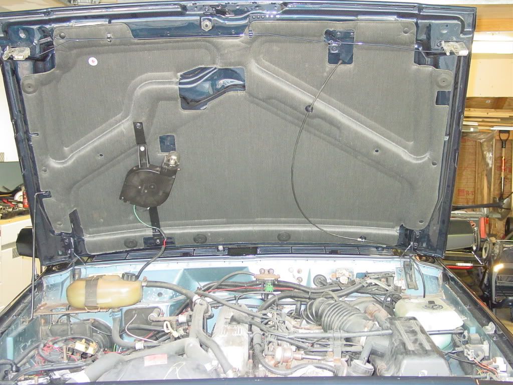

My dad surprised me by ordering a replacement hood padding. Before
After. Fun fact about that funky looking light; apparently it is a retractable 20ft spotlight with a magnetic base for "repairs in the field"

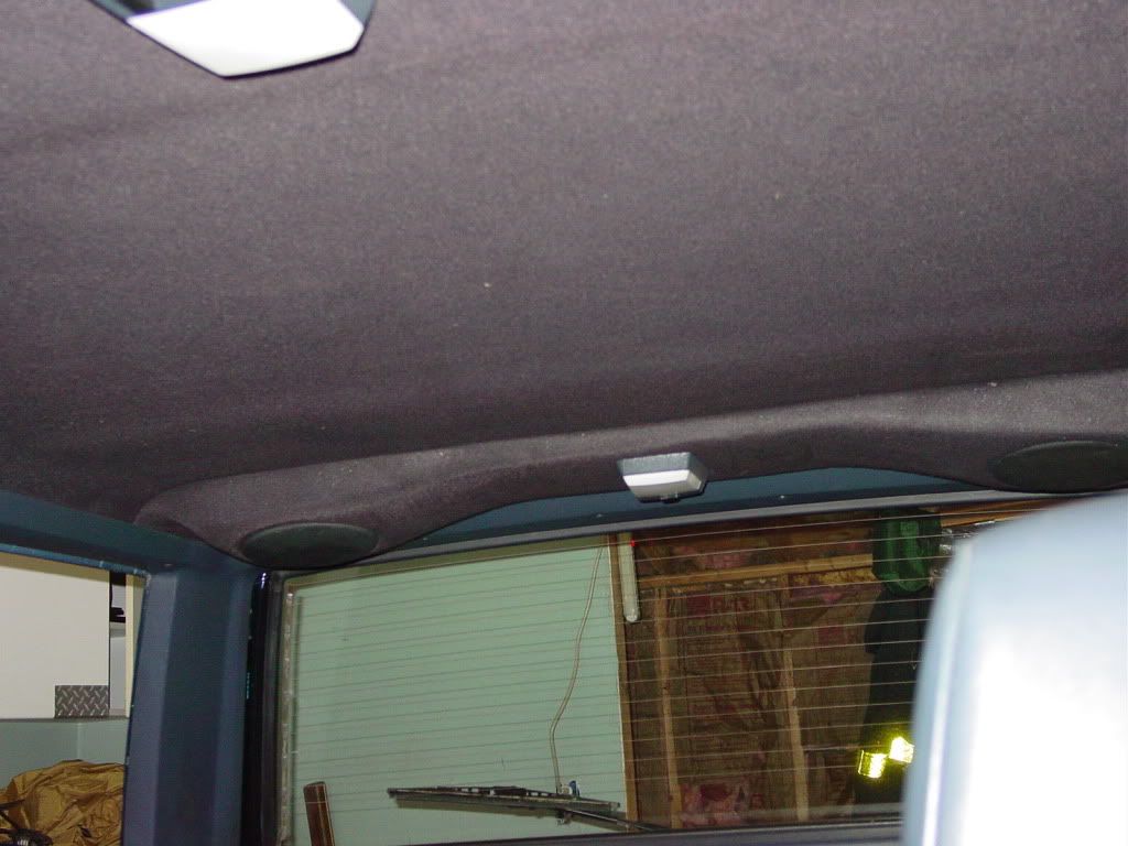

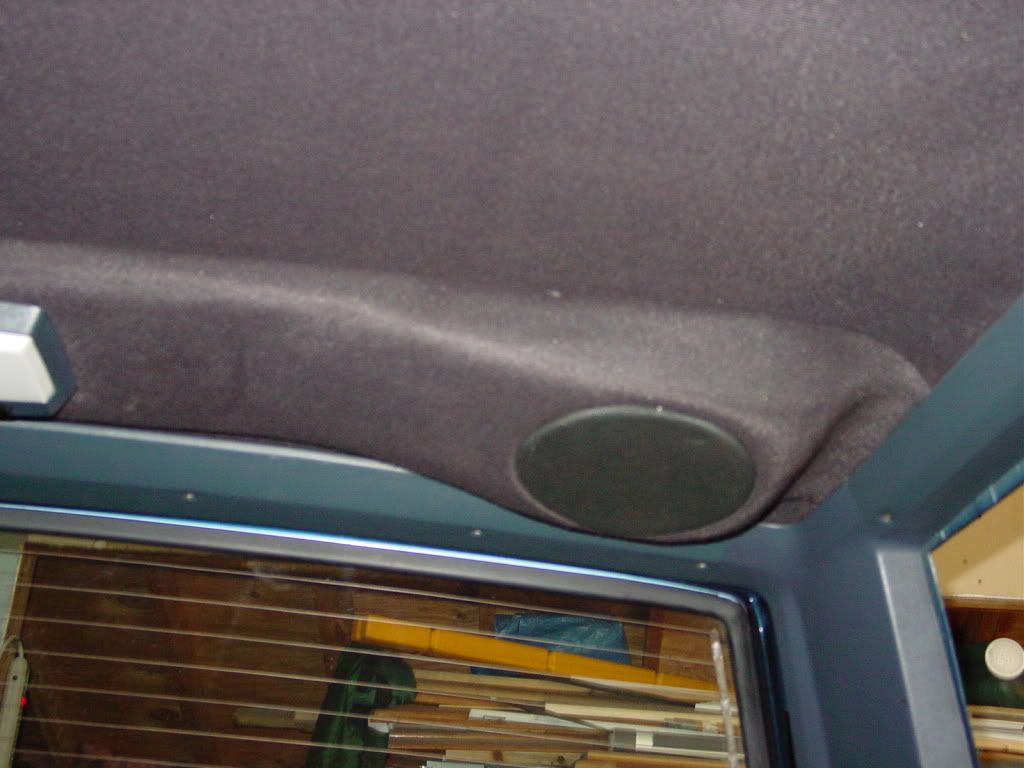

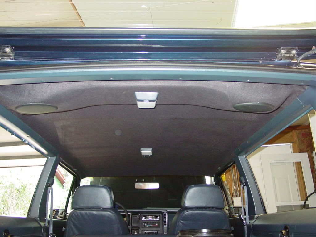

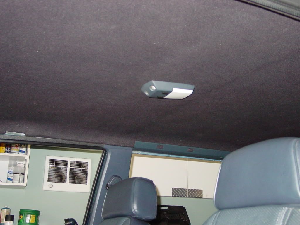

I was a little hesitant about doing the headliner by myself, but definitely did not want to pay someone an arm and a leg to do it. My dad and I went to Joannes Fabrics and got some headliner material (and yes, apparently they do carry special headliner fabric with a foam base) and some headliner spray adhesive.
Heres the speakerbar I mentioned earlier
Had enough headliner material to cover the speakerbar; Im so happy with how it turned out

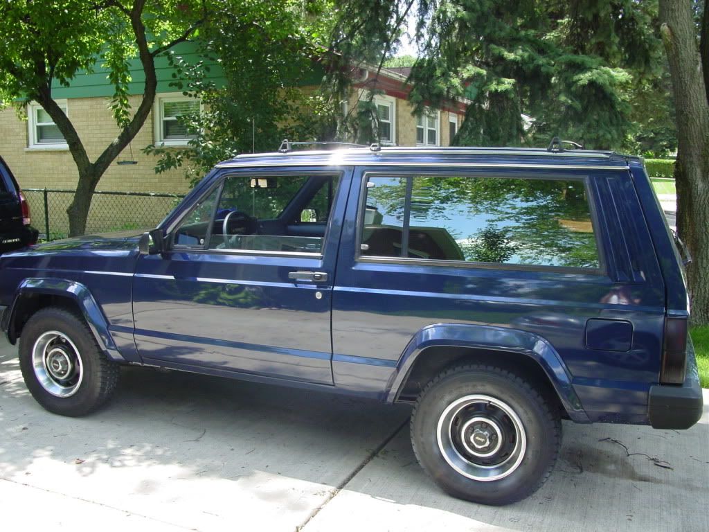

Overall, I was able to reuse about 90% of the original materials, such as the seats, the carpeting (reused the carpet, but installed new carpet padding), just about all original interior except headliner, gauge cluster, and center console.

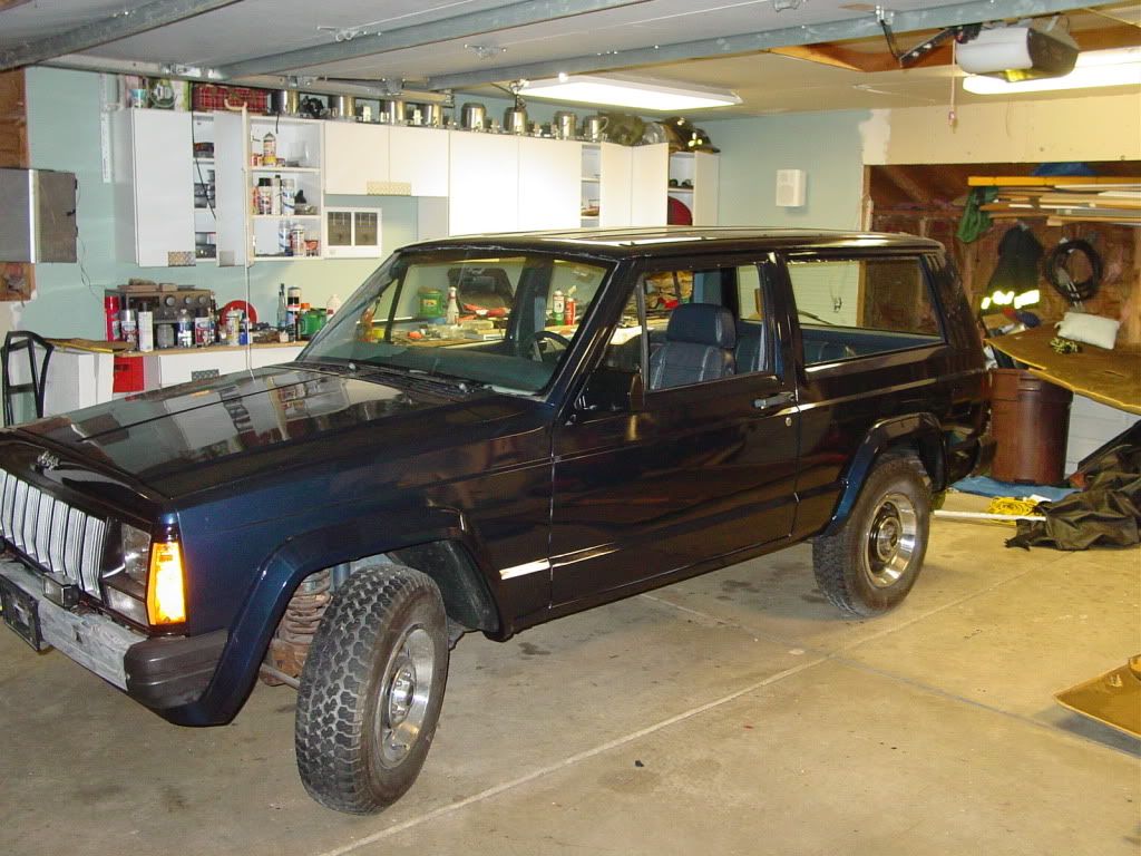

Here is the finished product (at the moment) with the new tinted cargo windows (professionally) installed.

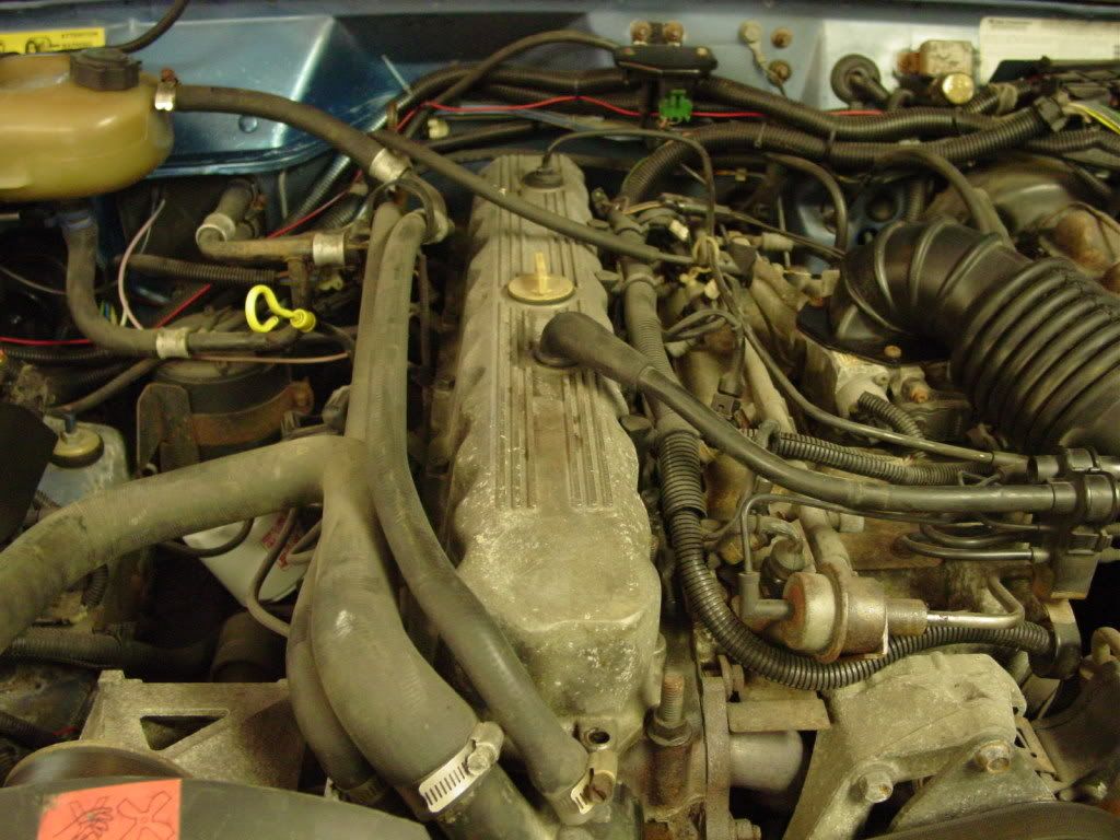

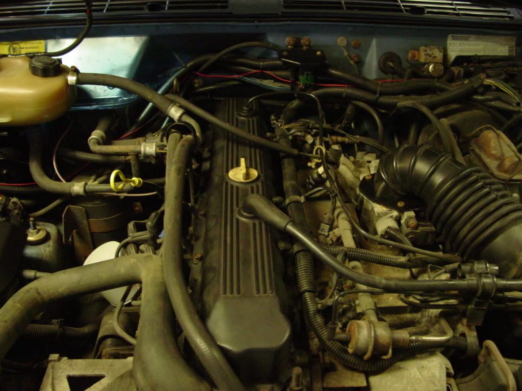

Once everything aesthetic was done, I didnt know what to do with my spare time, so I became knit-picky. I decided to spruce up the valve cover, and replace the old gasket.

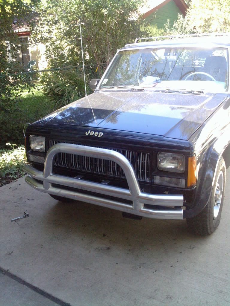

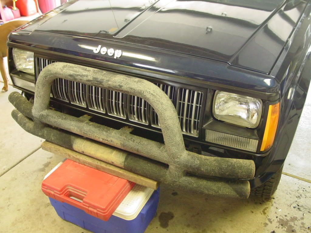

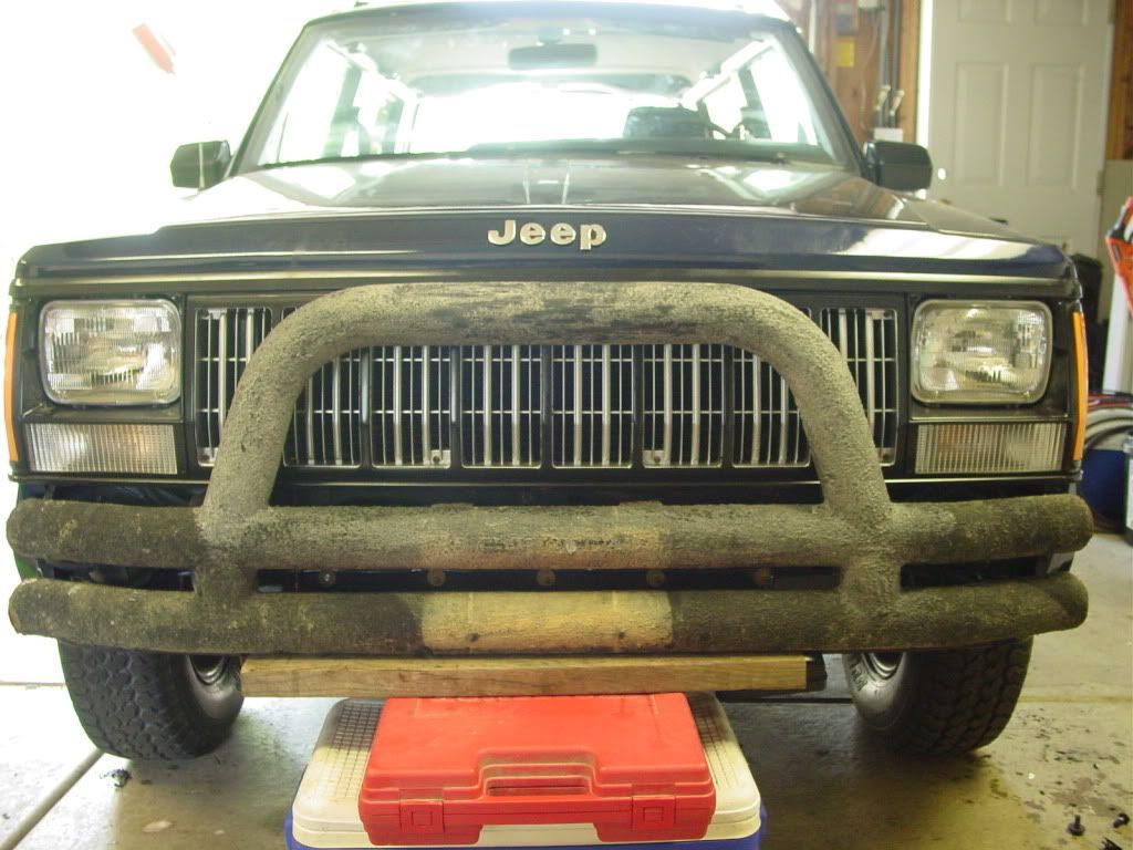

A friend of mine who enjoys offroading in his wrangler got a new bumper for his birthday (the kind that protects the hood if the jeep rolls over). Unfortunately for him, he was out of town when it came. He told me that if I installed it for him and had it ready by the time he got back, I could have his old bumper. So I did. Using my imagination, here was the prototype mock-up of my "payment"
What I did not realize was that he had covered the entire thing with the truckbed coating, which is not designed to come off easily.. or at all for that matter. I tried everything from various types of stripper, to burning it off, but the only decent way was to scrape it off by hand using a razorblade scraper. Once it was all removed, I sanded it smooth and (since I cannot even come close to affording it to be chrome-plated) I sprayed it with "Chrome Spraypaint", I know, sounds cheesy, but for $8 a can, worked pretty darn well.
And now ladies and gentlemen, I present to you; My Jeep.
Keep in mind that the Wrangler bumper required some fabrication to fit. I had to cut the mounting brackets, turn them vertical, then weld them back on.
The fog light mounts also needed some modification to fit, but turned out fine

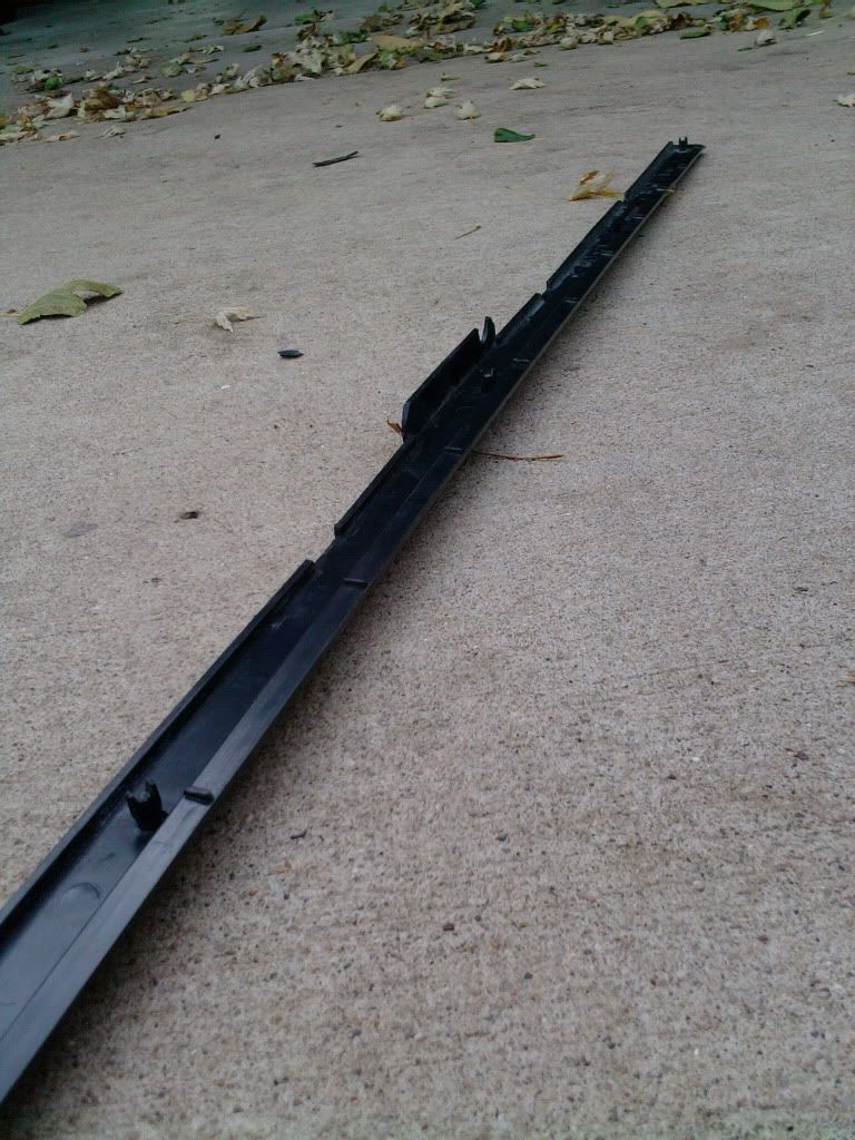

Now after I had finished everything on the jeep, I was left with about a tupperware box full of "leftovers".. most are understandable because I replaced many of the old rusted hardware bits, but I was also left with this:
I have no idea where it came off of or what it did. If anyone can help me out with where this goes, and what it is, I would be forever grateful..
Close up of the middle
