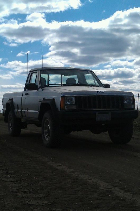

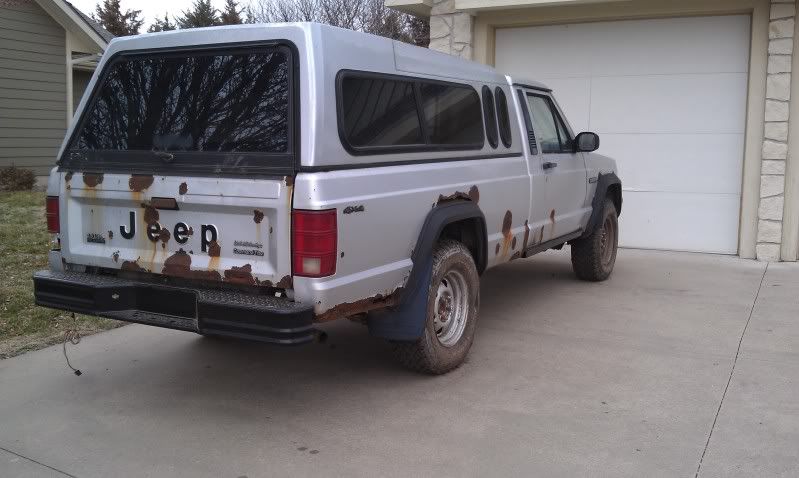

Ever have an impulse buy? I thought I needed another project, drove to Iowa....
.....and ended up dragging this home:
Interior... with 3/4 cluster!
1986 Longbed 2.5L/AX5/207 D30/35
It is rusty, it is crusty and it doesn't run.
My goal for this truck is to build a solid, comfortable, daily driver and a work truck. Since it will see a fair amount of salt on winter roads, I wont spend any time trying to 'save' any removable parts from rust.

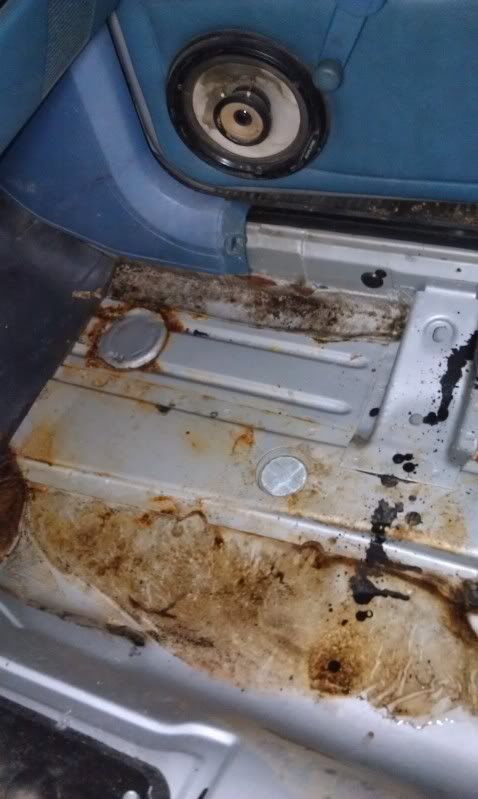

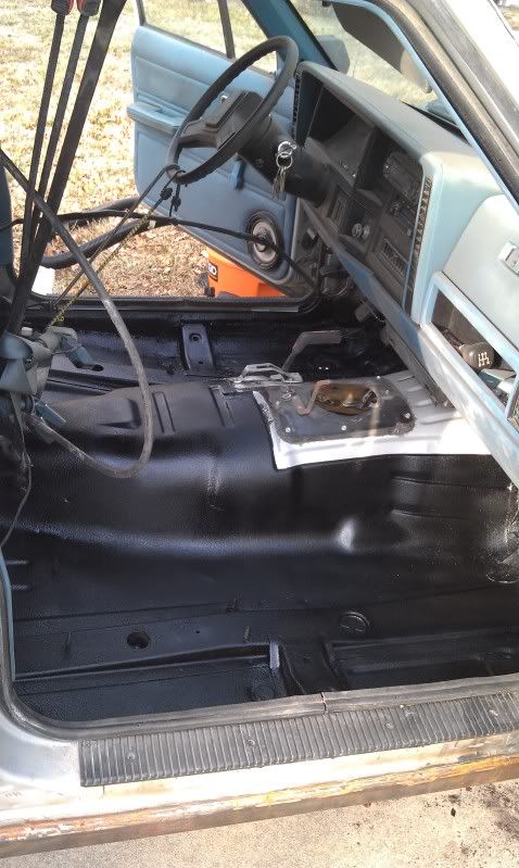

Naturally the floor pans are rusted
Pulled the moldy, flimsy, wet headliner, well as the bench and wet carpet.
Passenger side isn't bad at all:
Driverside isn't as bad as my 92:
The driver side does have holes in it, primarily around the firewall/floorboard seam and one in the back corner.I will also cut the sheet metal of of the donor and do a 'patch' fix.
A good friend of mine picked up the truck and hauled it to his shop. He will be welding in new floors/patch panels. I am not looking for a pretty repair job, just something sturdy that will keep the dirt and water on the bottom side of the cab. Pulled with his sweet Dodge. Truck didn't even realize the MJ was on the trailer.
Pulled the fenders:
Being an '86 it took me a while to figure out how the fender/header panel mount which is quite different than my '92 or the '99 XJ.
My buddy notified me of some possible scrap material I could use for rockers from an old cultivator in a pasture. 2x4, 1/4" box steel. Perfect! After torching it out and putting out the grass fire which was inevitable, a section was cut down to size for the truck.
The patch work of repair. I had initially only cut a few pieces out of the donor. Since nothing is ever easy, there was very little solid floor to weld to. I had him leave a small opening into the frame rail so I can treat it with POR15.
Had another snap of warm winter weather so I primed the new floor and sprayed with under coating:
I also mounted the Fey bumper I had bought for the '92 a few years back.
Sprayed the rockers as well:

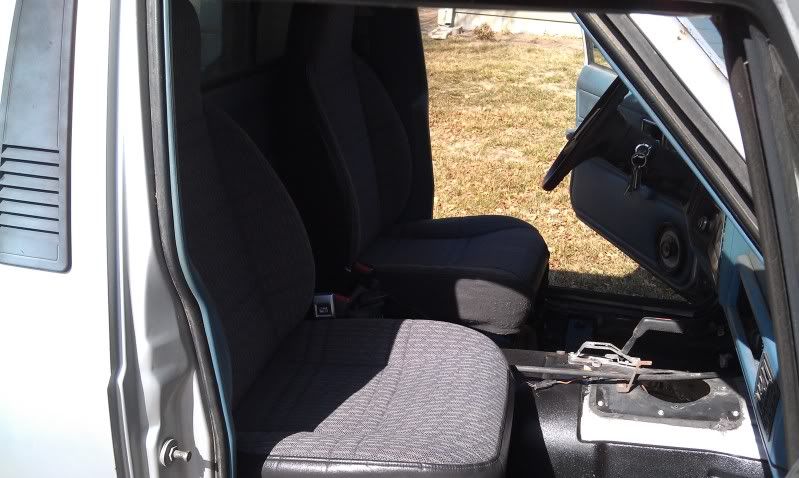

At one point I had deemed the seats out of my 99 donor garbage. They were dirty, grimey and were filled with a stagnant ciggarette stench. I couldn't even get any local folks who were looking for bucket seats to take them!
I brought them home from the farm to try and clean them up. First I hosed the seats with a garden hose. Then I mixed a bucket of HOT dish soap and water then scrubbed the seats with the soapy water mix with a small nylon brush. Rinsed with the garden hose and vacuumed. Repeated the process 2-3 times then let them air dry for a week. These seats are better looking that what is in my Rubi and only smell like fabric.
Installed in the truck:
Finished my center console mount and got it installed.

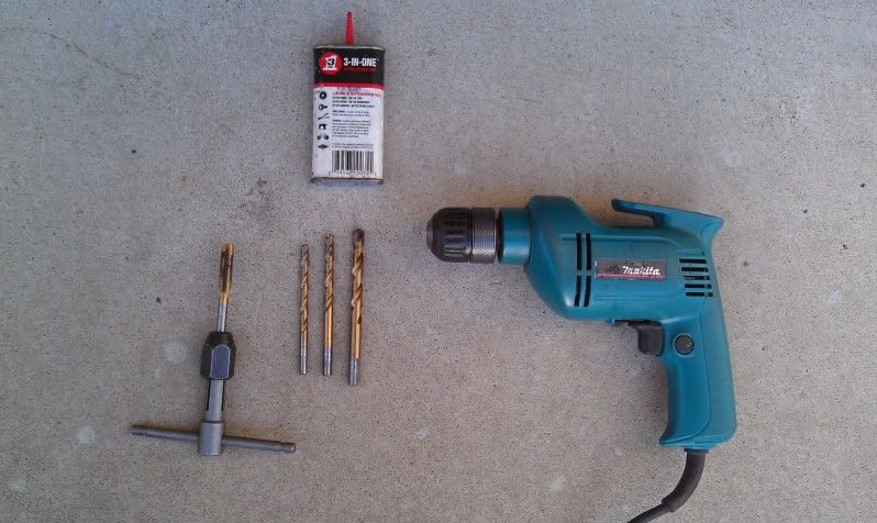

I spent some time drilling out the crossmember mount in the frame and on the braces. The extra crossmember braces on the 86 are actually welded to the frame. And wouldn't you know it, all of the bolts were snapped.
My tools of choice
Drill bits
-15/64
-9/32
-11/32
A 10-1.50 plug tap (this is the same tap you need for the rear frame bumper brackets)
And of course, oil

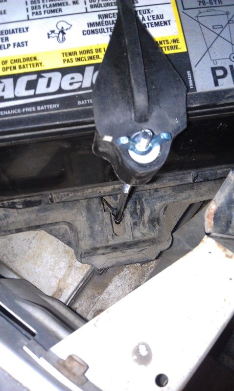

It was then time to address the battery hold down on this truck (and the worn out battery from 2004). A rubber bungee cord is the only thing keeping the lead brick in place. I obtained a good used battery from my father who needlessly replaced the battery in his Silverado.
Used a generic battery hold down I found at the local farm supply store. I think it will work just perfect.

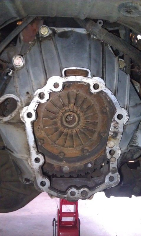

I also got the bell housing test fitted with the bolts I bought. Fit like a glove.
Apparently I need to figure out what size bolts hold the CPS in place as now have two zip-ties holding it in place.
And the good news. I turned the key on and off several times to let the fuel pump get gas to the motor. This little 2.5 hasn't been run since 2004 and I was expecting the worst. Instead, this is what happened:
https://www.youtube.com/watch?v=fMCDbs4I1Tw
Yeah buddy! Even with an open header it was running darned smooth.
Oil pan and flywheel have been removed so I can replace the rear main and pan gasket.

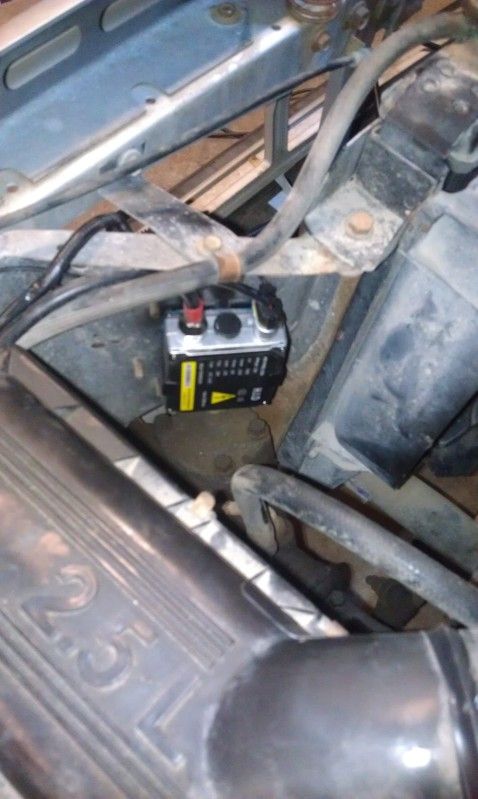

I upgraded the headlights.
IPF Housings and 55w H4 HID kit
Installed the driver side ballast:
And the passenger side ballast and the HID relay box:
HID bulb fitted into IPF housing:
Testing:
Light pattern:

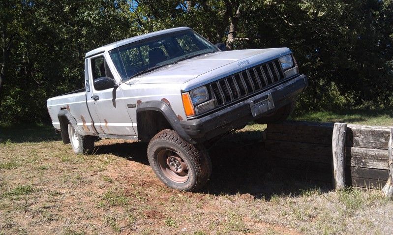

I installed an old set of JKS disconnects I had laying around.....and tested her out in the back yard:
My shocks are a little short.....
Finally got rid of the mismatched steel wheels. Helllllooooo Turbine:

Other than that and replacing an O2 sensor, I have just been driving it. Also took it wheeling a few times.
Just a glamour shot of the beast:
Replaced the radiator that has been flopping around in its mounts since I bought the truck. It just seemed like an accident waiting to happen, probably when I would be a long ways from home....
- Flushed the slimy brown/green gunk from the radiator/motor
- Radiator
- Thermostat
- Upper and lower hoses
- Fresh extended life coolant
