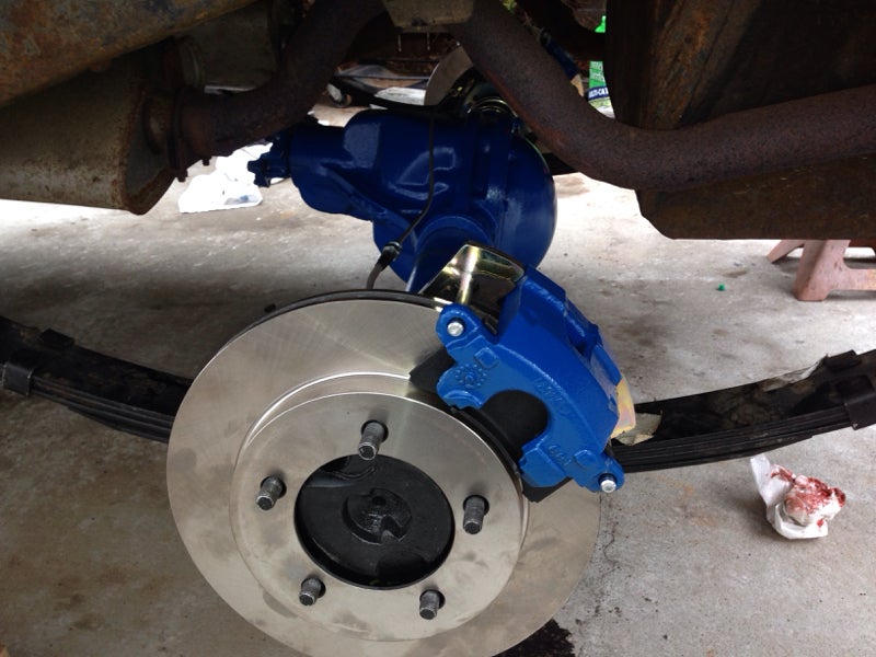

Well here is the rear hi pinion Dana 44 wearing it's disc breaks. It works awesome.
