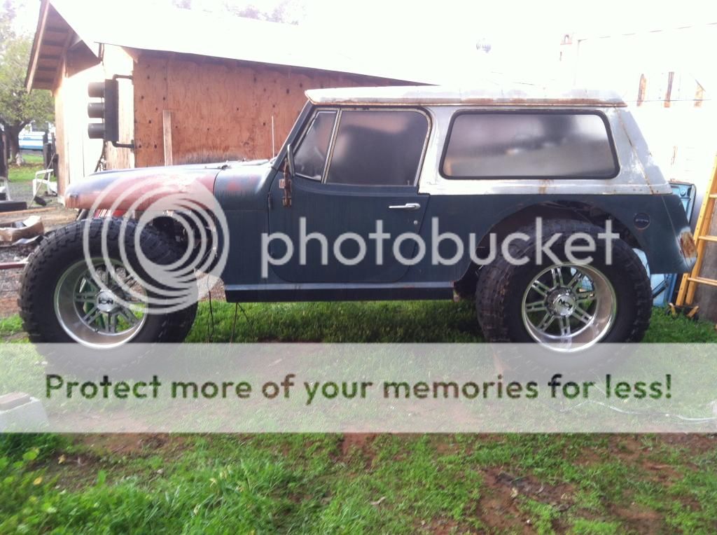

1967 jeepster commando build

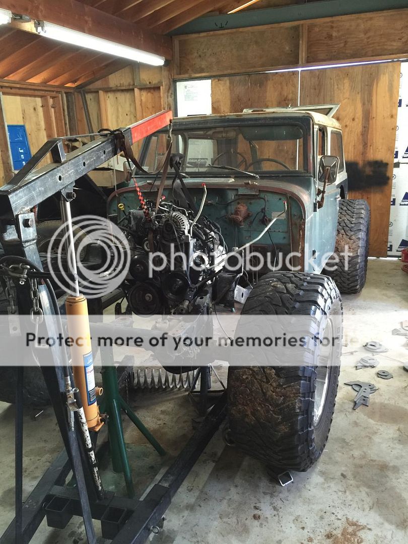

greetings all.... i am starting this to document my build of a 1967 jeepster commando. I picked this baby up from a guy near el dorado hills. got a sweet deal and started planning and collecting parts. so far i have good running 5.8l ford efi motor with a zf 5-42 transmission. i bought it with the complete truck. scrapped what i didn't need and turned the rest into a pickup bed trailer. I bought an advanced adapter for the transmission to a bronco dana 20 transfer case. I also picked up some earily bronco axles that had been built for rock crawling (the guy was upgrading to 1 ton axles). the front is a dana 44 with 4.56 gears, heavy duty axles & u-joints, an arb locker, all of the bushings and long radius arms. the rear is a ford 9" with a strange center section, detroit locker, 35 spline moser axles, disc brakes, leaf springs and roll over shackles.
because i was worried about fitting the engine i picked up some late model cj fenders and will lengthen the hood 3". that should give me plenty of room for things. for tires i have a near new set of dick cepek fun country 36x16.5r15 on 15x12 black d-hole wheels. i am hoping to get started in the next few days. i have attached a pic of how it looks now and will take more pics soon

Well I was going to run the slots but I really like the cepek tires.
Today I pulled out the stock rear and put in the 9 inch with the tires
Attachment 270061
This morning I got the front axle out and mocked up the fenders and flares
That's it for now. I have baby duty today.

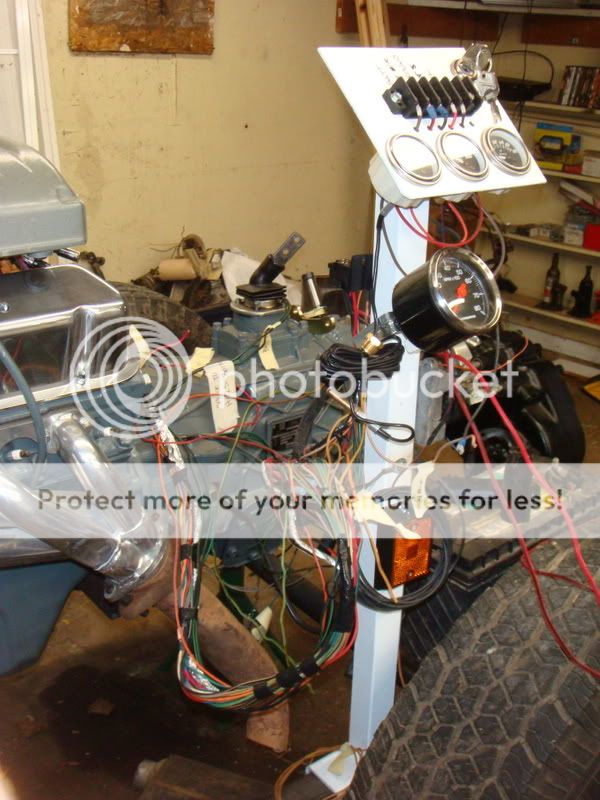

I digress... here is some updates. the pics below are of the engine on a stand I built. This will allow me to get all of the wiring worked out prior to putting it in the jeep.

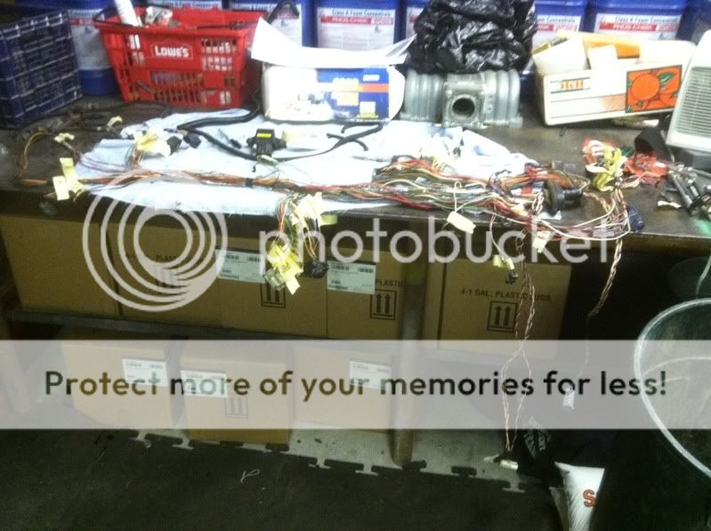

I realized that the truck intake will not clear the hood. I did a little research and found that BC Broncos has a great section on the installation of ford EFI into old broncos. there is an amazing amount of information. Here is what I found. They make an adapter plate that allows the installation of a mustang upper intake (89-93) onto the 5.8 truck lower. I picked up a mustang ECM, wiring harness, and 70mm MAF off craigslist for $250. I decided to modify the wiring harness myself. This is not for the faint of heart. I have approximately 25 hours into the modification. There were times when I wanted to say 'f**k it' and buy one already done from RJM injection. But now I am almost done and got my fingers crossed. here are some pics of that.

The short version of the wiring is: 1. Remove all of the covering. 2. Determine the location of the ECM. 3. Find the length of the from the back of the motor to the ECM. 4. Get wiring diagrams from alldatadiy.com. 5. Trace and modify all wires begining with Pin #1.
If you do the wiring one at a time it is not to hard. Just takes time.

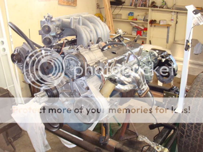

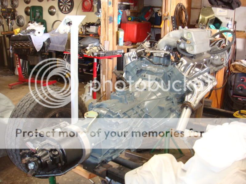

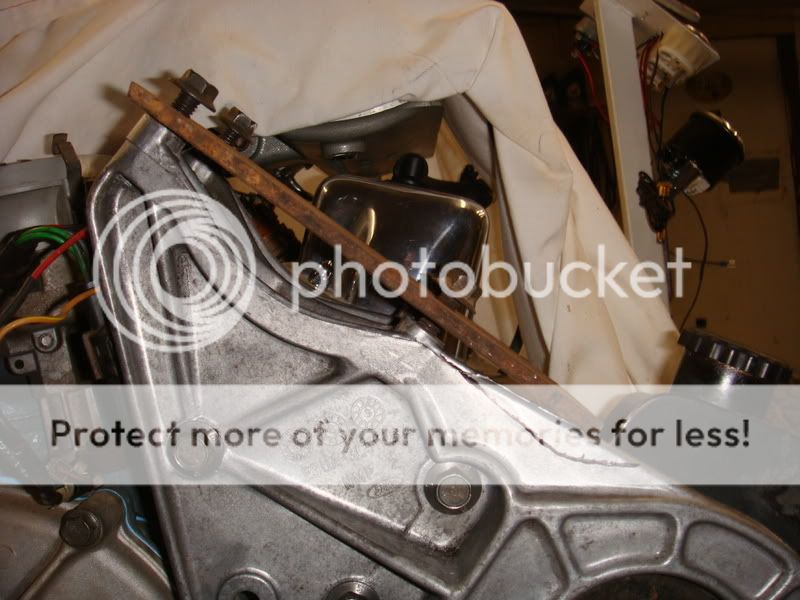

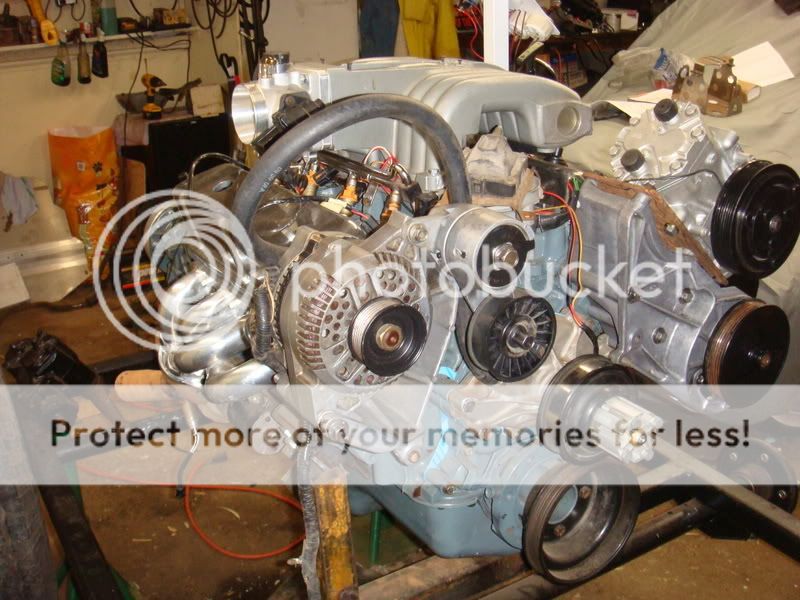

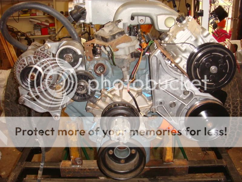

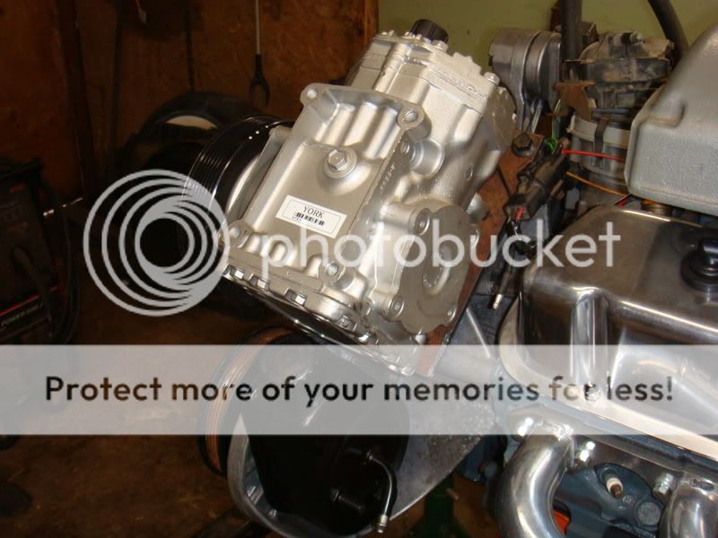

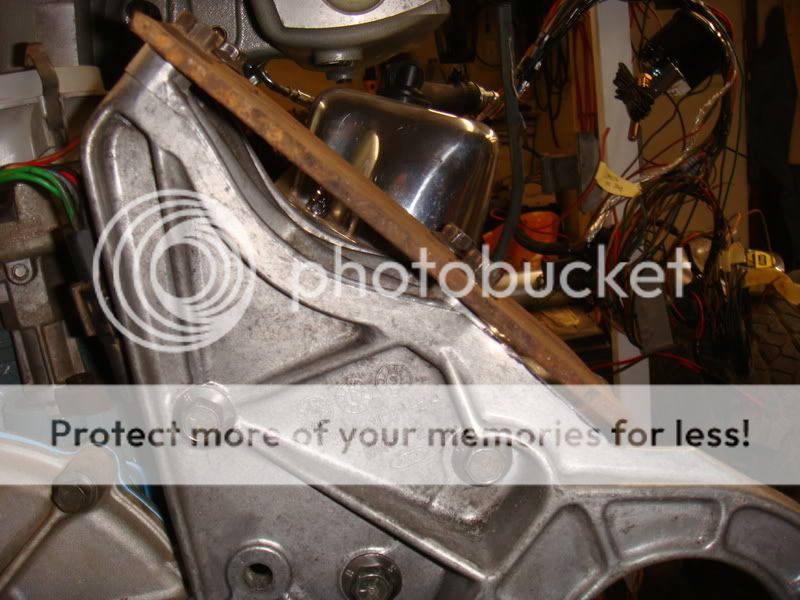

I have had some time in the evenings to work lately. I have been trying to get the motor running and buttoned up. I was having trouble figuring out how to remove the smog pump and mount a york. After a little internet research I discovered that the accessory brackets from an 90-95 E-Series ford van were perfect. There is a difference in mounting through the years but the all came with 130a alternators and the heavy duty Saginaw power steering pump. The location of the tensioner was optimal for Smog pump removal. I measured and a 93 inch serpentine belt should work great. Also I picked up the brackets, pump, alternator and tensioner at Pick n Pull on a half priced weekend Now about the York compressor, finding one in the wrecking yard is near impossible with a serpentine belt. I found one on e-bay rebuilt and shipped for $170. Which is a deal in my opinion when considering all of the running around to try to put something used together. I will not need A/C since when it is hot I will have the top off anyway so I mounted the York in the same location as the stock AC compressor. Basically I drilled 7 holes in a flat plate. Here are the pics.
In the next two pics you can see where I had to notch the PS bracket to fit the York plate.

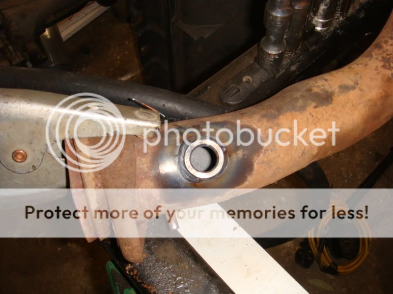

Here is a pic of the O2 bung welded in the exhaust started pipes.
Finally this rats nest is the wiring harness loose. When I get the engine started and running I will zip tie all of the branches off the main. Then remove it, tape wrap it, and add plastic loom.

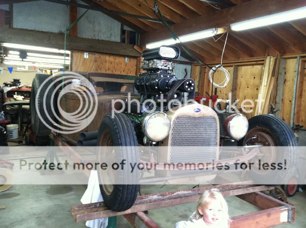

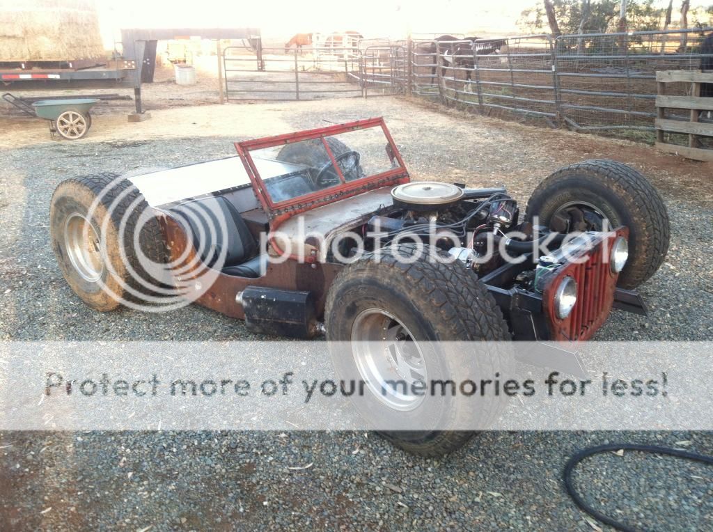

greetings all. I am finally ready to start working on this beast again. Two years of hibernation leads to changes. The Jeepster was put on the back burner for this
and this
The 1930 sedan was a redo and the flat fender I built from scratch

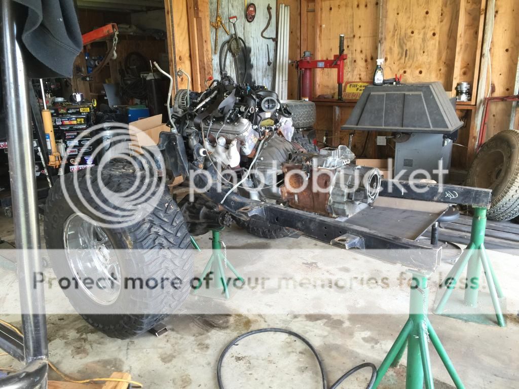

and I decided to run a TJ front frame half. I ordered a Barnes belly pan.
here is the 6.0L vortec LQ4 from a 2005 denali with the NV4500 just sitting in the frame after cutting off the back half of the TJ frame

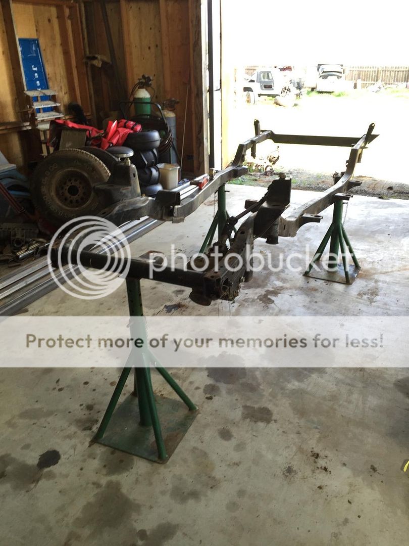

I did get the body back on the frame half and some jackstands
It is almost where it needs to be on the frame. I have to move it forward about 5" to get it right. the front axle is a reverse spiral ford dana 60 narrowed to 63" wms to match the 14 bolt cab & chassis rear. Most of the remaining parts needed are on their way. 3.8 atlas, arb's, 5.38 gears, 35 spline outers and the 44" pitbulls (although I found out yesterday that they are in the process of making them so their going to be a while in getting here). oh and the finish goal is to take this on the jeepers jamboree in July. fortunately I already have the ECM flashed and the wiring harness finished (thanks to LT1swap dot com for all the information)
