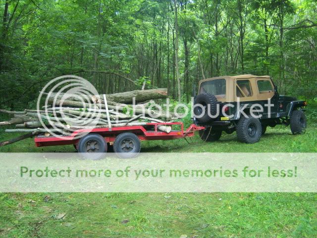

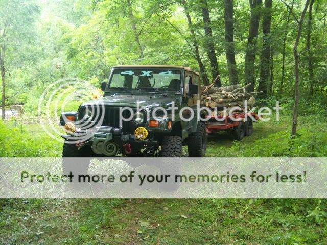

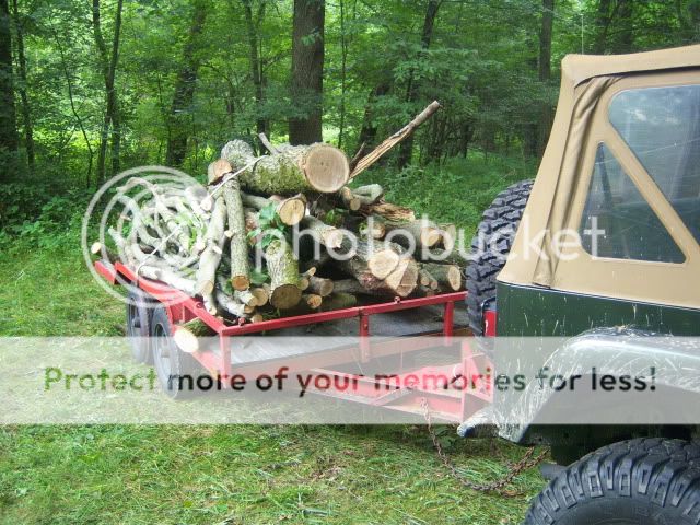

I cut/pulled some trees down, and winched some others from some gullies.
Then hauled the chunks on the trailer:

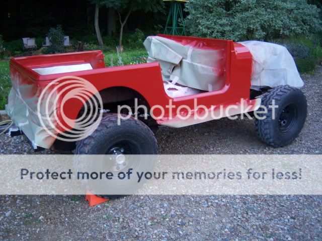

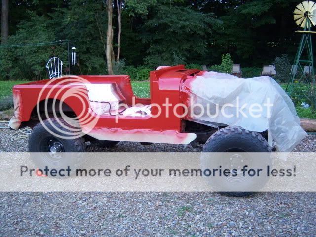

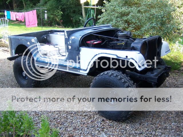

I finished sanding my jeep down.
Went from this:
To this:
Finally to a primered tub:

Old 07-24-2009, 10:33 PM   #67
BriansCJ
Haulin' Groceries
BriansCJ's Avatar
1994 XJ Cherokee
Location: South Jersey
Posts: 3,518
Is that red really the primer. Looks like a final coat of paint with a shine to me.

Old 07-24-2009, 10:43 PM   #68
ET48
1986 CJ7
Location: Wooster, Ohio
Posts: 2,731
Yep, that is the primer/filler. It is what they use in the body shops. (Not cheap) It is somewhat shiny so you can see the tiny imperfections that you need to spot repair before the final coat of paint.

Old 07-24-2009, 11:18 PM   #69
1997_Sport
1991
Location: Bel Air, Maryland
Posts: 4,356
im calling a double fail on you, one nice overspray on the tires. haha
also you could have just used regular primer( a lot cheaper) and used a guide coat, then wet sand it and its the same thing but a lot cheaper and not that much more work to do.
But looks good, what color you going with?

Old 07-25-2009, 05:45 AM   #71
ET48
1986 CJ7
Posts: 2,731
Dude, as much wear as those tires will see after I'm done, I could care less right now about the tires. Plus, if you take brake cleaner on a rag and wipe the tires down, it will strip all the paint off.
I decided to go with this primer since its a one step primer, and it shows the imperfections like the final coat would. I am going for a pretty good finish here, and money wasn't a big deal.
Final color with be AMC charcoal metallic. --I can't wait!!
