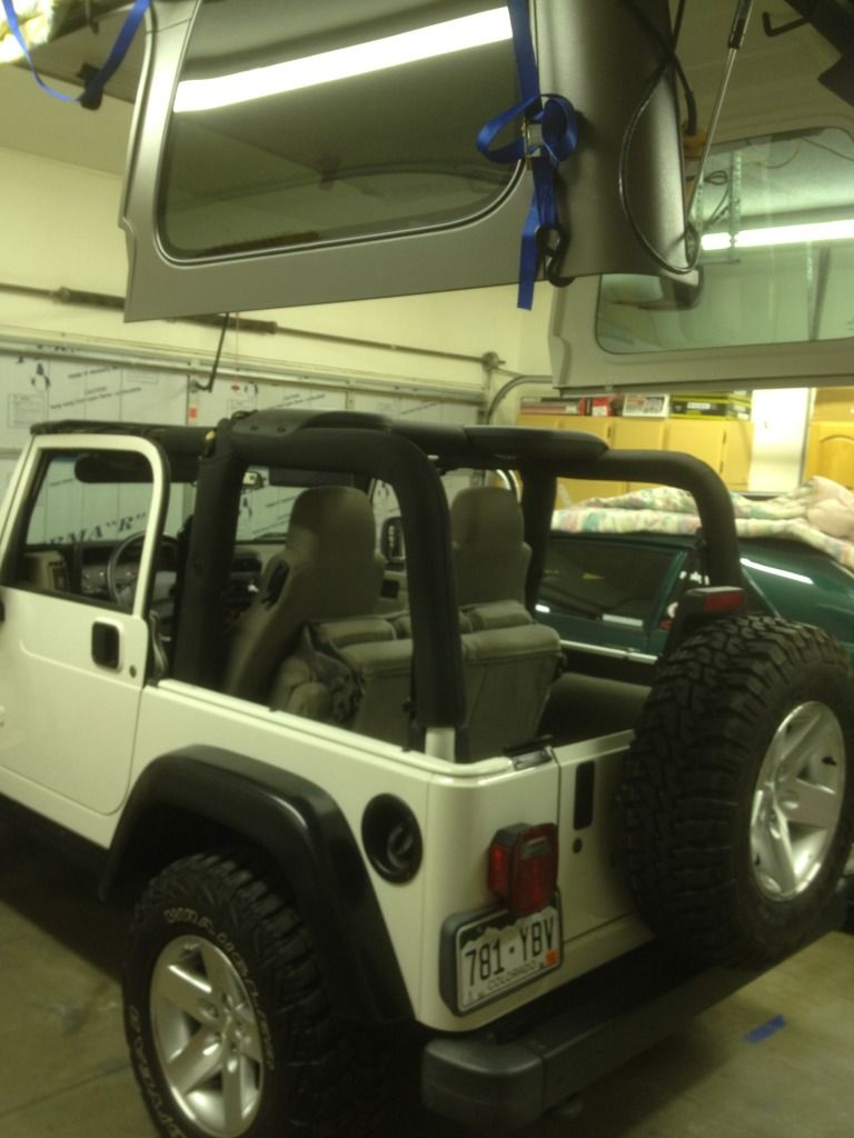

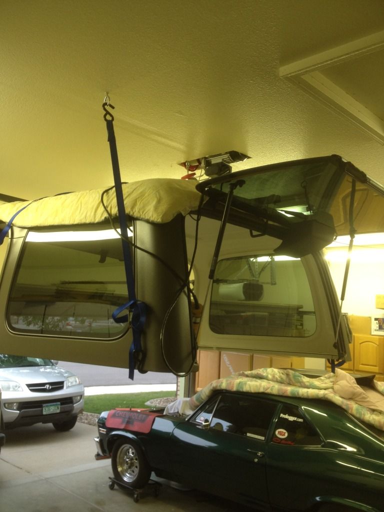

I like my hardtop for the winter but let's be honest, what good is a Jeep without a soft top? My next project was to build a hardtop lift in my garage and buy a soft top for the Summer. So in May of 2012, I undertook that project.
I installed a Harbor Freight 120V winch in the rafters of my garage. I used 1 1/2" square tubing to build a T and then used rafter hooks to get a hold of the top. It seems very secure but since I used a HF winch, I decided that 4 ibolts in the rafters and some straps would make a good safety.
Topless for the first time.
I decided that a Bestop Supertop NX was right for my Jeep. Funny story about the top. I ordered it from 4-Wheel Parts here in Denver. When I went to pick it up, they didn't offer to help me out with it. The box, while not being super heavy is awkward and as I stepped off the curb in the parking lot, I stepped in a small hole and down I went. Terrible sprained ankle and 3 weeks in a boot on crutches.
When I finally healed up enough to limp around the garage, I got the top installed.

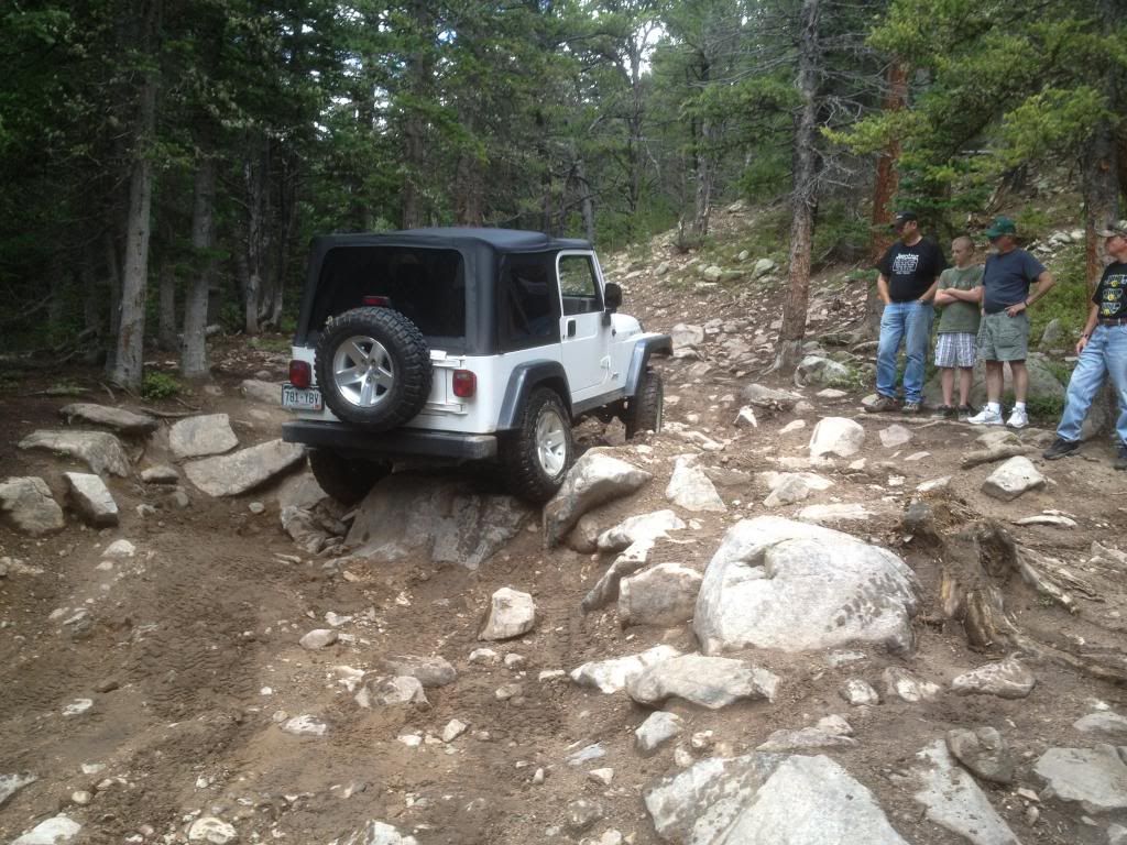

No reason to have a Jeep just to commute to work in. I like my stuff to look good but I also use it as intended. Here are a some pics from the first couple of trips off-road with it. Being a bone stock Rubicon, I was pleasantly surprised at the places it would go like that.

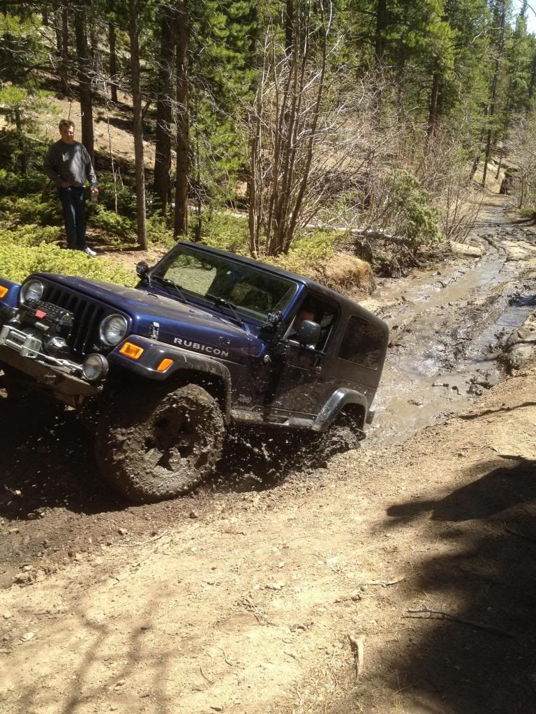

Pickle Gulch - April 2012
My dad playing in the mud in his LJ. It was my first outing so I opted not to try that big hole.
Miller Rock - May 2012

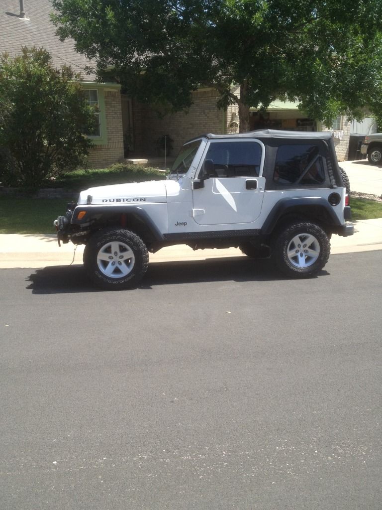

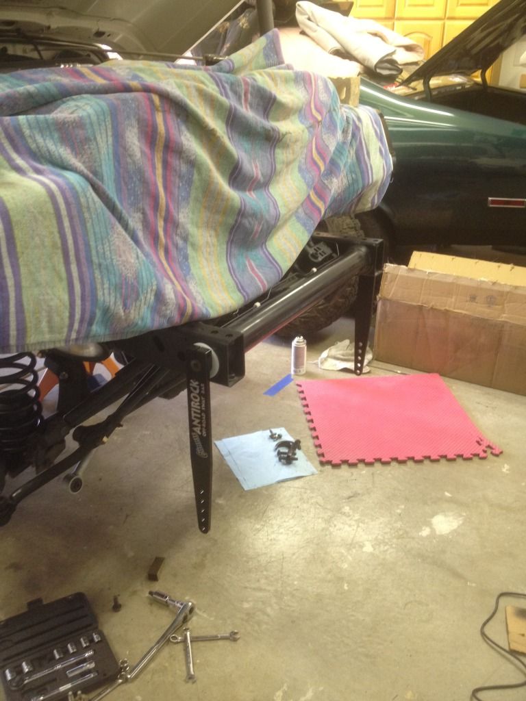

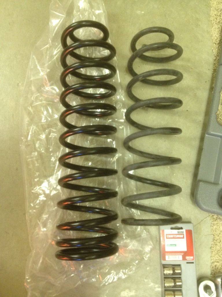

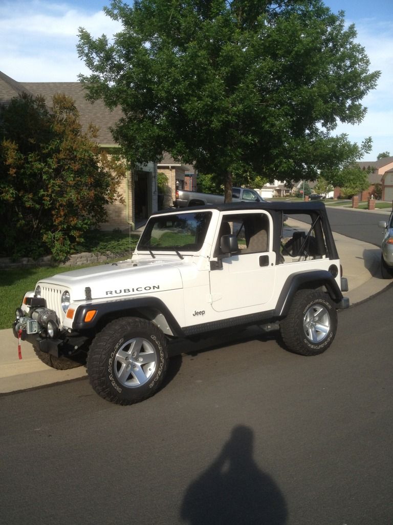

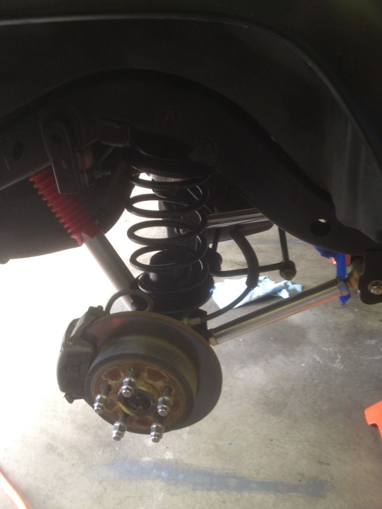

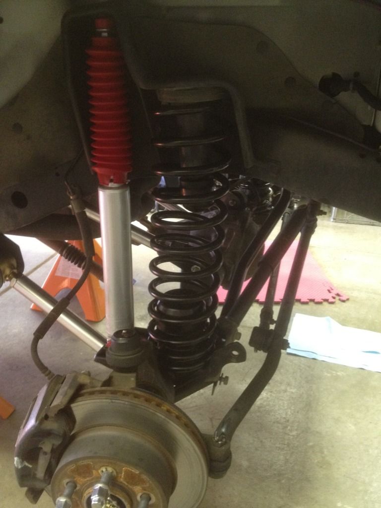

At the end of May 2012, I decided it was time to proceed with a 3" lift. After a lot of research and helpful responses on this forum, I decided that a complete kit from Savvy Off-road was in order. Aluminum adjustable control arms, 3" springs, both track bars an Anti-rock and all the other goodies to make it work.
Look! UPSclause made a visit.
I got to work on it right away. For the most part, it was very straight forward. The few questions I had were answered here on JeepForum.
And the end results of a week of work. I'm so happy with the lift and the quality of all the parts I received from Gerald at Savvy Off-road.

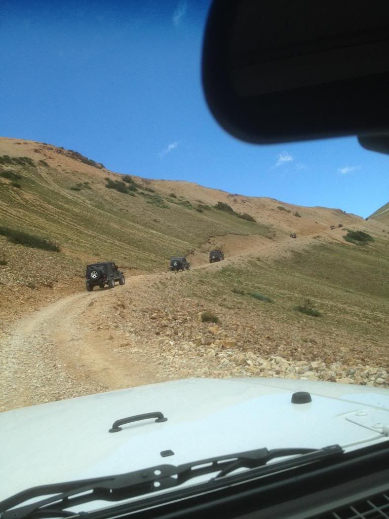

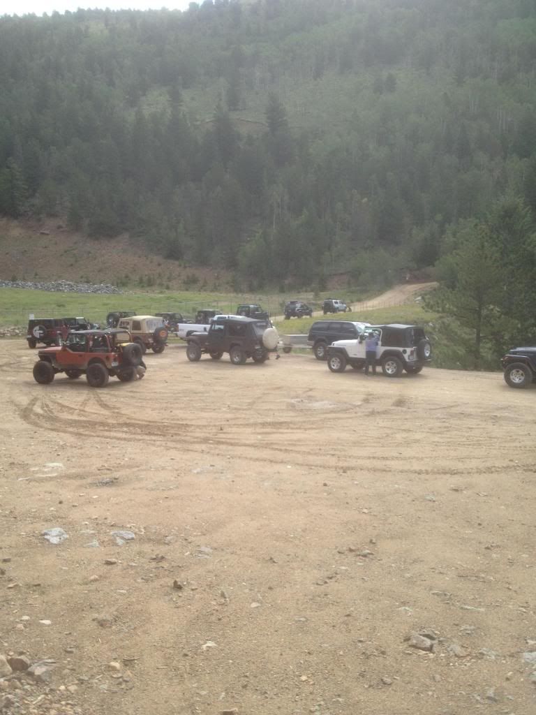

That's basically it for the 2012 upgrades. The rest of the year, we spend out 4-wheeling and enjoying Colorado. In August, we attended the Mile-Hi Jeep Club All-4-Fun event in Empire. What a great week of 4-wheeling and fun. Here are a few pics from the week....
Playing in the water - Kingston peak
Airing down for a ride into Bill Moore lake
Jenny Creek
Jenny Creek
Jenny Creek
Webster pass

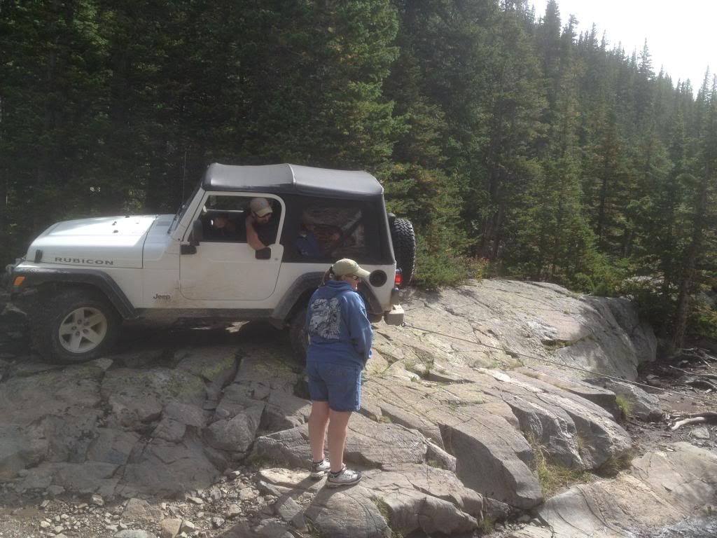

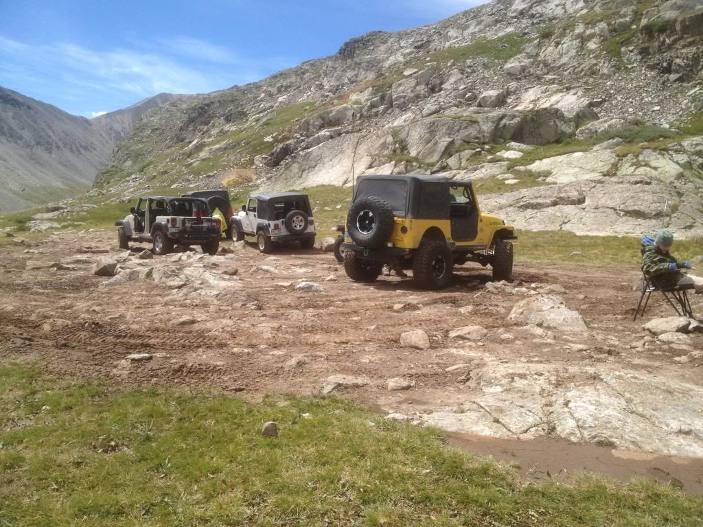

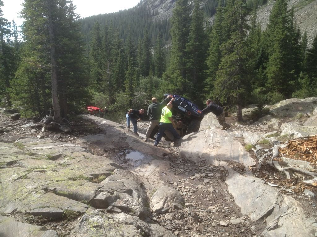

Here are a couple of pictures from our trip to Wheeler lake. This was the most challenging trail we have done up to this point.
Being used as a winch point...
to help recover from this behind me
Lunch at the lake

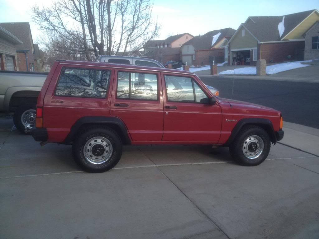

From September till the end of March 2013, I let my youngest son drive the Jeep as he had just returned from the Army. Having him use it as his daily driver put a damper on upgrades till last week. He bought this clean 92 XJ for himself.
1320quick is offline

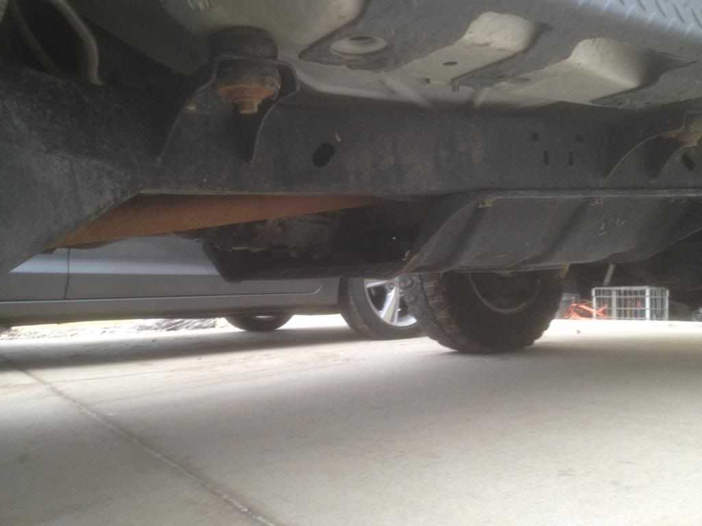

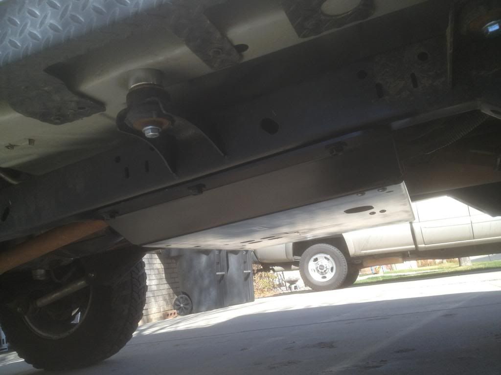

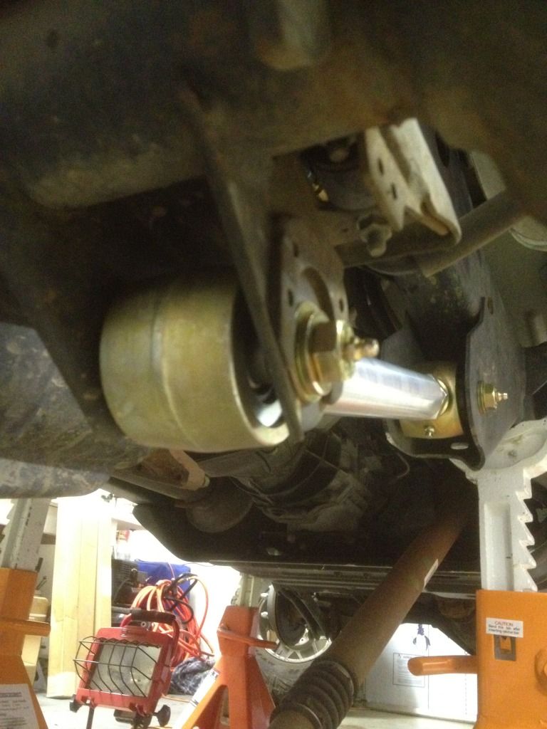

Now that I have my Jeep back, a trip to Rokmen was in order so I could get rid of this...
Here is the new Rokman skid and 1" body lift:
I added a Daystar 1" MML as well.
Now we have this. Much better.

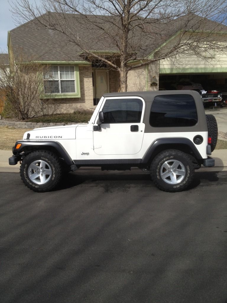

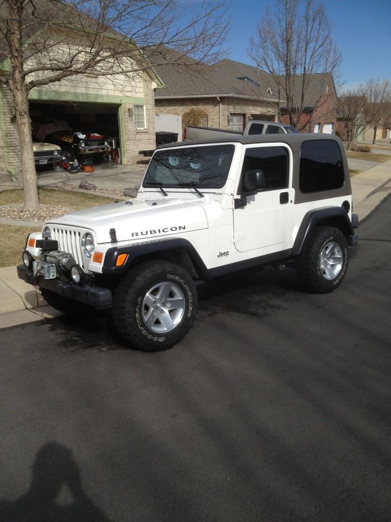

Here is what the Jeep looks like today.
I'm very happy with the way my TT project came out. The transfer case linkage works just like it did before since I used a 1" mml and 1" body lift. I didn't have any clearance issues with the exhaust on the upper control arm mount like I've read about. No issues with the nutserts in the frame where the transfer case skid mounts. Honestly the MML was the most difficult part of the project just because the drivers side access is not perfect and they put the motor mount bolt in so it's hits the A/C coming out.
I ordered a Tom Wood CV driveshaft yesterday and it should be here on Tuesday. Then I can rotate the pinion and get that setup correctly as well. My Savvy shock extensions showed up today so that should keep the shocks from hitting the spring bucket. This is another one of those projects where doing things right the first time pays off as I already have the adjustable upper control arms to fix the pinion angle.
