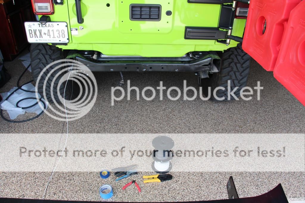

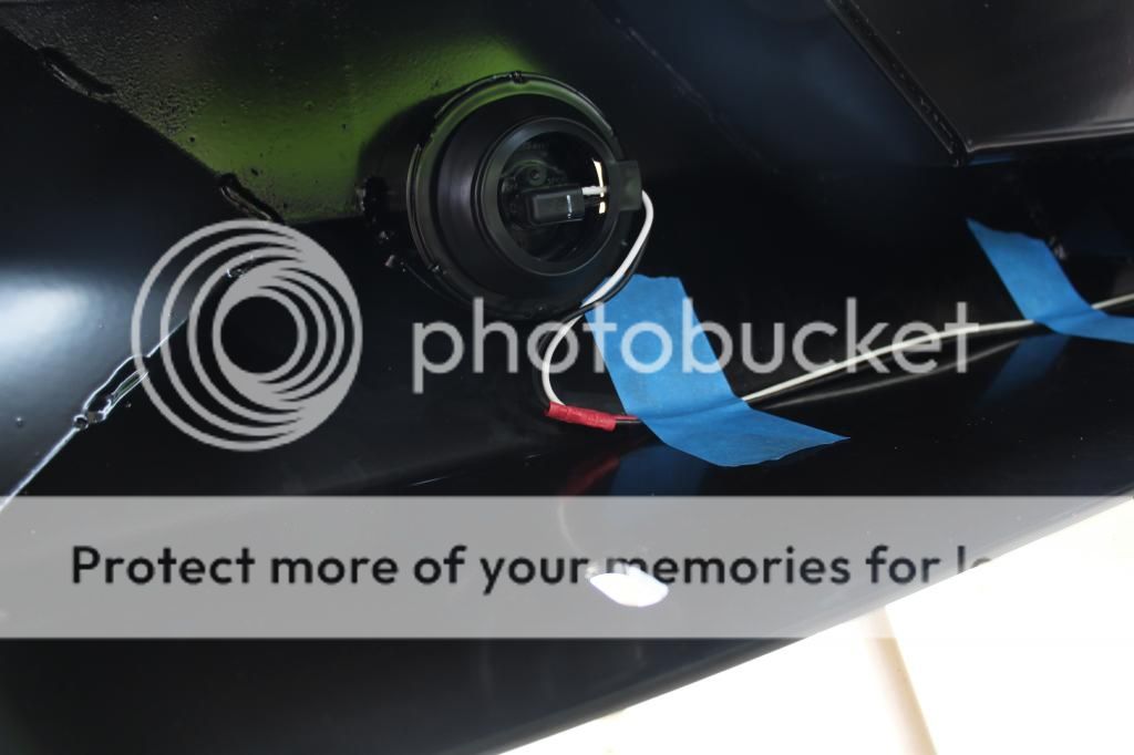

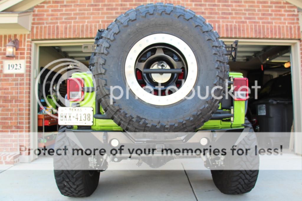

So after Poison Spyder dropping the ball a couple times on shipping the bumper. I finally got it and had it powder coated. Began installation last night. I hit a snag when I went to install the rear facing LED lights that are optional from PS. These lights have a short wiring harness consisting of two wires. One black and one white which has a two prong plug at one end and pig tails on the other. Question being is the polarity reversible? How would I know what is positive and what is negative? Also, the plug can go either way on the back of the LED.
I plan to test it out on a battery after work today and see if it will work either way. I just thought someone might have been down this road before and could clue me in to save me some time.
Thanks, David M
David_M is offline
post #148 of 218 Old 08-23-2013, 07:39 PM Thread Starter
David_M
Location: San Antonio
Posts: 447

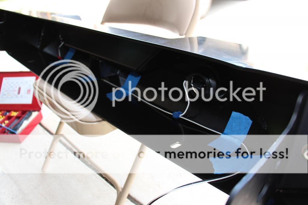

So after speaking with Poison Spyder about the LED light question. They said the polarity was in fact reversible. Honestly, the person I spoke with didn't sound like he had much confidence as he was speaking with me. I decided I better test them out before proceeding. I did so with a simple 9 volt battery. They did work either way so I went ahead with the install.
I went ahead and spliced the two LED's wires together so I would only have two wires going up into the Spod.

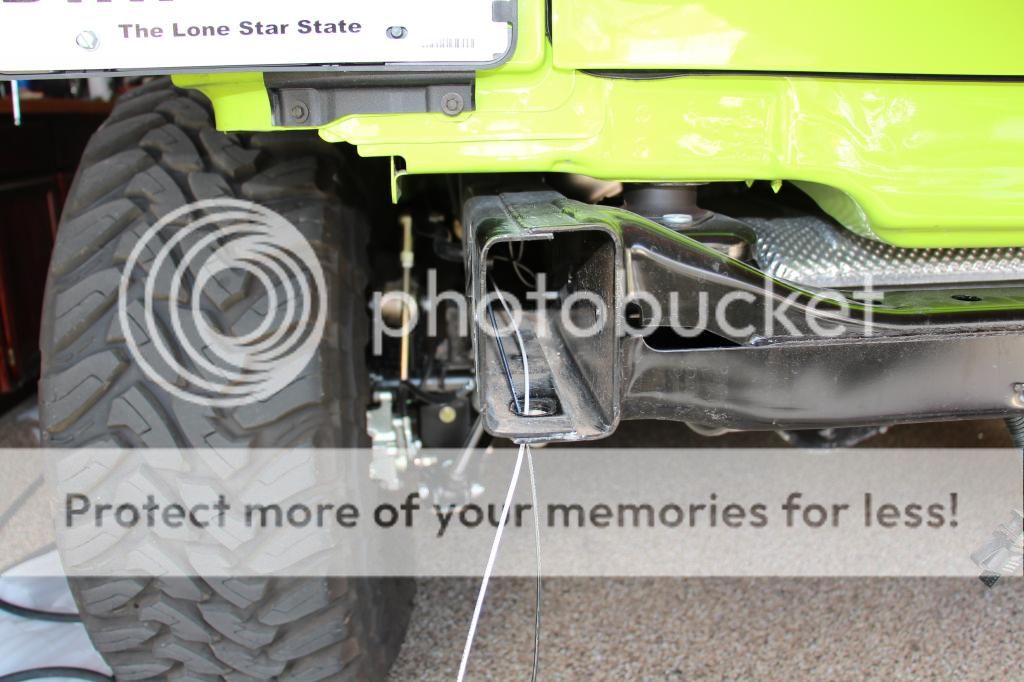

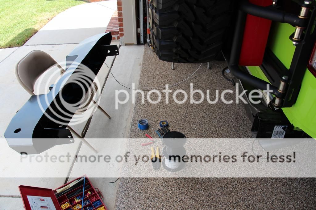

I decided to string the wires through the frame rail to protect them while playing in the rocks.

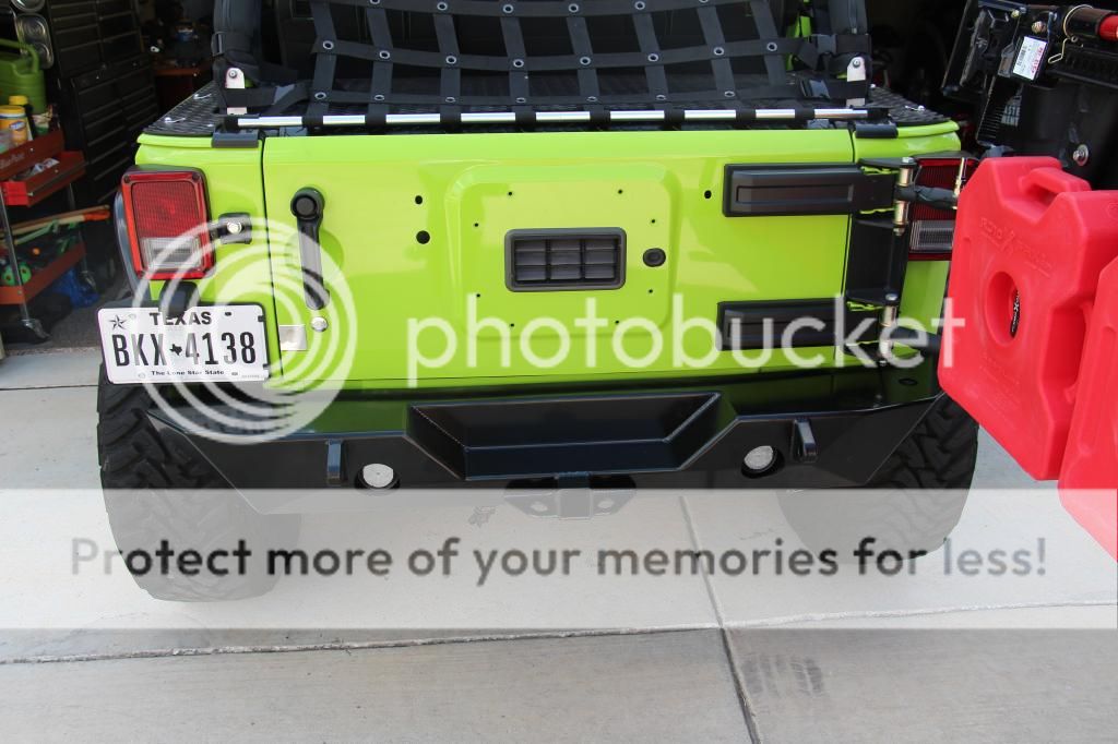

Bumper staged on chair with wires pulled through the frame rail up to the engine compartment. Waiting for my wife to get home and help thread the bolts in place while I hold the bumper up. I loaned my father in law my floor jack and jack stands.
Finished!
