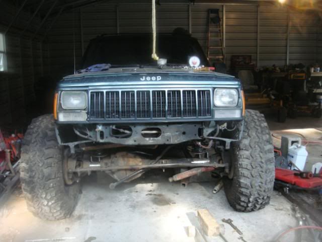

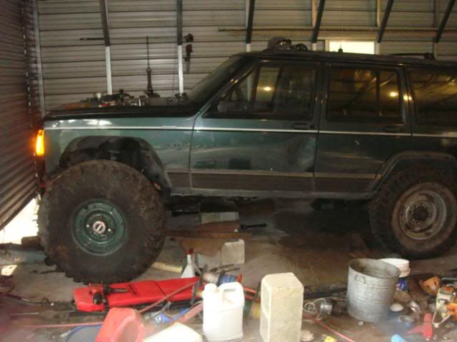

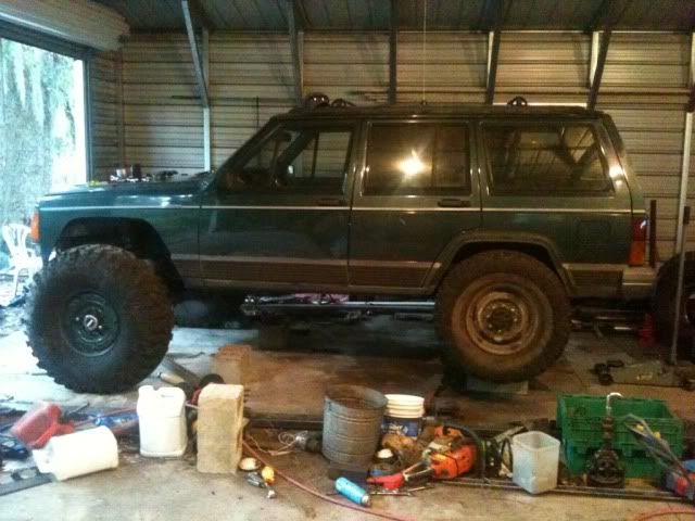

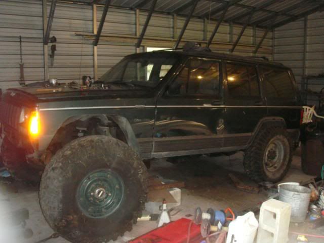

Picked up some front springs and shackles today. The coils were suppose to be Rusty's 4.5" but they ended up being 3" HDs. My fault for not checking them when I bought them, but in the end I think the stance is just about right. Might end up adding a .75" spacer once it gets a winch and bumpers.
And the rear jacked up to approximate ride height. I'm guessing the front is about 5.5-6" lift. It doesn't sit as tall as I thought it would, 71" to the drip rail, 29" bottom of the door and 23" to the bottom of the frame at the tranny crossmember.

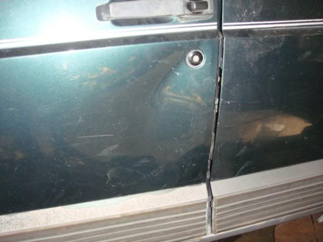

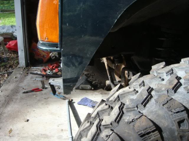

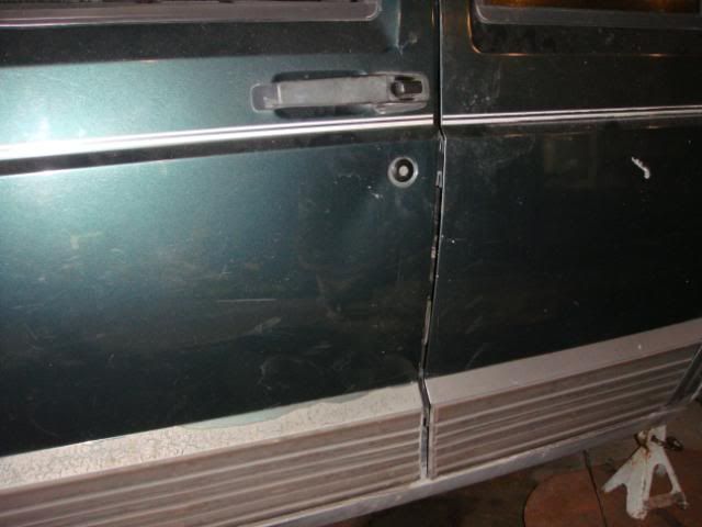

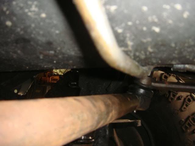

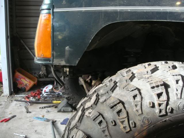

Today I trimmed some more on the front fenders and pulled most of the dent from the drivers door. Just a small area left at the lock that i'll have to work from inside the door panel.
The other day I got the drag link on. It's pretty close to the oil pan so it looks like it needs more lift, replace the waggy pitman arm with one with more drop or maybe both.
