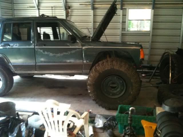

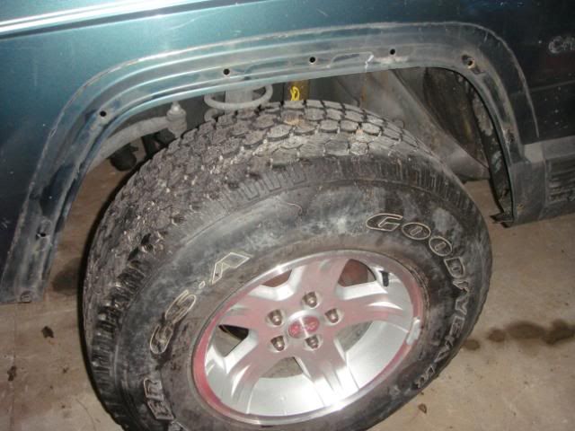

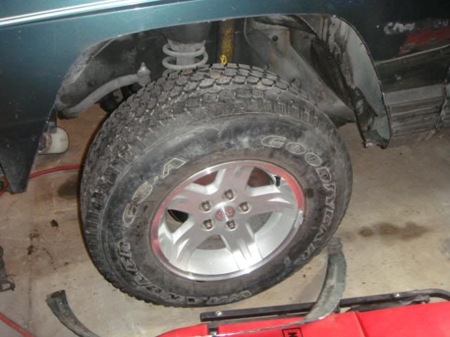

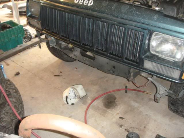

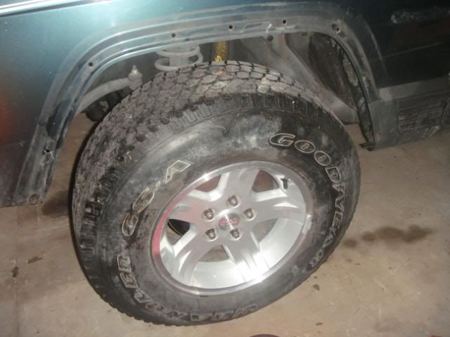

Trimmed the front fenders yesterday, still need to do the cut and fold on the pinch seam. May have to end up cutting more but will wait till I can get the tires on to check the clearance. Probably will end up cutting the front side horizontally just below the side marker lght. Also removed the front bumper, thinking about recessing a winch below the radiator to help the approach angle like this http://s143.photobucket.com/albums/r...cpZZ1QQtppZZ20
Ordered some leaf spring pearches from Ruff Stuff Specialties this morning. If they arrive by this weekend I may have the rearend sitting under the Jeep Sunday.
Before
Scratched a line following the mark left by the fender flare and then cut it off with a cutoff wheel and the cleaned it up with a flap disc.
After, when its all said and done going to cover the edge with door trim.
Bumper off
Getting there!

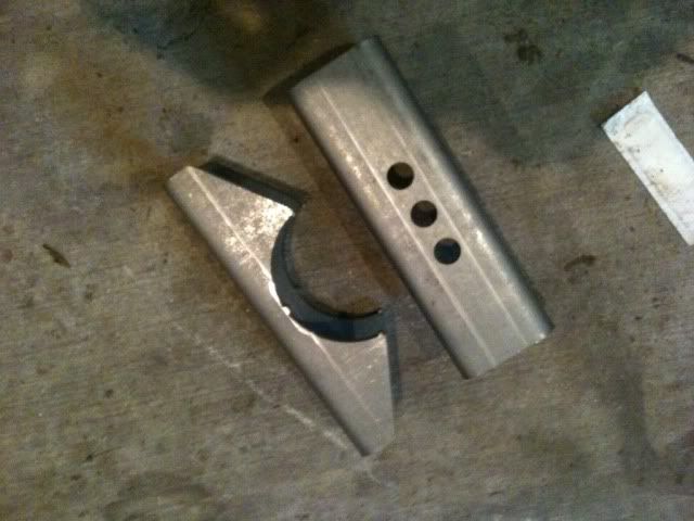

Perches arrived yesterday, the plan is to get them tacked on tomorrow and slide the rearend under the jeep.
Got an email from Ballistic Fab today saying my brackets were backordered (imagine that ) Called them up, talked to 2 different people and changed brackets so hopefully I'll see those soon. Changed from the 3" diameter to 3.25" The Dana 60 housing is like 3 1/8" so I don't think it should be a big deal.

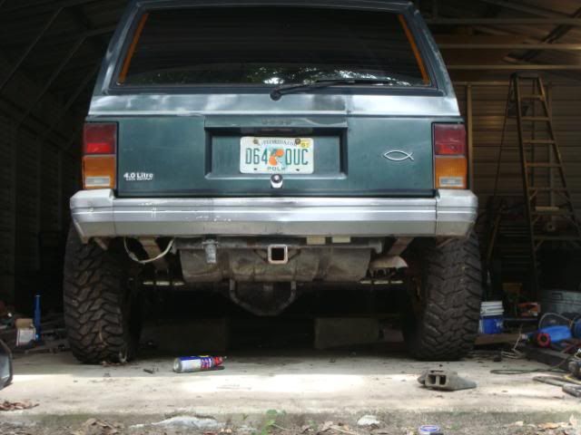

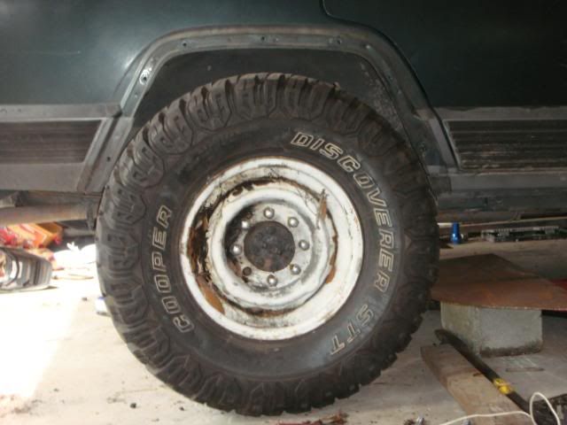

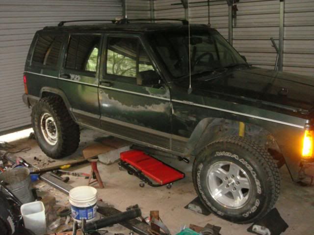

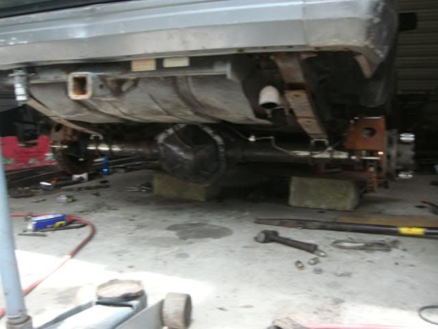

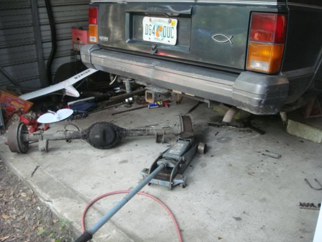

Out with the old
In with the new!
33's and no lift, better not hit any bumps
Just put a tack weld on the perches to keep them from moving until I figure out the exact pinion angle.
