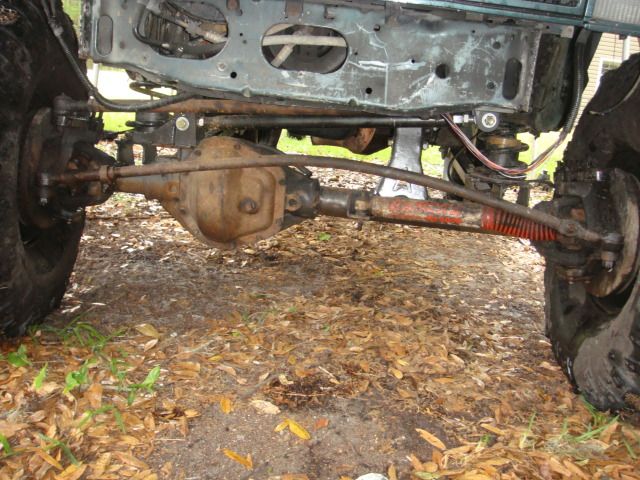

Made some shock brackets for the front out of some 2" flat bar and 2" square tube (all 1/4"). Used and old shock I had laying around and the steering stablizer for mock up and temporary use.

Originally Posted by jkl View Post
Foolin around down in the pasture again and then oops
looks like you need to upgrade your steering
do you get any bump steer with your track bar being so short?
Yeah, upgrade is definately in the future. It's not the first time it has been bent so I'll just straighten it out again and keep runing until then.
Haven't really noticed any bump steer with the setup.
Weld some angle iron to it?
I take it that's going to be a winch bumper? Going for a hidden winch?
Thought about that, also might sleeve it till I redo the steering.
You sir are correct
