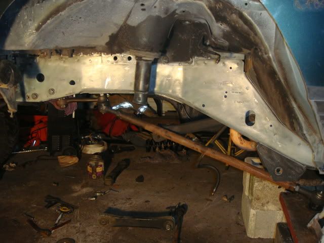

Pass side

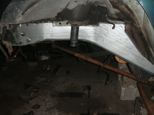

Started cleaning up the frame to plate it and making a duct tape template

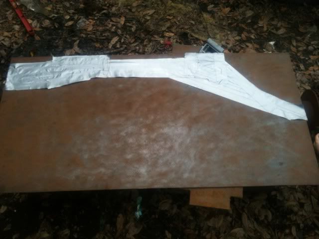

Laid the front frame plate template out on some 1/8" steel
Still need to trim them up a bit to fit better and drill rosette holes.
