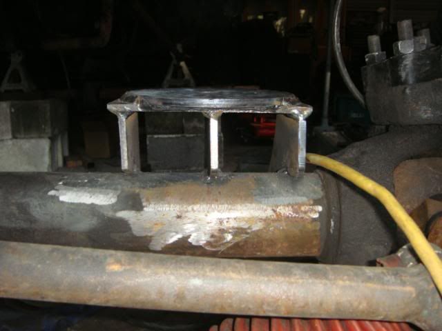

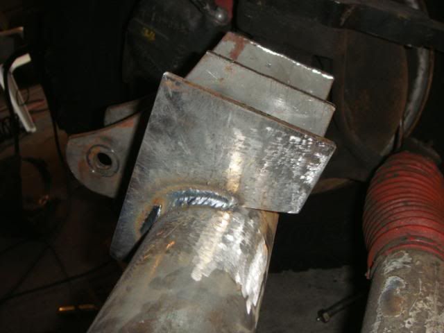

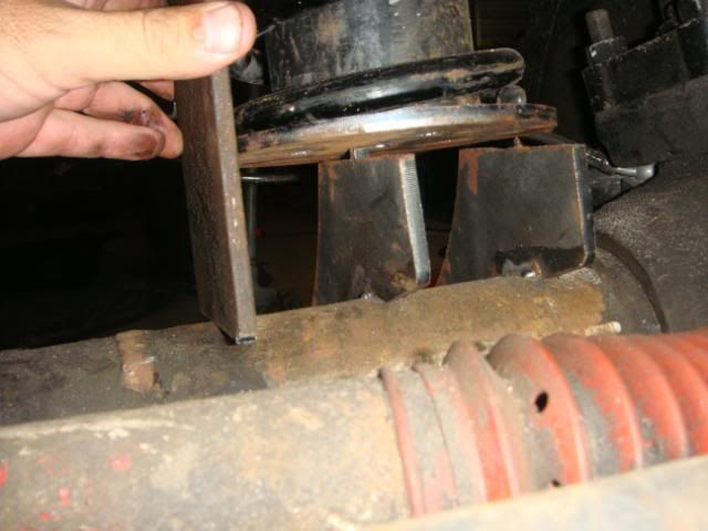

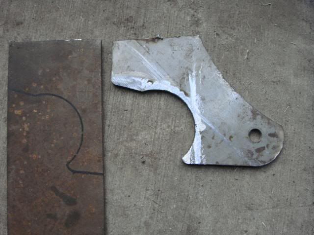

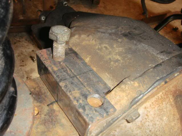

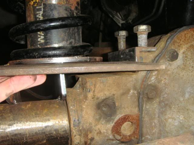

Messed with the suspension brackets a little today. Cut and trimmed a piece of 2" x 1/4" angle
Then I'll tie it into some 1/4" plate that will sit on top of the ballistic brackets. I'll then weld the round coil base to that.
On the drivers side basically going to build a third leg and then tie them all together with plate like the other side

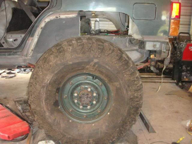

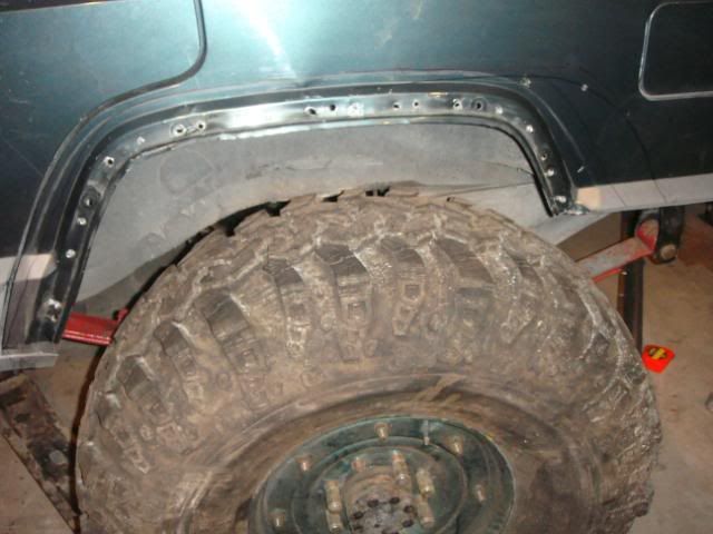

Also used a spot weld cutter and seperated the rear fenders. Hopefully I'll get them cut out tomorrow.
A friend is moving out of his storage shed and needed a place to keep his welder so I quickly volunteered my house!

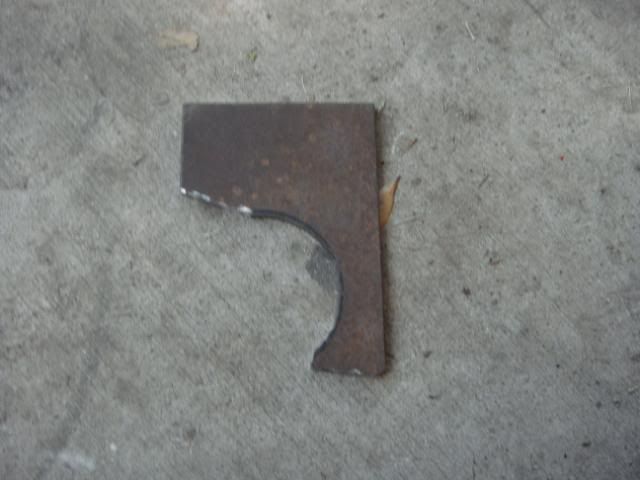

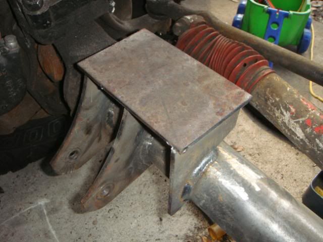

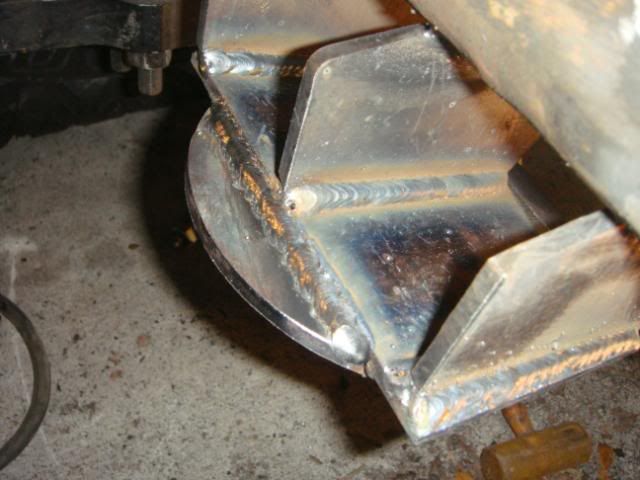

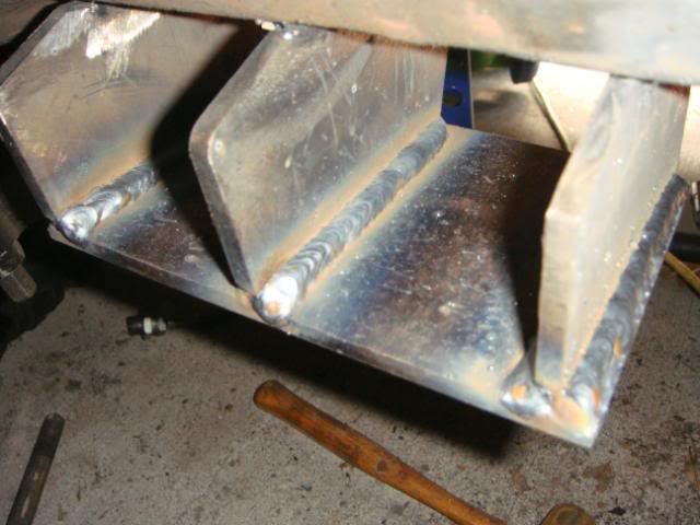

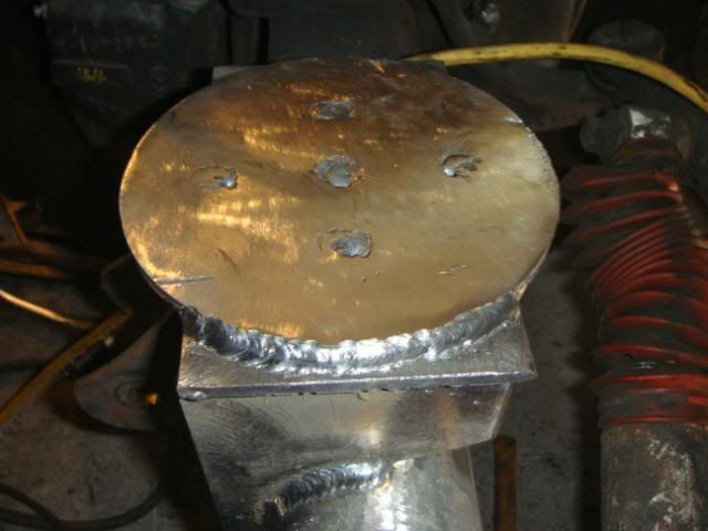

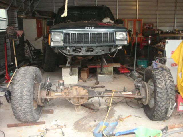

Got the front axle pulled and fired up the welder today. Only got the driver side finished. At the FD tomorrow, so hopefully I will get done mowing early Thurs. and can finish the pass side. Looked at the leaking freeze plugs and they are worse than I thought. Since the axle it out I'm going to go ahead and replace them all. Have a deal pending on my SBC and TH350. Suppose to be picked up on Sunday and should give me enough cash to get this rolling under its own power again.
Made a third "leg" so I can offset the coil seats. Traced the ballistic bracket onto a 4" x 1/4" piece os steel and then cut it out.
And then went to town...
'13 10th Anniversary Unlimited Rubi

Front looks ultra freaking wide. Are you going to swap to SRW hubs?

It's about 85.75" No plans to swap to SRW hubs now, maybe when I wear these tires out. I'll match the rear width with spacers.
