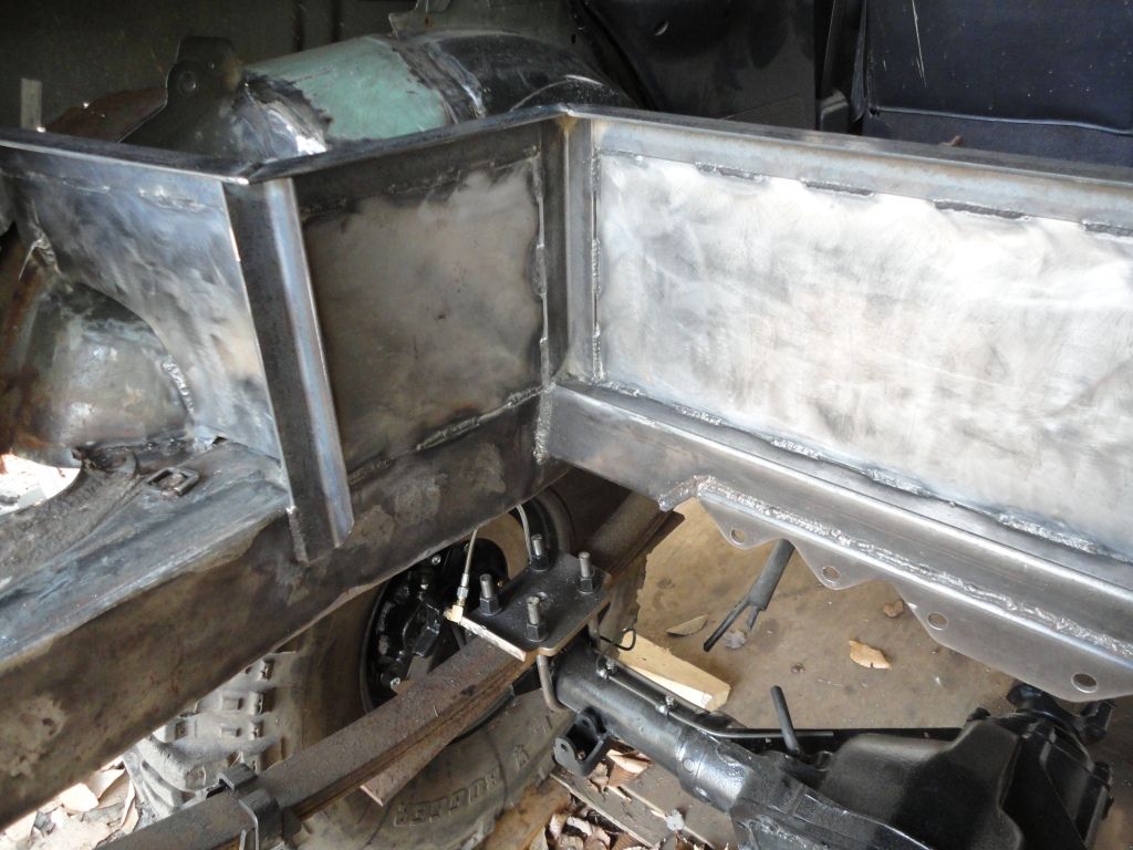

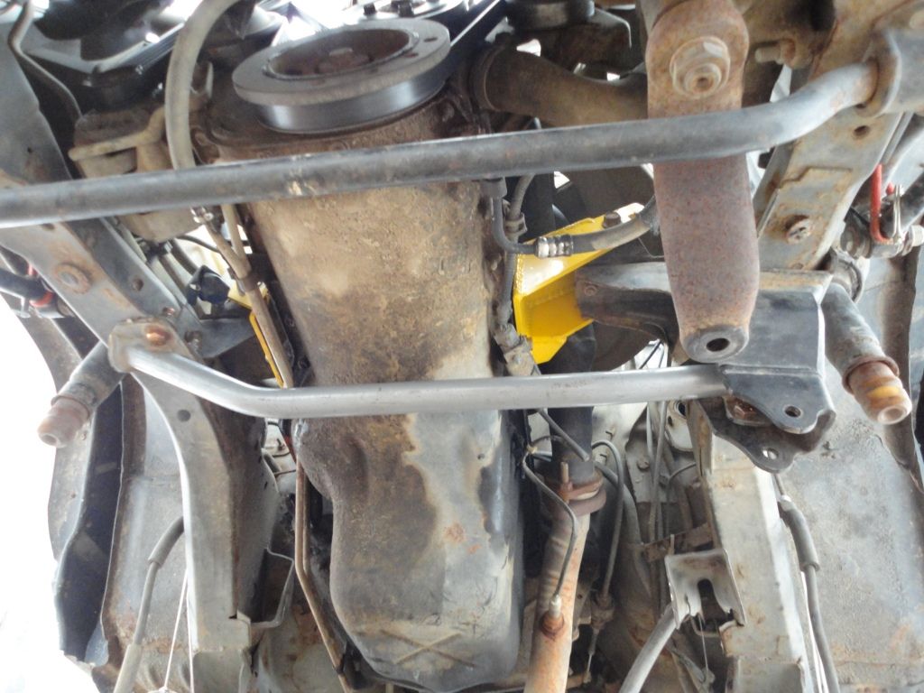

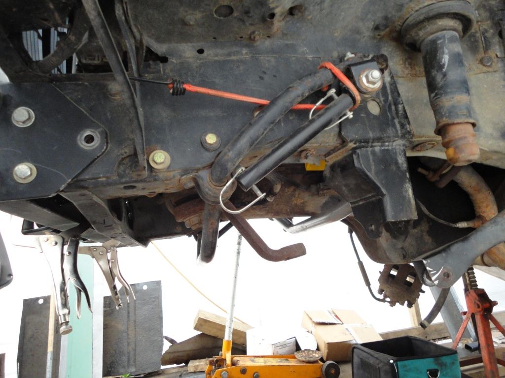

This weekend, I got the RE track bar mount installed. I don't plan to plate the front unibody/frame section for now, because I have 1/4" plating behind my bumper mounts, a C-Rok steering brace behind the steering box, the front bumper solidly ties the front end together, and the RE mount has a brace that ties into the passenger side. So, I think that's fine for what I'm doing, although I may change my mind next season. This also gave me a good chance to install the drivers side Brown Dog engine bracket, which I never got around to doing last summer.

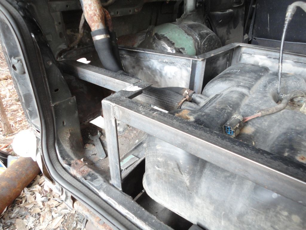

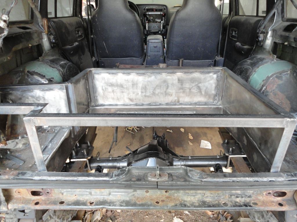

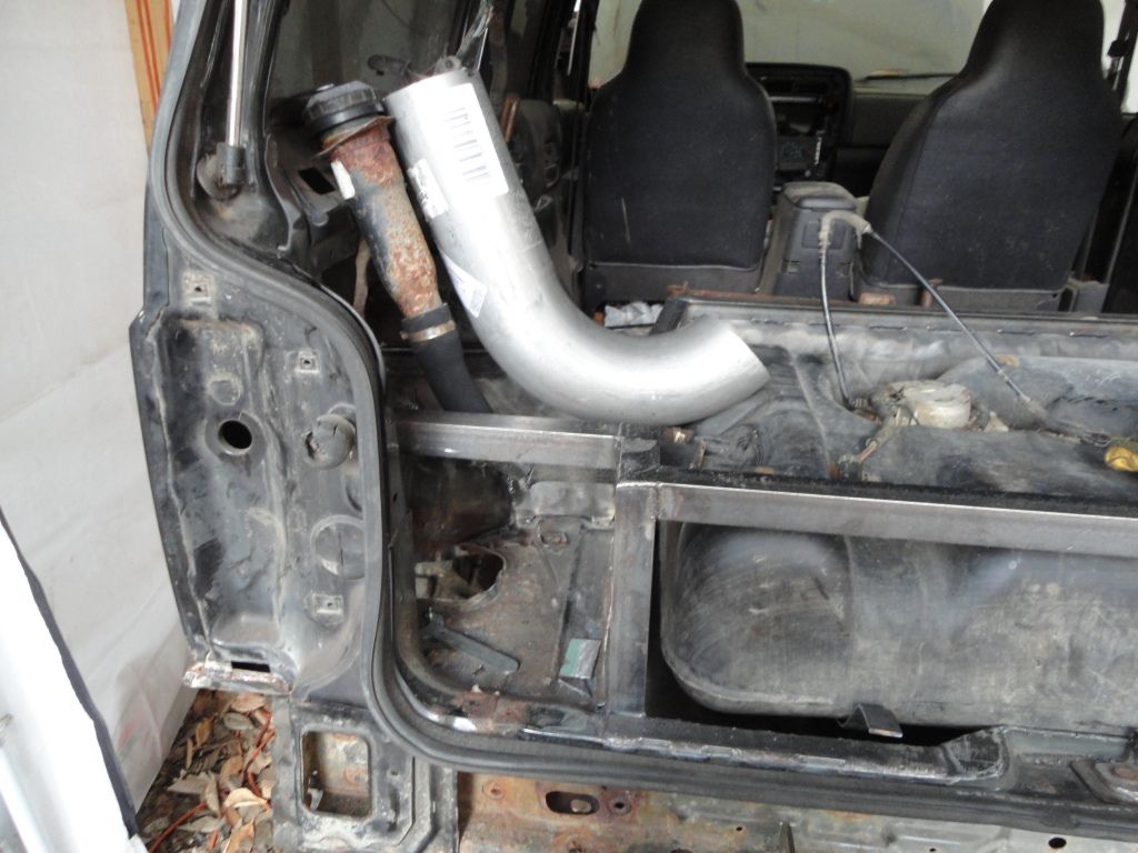

I also started covering up the sides of the gas tank enclosure. I'll run some kind of sealer along the seams to keep vapors out of the cabin, and also drill some holes in the skid to allow good ventilation to the outside.

So I'm thinking about the tank filler tube. If I use the stock fuel door, the tube would be just about horizontal. Would this be a problem, say if the body was leaning to the side, would gas come out of the filler from a nearly full tank?
My other thought was to build a wrangler style filler with a scrap piece of 4" exhaust tubing I have sitting around. I would notch it through the fender and cut it flush with the outside and weld it to the quarter panel. The filler neck will fit inside the 4" tube with minor trimming of mounting flange.
What do you guys think? Will the factory location even be a problem?
I also finished the sides of the box tonight. I think the back is less than an inch from the hatch when it's closed.
edit: Actually, I think it hits- but still latches! I'll have to cut off that part of the plastic interior liner.

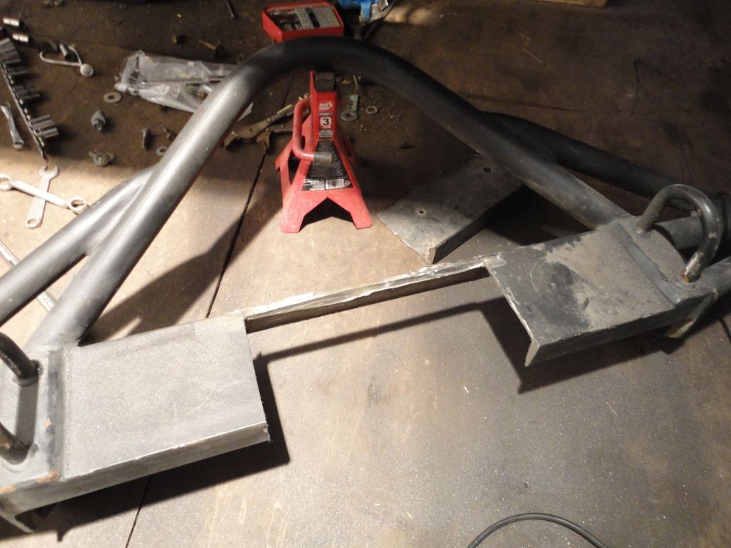

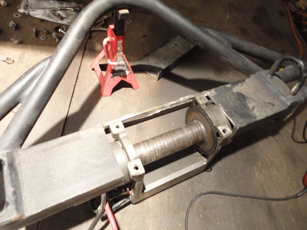

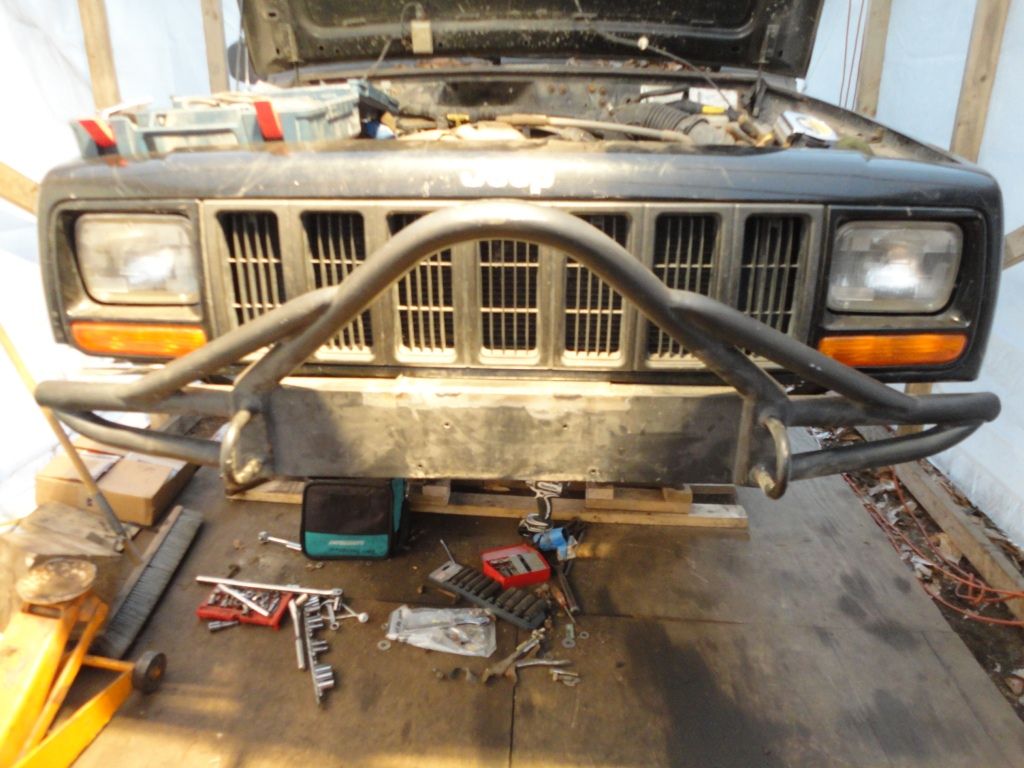

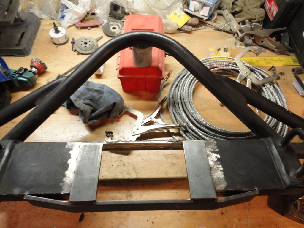

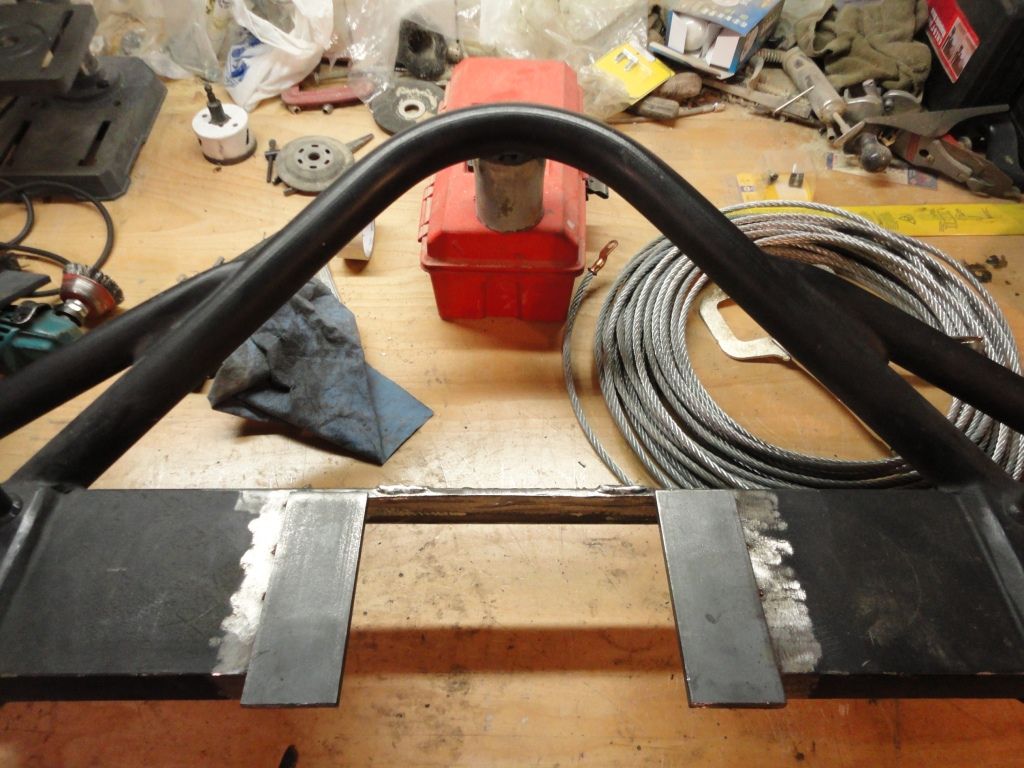

I'm waiting for parts to go any further with the front axle, so I started modifying the front bumper to fit the winch. I was hesitant to cut it up, since I spent a lot of time carefully building it in 2010! It'll be worth it though.

A couple of observations. I think you will find that the Jeep is going to be significantly less stable over the 4.5" lift on your current wheel/tire setup. I experienced something similar on my ZJ- used JK Moabs to try to keep it inspection friendly and I hated the lack of width on the trails. I then switched to 35's with better backspacing and felt twice as stable- the track width was matched much more closely to my lift height at that point. I would also route that filler neck as high as possible. I helped a buddy do a similar tank lift on his XJ and he had nothing but problems with it. Yours will be slightly better because it will be sealed.

I also ordered a YJ filler, so I'll mount it just below the window.
