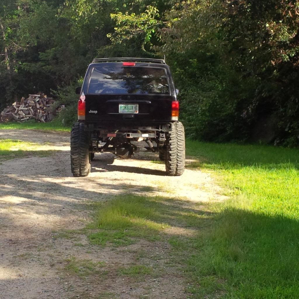

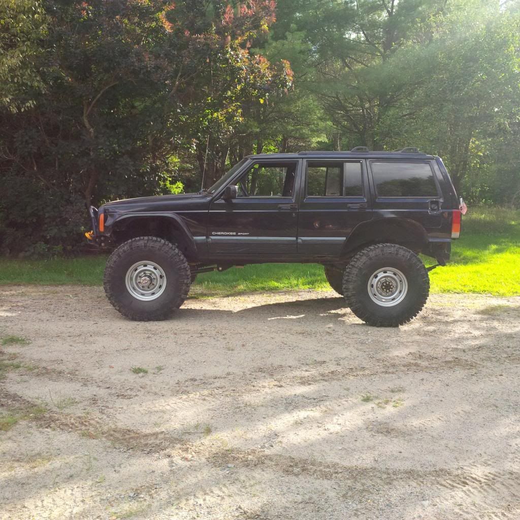

I've skimmed through your build and it looks like a nice build. But I must say, the angle on your rear shocks are terrible. You can't be getting much use out of them being mounted like that. Ever thought of running them through the floor to a set of hoops?
Yeah, I knew the angles were bad at the time I built it, knowing that I would probably change it at some point. It was simpler to build and I figured it wouldn't hurt to at least see how bad it was. I thought about going through the floor, but didn't want big holes in the floor. I have some other ideas. This works for now though.

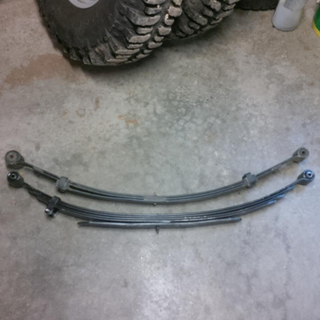

Well these leaf springs are done...
For whatever reason, I decided to forget about the overload spring, which would have helped with axle wrap and hard hits. These S 10 springs are the light duty variety, with 3 leaves/1 overload. The Jeep now sits probably 1 1/2" lower than before, so the light duties are not up to the task. I guess I got my $80 worth of fun from a used set of leaf springs. I ordered brand new heavy duty packs (4 leaves/1 overload) and will keep the overload this time.

New leaf springs came in today. The ride is much stiffer which is nice, but the rear doesn't flex nearly as much. I may end up removing the overload. The Jeep sits level again.
