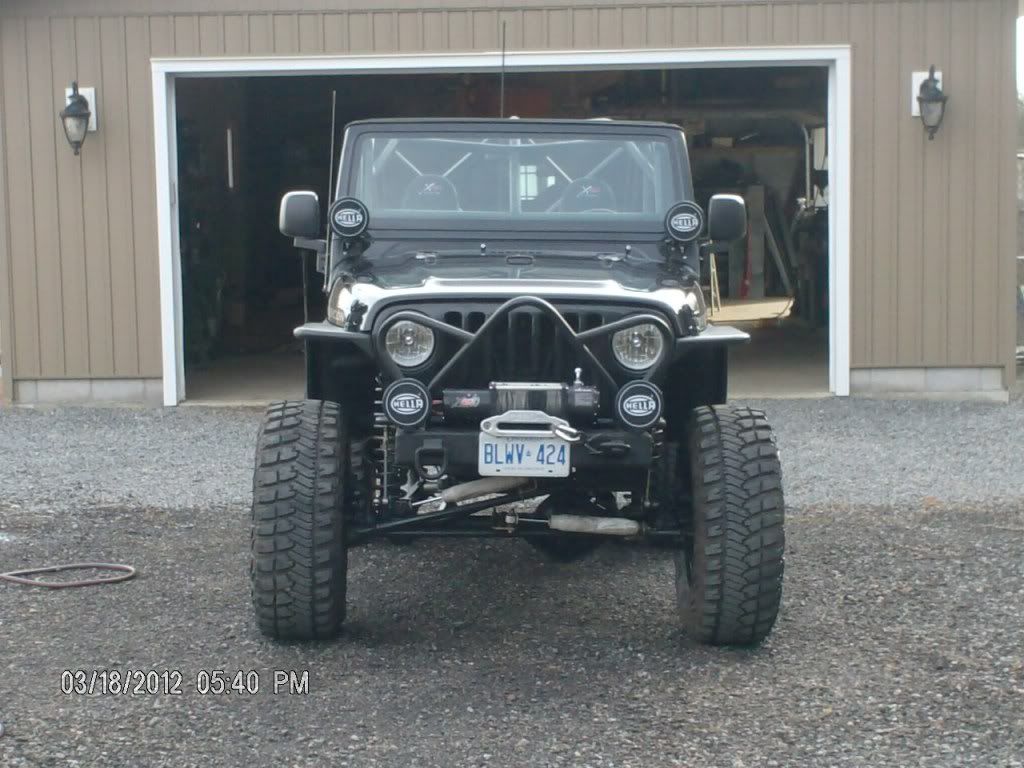

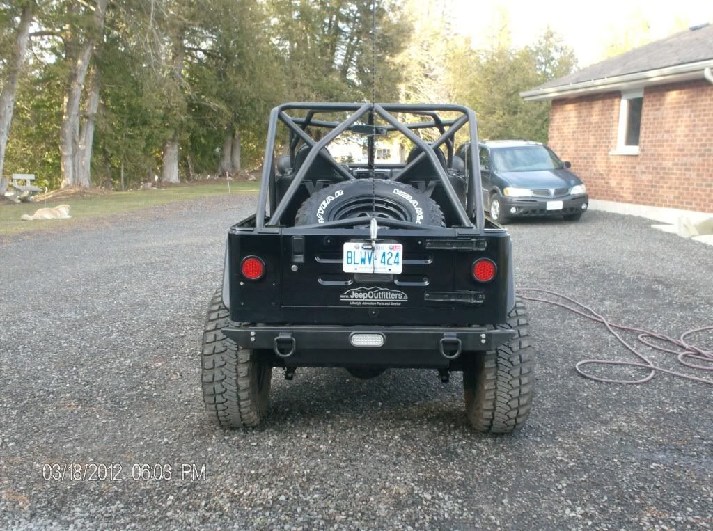

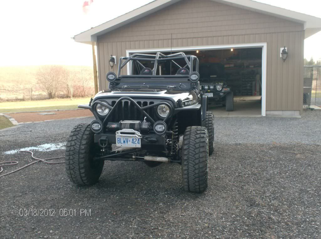

Got her cleaned up today And ready to go!!

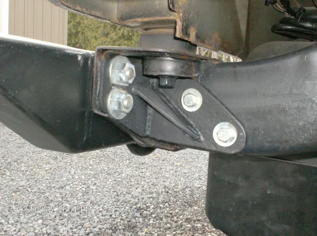

Frame tie-ins I built for the rear bumper.
And just a random pic of some jeeps

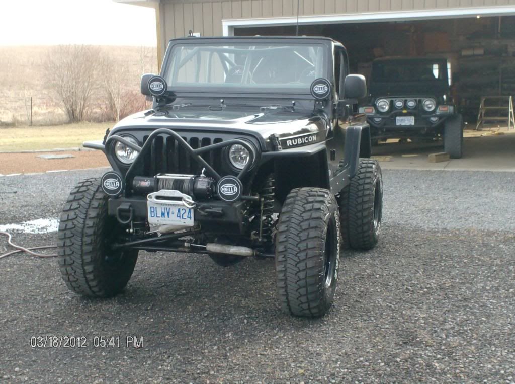

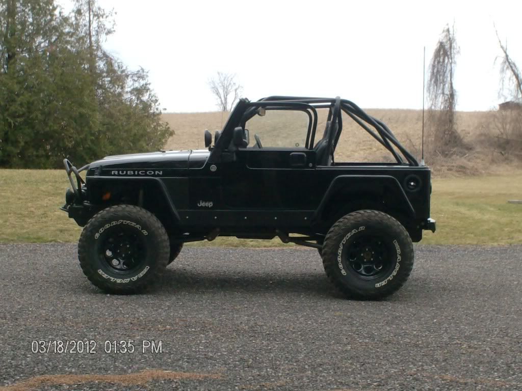

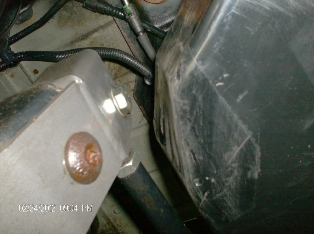

I also stretched the rear of the jeep a few weeks ago. Worked out to be a 2" stretch. After that my track bar hit my gas tank skid hard, so I drilled some new holes and moved my gas tank back 1/2". I also had to cut and weld a section of my gas tanks skid for clearnce. I plan on stretching the front as well. I have to wait till I do high steer tho because my tie rod and drag link will hit each other if I do it now. After the front is done I will have a wheel base of 97" +
Here is a pic with the rear stretch.
(pics like this make me want/ need 37s so bad! The 35s look small)
This is where I had to modify my gas tank skid for clearnce.

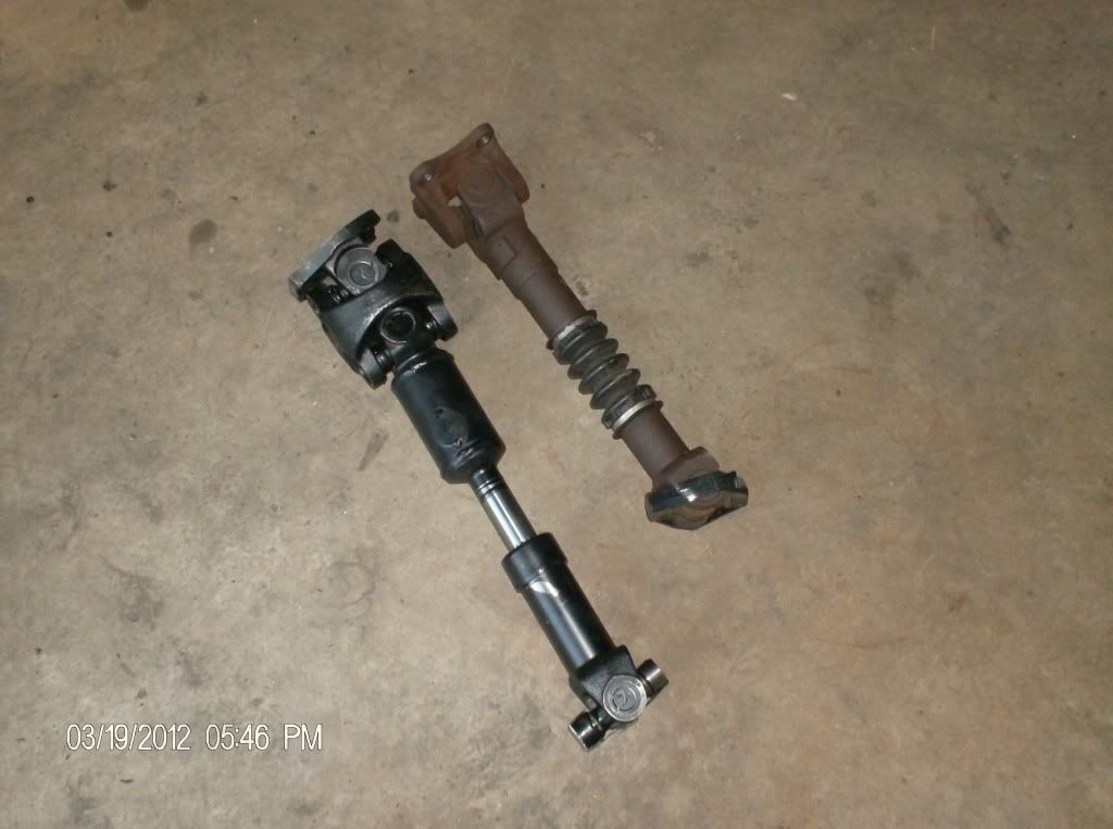

New Drive shaft

Looks great dude! Why is the new drive shaft longer? or is the slip joint just compressed on the old one?

The new drive shaft is longer because i stretch the rear 2" and I now have a tummy tuck, so the old lenght was to short. In the pic the the slip joint is compressed a little on the old one and is fully extended on the new one. It is only a couple inches longer.
