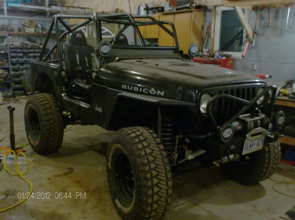

So far i really like them, they are pretty nice to sit in and i really like the look of them. My boss has had the same ones in his commando for a while and he also really likes them. I would recomend them for sure.

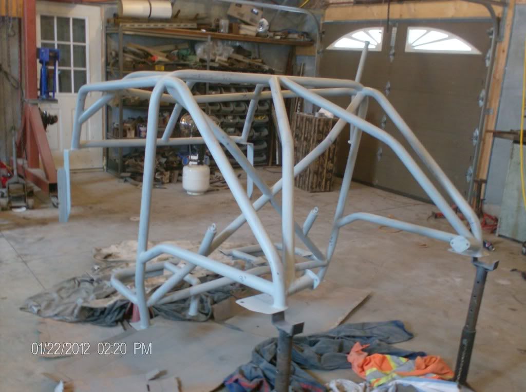

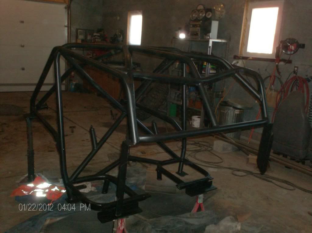

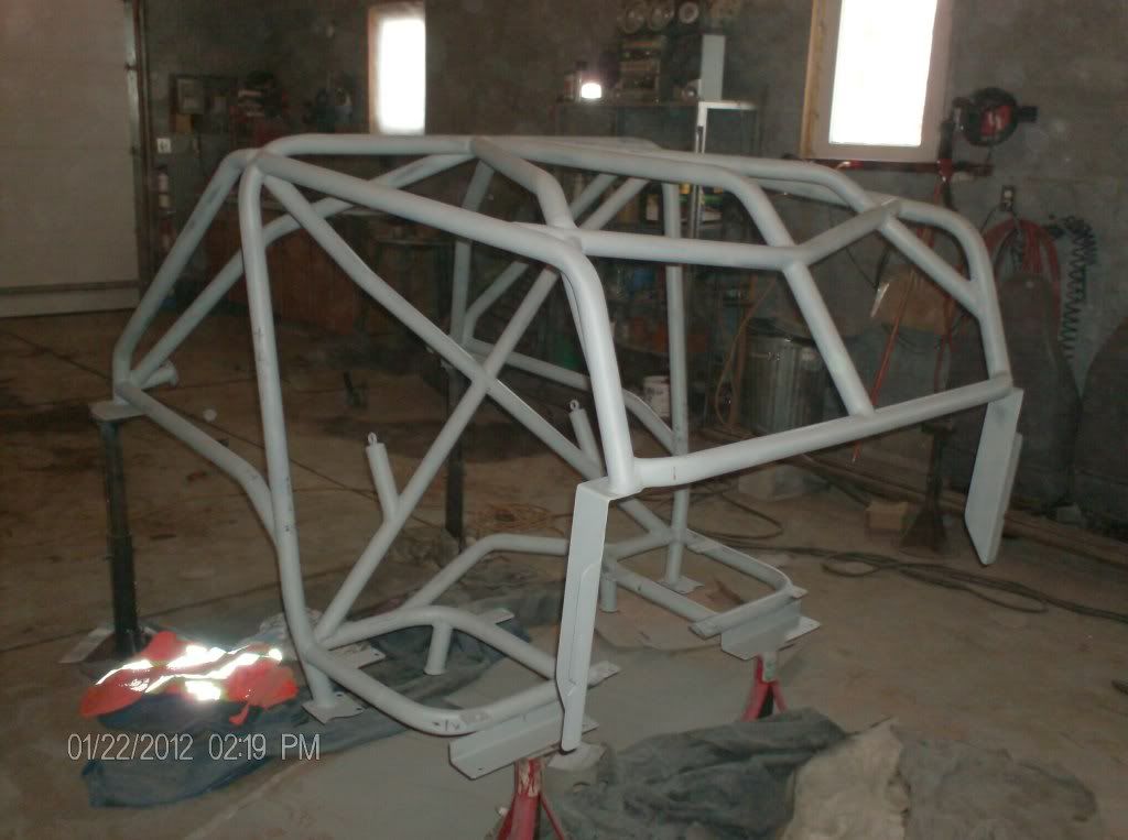

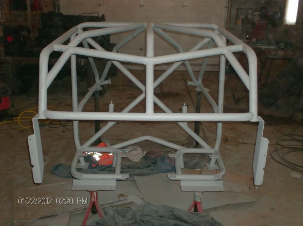

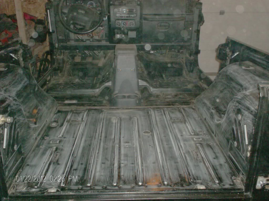

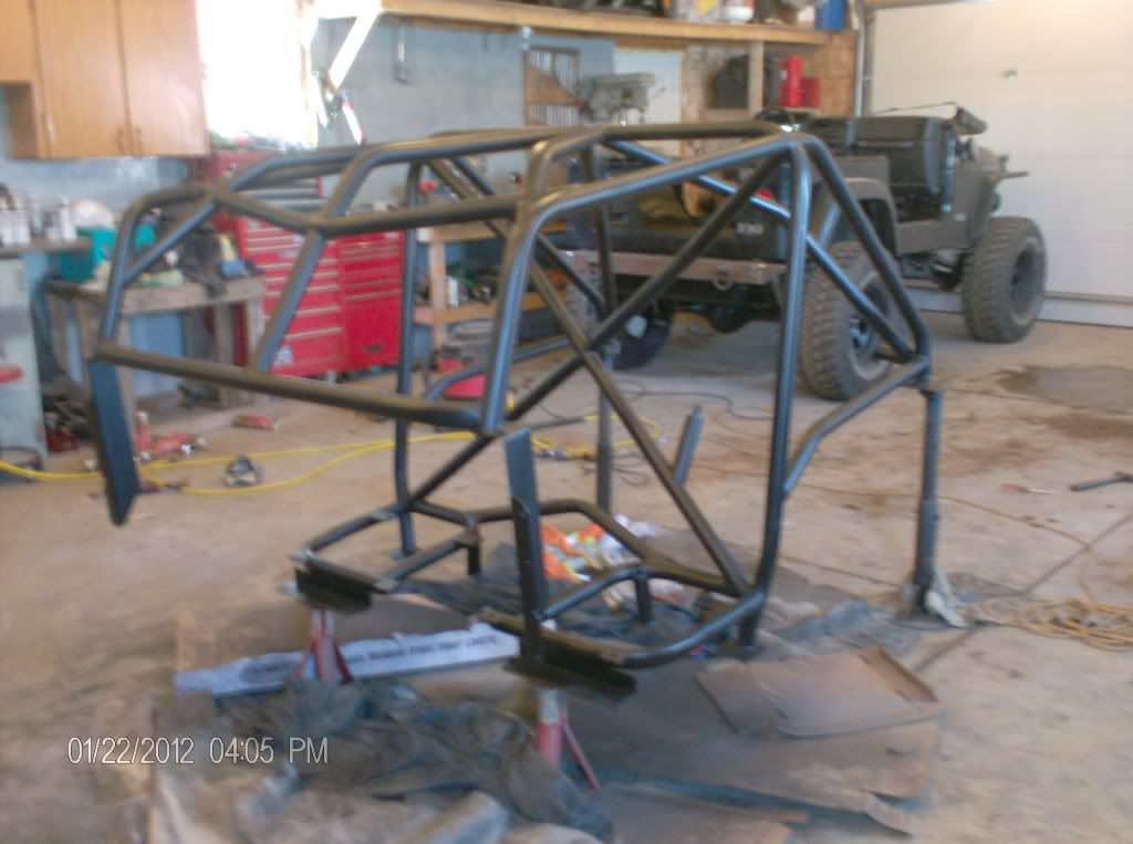

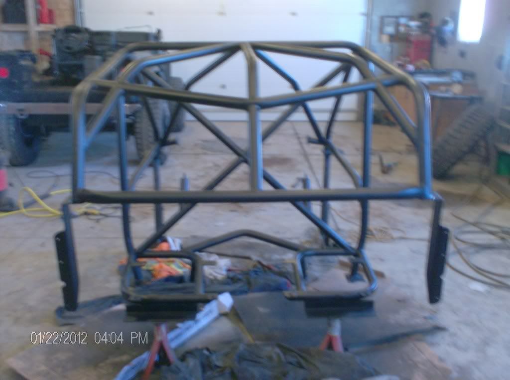

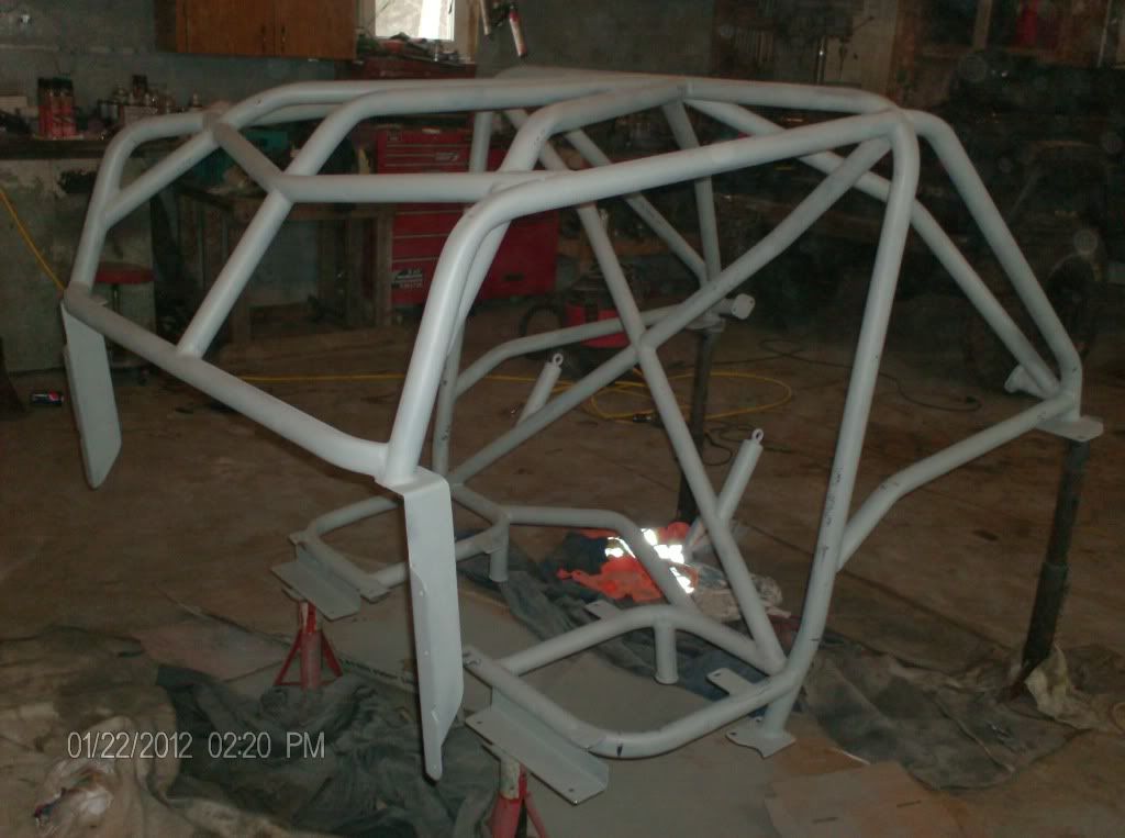

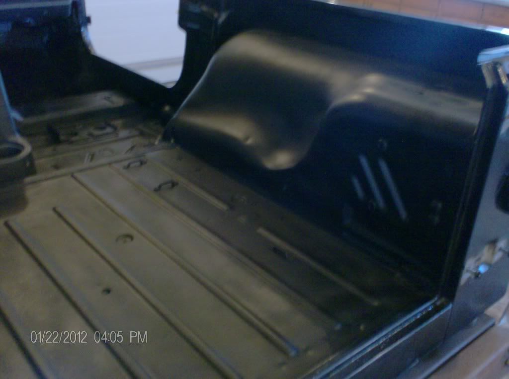

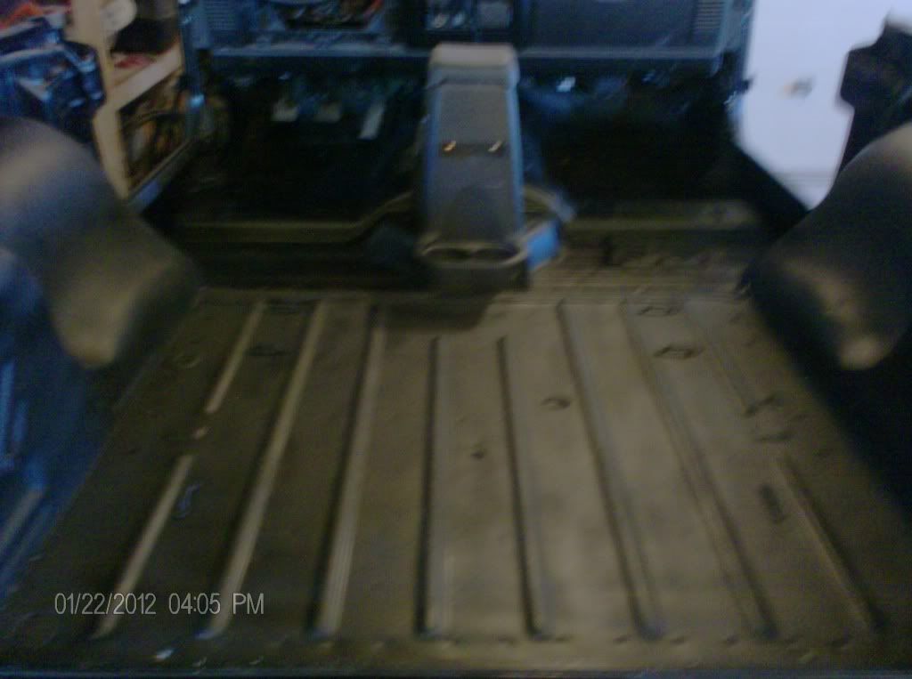

Time for a Updata
Cage is DONE!
Tub floor sanded.
And then painted.
I am really happy with how the cage turned out. I think it looks pretty good. It should be going in the Jeep to night or i might wait till tomorrow night.
Let me know what you guys think.

The cage should at least extend all the way to the floorboards in the front. I wouldnt trust it just mounting to the side of the dash like that. That is a weak area. Also might want to reinforce where it wraps arounds the top corners of the dash. That looks a little flimsy.
The rest of the cage looks killer though.
Jankoid is offline
post #84 of 105 Old 01-23-2012, 08:22 PM Thread Starter
MRYJ101
Location: Peterborough
Posts: 169
I know what you mean.... but there are gussets on both peices you just cant see them very well in the pics. Also there is very little room for the pieces to run all the way down to the floor and get the doors to shut. I may look into bringing them down to the floor for more strenght. Thanks for the tip!

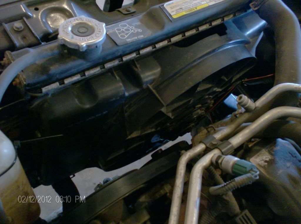

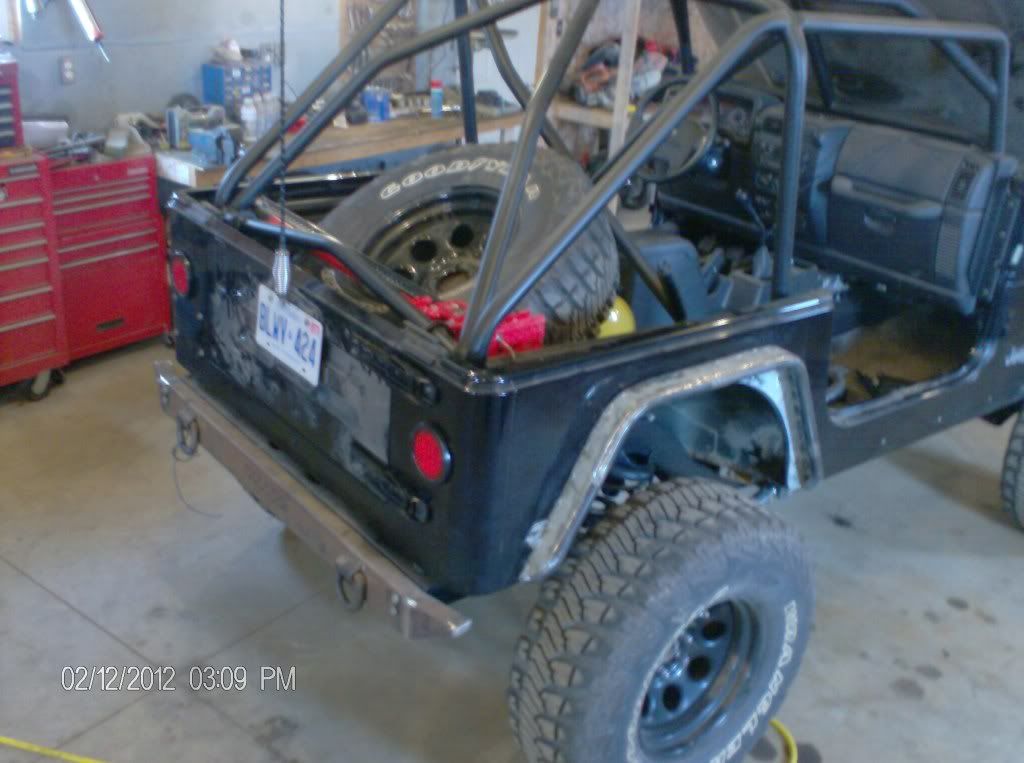

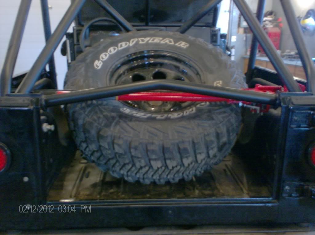

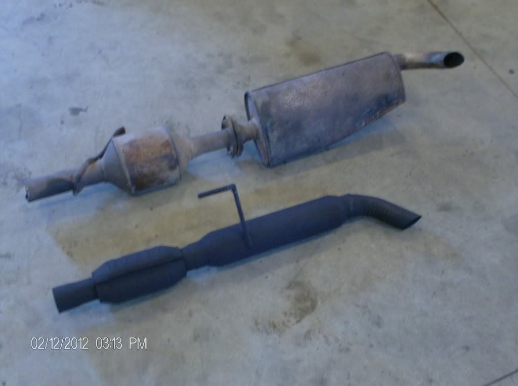

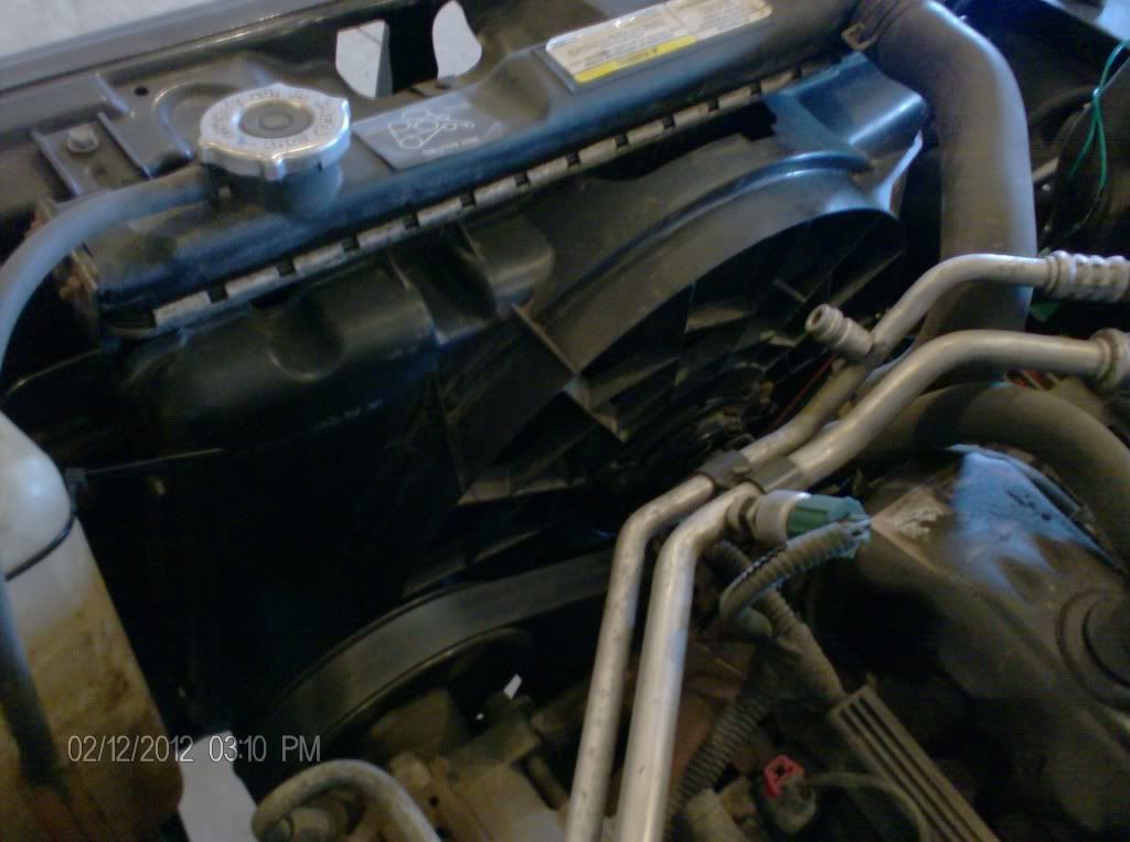

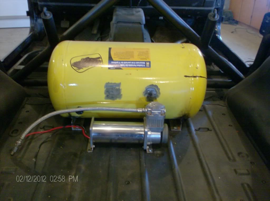

Compresser and air tank mounted.
Tire and high jack mounted.
Electric fan mounted.
Not much room between the fan and the motor.

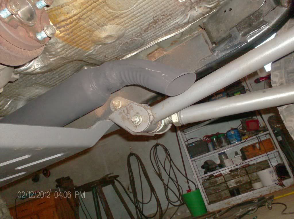

Made up some new exhaust.
Old vs. New

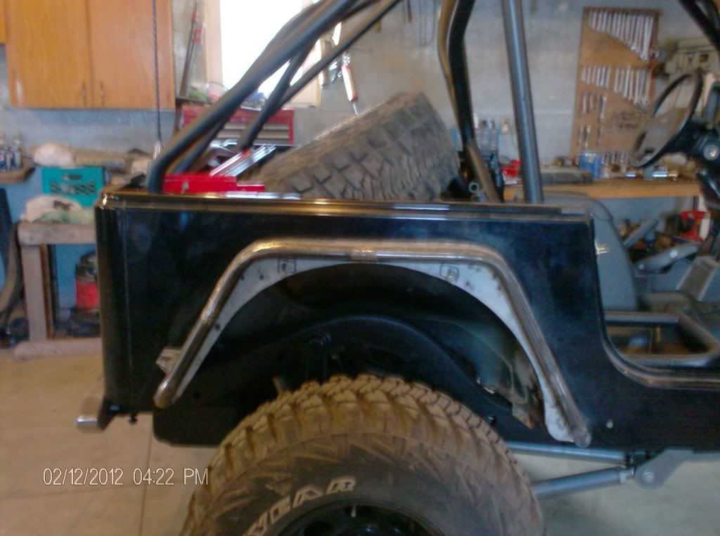

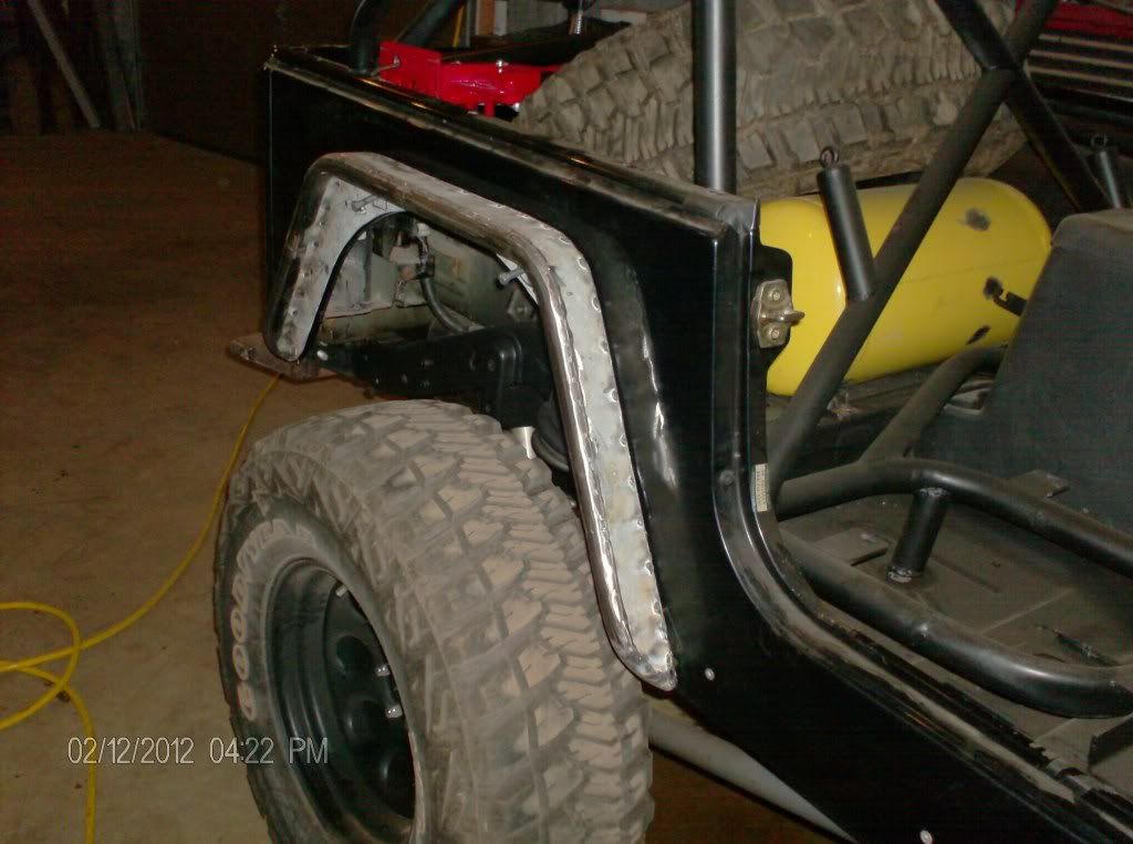

Also have been working on rear tube flairs.

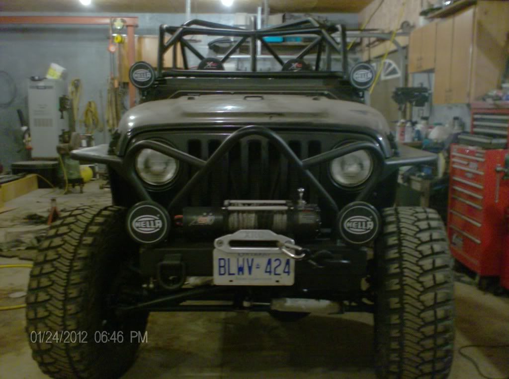

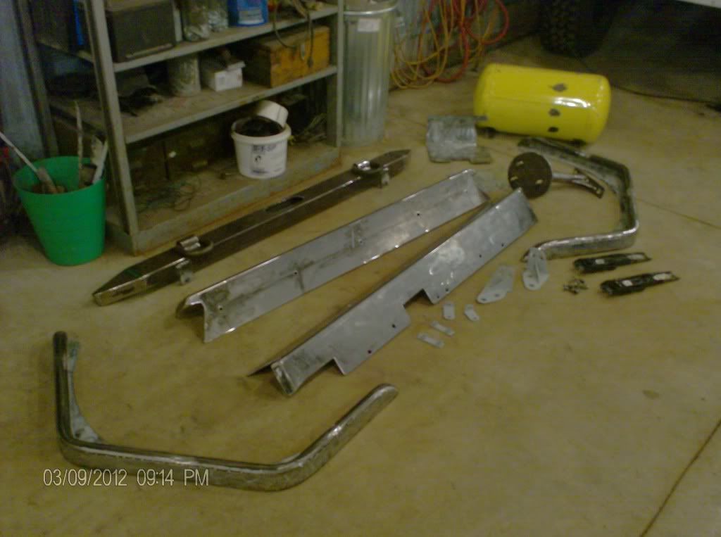

Got some new super sexy head lights the other day! They are crazy bright, a 100 times better than the stock ones.
Here are my front turn signals for the side. I just re-used the factory ones.
The parts that are getting painted this weekend.
