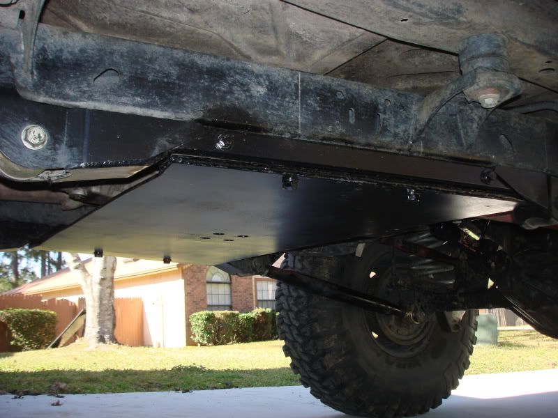

I just got back my jeep from a local guy down in gainsville that does great work. He made me a tummy tuck that would work with my skyjacker LA bracket. He also mounted my BTF LCA brackets on the front axle. all for a decent price. Im really stoked about it, since i gained 4" NOT inscluding the skyjacker bracket. heres some pics.
before:
after:
the skid is reinforced with 2 angle irons going across and the actual skid is 1/4" thick. my rear pinion angle had to go way up which kinda sucks but thats the name of the game. also whenever i got the jeep back it was making some racket from the rear, i thought it was the rear axle but it wasnt. i adjusted the pinion angle and was still there just much less. I figured out that it is my driveshaft going bad. I never had it rebuilt when it got cut down so i ordered some spicer joints and the centering ball yoke ($87.05 shipped, no local shops had the parts)and will be replacing it very soon.

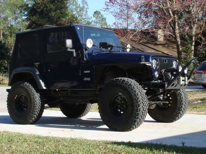

so i rebuilt my rear driveshaft and now its smooth. I have the upper arms on order to get rid of the clanking. I need a front track bar asap, awaiting funds since my current track bar doesnt want to flex as much as the jeep wants it to. I replaced my shock with some longer ones and this is the outcome of them(a lot more flex):
pic thanks to ben.
i havent installed the rear shocks since i need to bumpstop it correctly so i dont blow them out.
