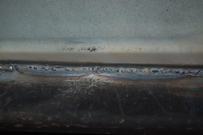

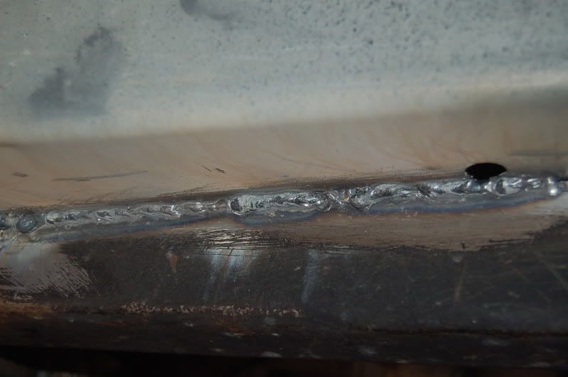

new, cleaned up long arm bracket welds....

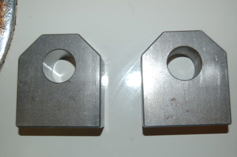

Posts: 3,875
shackle mounts came today. took em and dropped them off with the dude and saw his progress. he's got the main mounts made for where the tow hooks mount. .5" 2x4 for the beams, and he's going to do the winch box in 3/16" instead of 1/8" bc he wants the added strength in the winch box. everything else will be 1/8" and the tubing is 1.5" i believe. anyway, he's going to call me when it's ready. i miss my little moneygrubbin ho....
