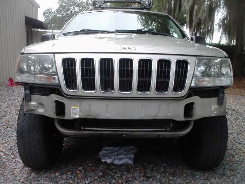

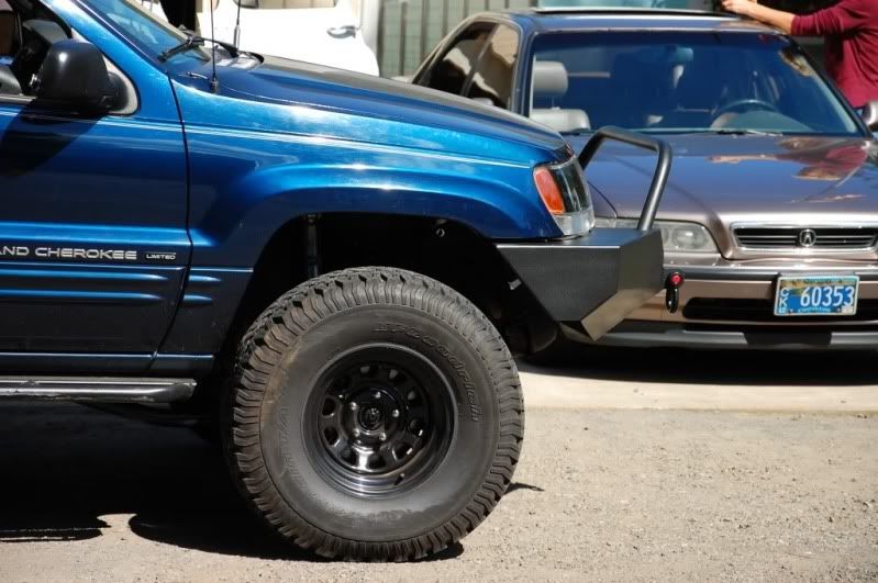

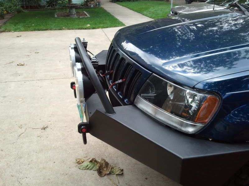

So i went to my welder today and discussed the bumper and gave him a down payment of half. I'll put pics below, but it's basically molded off of moony's, with the lsr lower radiator support. the winch tray is going to be 1/4", the radiator support and hoop over the winch 1.5" tubing, the frame at 1/8", but i wasnt sure this was heavy enough so he's going to check the prices on 3/16". anyone? is 1/8" gonna be beefy enough to lean on? anyway, taking my bumper off tomorrow and gonna take the jeep up for him to get his measurements, etc and then take it back again next week for the final fitting. hope all goes well!!!

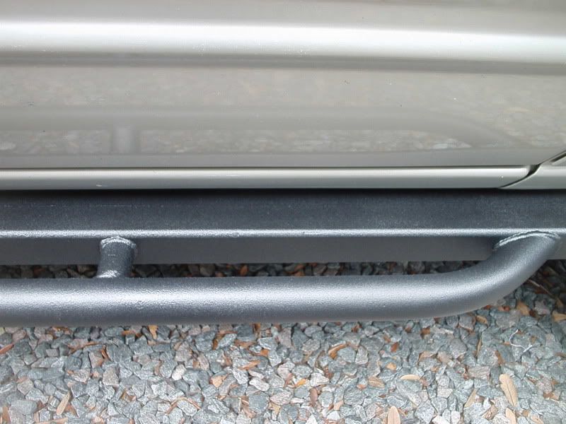

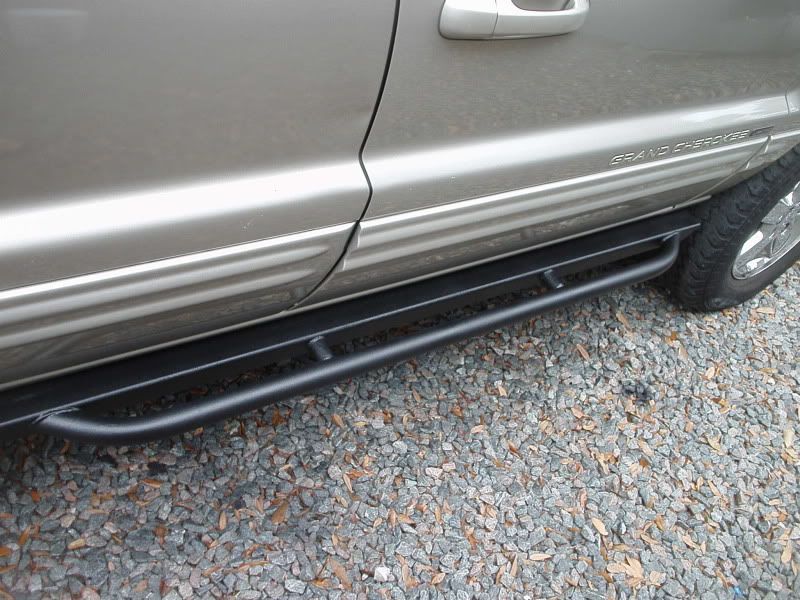

got quite a bit done today....changed the oil (mobil1 10w30 extended performance full syn) after 1800 miles since the head gasket change/fluid change/sea foam in the first tank after the gasket change, and one bottle in the last tank i ran dry before the oil change. when i drained it, it was a little darker than it should have been IMO, but that's what i wanted. i drove it the length and width of the state, so i was hoping to loosen some **** up in there; looks like it worked. when i went to the store to get my oil filter, i grabbed a couple cans of duplicolor spray on bed liner to try out on my sliders bc they were lookin a little haggard, and i had also planned on painting the new bumper with it bc of the good things ive heard on here about it....MAN was i impressed. i wont bore you with the preparation details, but it came out AWESOME! it looks like powdercoat with sand in it; pretty much sandpaper...no slippage here!

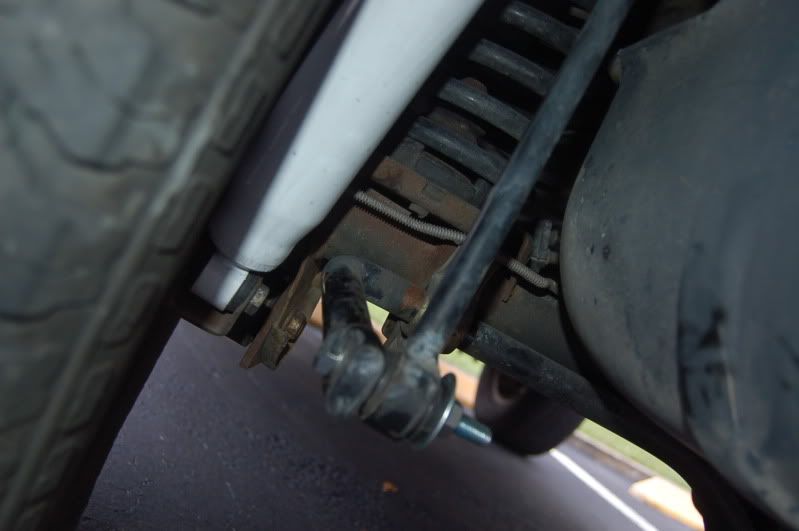

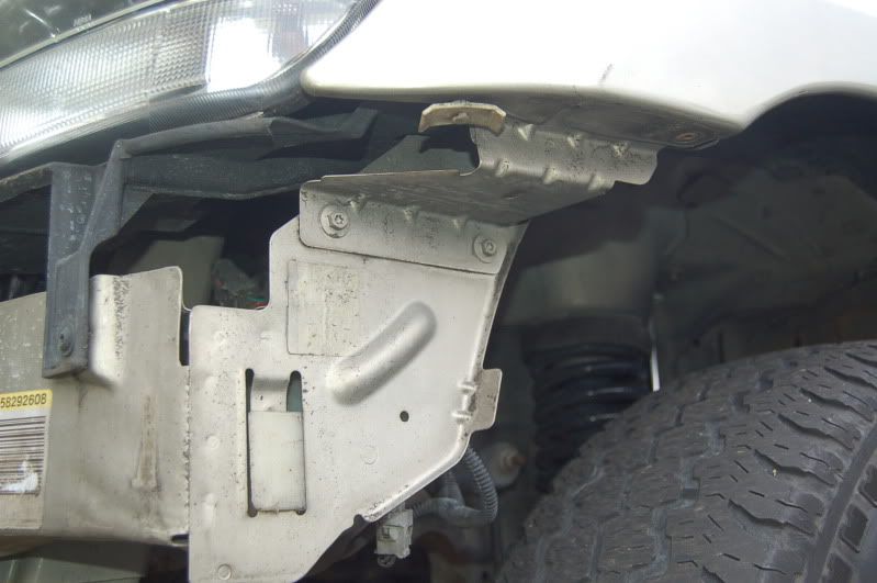

was checkin around, noticed the bolt for the rear sway bar link was missing, so i picked up a new one and fixed that...and then onto the bumper. just ripped that sucker off and then took it to the welder so he could get his measurements, pictures, etc. i'm going to have to leave it with him for a few days later on, but for now he's got his sketches...anyone wanna buy some foglights with headlight bulb upgrades?

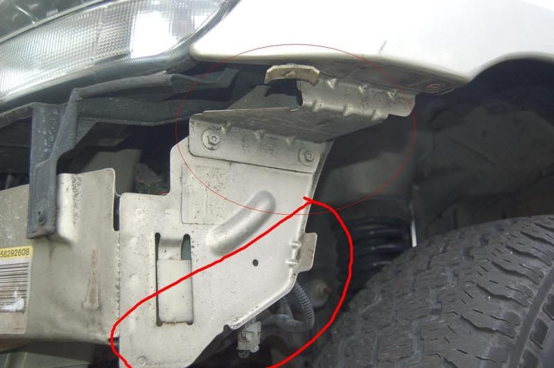

on the pictures below, i circled the support that he's going to remove with the thin red circle, and the thick red is where he's going to try and trim some off for a more snug fit. anyhow, ask anything you want, and i'll put up more as i have it....
