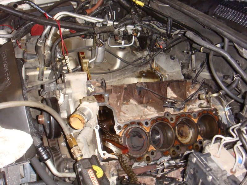

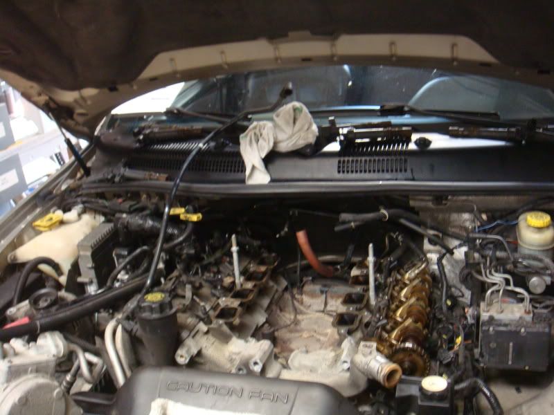

here's starting from yesterday...

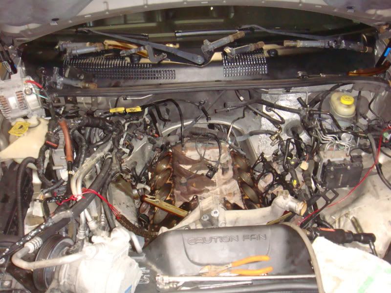

just finished 9 hours under the hood....got everything out down to the heads today so all we have to do in the morning is go in and pop the heads off. good day of learning, but the guy that's doin it with me def knows what he's doing. started out with the plugs, and there wasnt any moisture on a single one, so we moved on to a compression test... but the tester we bought was bad (stupid harbor freight). borrowed one from the shop next door, and no leakage showed when we tested with all spark plugs out, fluid fills open, etc. so we just said **** it and started breakin her down. everything's been fine, no problems at all. from what i'm told, everything we've found so far is fine. (no milky oil, no water/coolant in oil, etc.)
i dont really have the money to get the heads re-done as preventative maint....should i let the jeep sit for another week and save money to have them re-done? the guy that's doing it with me is convinced that there's a crack between the water ports and that the coolant's burning off before it gets into the engine, so it shouldnt be that big of a deal...? what are your thoughts on this?
felpro...that's what i went with. got the gasket kit with new gaskets for everything, and duh new bolts. im not THAT green. anyway, i got some pics today, and i'll take more and post em to my build thread tomorrow and let ya'll know how it goes.

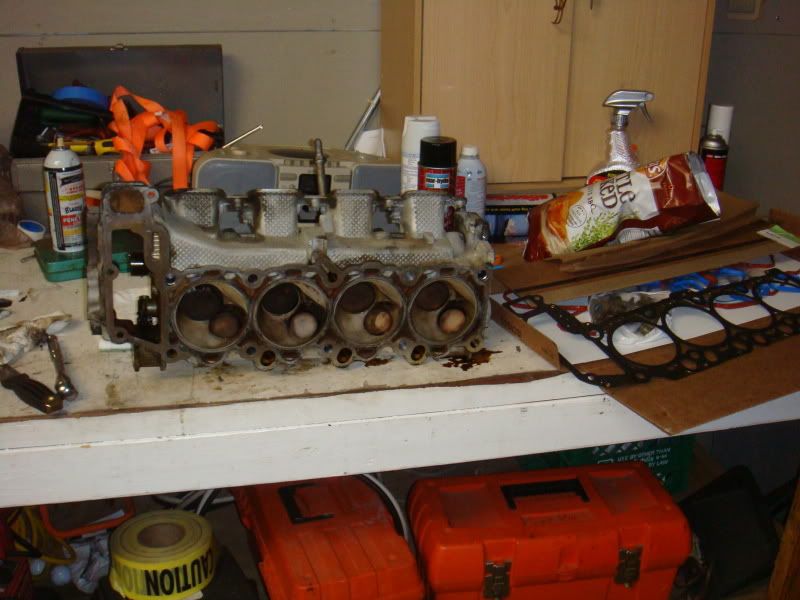

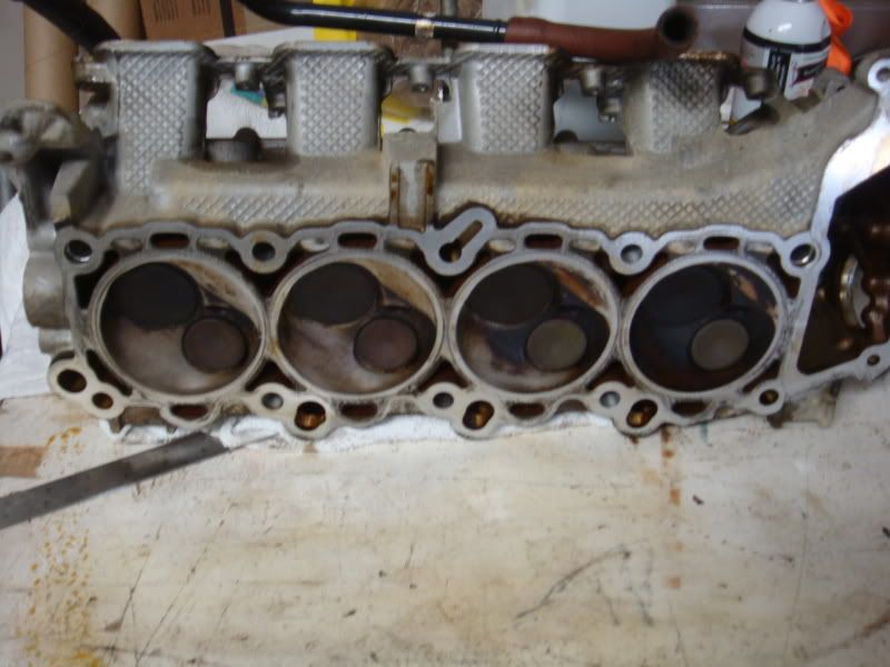

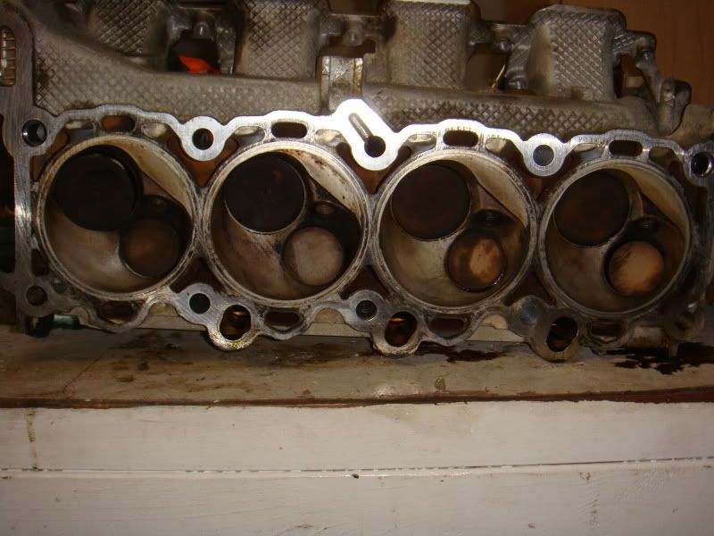

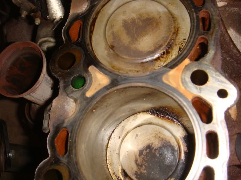

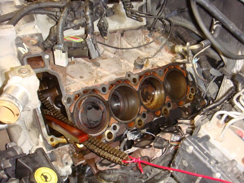

got the heads off easily first thing and sent them to a friend of the father in-law's machine shop to do just a pressure test and measuring bc they look killer clean. everything was good. found the problem and i'll post pics of everything tomorrow as my camera's at the shop save for one cell phone pic below...
there was a leak at a water port on the passenger side cylinder head, in the pics you can see the discoloration at the one spot where coolant was getting in and burning off. got the heads all cleaned and ready to install and took lunch. oh, also picked up new champion platinum plugs to install as well.

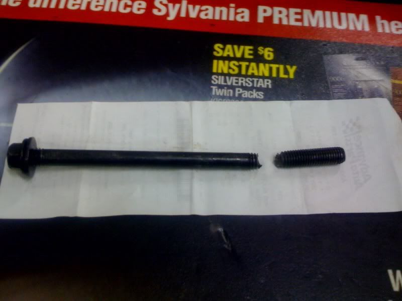

came back from lunch, started putting the drivers side head back in first, get to bolt #2, and...SNAP!!! i must've gotten a bad bolt bc that sum***** snapped right off. snapped right off nice and deep in the block too. luckily my bro in-law was there and pulled his tap out kit out of his tj. drilled her out, breathed a sigh of relief, and went to the auto parts store for an exchange and to rip them a new hole. so that's that. the father in-law is letting us stay in the shop monday and finish putting her back together so i can take her camping next weekend for my bday. anyway, here's the broken bolt via cellphone pic...

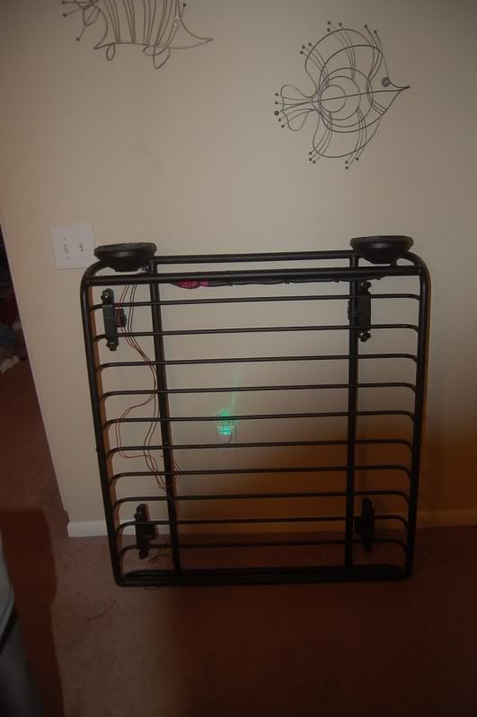

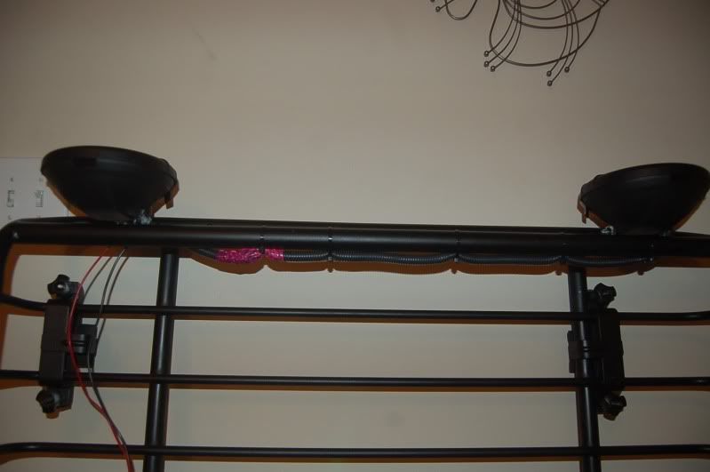

on another note...got the lights put together on the rack and had some wiring questions...here's pics first...

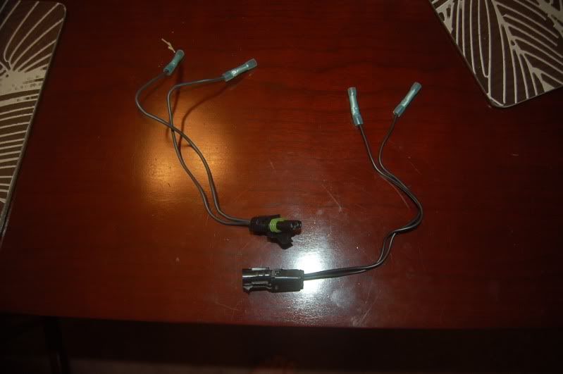

the disconnect i want to use for rack removal...
how do i wire that disconnect in? i ran both my light power wires to one, and both my grounds to one. i was going to ground the lights to a rack rail bolt...but can i run the ground to one wire and power to one on the disconnect, and then ground one of the wires coming out of the other end of the disconnect that stays attached to the jeep? let me know what you think about everything. i appreciate the input. oh, and ps...the pink duct tape was my fiance's touch, it'll prob be covered with black tomorrow.

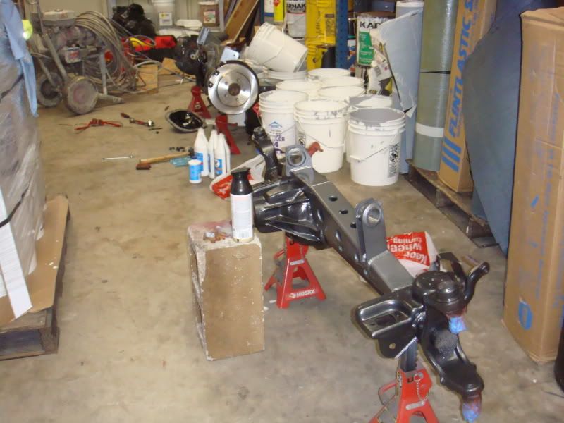

bro in-law's axles he's preppin for the tj...

how bout "wiring issues" ?....haha..im kidding. did you ever get the cargo light swapped out? im not entirely sure on this..but i think you can just snip off the same wire on both of the connectors...and just run power through the connector and ground the lights out on the rack bolts...im almost positive that will work. but wire it before you cut the extra wires off the connectors just in case.

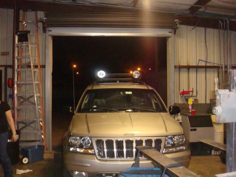

i got everything done tonight with the rack wiring. ran the grounds into the body between the doors, under the sills with self tapping screws. got the battery lead run and the relay. going to finish off running the wires to switch tomorrow after work.

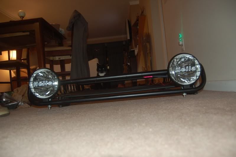

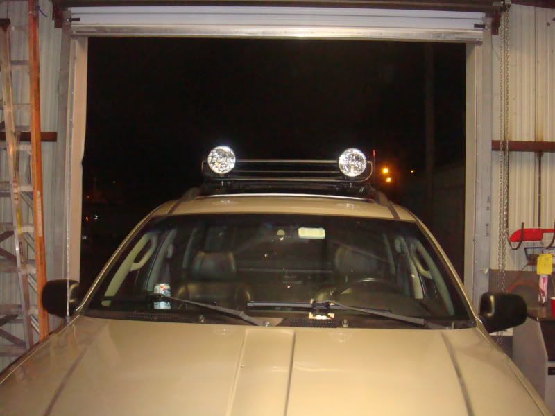

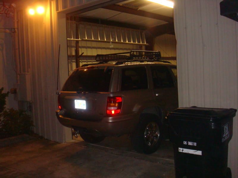

bigb...got the tailgate light done, but it was a weak light. wires are run and waiting for a new light...but the head gasket shenanigan set me back in fundage as well as the fact that i havent had my jeep to work on for...damn, only a week; seems like forever. i may just stop on the way to camping friday at the trailer shop and pick one up to install in the tailgate once we get to the site. we'll see. here's a couple pics of the lights on the rack, and an *** shot...
