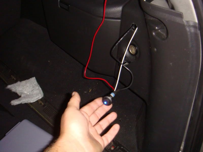

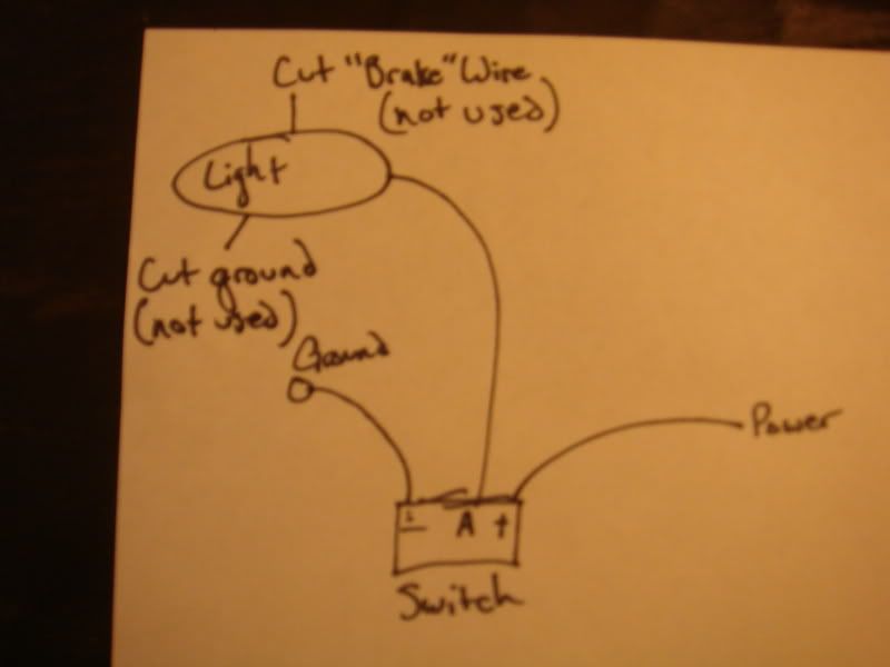

got the light into the tailgate, all the wiring run, but when i connected power, the switch lights up showing power, but the light does not, any ideas? i went back and switched the power to the other wire on the light, and still nothing. anyone have any ideas/advice? if i directly grounded the light, do you think that would solve the problem? here's a pic showing the switch getting power, and a diagram of my wiring...

your light has to be grounded....the wire from A on the switch goes to the power wire of the LED lights (its prob red) then your white wire on your light should go to ground...post a pic of the light wires if you can.

better yet...just go out to your car and ground out the white wire on your light to metal in your tail gate and flick the switch.

i never said the light didn't need to be grounded. lol
from the light- power - ground
then power to middle tab on switch
one side of switch to the source (known power)
other side to ground

electricity is a cycle that has to be completed...right now with no ground on the light you have an open circuit.

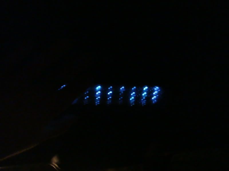

led. yeah, i may go out there and try hookin it to the red. i just went on what the dealer told me. on the light, it's labeled "brake", "tail", "ground" so theoretically, either black or red should work. be right back...

so yeah. i got a ****in' nightlight. sending this **** back tomorrow. can someone give me a link to a good light? ive got all my wiring run now. just need a 6" oval. stupid ebay
